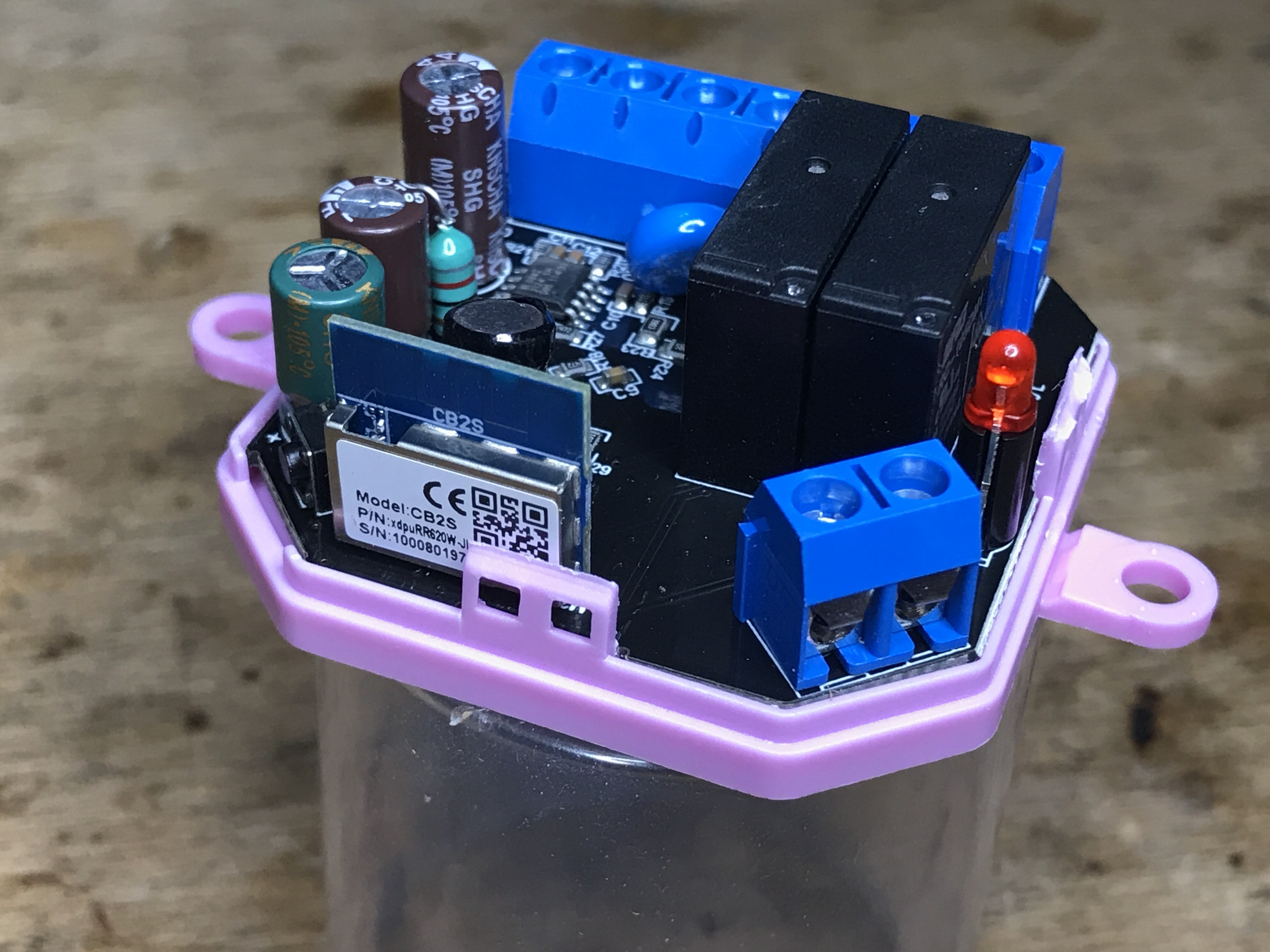

The interior of the RR620W
The case is latch only. Inside, the elements are quite tightly packed.
There is CB2S, which is basically a newer WB2S, but on BK7231N and not BK7231T.
There are two relays, of course, both are WRG RC-105DM1, each powered by 5V, 5A/250VAC. These 10A sellers are misleading....
At the input there is a varistor, a simple filter made of a choke and two 4.7uF 400V capacitors:
There's no flyback power supply here, it wouldn't fit here, but there's no simple capacitive dropper either. Here is the step down converter, you can see the coil from it:
But first, BL0942 - it's a voltage, power, etc. measuring device with UART interface:
UART is used here - it is connected to RX1 and TX1 from CB2S.

Pin configuration and board analysis
And most importantly - here is my PCB development:
All sensible CB2S IOs are occupied. Even the ADC pad is a button, which here is a single one. The relays are on P7 and P24. Single LED on P26. BL0942 is on this UART port, which is for programming, on RX1 and TX1. The switches are on P8 and P6.
