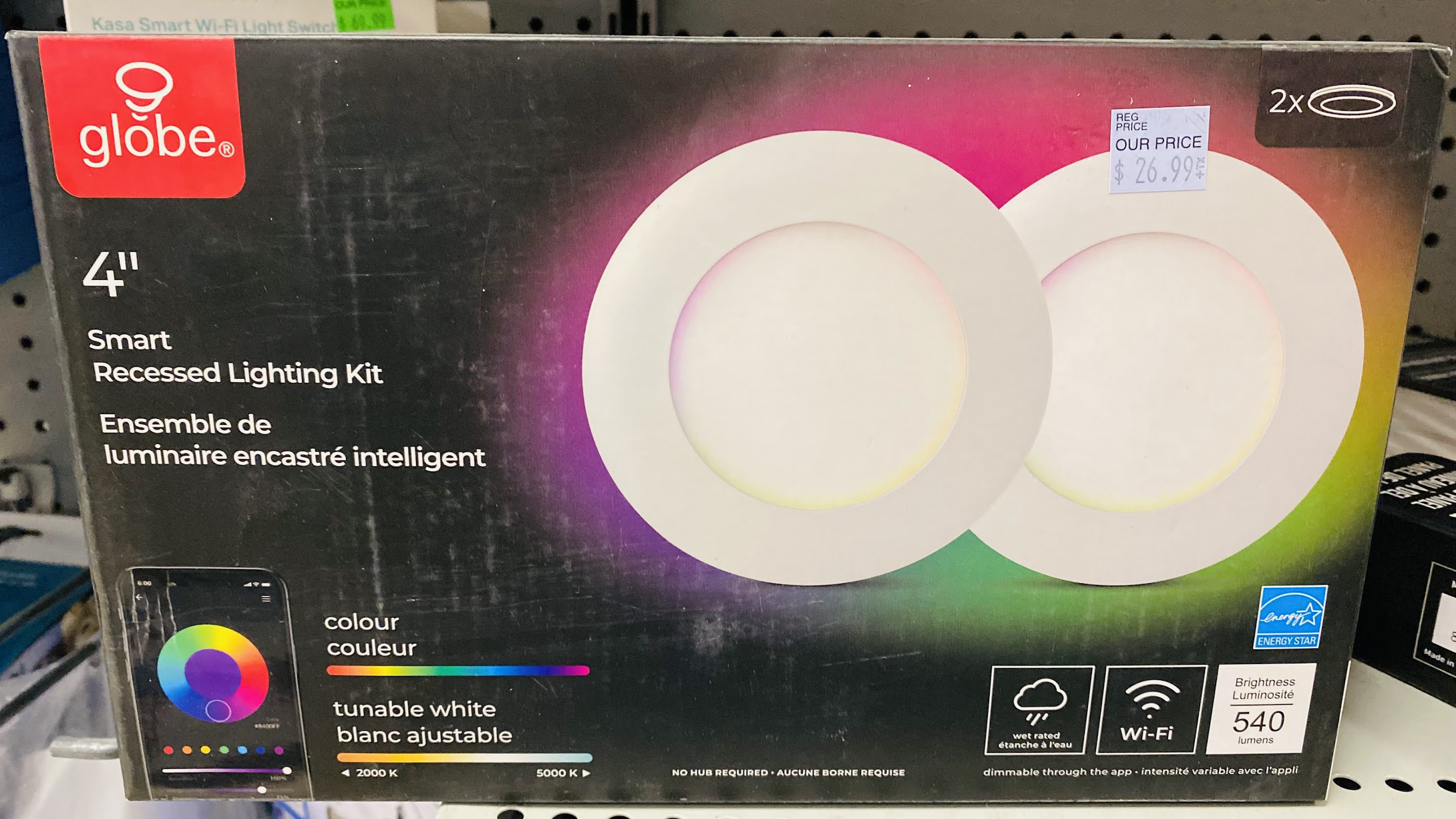

Globe 4" Smart Recessed Led Lighting Kit RGBCW ( WB2S - BK7231T ) - Teardown
- The Globe 4" Smart Recessed LED Lighting Kit RGBCW, internal part number 50323, supports RGB plus tunable white from 2000K to 5000K.
