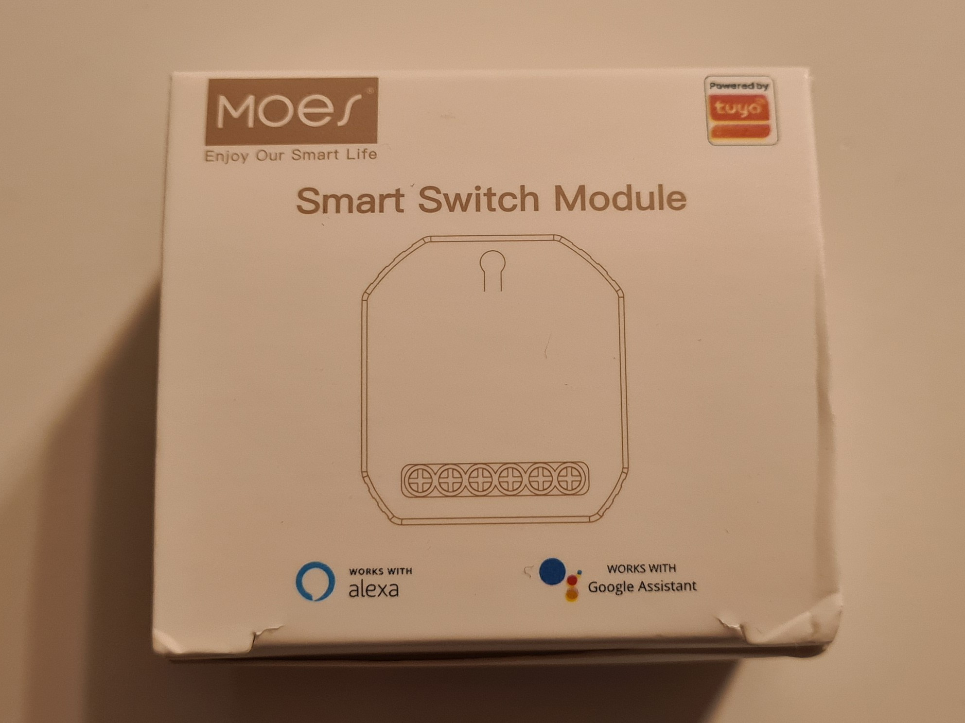

  • Moes Smart Switch Module MS-104 is a 1-gang WiFi smart switch module built around a Tuya CB2S (BK7231N) WiFi module.
  • The 1-gang board appears to share PCB design with the 2-gang version, while the 4-gang version uses different internals.
  • It supports 90 - 250V AC 50/60Hz input and up to 10A current.
  • Pin mapping identifies Pin23 as Button1, Pin24 as Relay1, and Pin26 as a PWM buzzer.
  • A solder blob between the CSN pad and adjacent cooling pad puts CB2S into programming mode, and hid_download_py flashed the latest release.
Module name: Moes Smart Switch Module MS-104
Protocol: WiFi 2,4GHz
Input Voltage: 90 - 250V AC 50/60Hz
Max Current: 10A
Wifi module: Tuya CB2S (BK7231N) datasheet
This is the 1 gang vesion of the module there is also a 2 gang version available (obviously with the same PCB based on tear-down).
Bought it on aliexpress from MOES Online store. It has also Zigbee, Zigbee+RF, WiFi+RF versions.
4 gang version has different internals, see tear-down in other topic: Link
Flashed latest release with python flasher: hid_download_py
Pictures of the module:
Tear-down of the module:
Pin config:
Pin23: Button1
Pin24: Relay1
Pin26: Buzzer (works as PWM)
Edit:
One easy way I have found to put CB2S into programming mode to put a solder blob between CSN pad and the cooling pad next to it to ground it:
