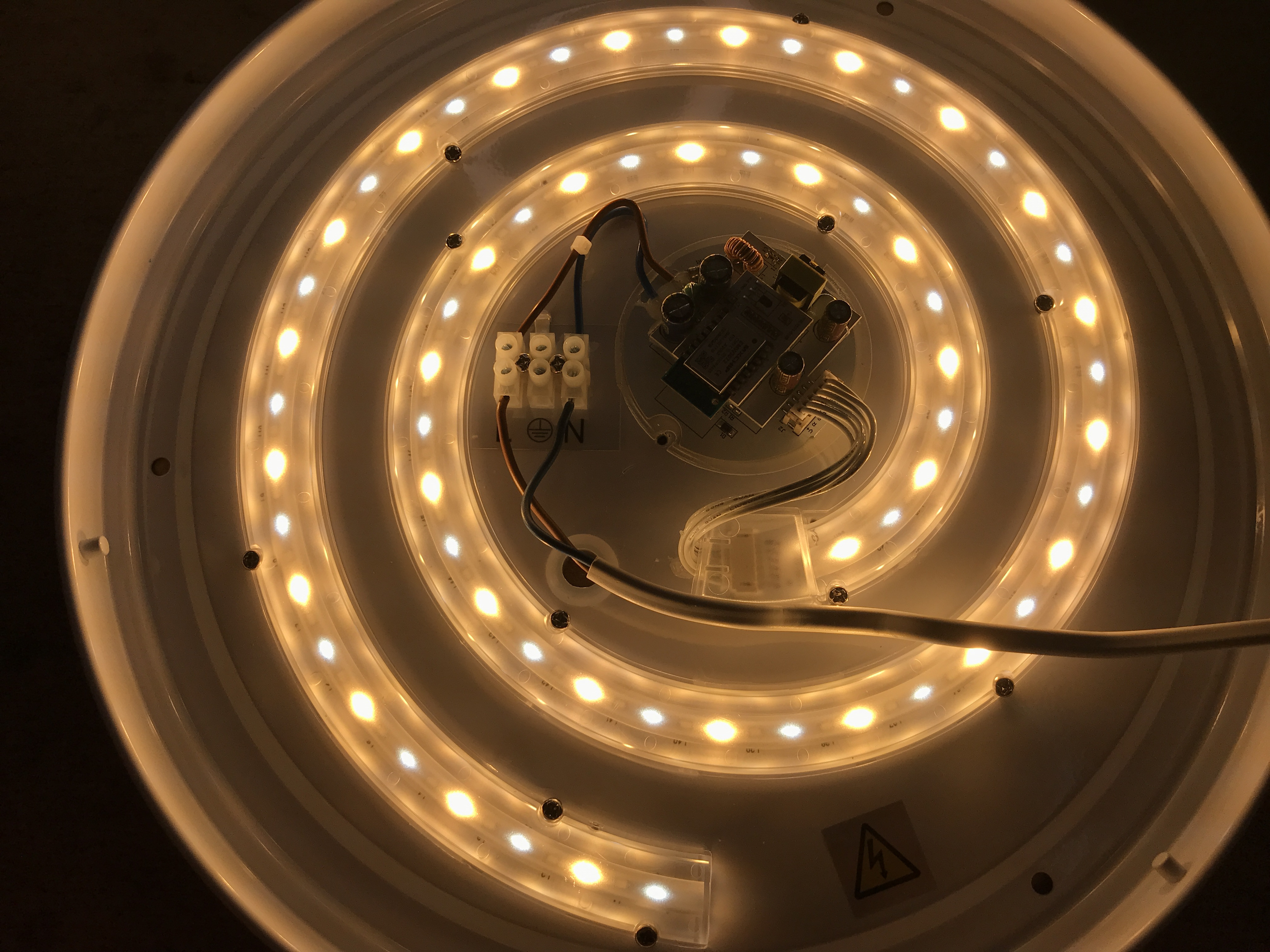

Ok, the LEDs are arranged in a spiral.
What`s inside the LED controller?
Module MXCHIP EMW3072 . Not a very pleasant surprise. It is not supported by OpenBeken or any open source software. We won`t free this lamp from the cloud. You might need to desolder the entire module and solder in e.g. ESP12E, if the pads fit.
