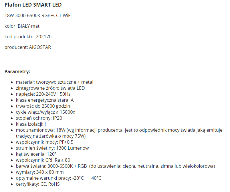

    Parameters:
    Plafon RGBCW na MXCHIP EMW3072 - Aigostar Smart 18872 18W RGB+CCT
    I don`t see any information about the Tuya app here, do I need to download the Aigostar app? This is the first minus!

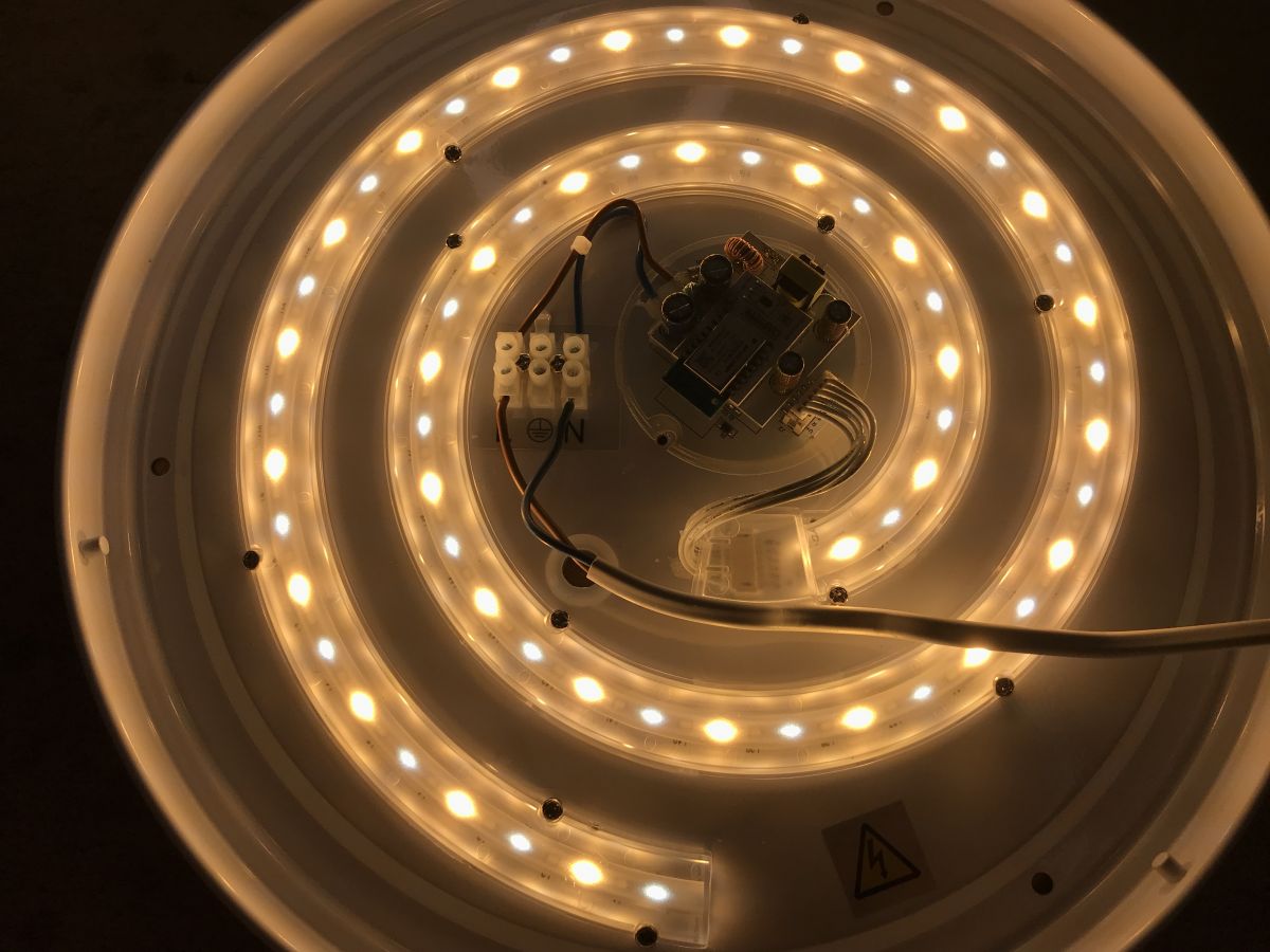

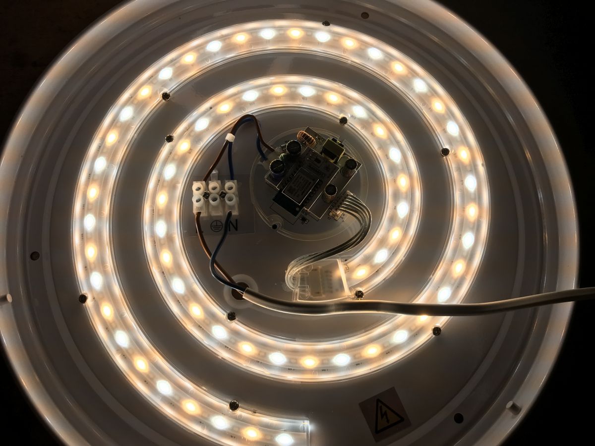

    Set in practice, interior

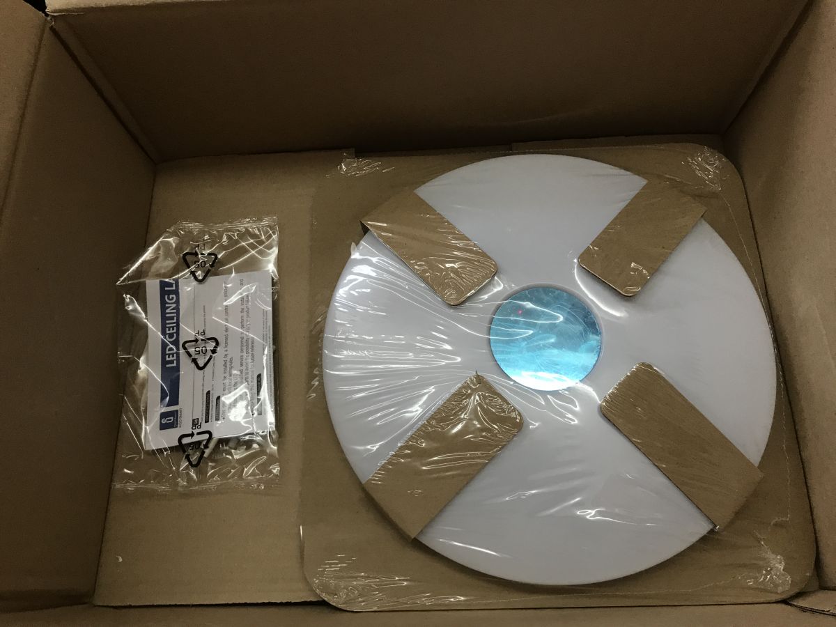

    Let`s see what we get.
    Plafon RGBCW na MXCHIP EMW3072 - Aigostar Smart 18872 18W RGB+CCT Plafon RGBCW na MXCHIP EMW3072 - Aigostar Smart 18872 18W RGB+CCT Plafon RGBCW na MXCHIP EMW3072 - Aigostar Smart 18872 18W RGB+CCT Plafon RGBCW na MXCHIP EMW3072 - Aigostar Smart 18872 18W RGB+CCT Plafon RGBCW na MXCHIP EMW3072 - Aigostar Smart 18872 18W RGB+CCT

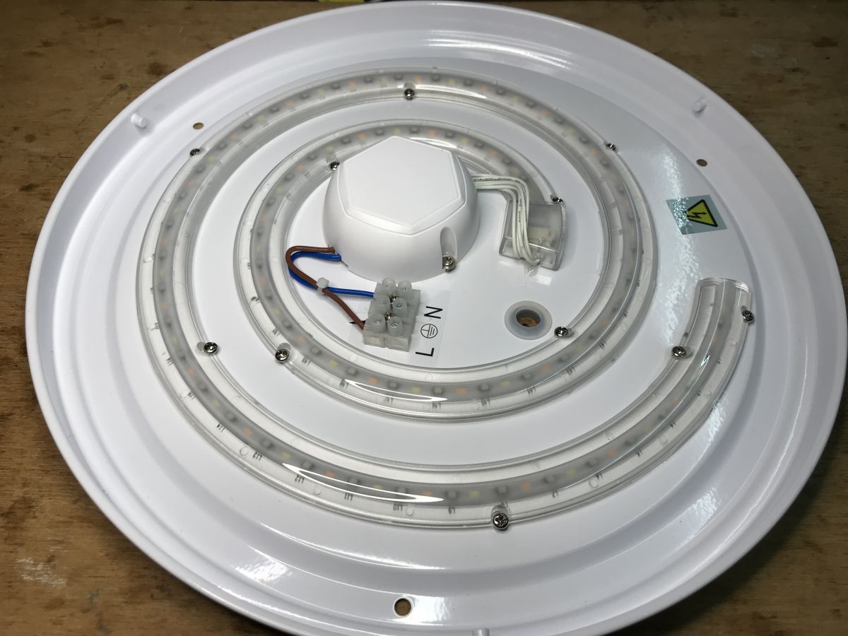

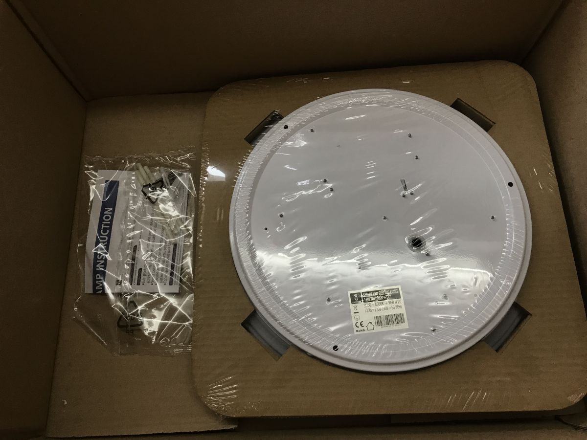

    Looks ok, well packaged... there are mounting pins.
    Remove the cover (just twist slightly):

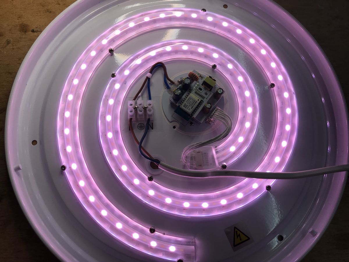

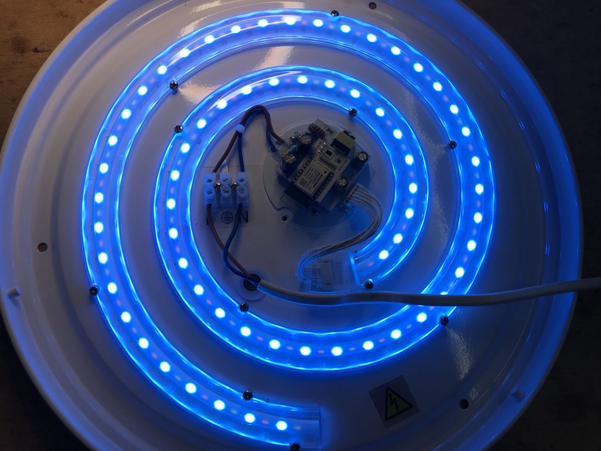

    Ok, the LEDs are arranged in a spiral.

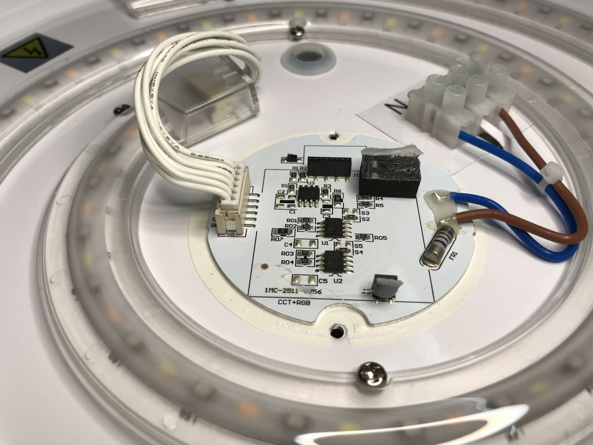

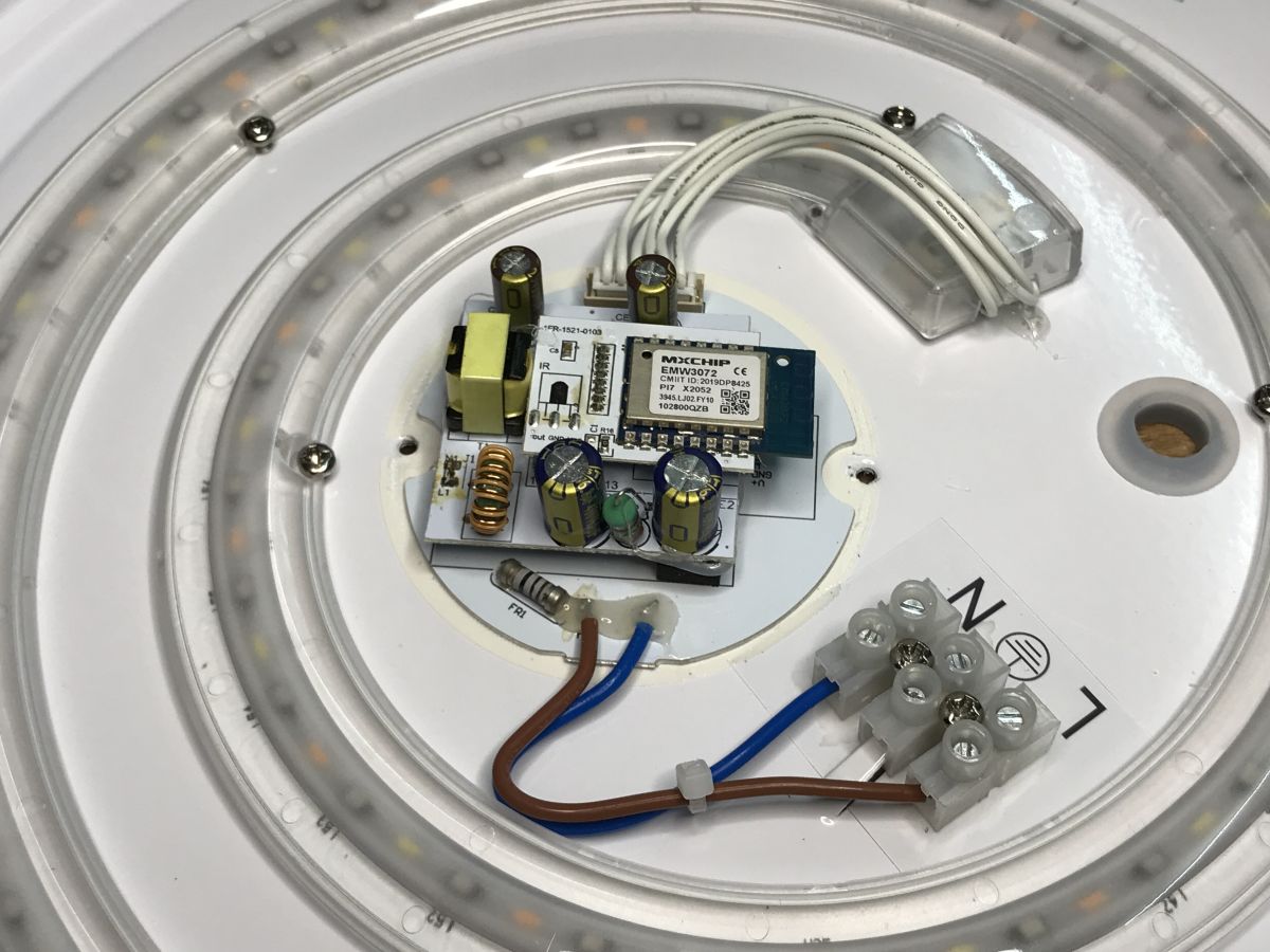

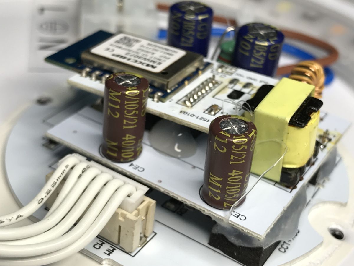

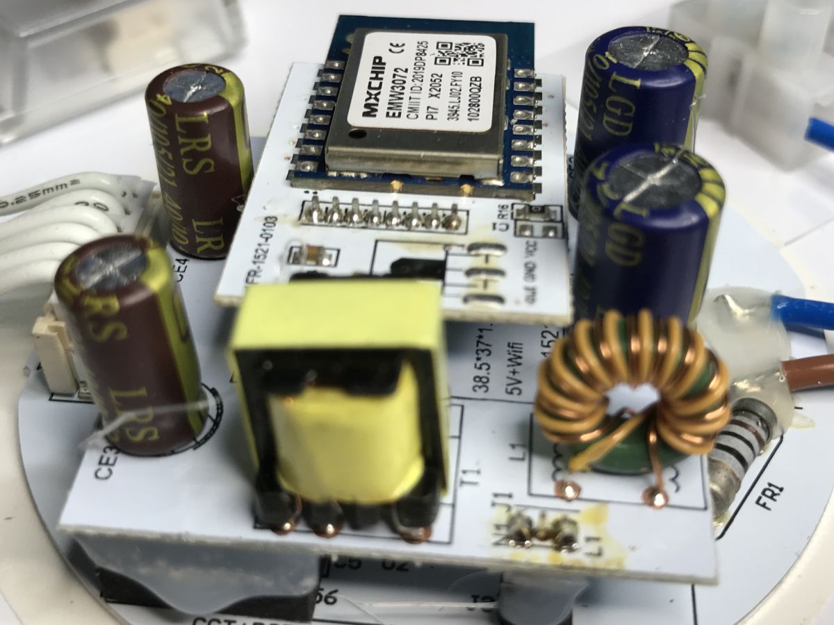

    What`s inside the LED controller?

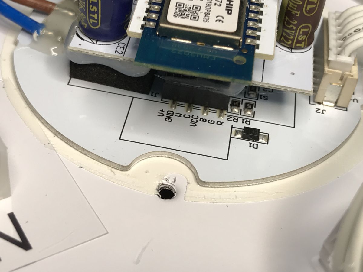

    Module MXCHIP EMW3072 . Not a very pleasant surprise. It is not supported by OpenBeken or any open source software. We won`t free this lamp from the cloud. You might need to desolder the entire module and solder in e.g. ESP12E, if the pads fit.

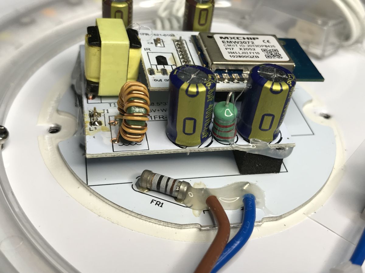

    However, we can still see the layout:

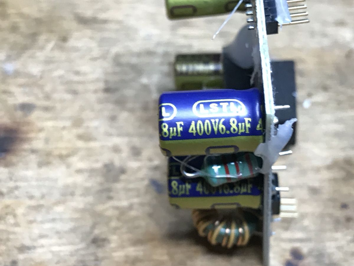

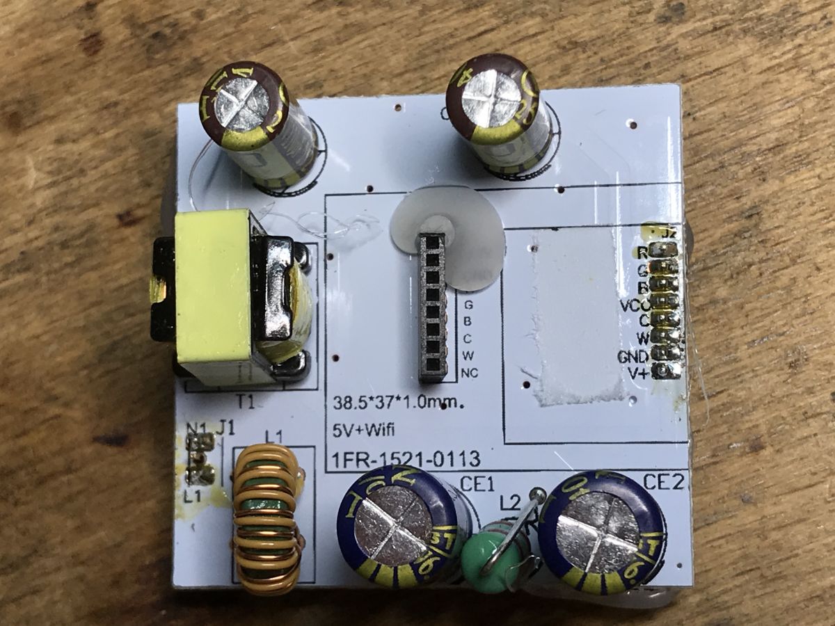

    Fuse resistor, filter with two electrolytic capacitors and choke...
    Coil, view of connected PCBs via pin connectors:
    Connector for LEDs, labeled CW, WW cables, etc.:
    I investigated the roles of the WiFi module outputs. Here are which pins control the colors:
    WiFi module motherboard:
    LSTI capacitors?

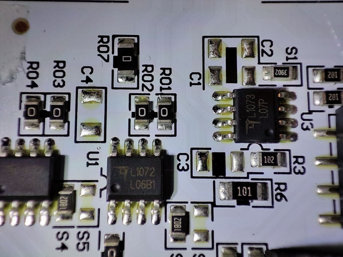

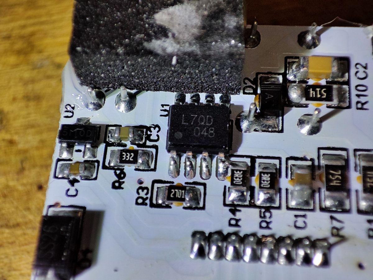

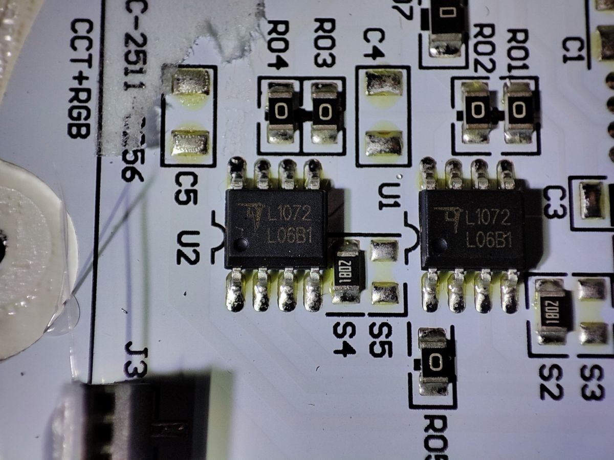

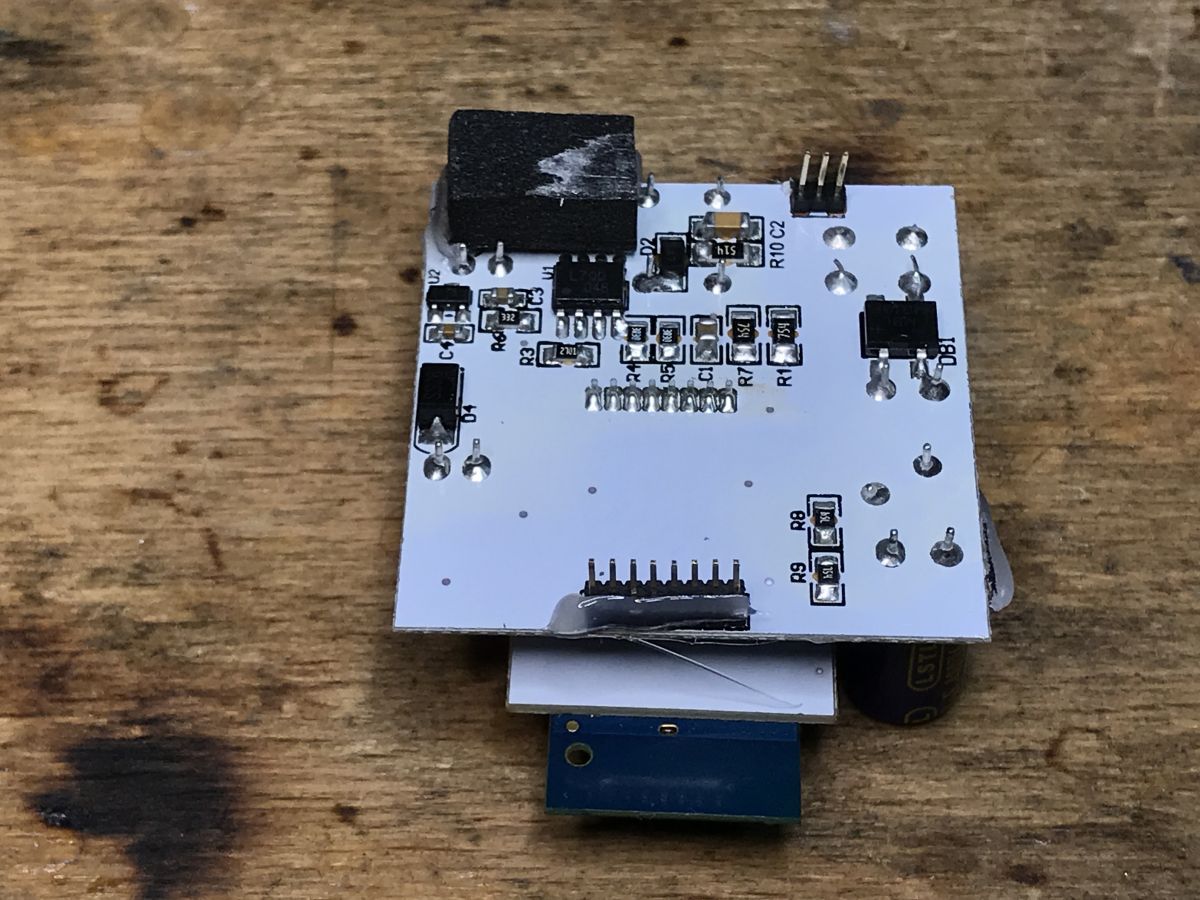

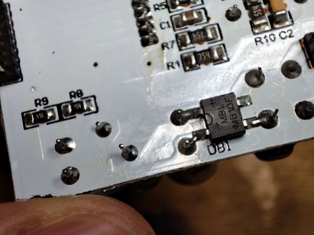

    Bottom of the PCB, LED driver board:
    The LEDs are controlled by several L1072s:
    There is also L1073. Unfortunately, I did not find a catalog note for these elements and I did not perform a longer PCB analysis.

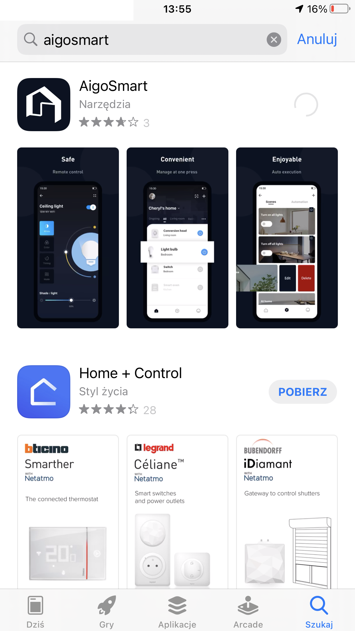

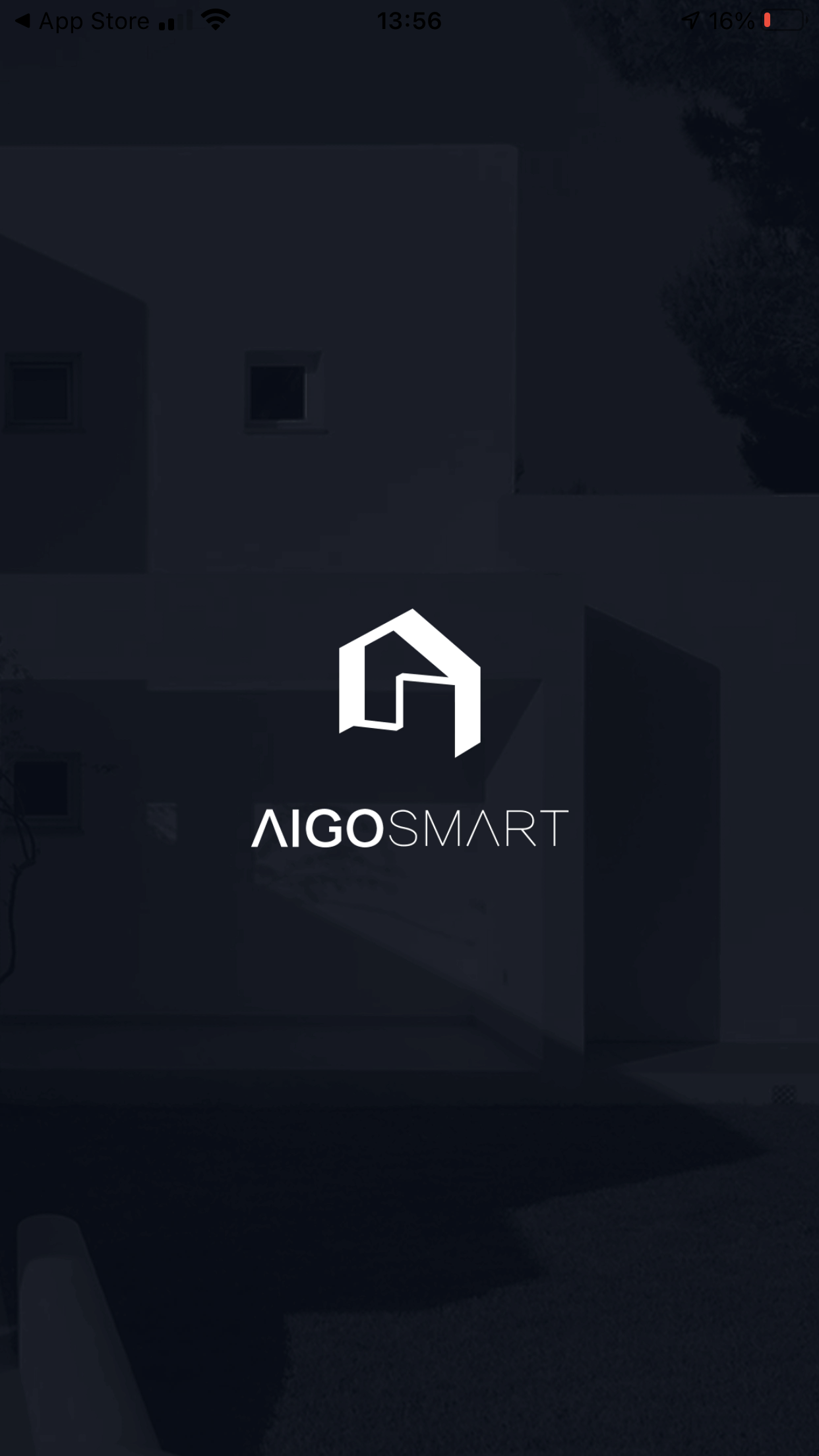

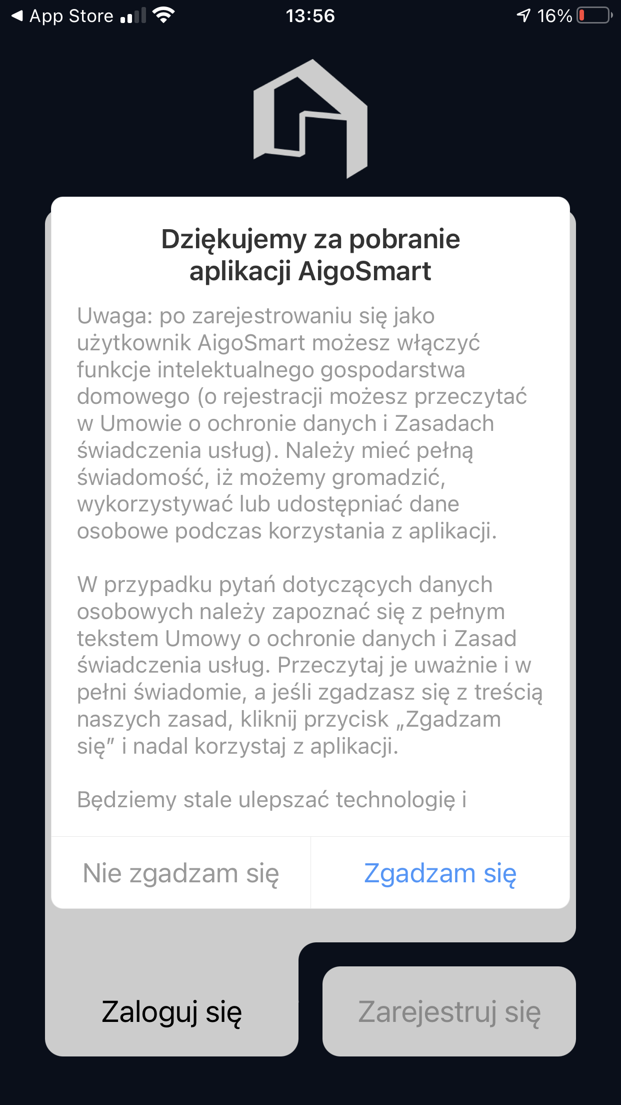

    Producer`s application, effects

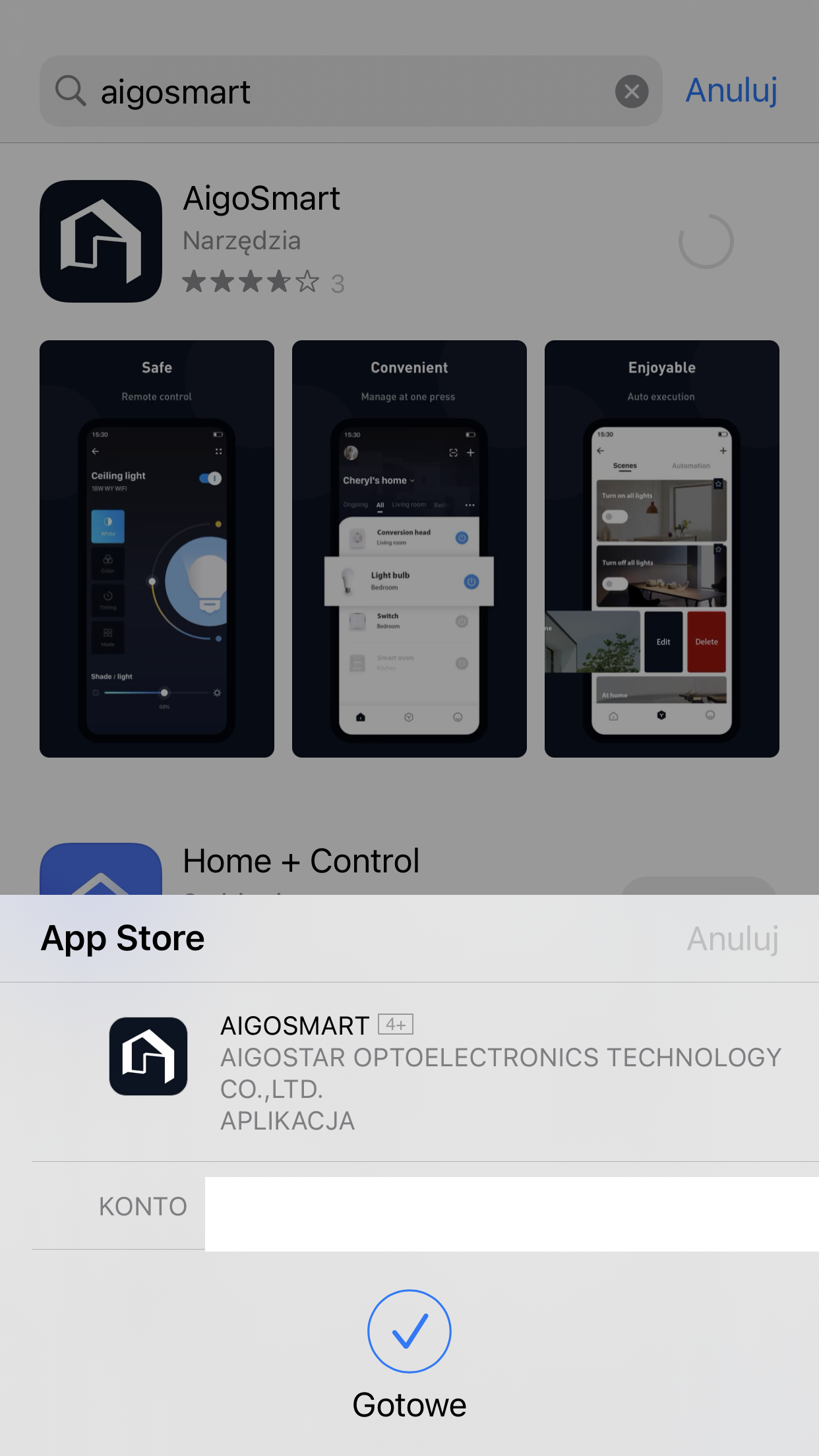

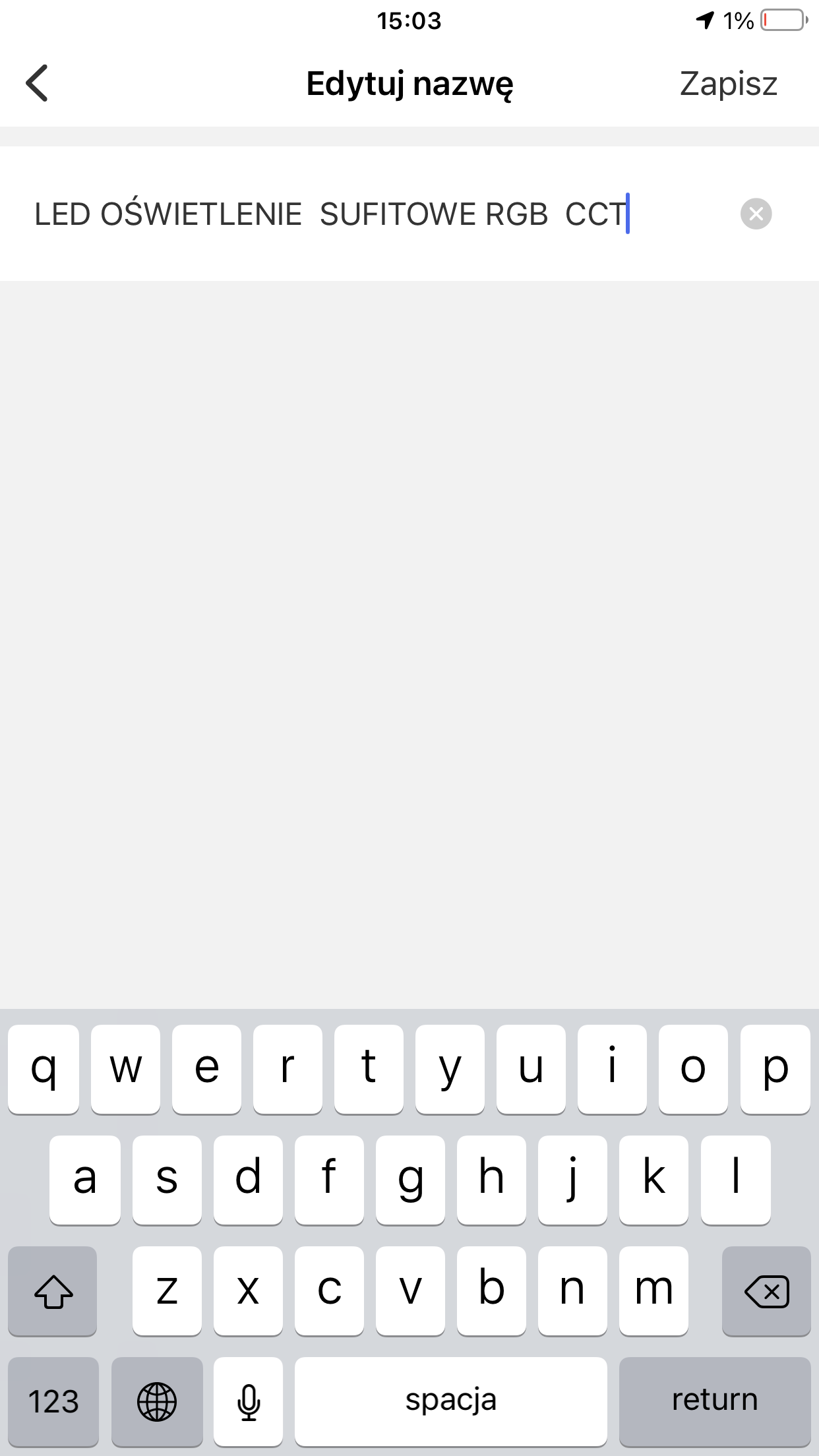

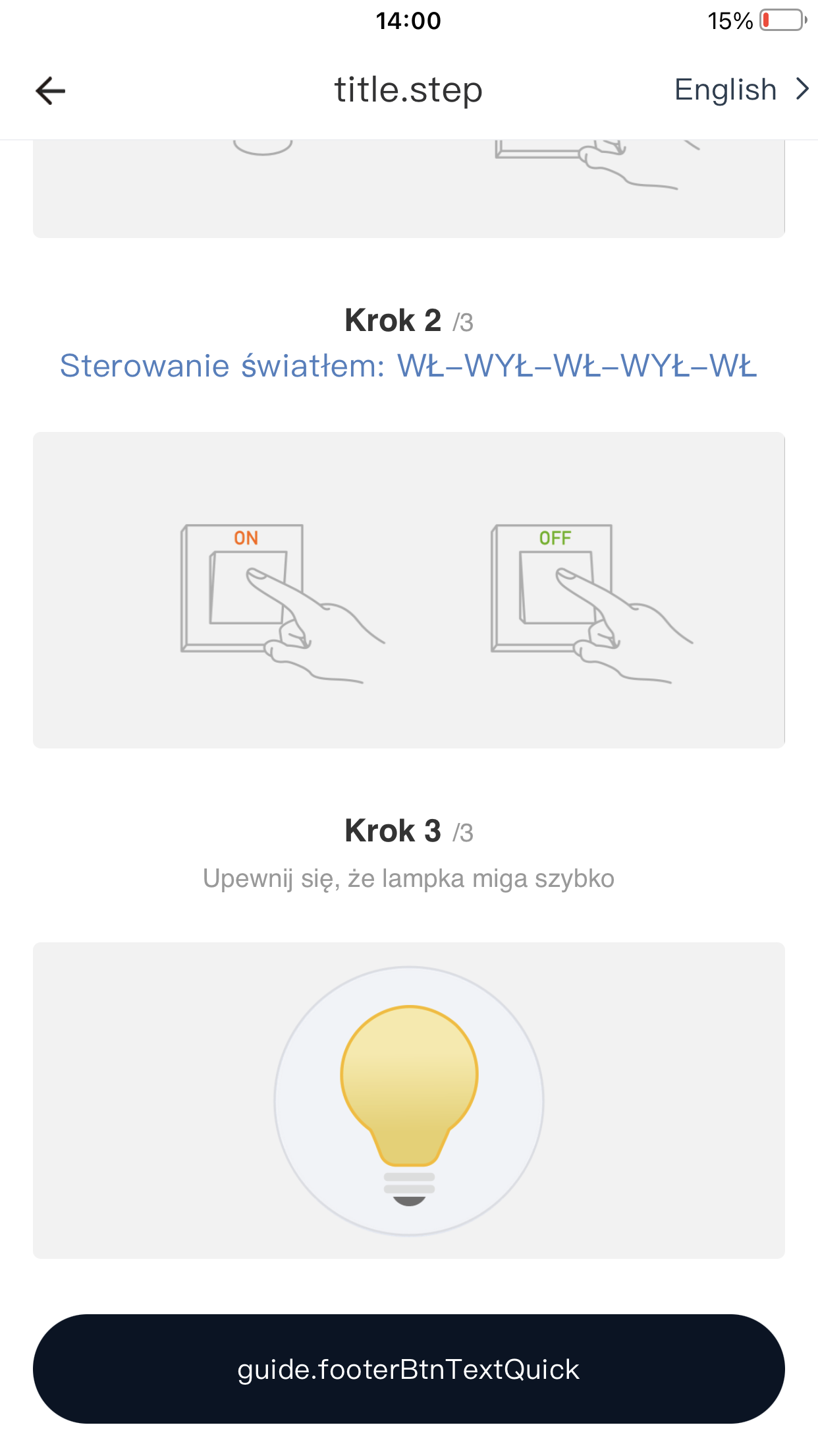

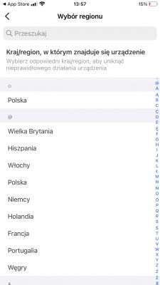

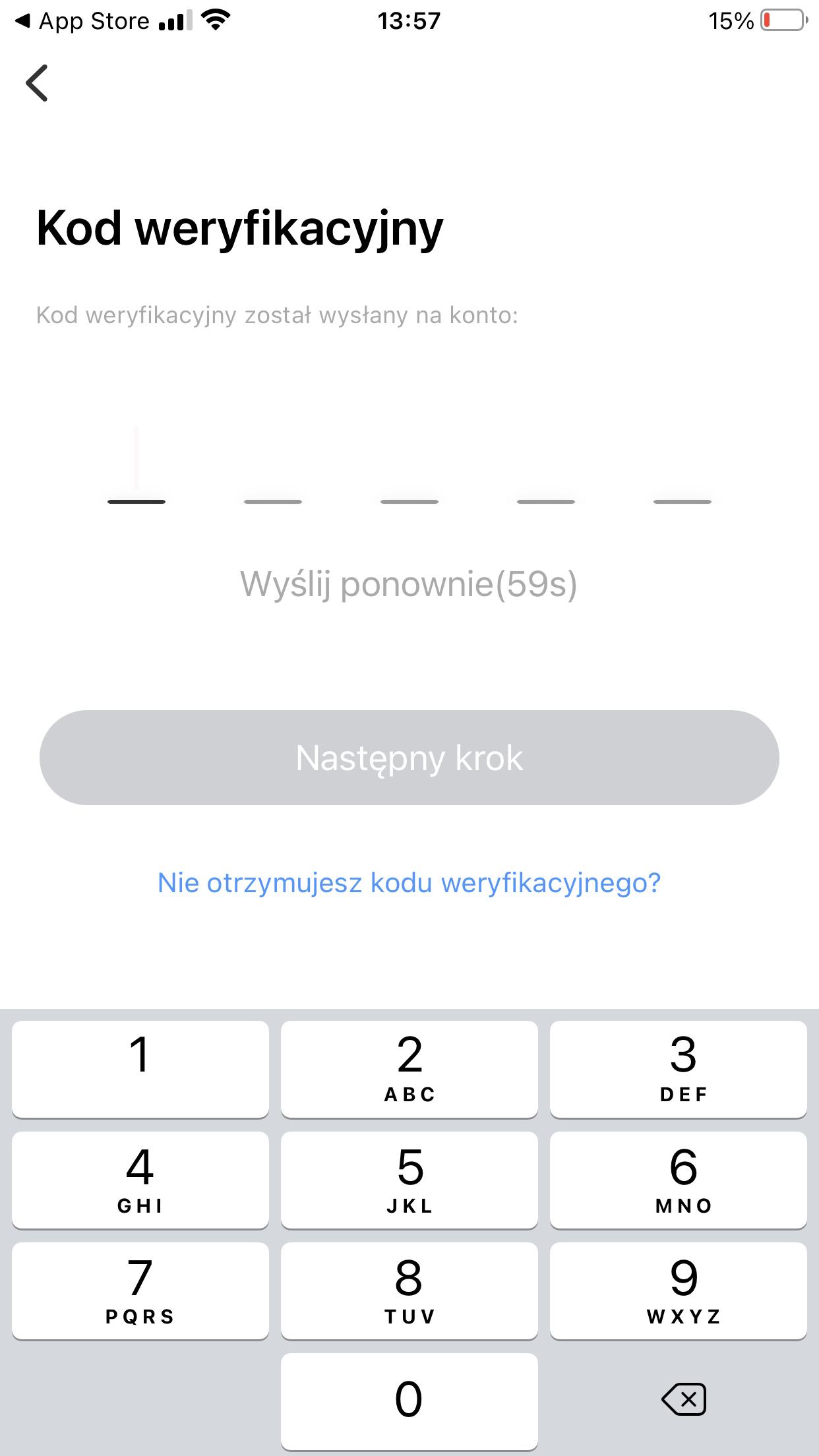

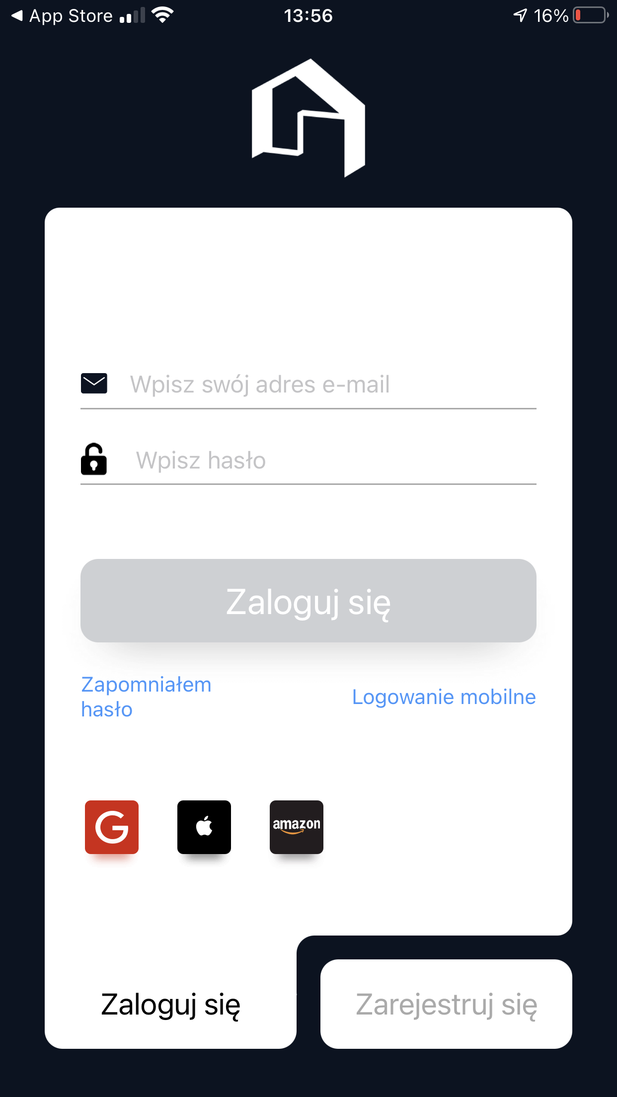

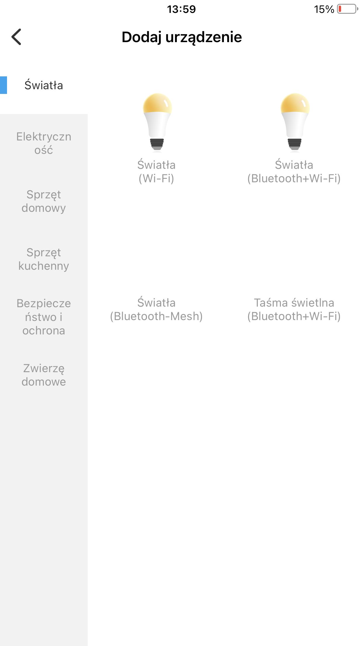

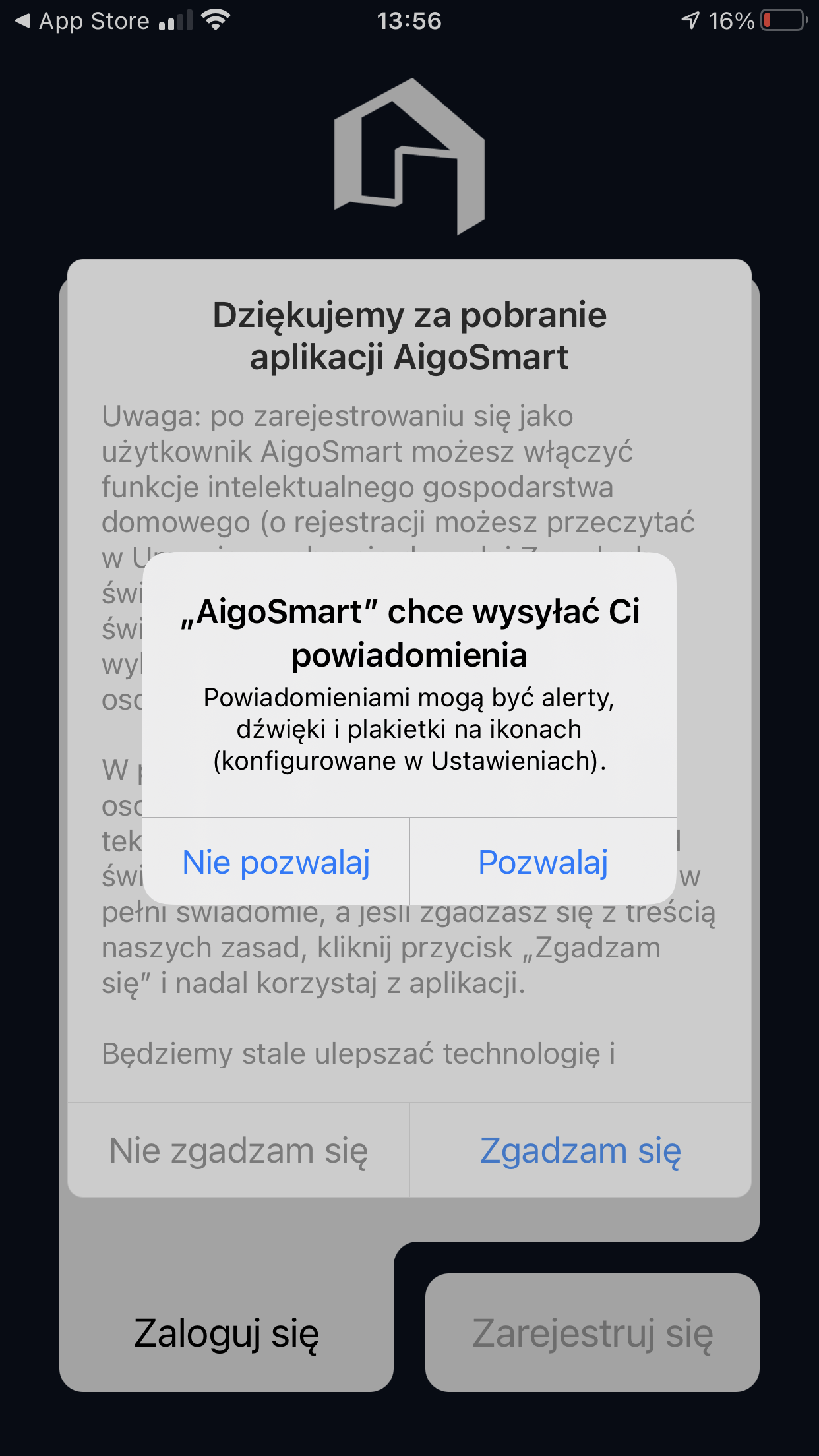

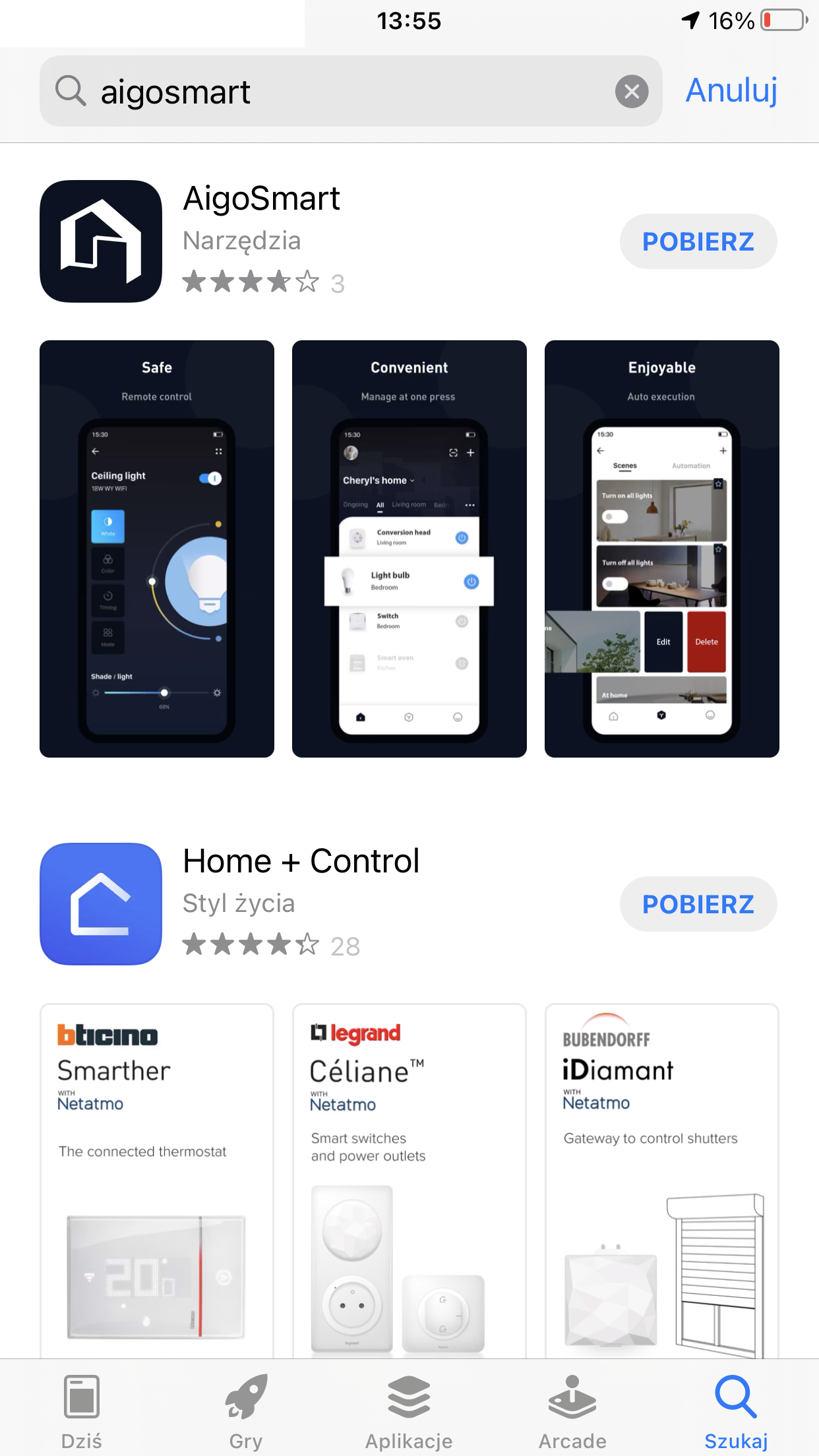

    I also tried pairing the device with the Tuya app. Unfortunately this is not possible. You need to download Aigoo:

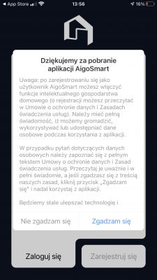

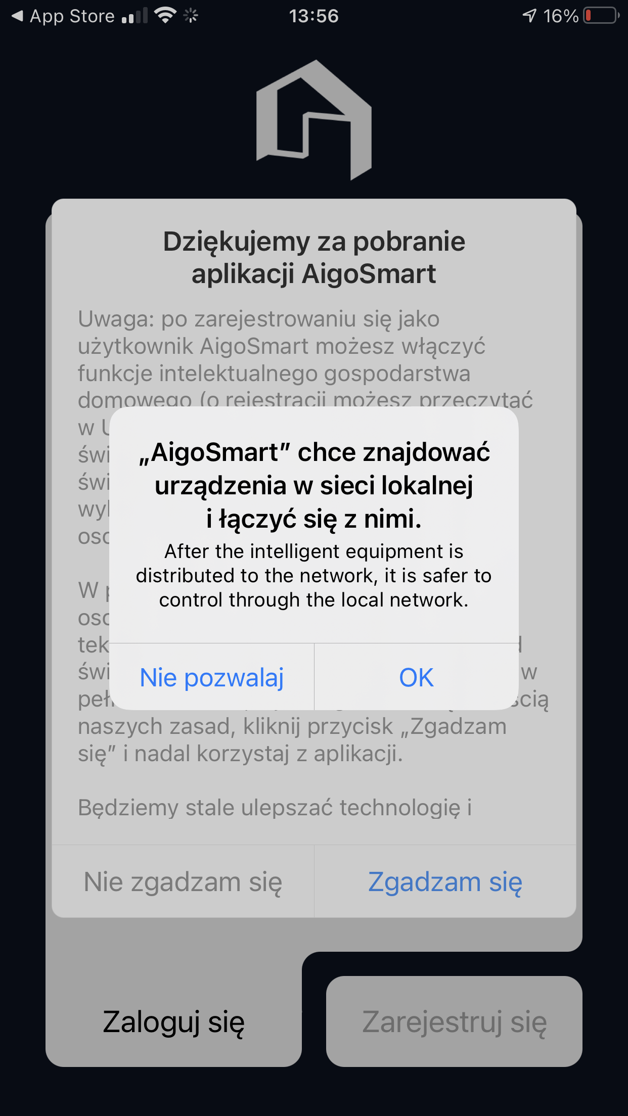

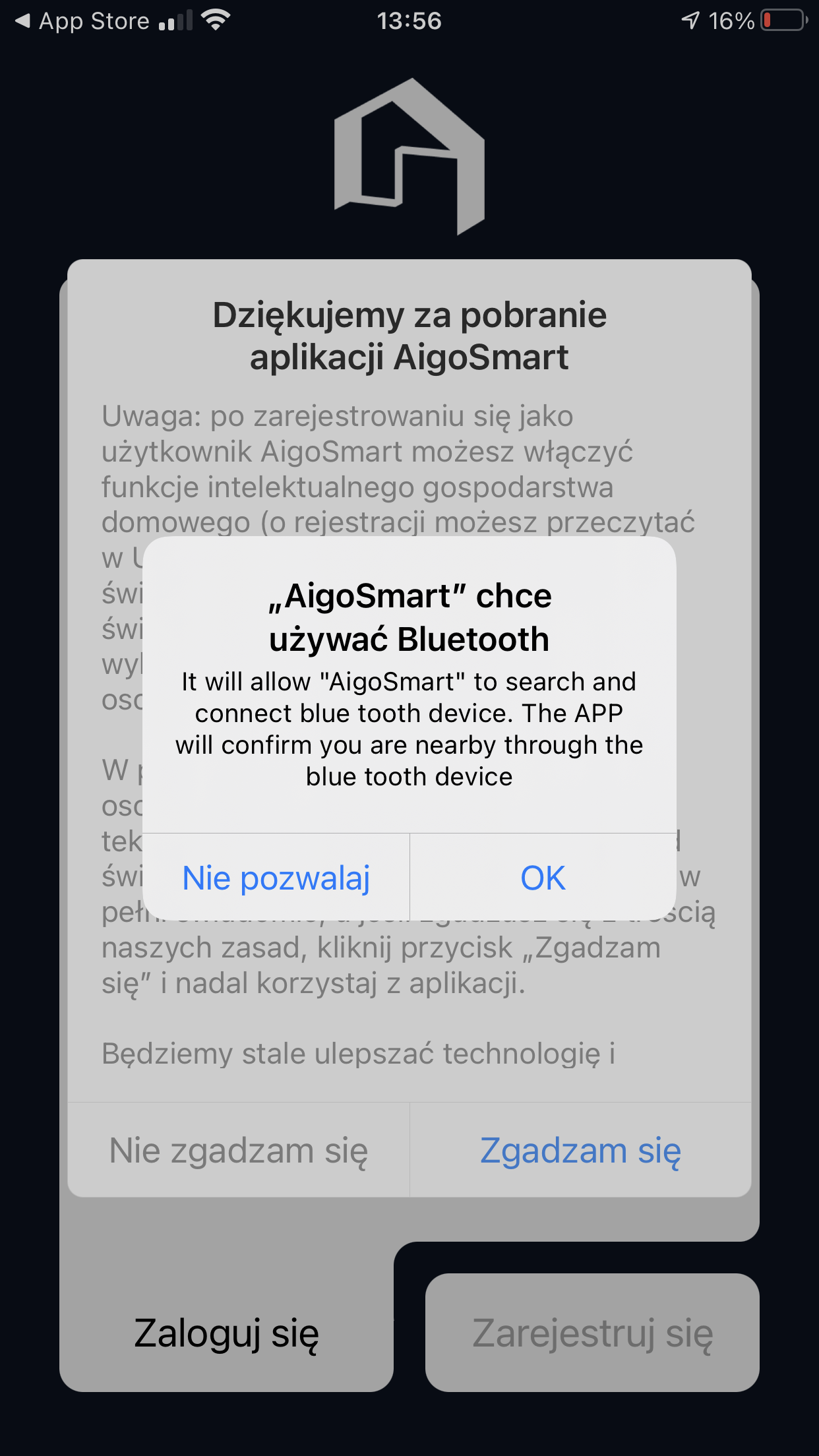

    Of course, the app requires a lot of permissions, including location and BT:

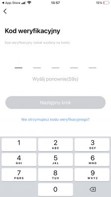

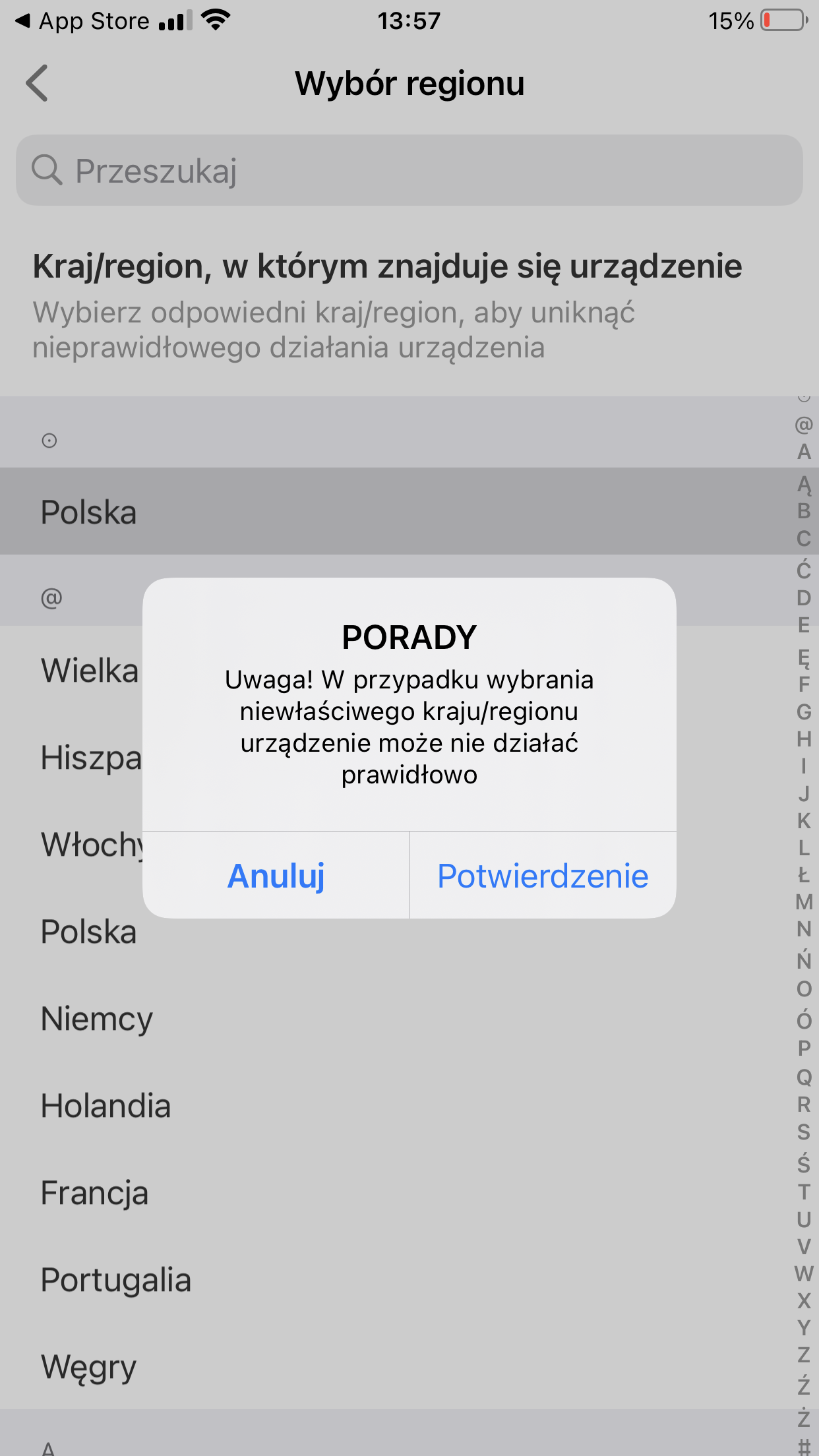

    And you need to register:

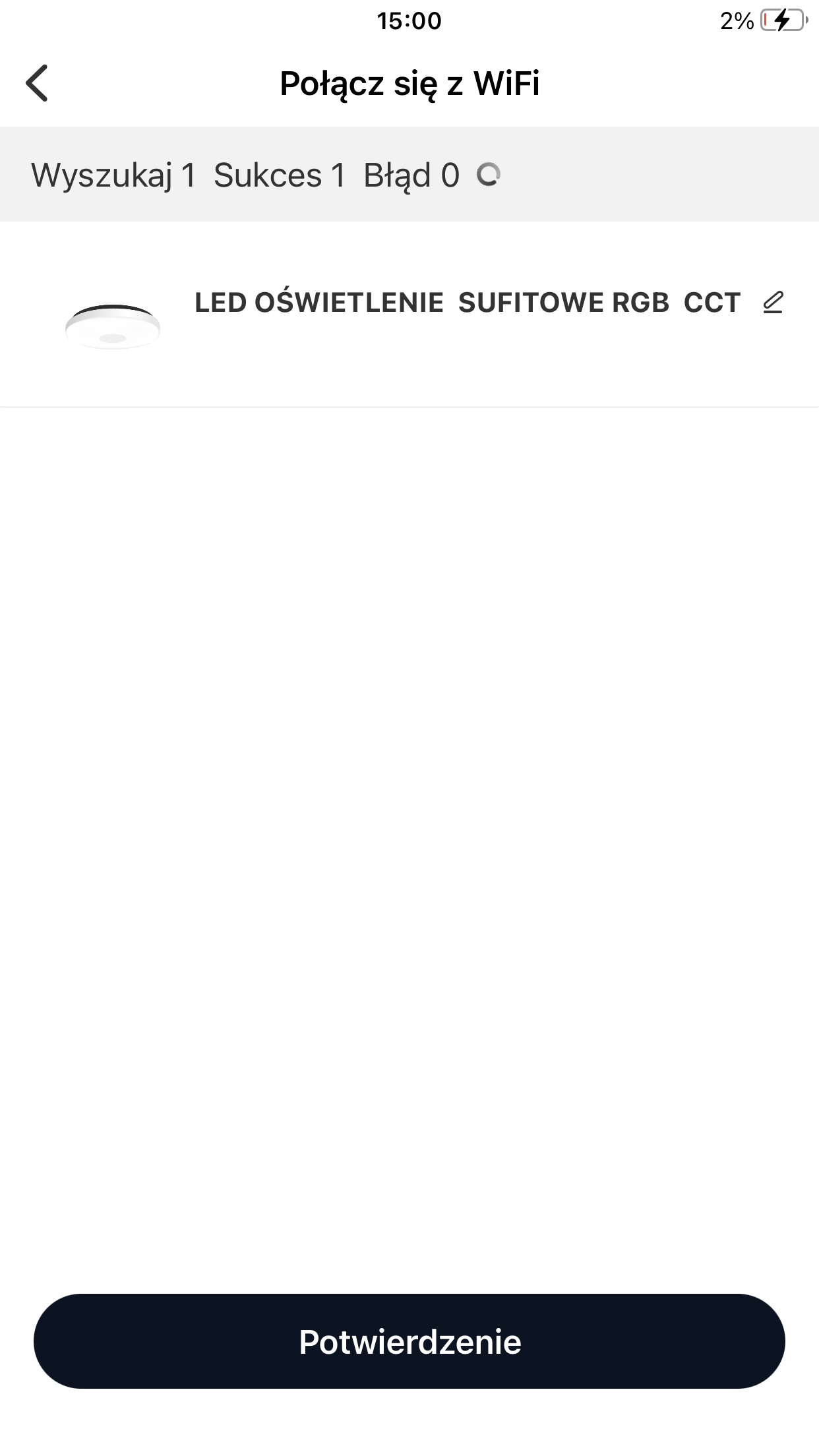

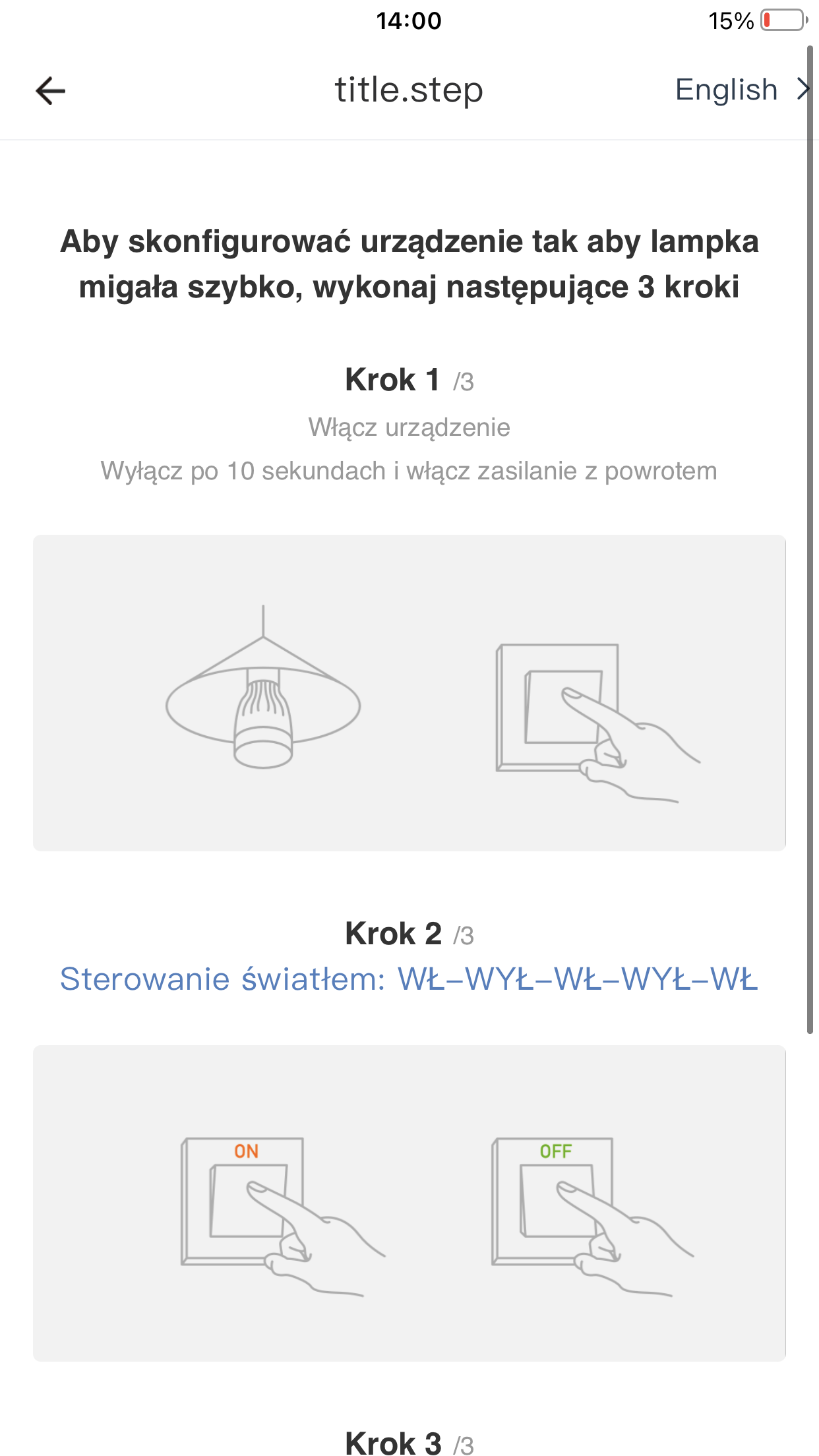

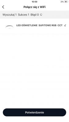

    Pairing... unfortunately is not fully translated. Again. The buttons have names like "guide.footerBtnTextQuick" and the header is "title.step":

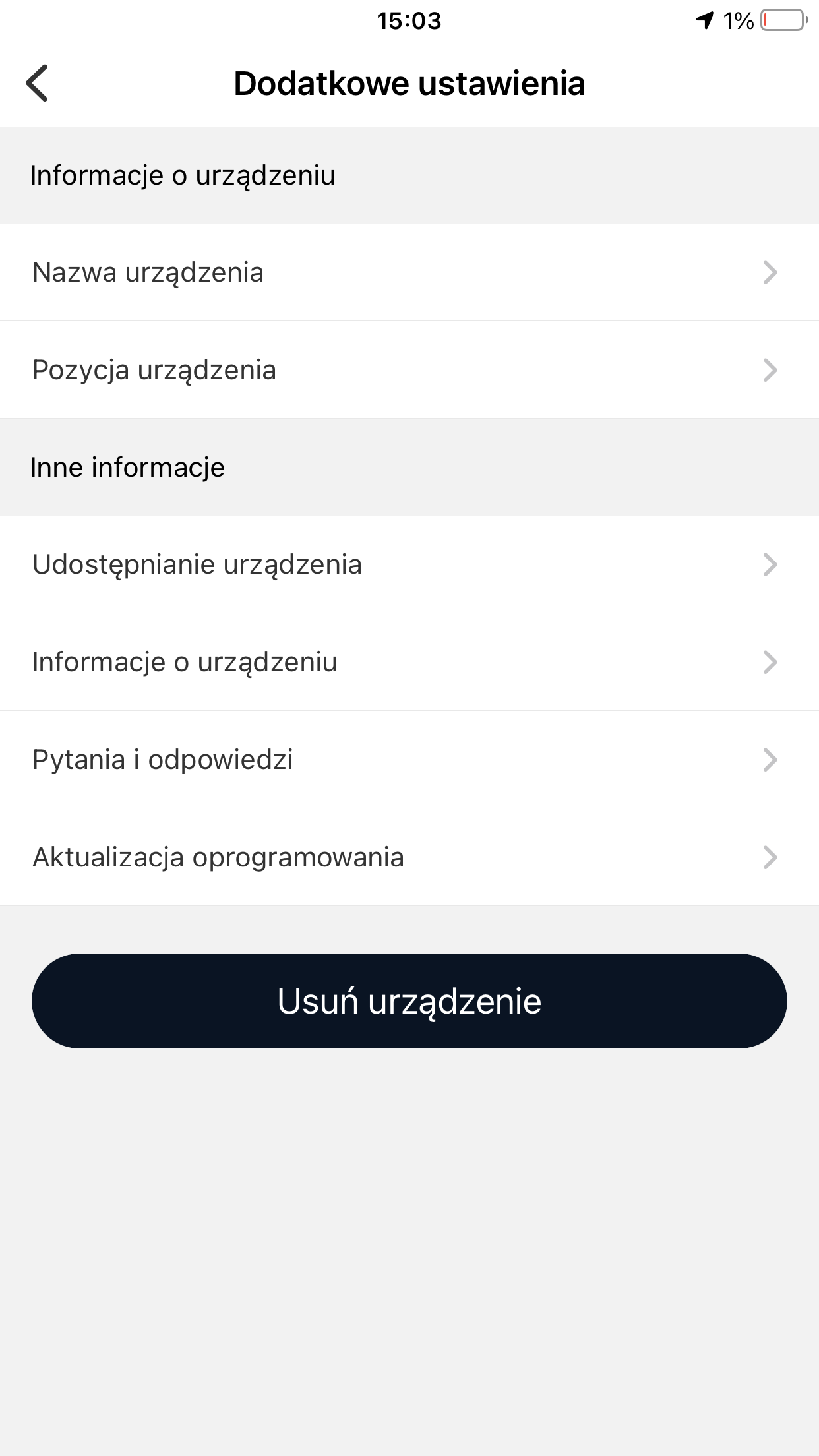

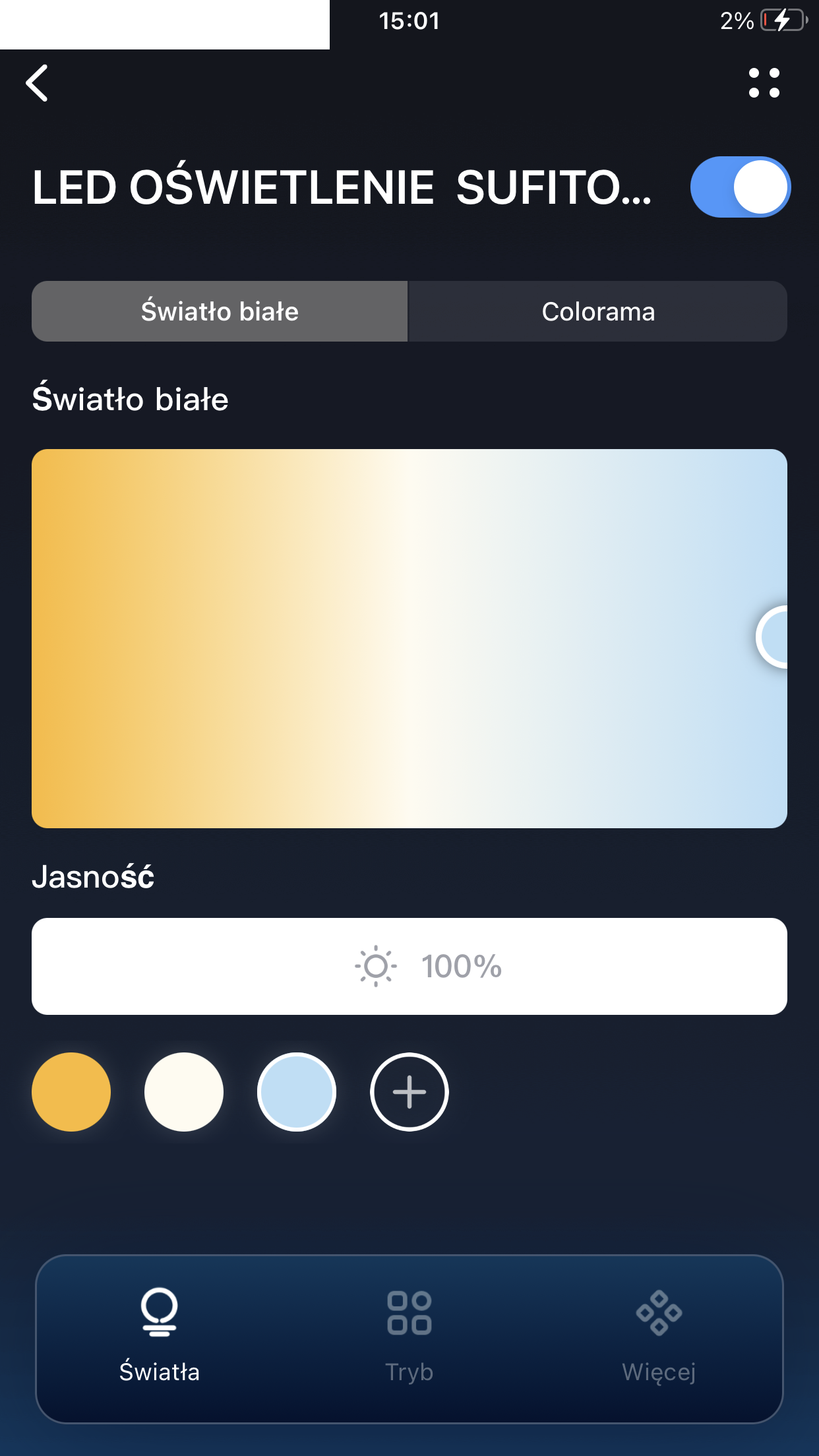

    Finally it worked, this is what the lamp control looks like:
    Effects:
    App possibilities? Rather standard...

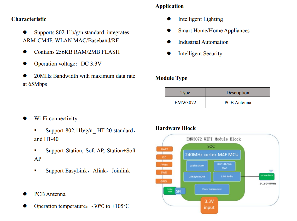

    MXCHIP EMW3072
    Here is another Chinese WiFi module. I haven`t seen one like this before. 2MB Flash, 256KB RAM, 240MHz Cortex M4F. 3.3V power supply. No Bluetooth.

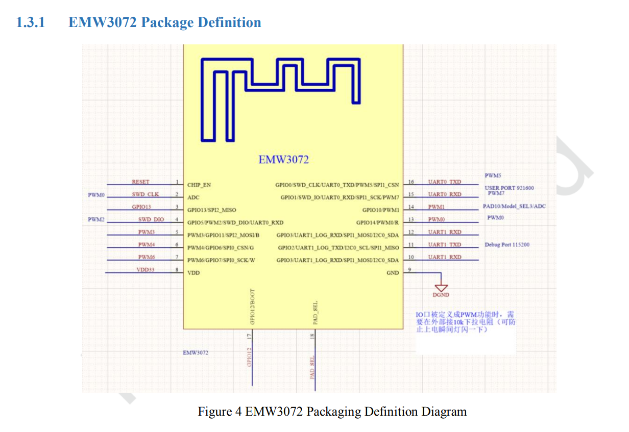

    Pinouts:

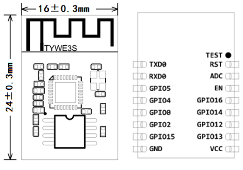

    Reminds ESP12 and WB3S/CB3S/TYWE3S. However, the description is probably incorrect, because e.g. UART1_RXD is repeated twice.
    This is what TYWE3S looks like:

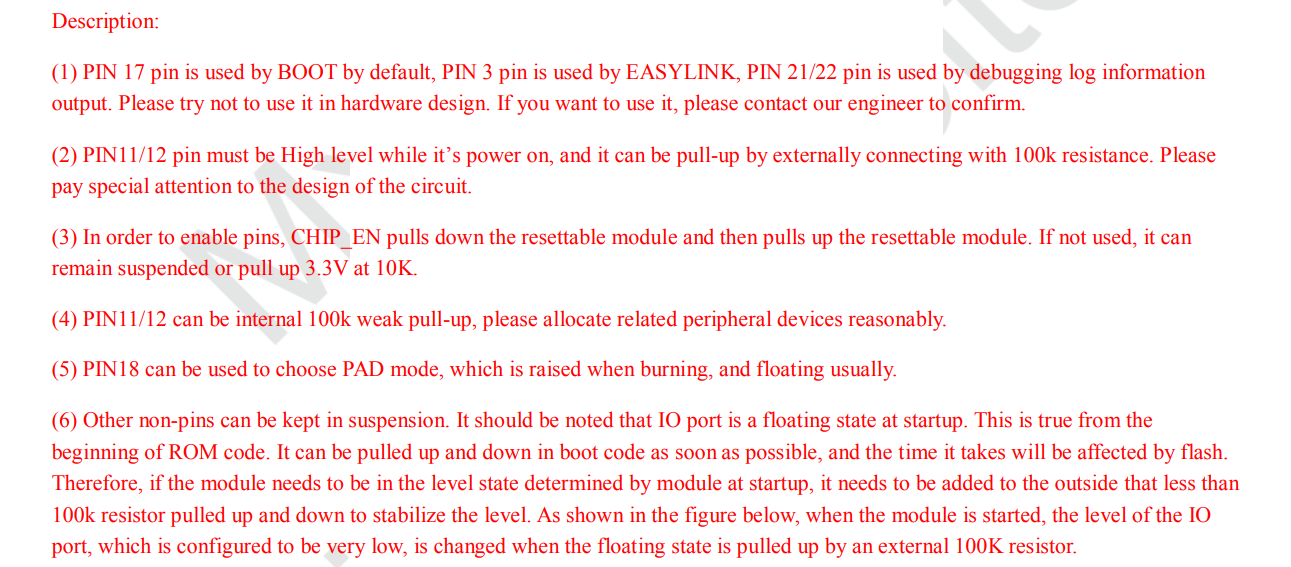

    There is some information about the bootloader in the note, pin 17 is BOOT?
    The PWM locations match those in the BK7231, but e.g. the EN pin does not (in EMW there is GPIO13 there).

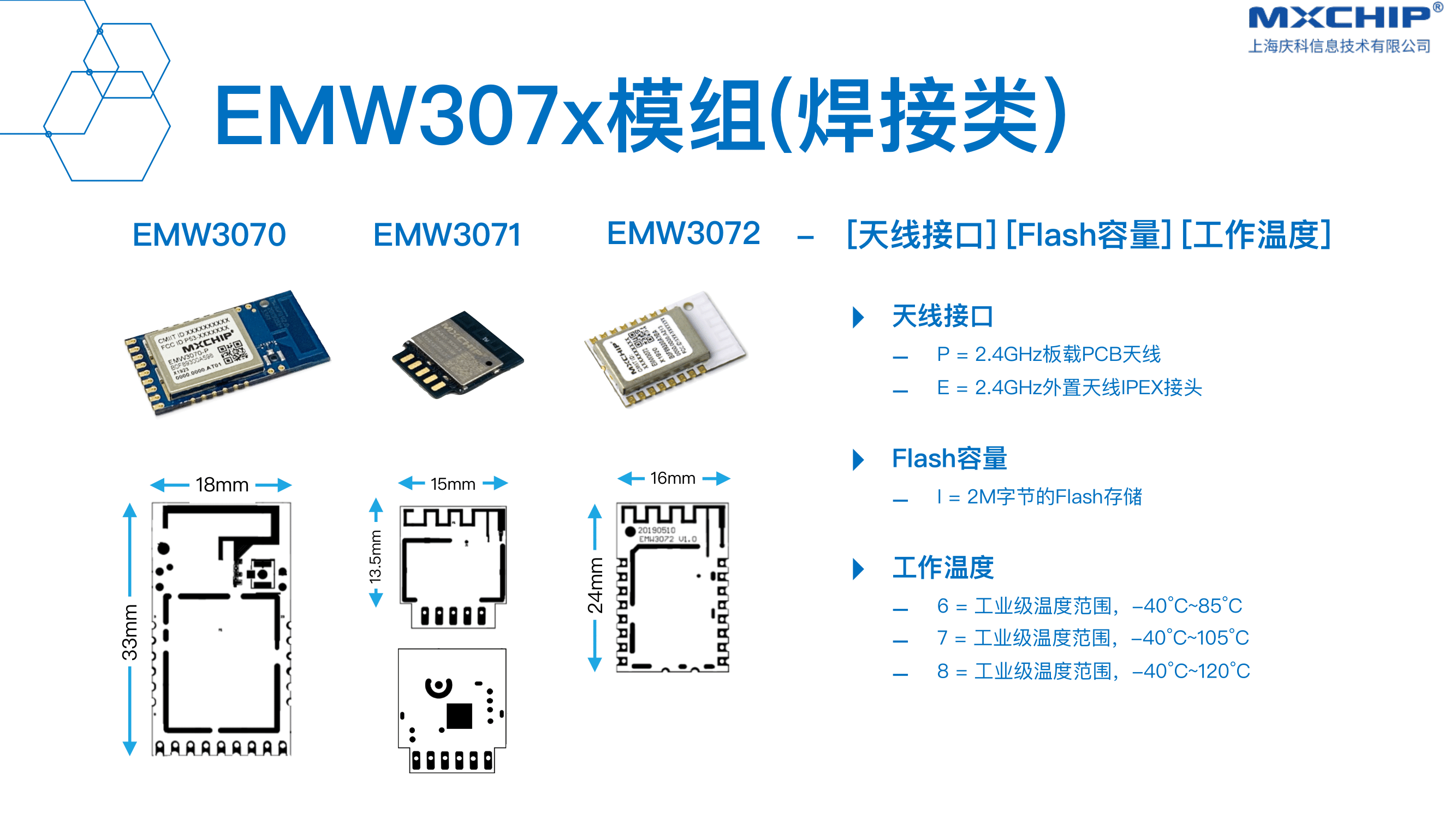

    I also managed to find a detailed presentation about this system (EMW307x family):

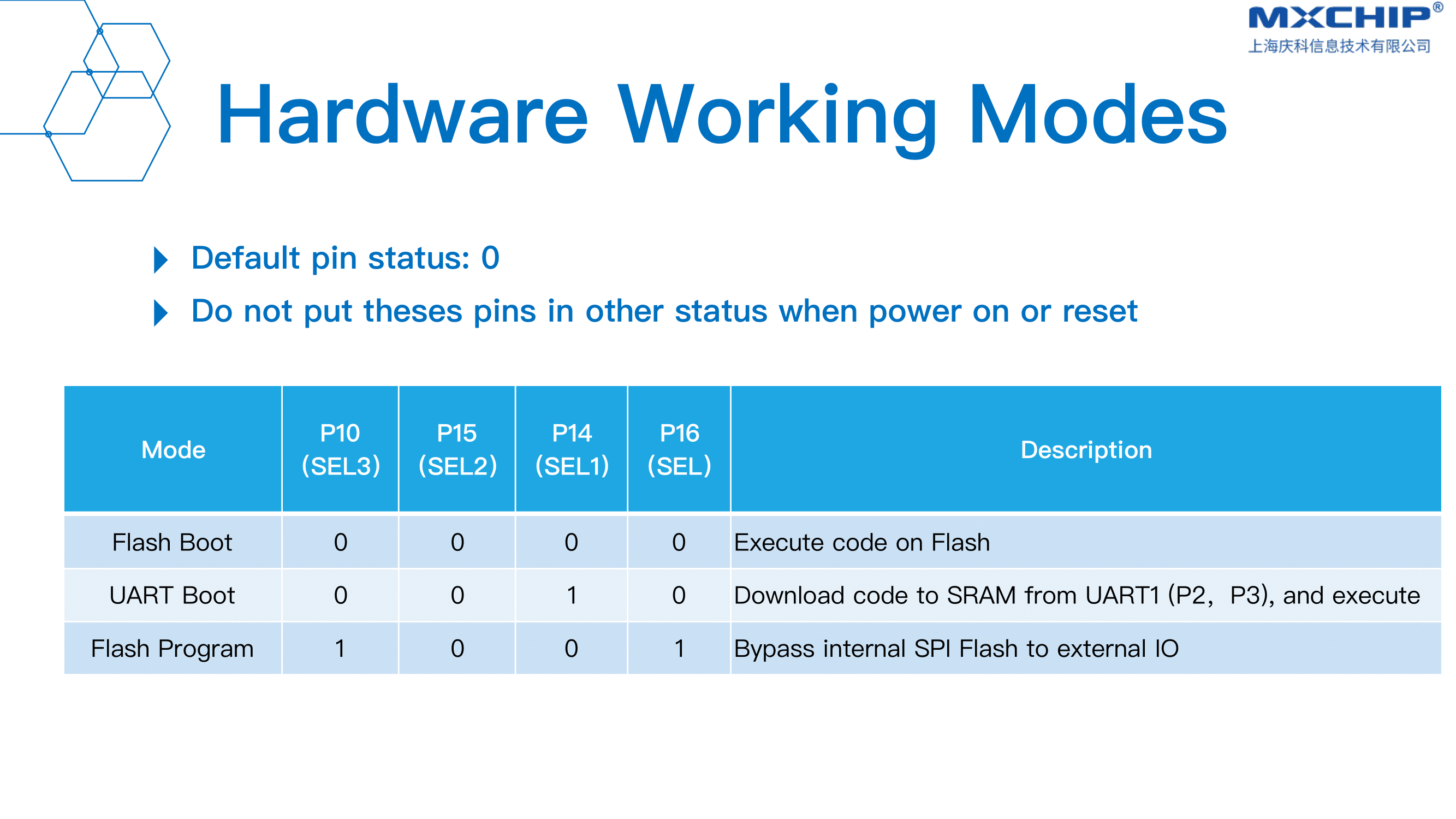

    So here we have EMW3070, EMW3071 and EMW3072.

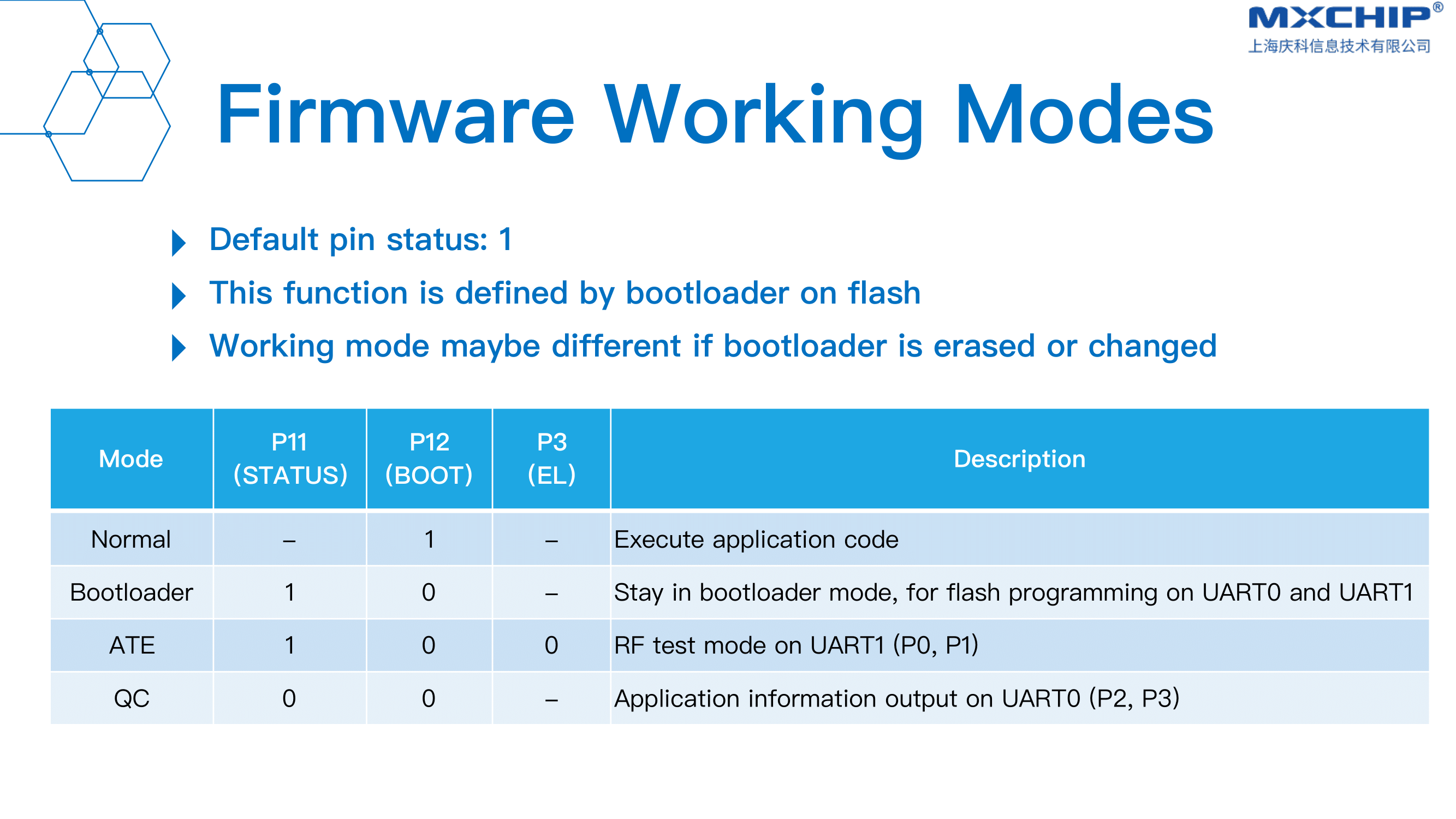

    The states on the SEL pins set the operating mode (e.g. bootloader):

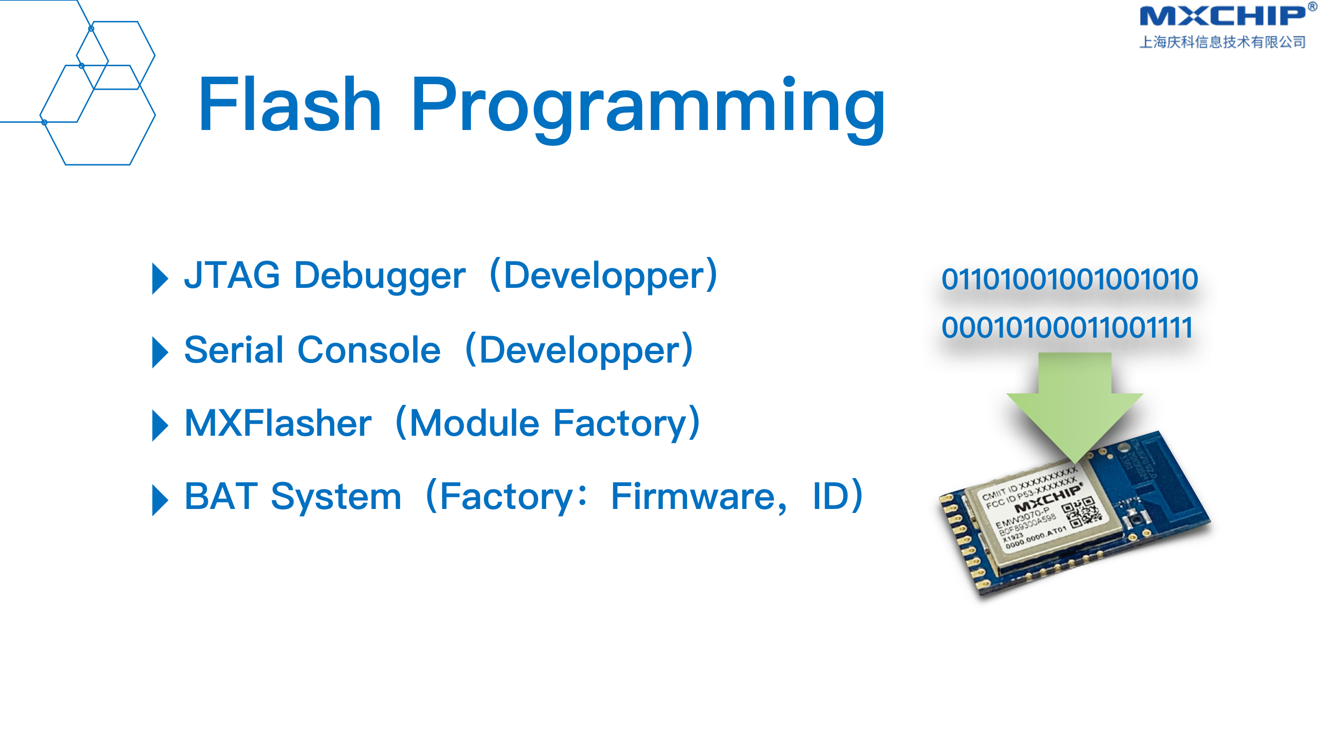

    It can be programmed via JTAG, serial port, MXFlasher or BAT system:

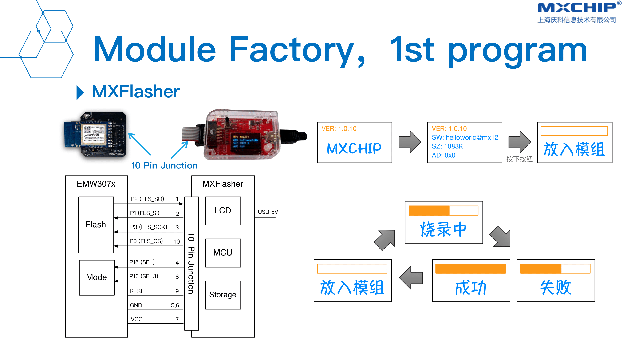

    Connecting MXFlasher:

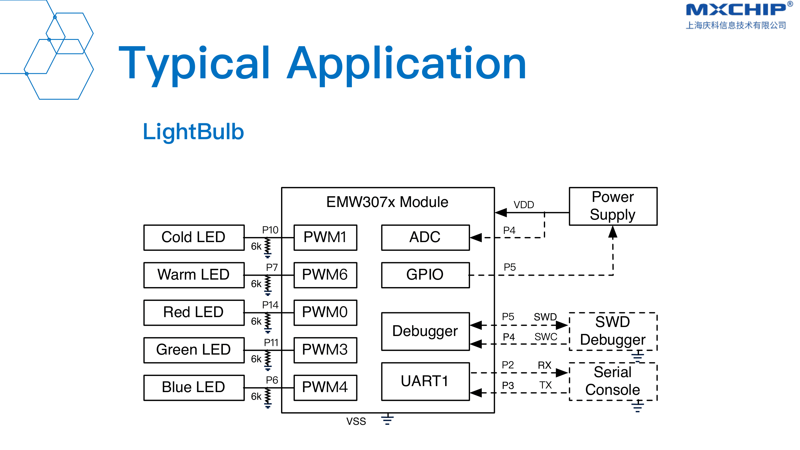

    Typical application - LED RGBCW:

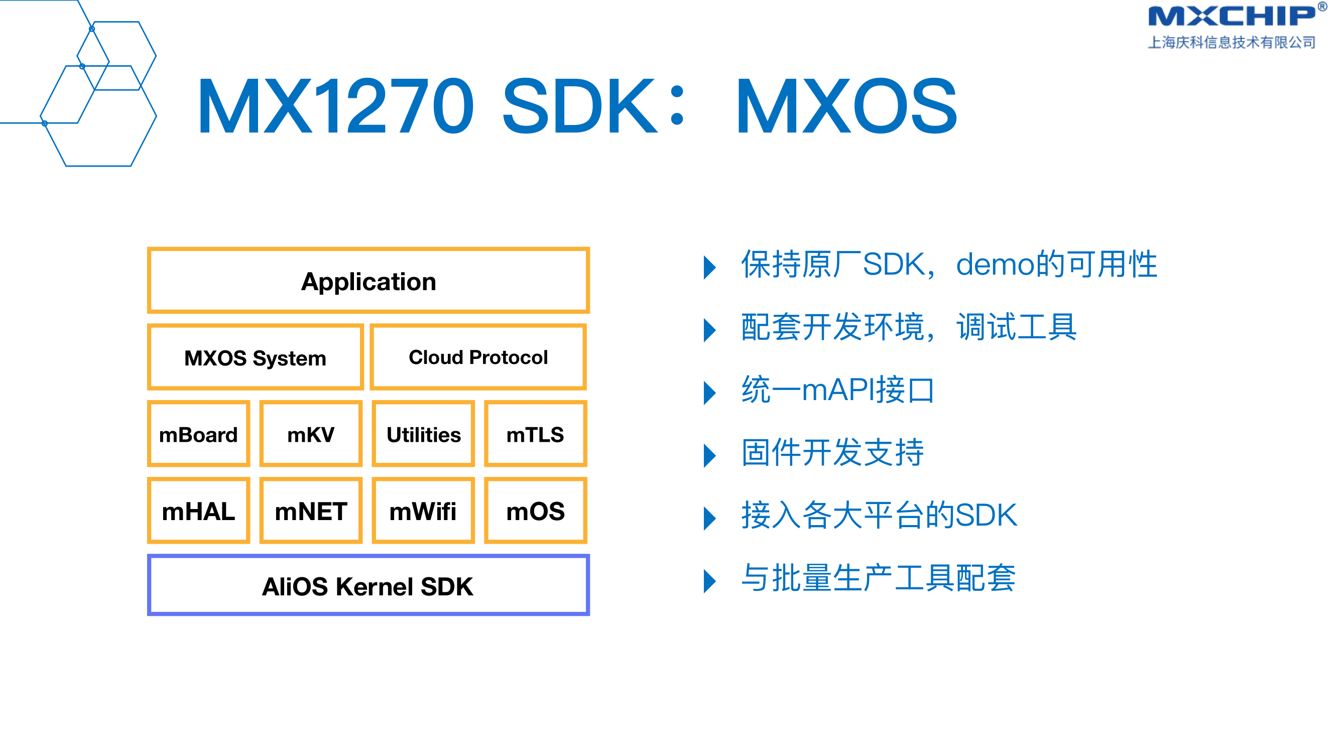

    SDK?
    Is that it?
    https://github.com/MXCHIP/mxos

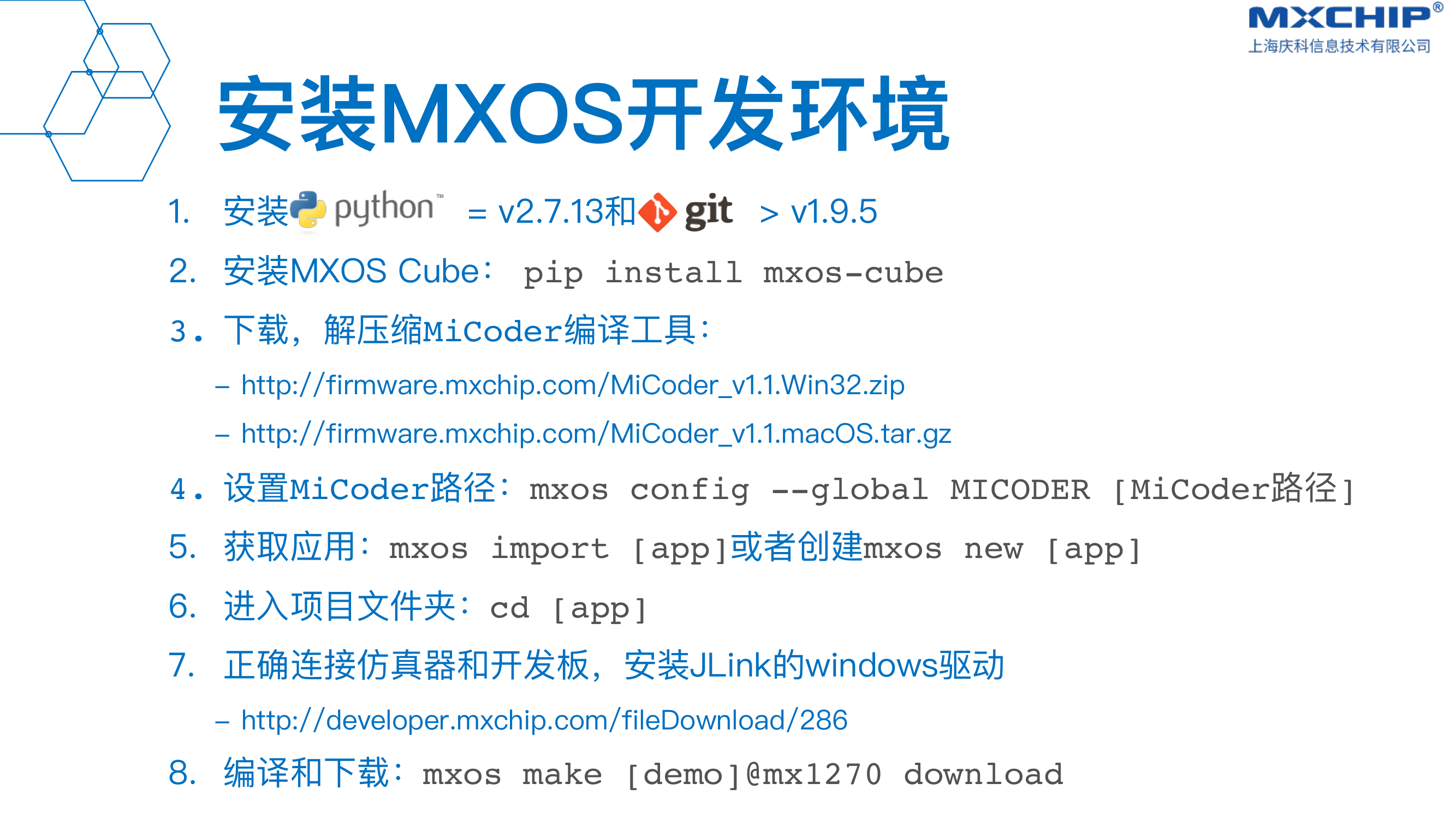

    Compiler installation process?

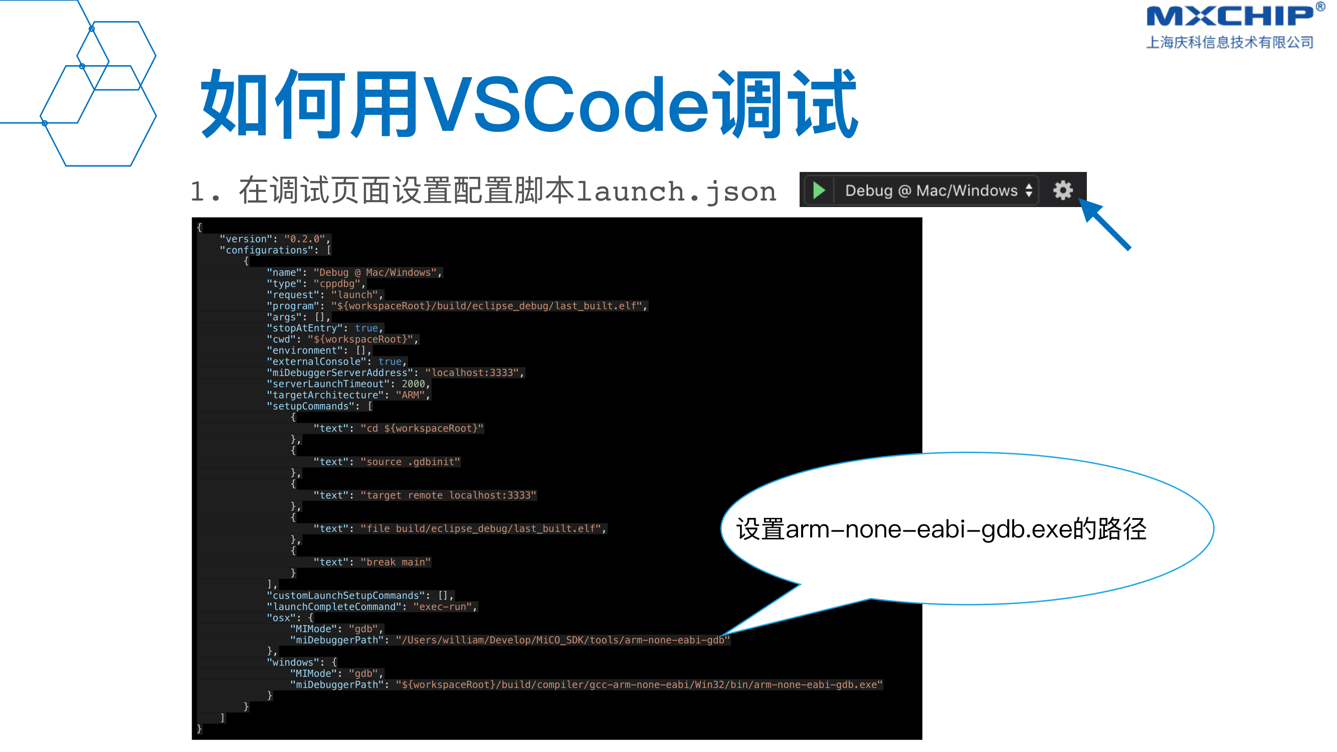

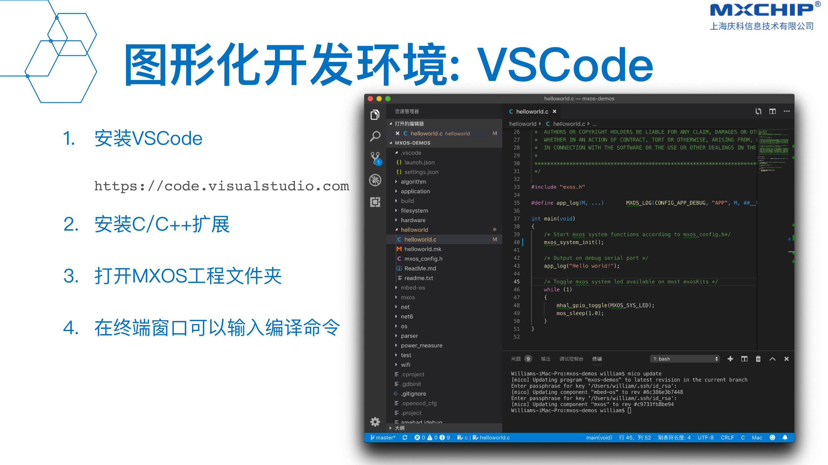

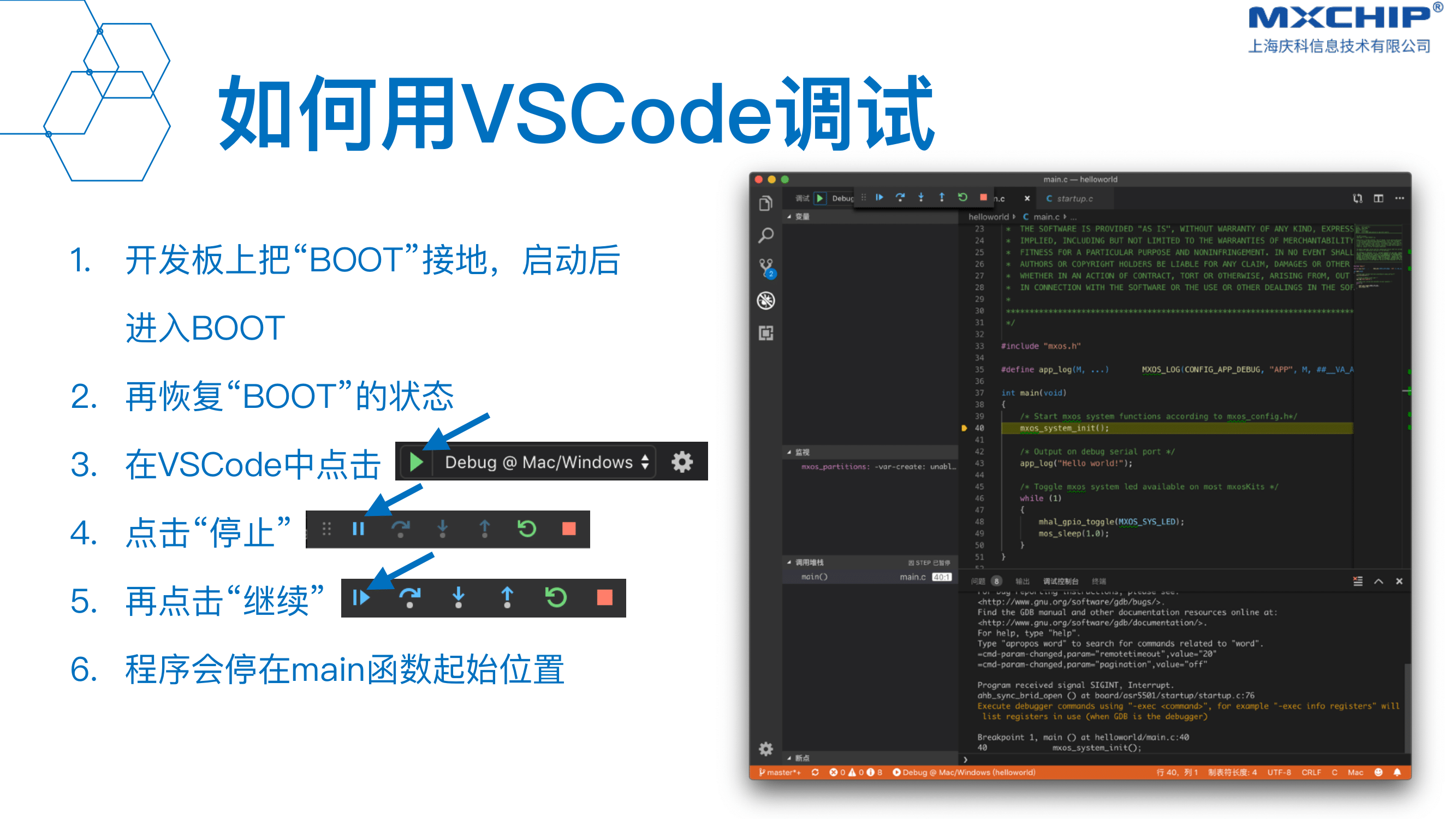

    Working in Visual Code?
