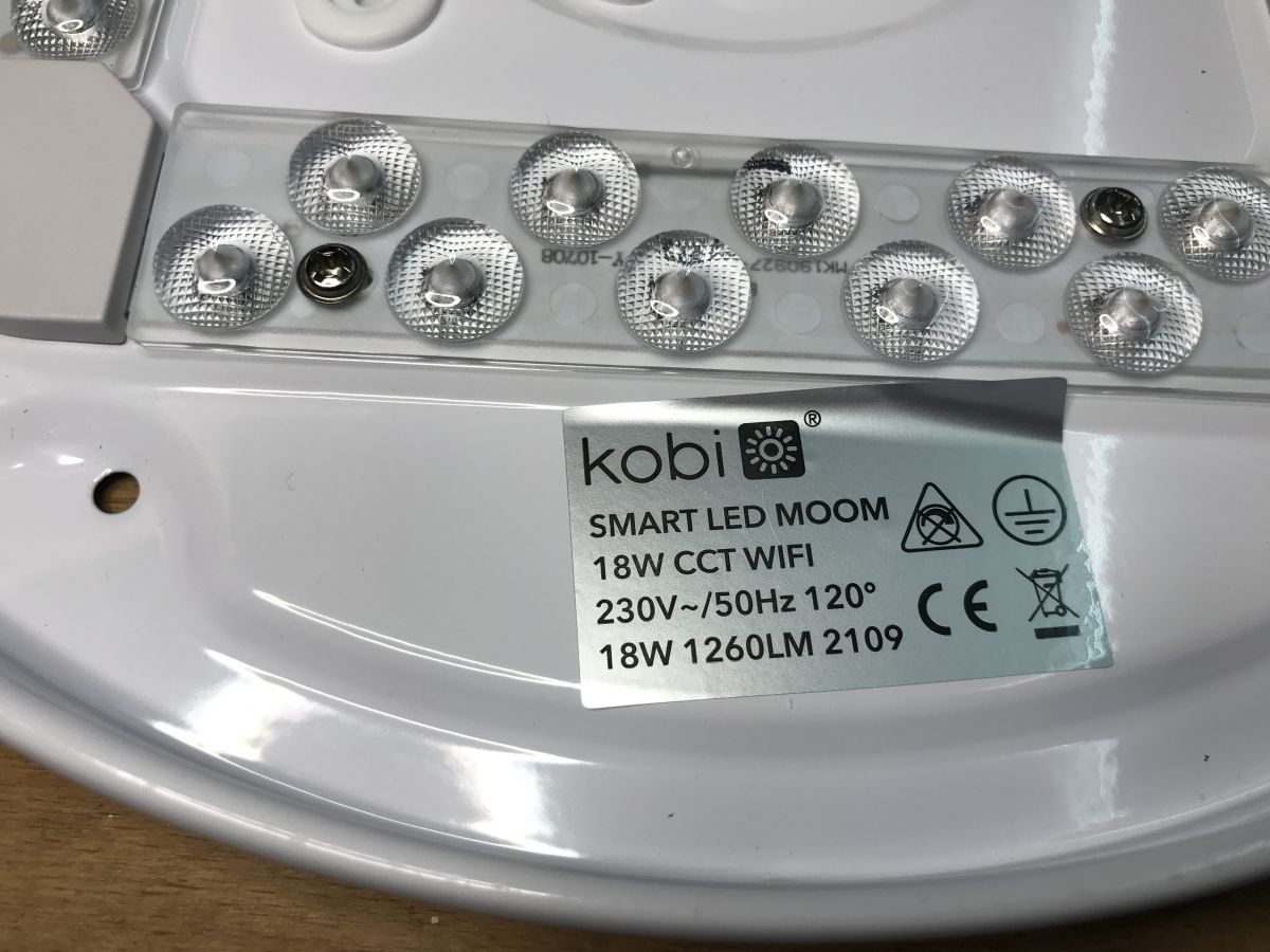

    The product model is KSMN18CTWA. The product is distinguished by the characteristic quadrangular distribution of LEDs:

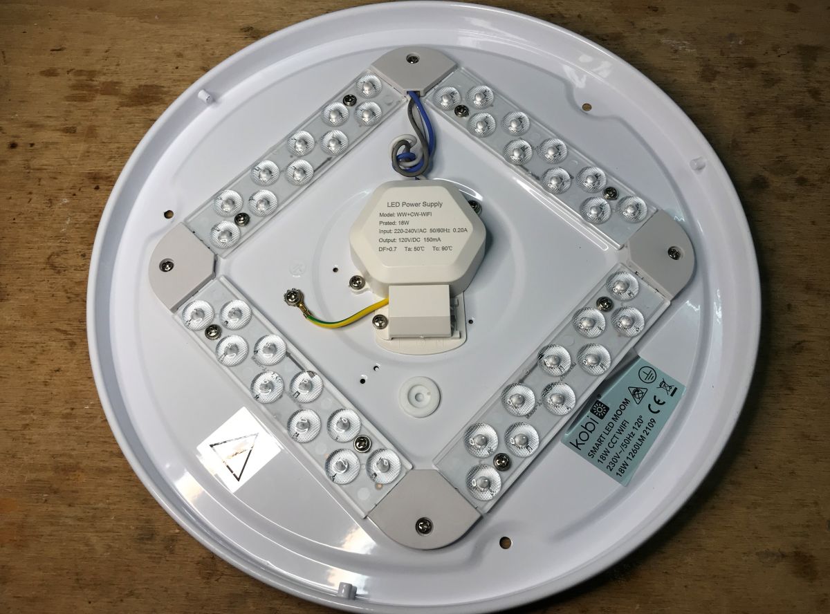

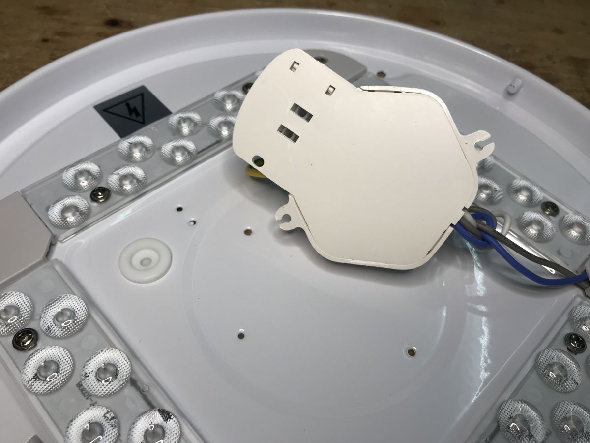

    The cover is simply twisted to the side and ready to be removed. Then you can see the controller and LEDs:
    [WB3L/BK7231T] Plafon CCT 18W WiFi Kobi Smart LED Moon Tuya

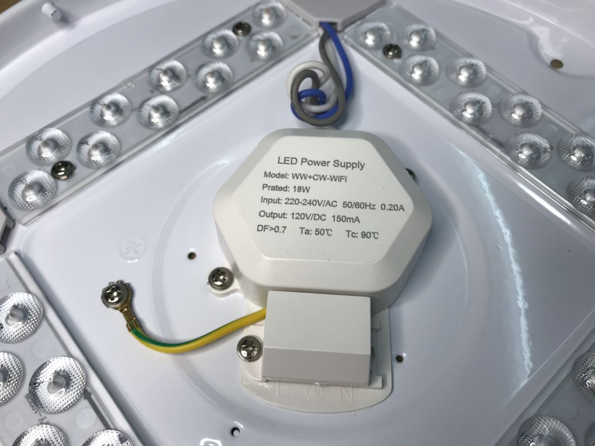

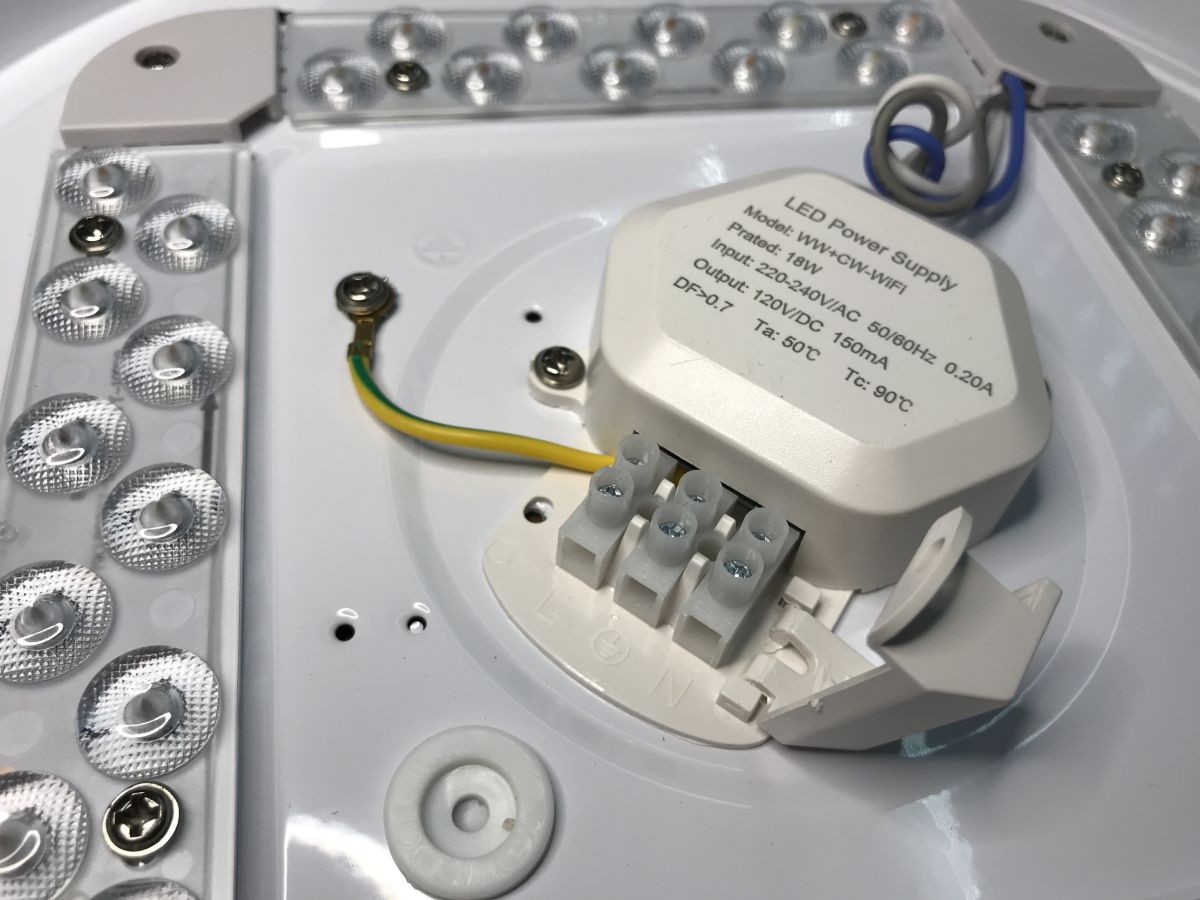

    And the LED power supply - even with information about power consumption and LED supply voltage (120V DC 150mA):
    [WB3L/BK7231T] Plafon CCT 18W WiFi Kobi Smart LED Moon Tuya [WB3L/BK7231T] Plafon CCT 18W WiFi Kobi Smart LED Moon Tuya [WB3L/BK7231T] Plafon CCT 18W WiFi Kobi Smart LED Moon Tuya

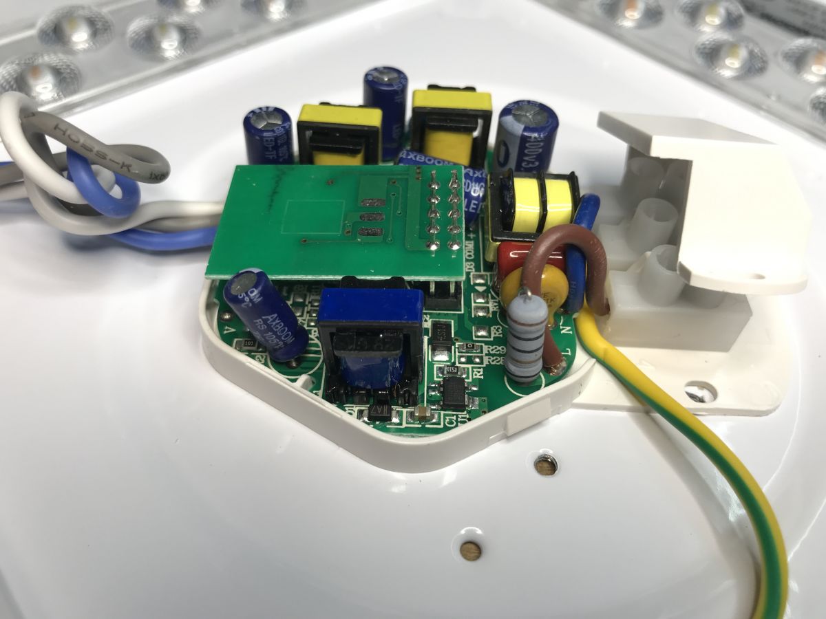

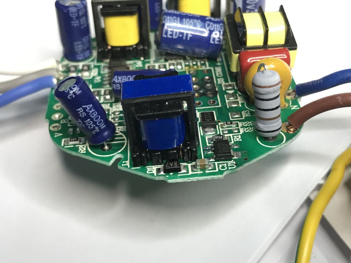

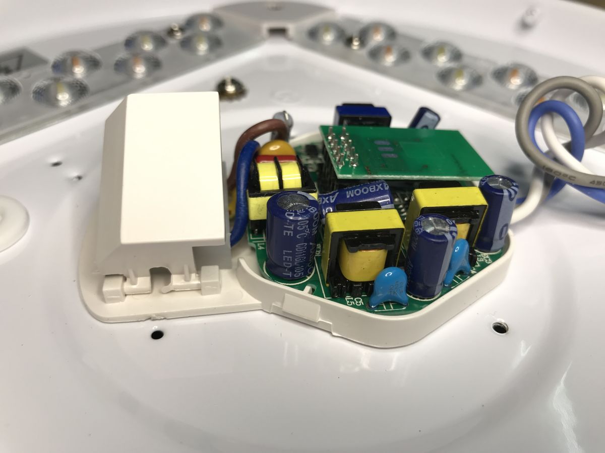

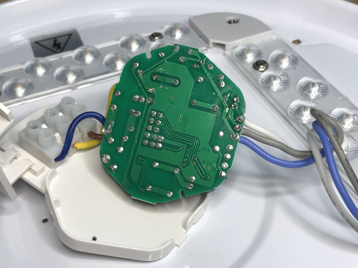

    The inside/power supply of the controller? You can already see the PCB with the WiFi module, but inverted...
    [WB3L/BK7231T] Plafon CCT 18W WiFi Kobi Smart LED Moon Tuya [WB3L/BK7231T] Plafon CCT 18W WiFi Kobi Smart LED Moon Tuya [WB3L/BK7231T] Plafon CCT 18W WiFi Kobi Smart LED Moon Tuya [WB3L/BK7231T] Plafon CCT 18W WiFi Kobi Smart LED Moon Tuya

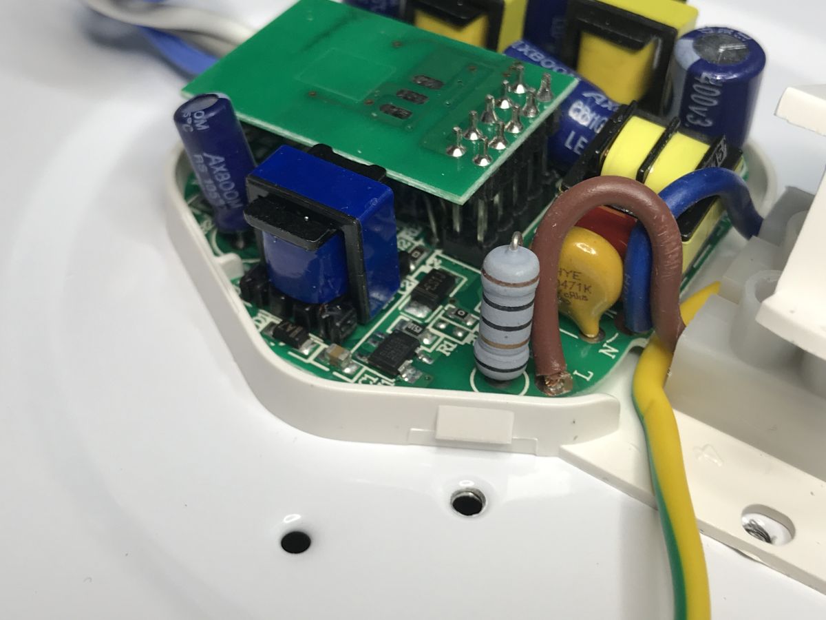

    Unfortunately, these goldpins are soldered on both sides. The module cannot be removed without soldering.

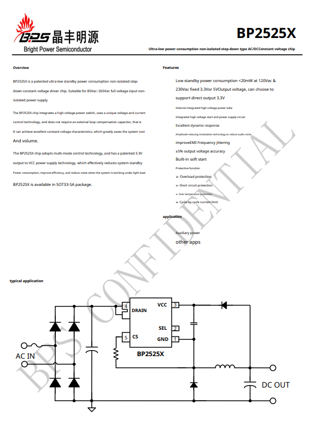

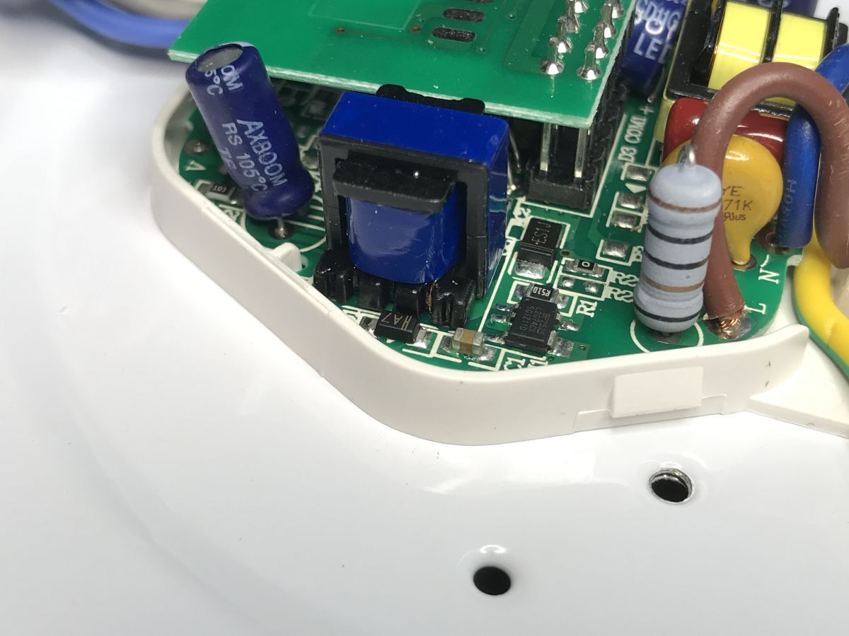

    By the way, you can pay attention to the fuse resistor, varistor, quite a large number of transformers/filters (separate power supply for WiFi and LEDs?), AXBOOM capacitors (this name does not bode well?) and the BP2525 chip (mini converter giving 5V at the output):

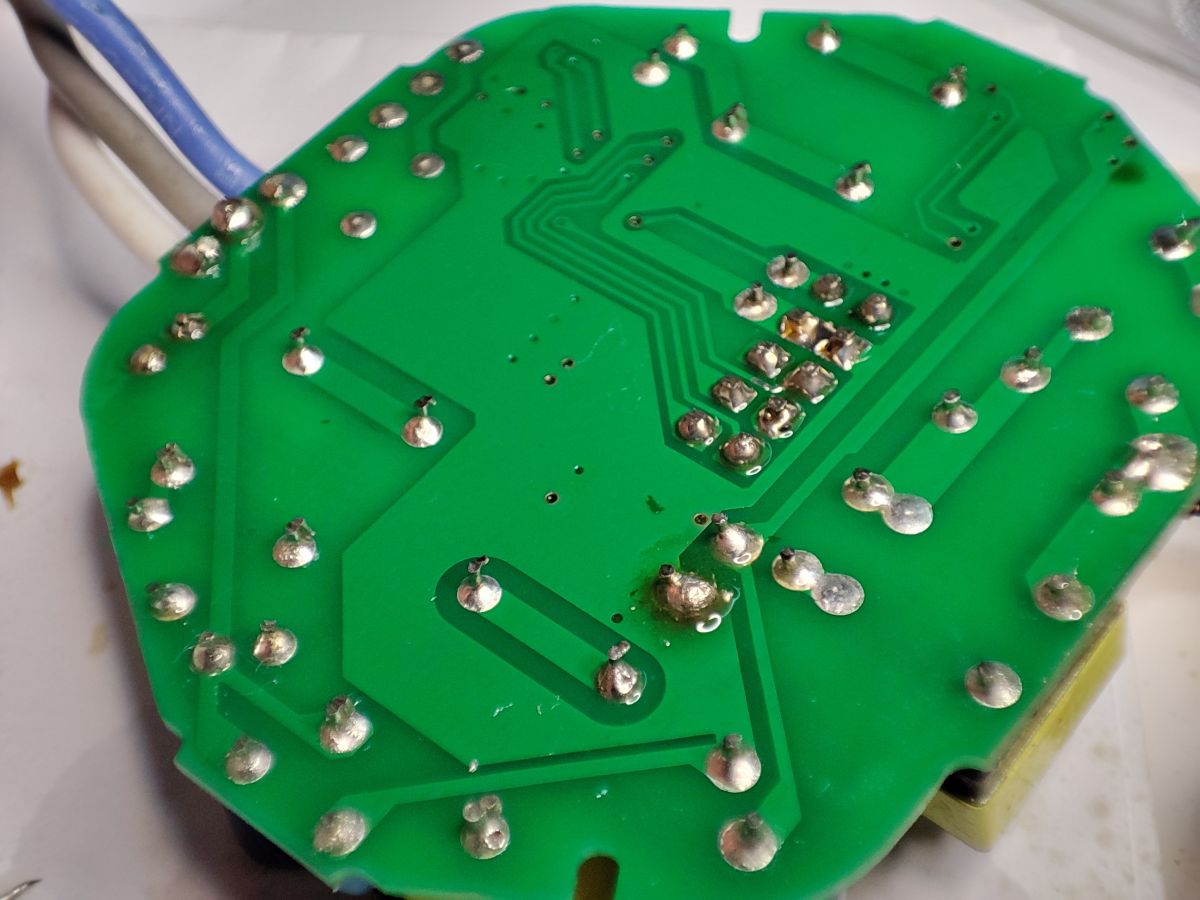

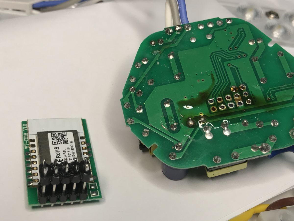

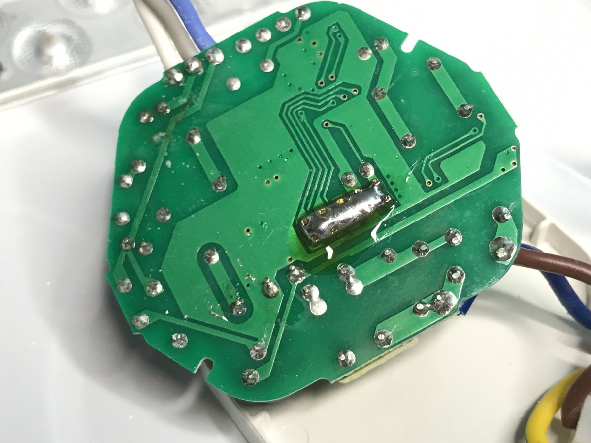

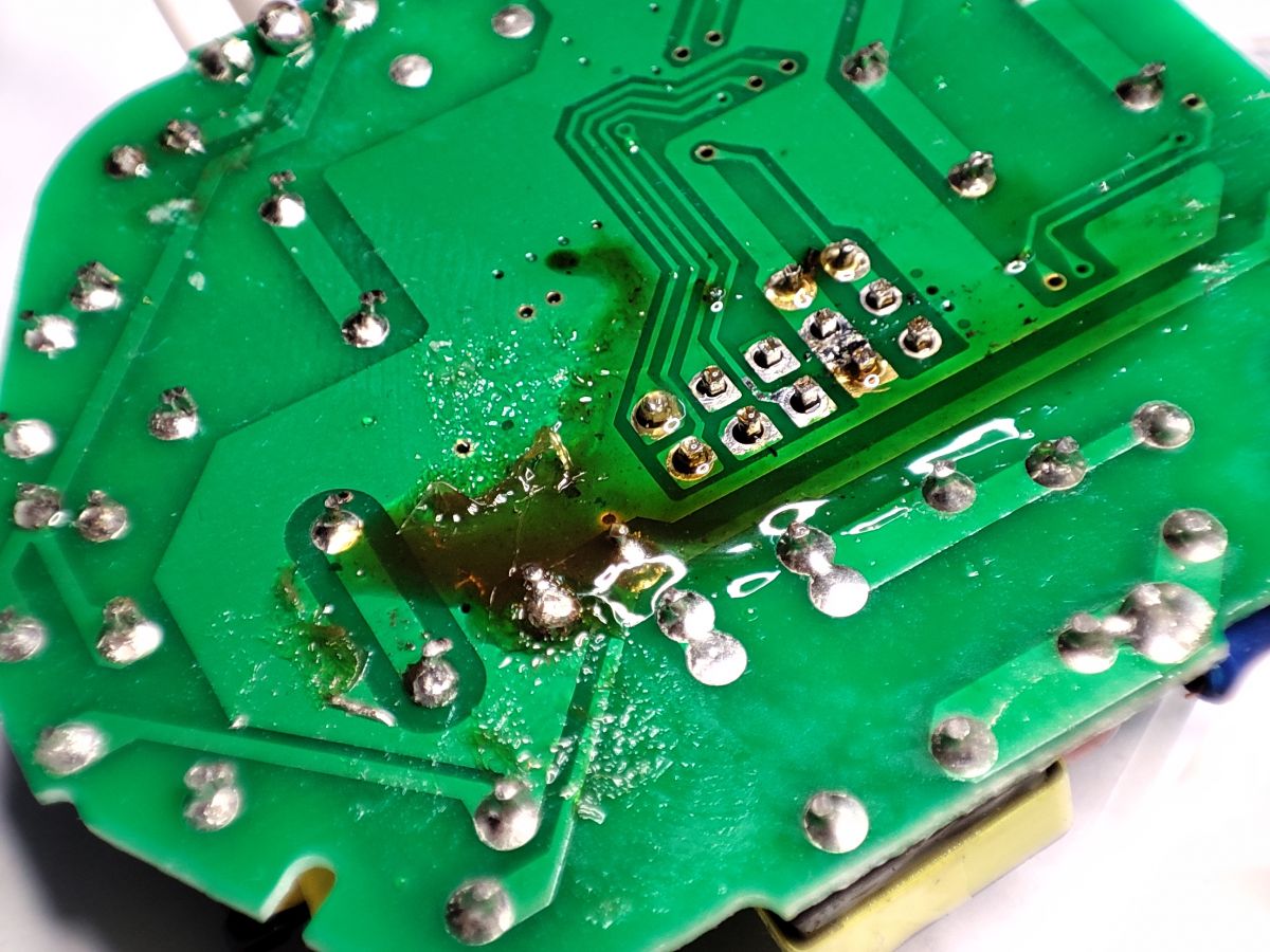

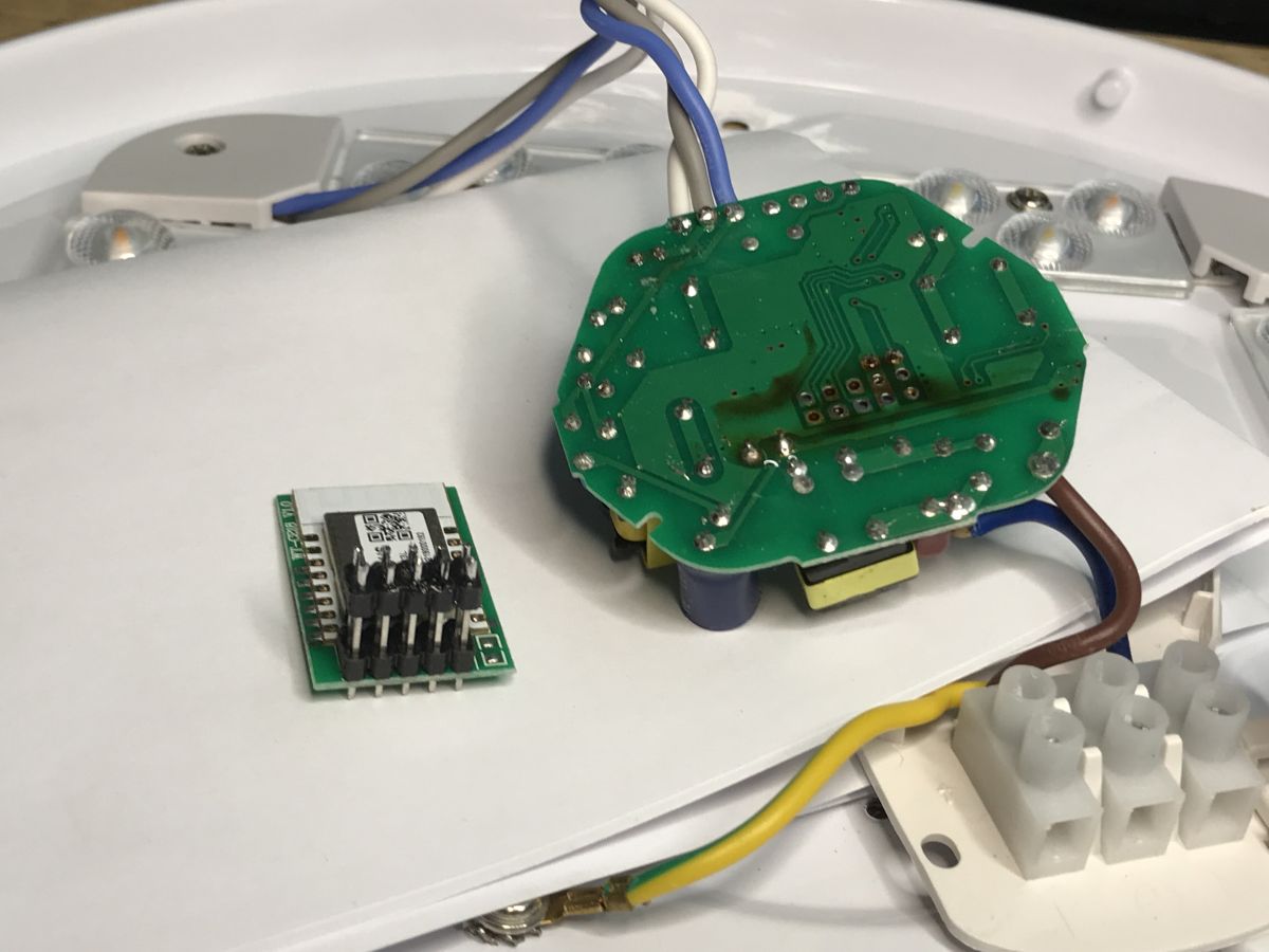

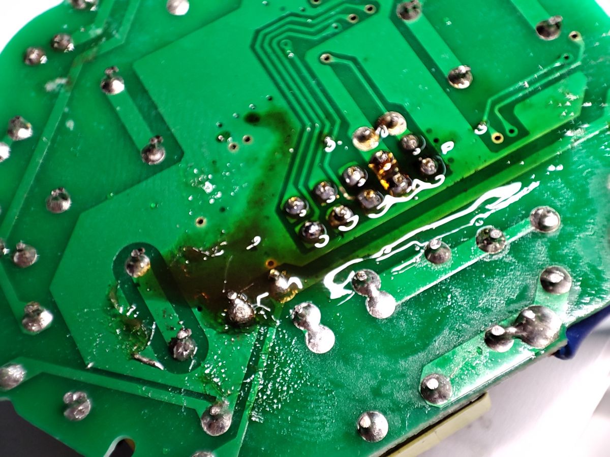

    Bottom of the PCB... here you can unsolder the WiFi module:
    I decided on the method of flux + lead binder + uniform heating of all solders:
    There were no problems. The pads are not damaged, everything is fine:

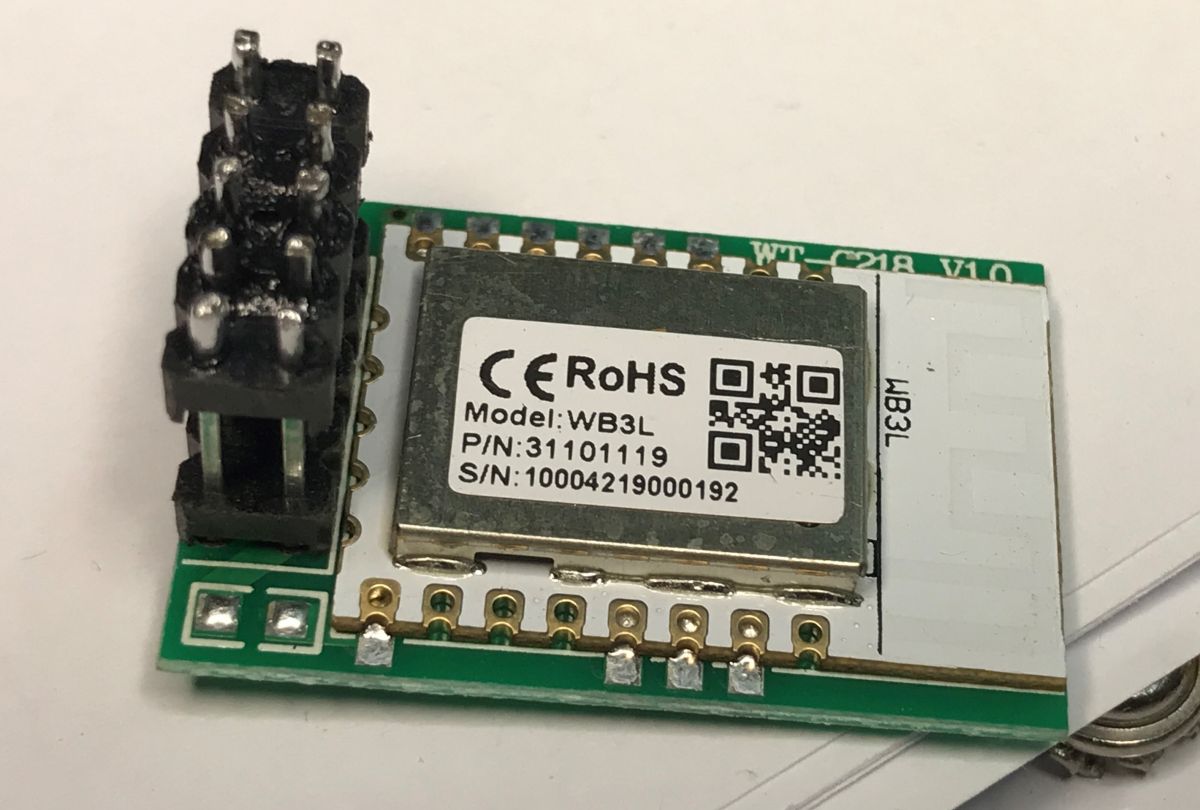

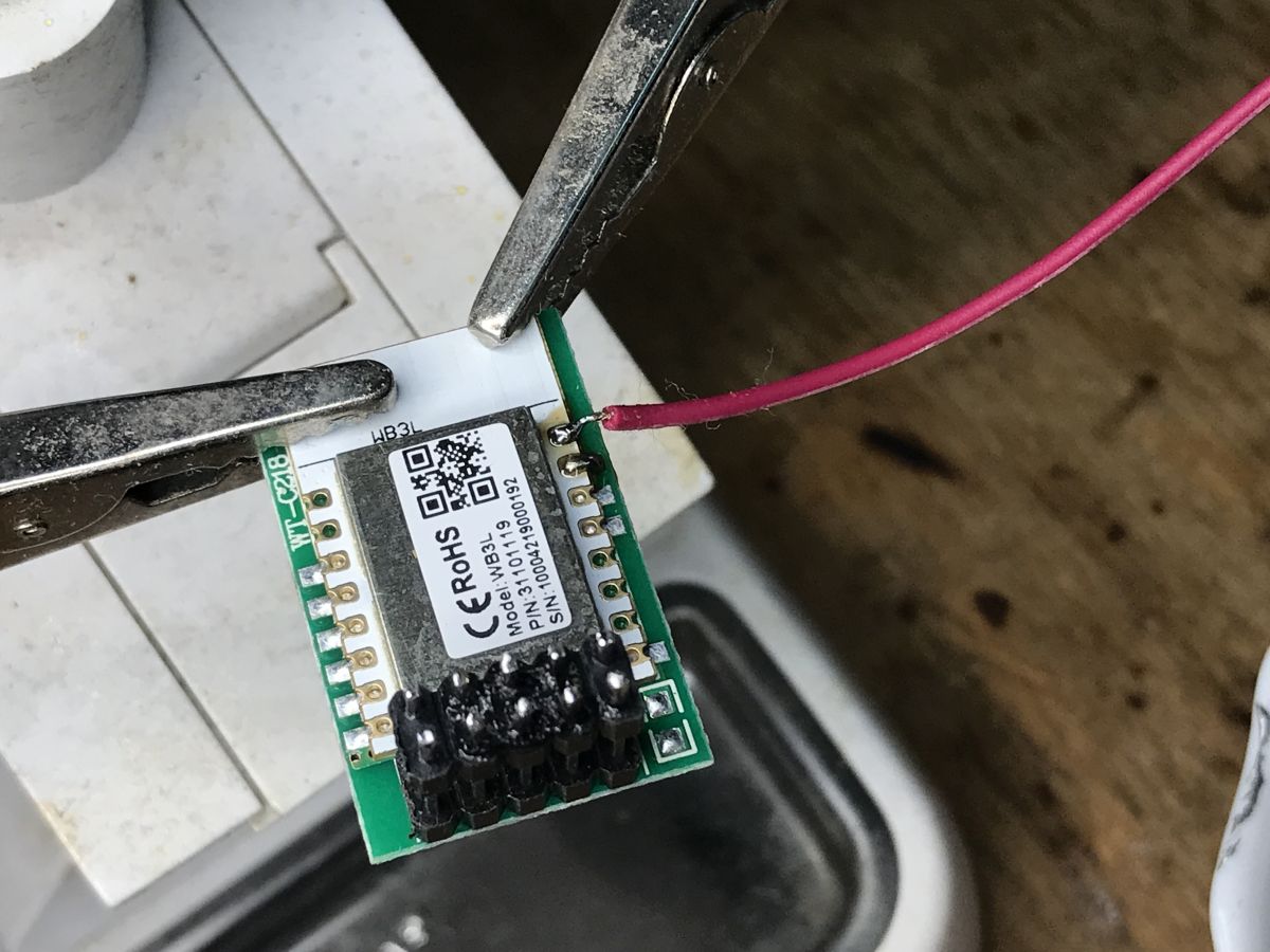

    You can see that the WB3L module is used here:

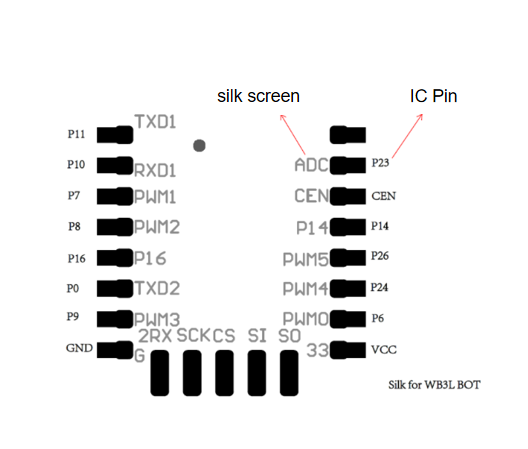

    Pinout (bottom view):

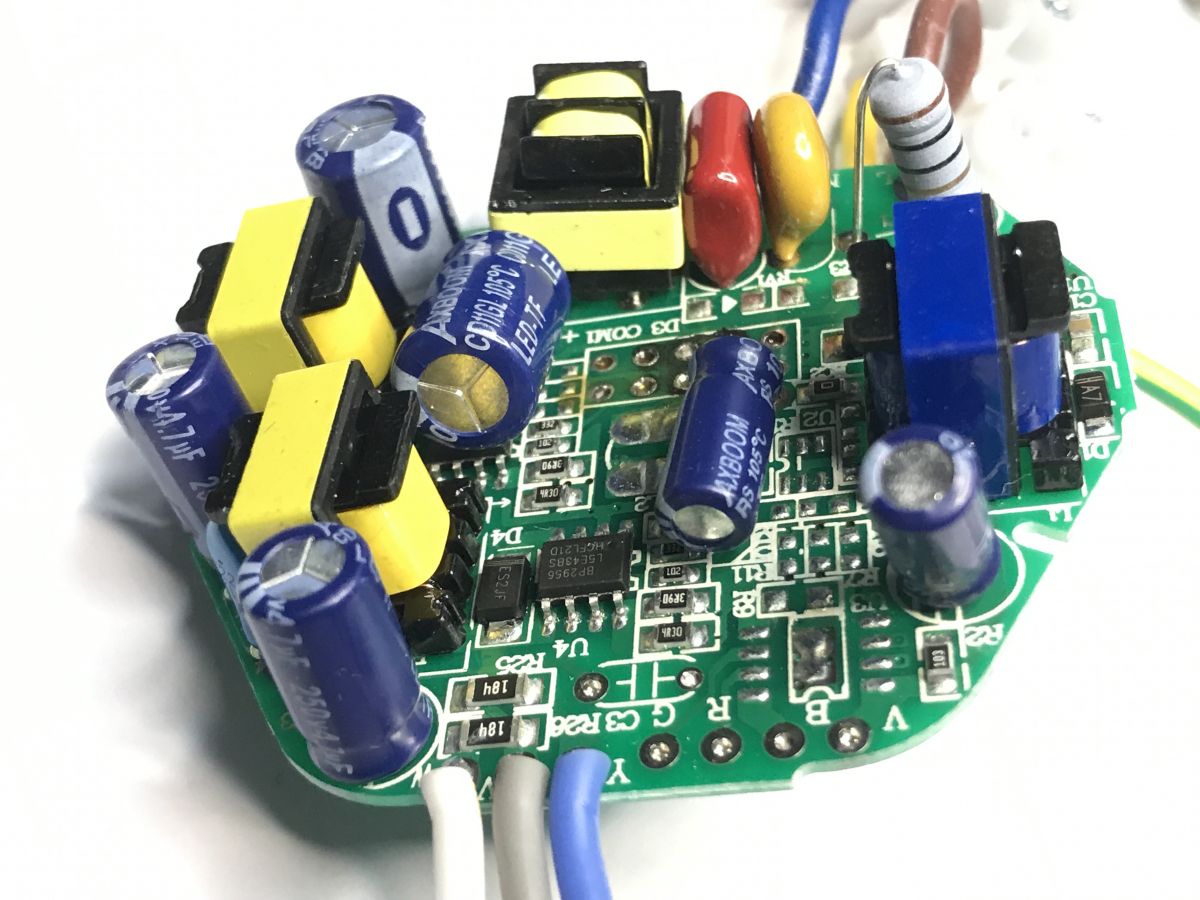

    Let's take a look at the now exposed parts of the main PCB:

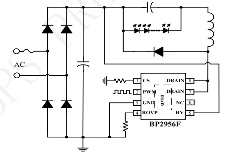

    The BP2956 is a constant current LED controller with the brightness level controlled by PWM. It connects directly to the mains, it is basically a step down converter:
    This arrangement is present on the PCB in two pieces. This is why elements seem to repeat themselves. We have two separate LED circuits here, for warm and cool white.

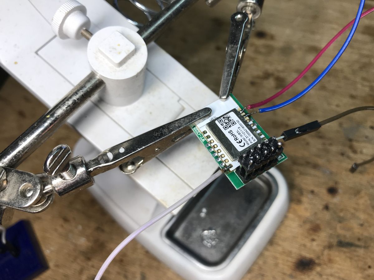

    It's a regular BK7231T, so either bkWriter 1.60 or my Gui Flasher:
    We only connect RX, TX, GND, 3.3V and when the program is waiting for "getting bus" we turn off the power for a moment.
    Connecting the wires should be simple:

    The question remains which PWM is from which color?
    - Cool Warm - pin 7 (PWM 1 - in OpenBeken set channel 1)
    - White Warm - pin 6 (PWM 0 - in OpenBeken set channel 2)
