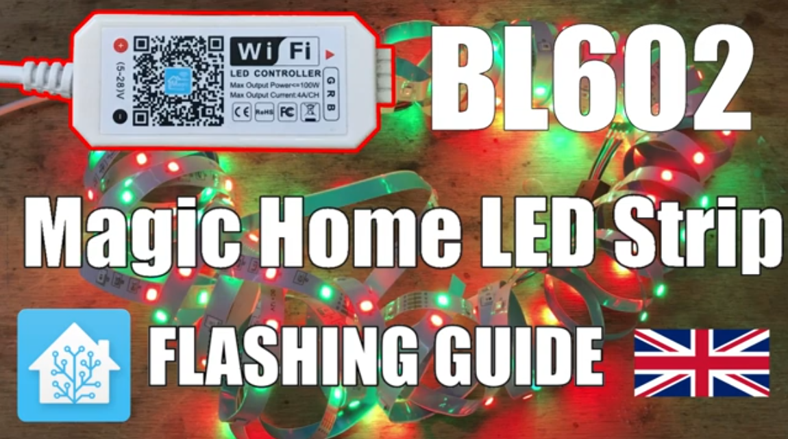

[Youtube] Magic Home BL602 LED strip programming guide (soldering wires, BLDevCube)
p.kaczmarek2  2 3408 Cool? (0)
  • Sets up a Magic Home LED strip based on the BL602 WiFi SoC for firmware replacement and Home Assistant-ready control.
  • Shows step-by-step soldering of USB-to-TTL wires, flashing with BLDevCube, and initial AP configuration on the board.
  • Notes that RGB strips require three PWM outputs to be configured.
Here's a detailed firmware change guide for Magic Home LED strip which is using BL602 WiFi SoC. The video includes step by step soldering instruction showing how to connect USB to TTL converter to the board and also shows how to use BLDevCube to program new firmware. Initial device setup (AP configuration) is also included. For RGB strip, three PWMs should be set.
