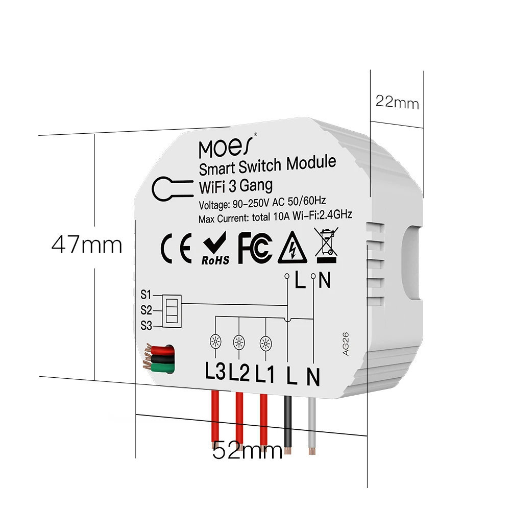

  • Moes MS-104C-1 is a 3-gang Wi‑Fi switch module, bought from AliExpress, with a CBU module based on BK7231N.
  • It was flashed with the latest BK7231N firmware using BK7231Flasher v1.0.6 and an FT232RL FTDI adapter.
  • Flashing worked, and the config maps three inputs and three relays to GPIOs 7, 9, 15, 17, 24, and 26.
Hi! Here is a teardownon of a Moes 3 gang module wifi.
I bought it from: AliExpress
Datasheet:
Module CBU (BK7231N)
Flashing:
I could flash lastest BK7231N using the BK7231Flasher v1.0.6 and a FT232RL FTDI Adapter.
Config:
"pins": {
    "7": "dInput_n;3",
    "9": "dInput_n;1",
    "15": "dInput_n;2",
    "17": "Rel;2",
    "24": "Rel;1",
    "26": "Rel;3"
