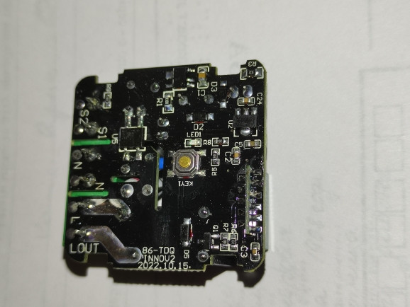

  • Teardown covers a generic AliExpress Wi‑Fi smart switch based on BK7231N and a CB2S module, sold in Tuya as "Latched hidden Switch Single pro."
  • Flashing uses tuya-cloudcutter with the `aubess-16a-mini-smart-switch` profile and `OpenBK7231N_UG_1.15.517.bin`.
  • The switch is described as simple to flash, and the post includes a configuration section for the OpenBK7231N firmware.
Hi! Here is a teardown of a r generic smart switch from aliexpress.
On Tuya app is named: Latched hidden Switch Single pro
Bought From:
https://it.aliexpress.com/item/1005004152926240.html
Pictures:
Flashing:
Is simple to flash with tuya-cloudcutter:
sudo ./tuya-cloudcutter.sh -p aubess-16a-mini-smart-switch -fOpenBK7231N_UG_1.15.517.bin

p.kaczmarek2 02 Mar 2023 10:24
Thank you, can you provide the pins configuration for that device? [Read more]
giovannij600 02 Mar 2023 10:37
I'm trying to find it, but using the configuration like this https://obrazki.elektroda.pl/5701076800_1677749837_thumb.jpg only relay work. S1 and S2 and push button not work [Read more]
p.kaczmarek2 02 Mar 2023 10:40
Well, you have either to look at the board and check traces with multimeter to see where things are connected, or just try pin roles one by one... you can also search for similar devices on our template... [Read more]
giovannij600 02 Mar 2023 21:23
I find it, I put it on post Thanks [Read more]
p.kaczmarek2 02 Mar 2023 21:24
You can also copy JSON template from the Launch Web Application in obk firmware. [Read more]
giovannij600 02 Mar 2023 21:47
Ok I get it, where I have to copy? [Read more]
p.kaczmarek2 03 Mar 2023 08:19
Copy from Web Application and paste here in the post, make sure to use syntax = json tag here on the forum. [Read more]
giovannij600 03 Mar 2023 12:28
Ok I put it on first post [Read more]
