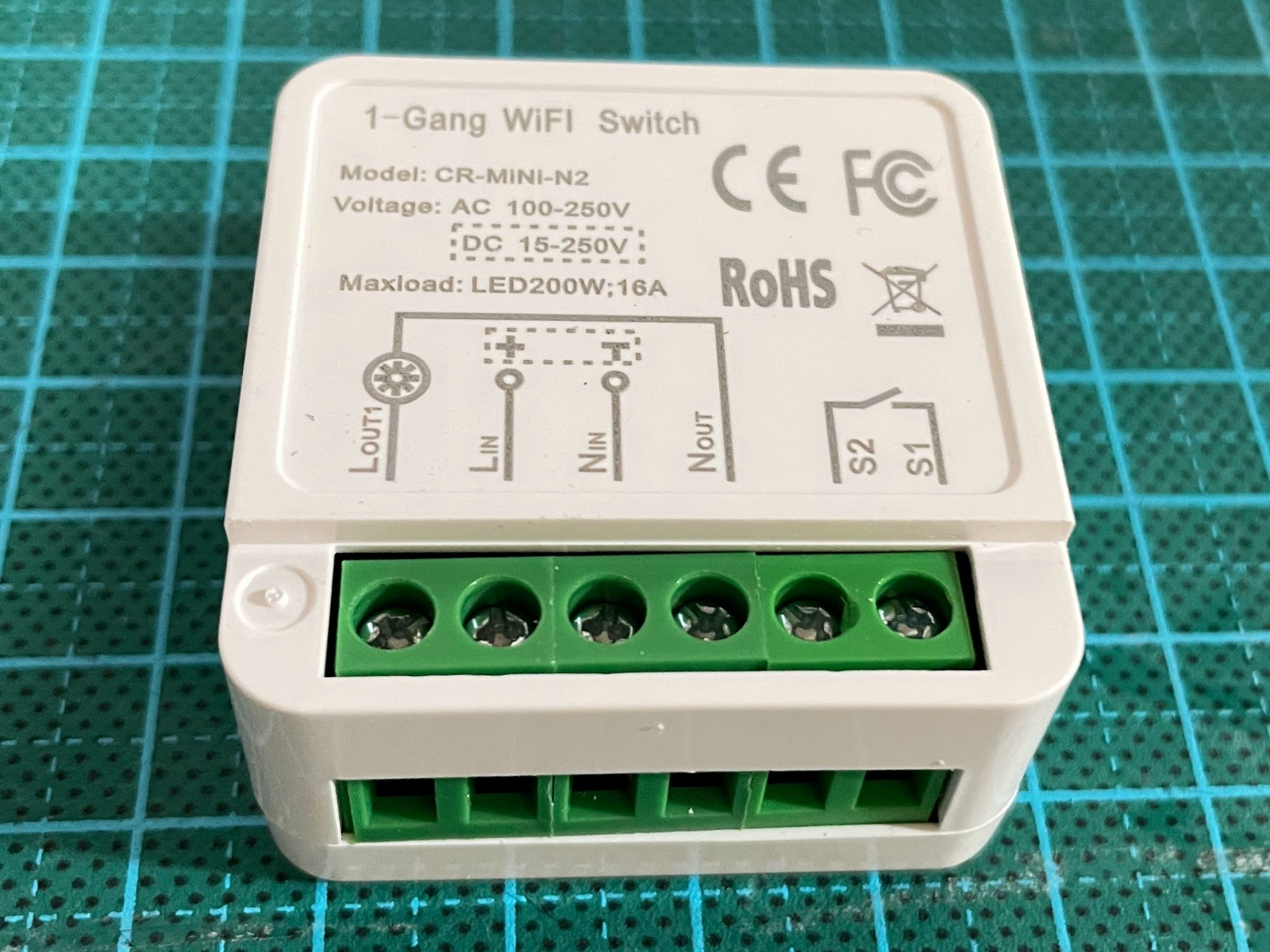

Hey all -
Yet another small in-wall relay. Looks very similar on the outside to the Aubess model, but it seems with a different board (so I figured it was worth it's own thread.)
Product URL: https://www.amazon.com/dp/B08RBNG2TX?psc=1&ref=ppx_yo2ov_dt_b_product_details
Chip: CB2S (BK7231N) https://developer.tuya.com/en/docs/iot/cb2s-module-datasheet?id=Kafgfsa2aaypq
Flashing:
Simple enough to flash, solder directly to the Tuya chip (no need to disconnect). Use BK7231Flasher at a 115200 Baud Rate.
I have a copy of the original firmware backup, not sure if that would be helpful / where to upload.
OpenBeken Config:
  "pins": {
    "8": "LED;0",
    "24": "Rel;0"

p.kaczmarek2 05 Mar 2023 19:54
Thanks, it seems like a very simple device, but I think you are still missing at least one IO role. The button on the case is separate from the switch, I think. Btw, you can upload the binary 2MB here,... [Read more]
mattj 05 Mar 2023 21:20
Yes, you are correct about the button. I never bothered to test it (don't feel comfortable touching on the device while it's connected to the mains voltage), since I don't intend on using it. I've... [Read more]
p.kaczmarek2 06 Mar 2023 10:58
I think that I could also extract pin mapping from 2MB firmware backup. [Read more]
mattj 06 Mar 2023 17:06
Original FW attached. I will also try to submit to the Tuya CloudCutter team. [Read more]
p.kaczmarek2 08 Mar 2023 09:58
Okay, so we know where is the button, then which pin is used for the switch? For the toggleChannelOnToggle role? [Read more]
mattj 10 Mar 2023 02:51
Sorry not sure I follow the question? The config I found that works is to set P24 as a Relay. [Read more]
