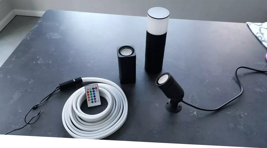

  • A dismantled LSC garden pedestal with a WB2S/BK7231T module was repurposed into portable plug-in lights after stripping everything but the white plastic LED unit.
  • Black nylon braided cord turned the wire-covered light unit into portable lights, and the BK7231T flashed cleanly with the OpenBeken Windows GUI flasher.
  • The same LED unit appears in another LSC garden light, and a Tuya CloudCutter attempt stalled after the firmware file path and AP name changed.
  • Warm colors are very bright, but the color output is very poor and the plastic housing feels cheap despite the designy look.
I got 2 of these second hand for next to nothing and dismanteld it purely for fun. Its all plastic and although it looks designy from a distance, its very plasticy and cheapass.
I tossed everything in the bin except the white plastic unit inside. Warm colors are super bright. Colors verry poor brightness. Dont bother for the colors.
Because the light unit inside has a wire cover(its not a GUI10 spot), i made some funky plug in anywhere lights from them with black nylon braided cord.
This pedestal has the same led unit as another LSC garden light found here:
https://www.elektroda.com/rtvforum/topic3940938.html
So i just post some more pictures here so you guys know what to expect.
Flashed it with the Windows gui flasher available on the Openbeken github page without probs.
Before that i tried the Toya Cloud Cutter from github and it kinda almost worked, but it ended up not finding the downloaded firmware file because i had it in the wrong dir. Then the script stalled because it was still looking for the original Tuya APname, while the script already changed the AP of the light to something else... derp. Made a ticket on github, it already has a response with explanation.
https://github.com/tuya-cloudcutter/tuya-cloudcutter/issues/313

p.kaczmarek2 10 Mar 2023 17:21
Wow, that's a very nice device, I haven't seen that one yet, thank you! I see they are advertised as 'garden', are they really waterproof? Btw, it would be nice if you could provide full model name/LSC/Action... [Read more]
hrijneke 10 Mar 2023 18:53
Hey, Its this one: https://www.youtube.com/watch?v=sN5QzyUCSZM its for garden yes. Its all plastic an skrewed together with rubber seals. It looked waterproof before i tossed the casing away in the... [Read more]
