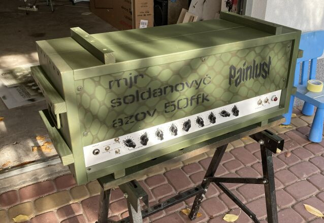

I would like to present my fifth SLO (probably it's starting to get boring) in the war-military version, i.e. stylized as the front gear, this time of Major Mykhailo Soldanovych from the Azov Regiment. Why? Because now we have a war in the east, and the amplifier is built on Soviet TS-250-2M transformers (as output), ST-270 (as power supply) and Soviet 6N2P-EV preamp tubes. In the end, there are EL34 from RFT because I no longer had efficient 6P3S-E. Because I already built an amplifier in this style (before the war), giving it the name of Major Mikhail Soldanov from the GRU, and this is known from the opposite side now, so as a counterbalance why not. The housing is made of MDF and wooden slats (hub) and chipboards (front and back). Aluminum chassis (plate + angles). The rest can be seen in the photos.

Did you make the handles for the kennel or the original ones? All great of course. [Read more]

The handles are just painted black. Added after 1 [minutes]: I don't know... the amplifier is still in my garage... I can paint it as needed... I won't check it now. Maybe tomorrow... [Read more]

As always - fine ;) However, I wonder where my friend gets these large transformers from? Because they're not popular anymore. Regards, AND. [Read more]
painlust 11 Mar 2023 09:50
I passionately collect transformers for tube devices... such a hobby. I have quite a lot of it. Sometimes I buy something on a bargain basis, sometimes I trade it for something. These, from what I remember,... [Read more]

I also collect transformers, mainly for tube equipment, but I also collect those with lower voltages, they come in handy. PLN 50 per piece is a total affordable price, now rather not available or more... [Read more]

Doesn't it hit you from Rubin? [Read more]

In the photos you can see that your signature on the panels is blurred. Added after 1 [minutes]: This is how it comes from Soviet TV sets, i.e. various Rubies and Electrons. [Read more]

Very neat center. As for the box. There is no extra, real MON-ish gem, and the switches and switches give effect [Read more]
