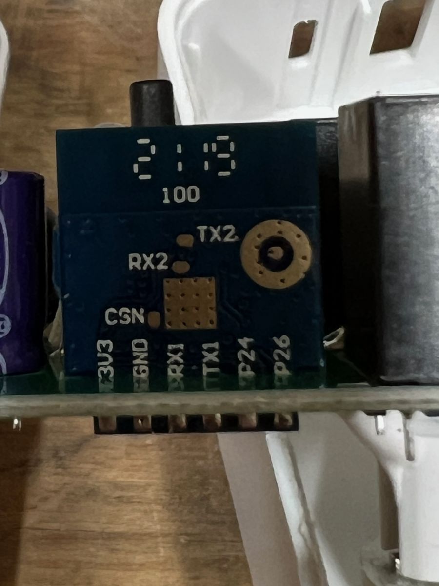

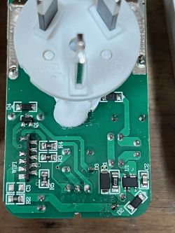

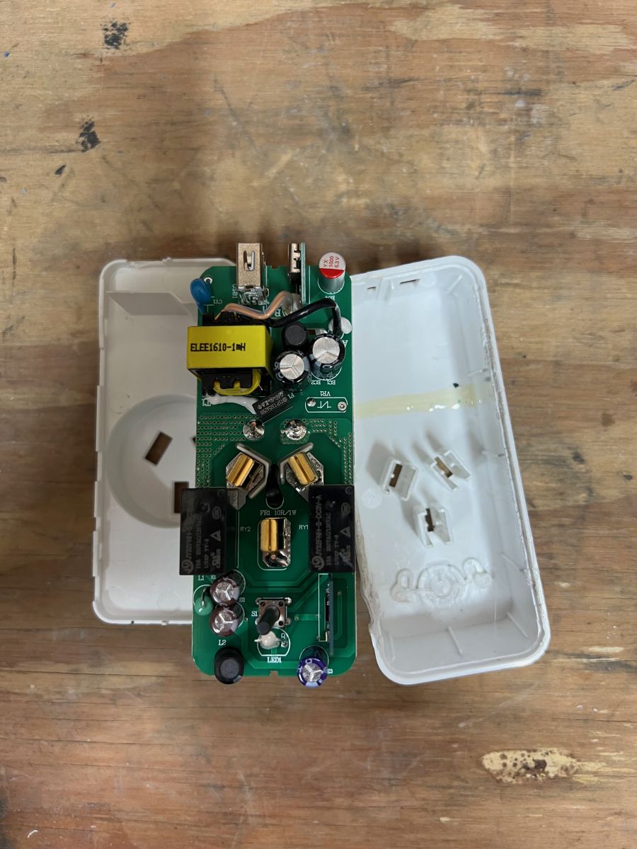

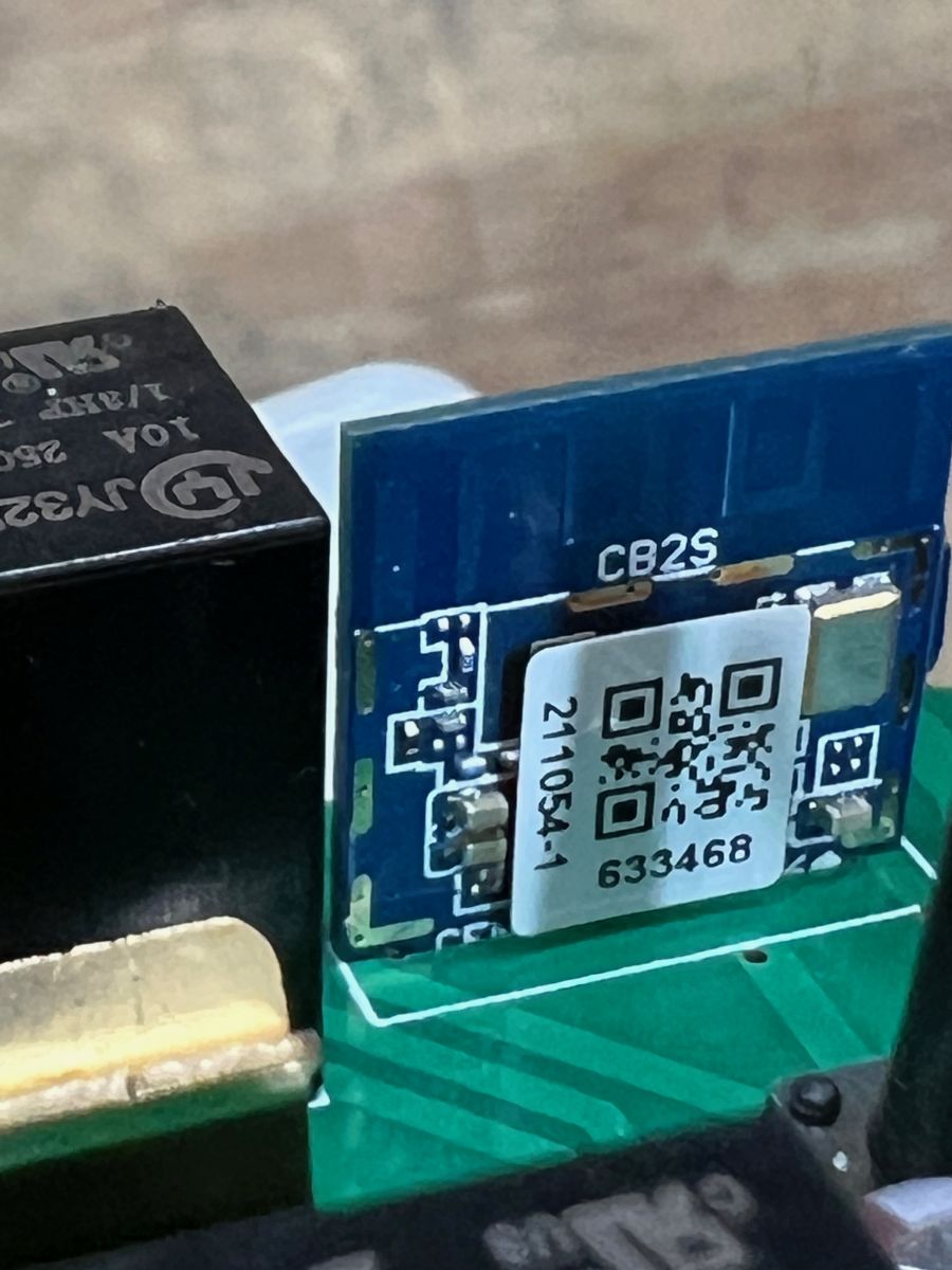

Below is the configuration and internals of a Mirabella Genio Smart Plug with USB A and C (I03632).
I have extracted the full dump, so this can now be flashed using tuya-cloudcutter. It uses the CB2S board, and can also be flashed by carefully cutting down the sides, and prying the case open. I made a bit of a mess, but it still clicks back together securely. I used by Pogo Pin Flashing Adapter, but if you can use cloudcutter, that should be a lot easier.
It's a simple device with a simple pin out (see below for JSON configuration)
P6: Relay
P7: Button
P8: Blue LED
P26: Red LED

p.kaczmarek2 22 Mar 2023 14:00
Thank you. It's interesting to see your CB2S module has no shielding, but the sticker was still put on that. I wonder why some of them ships without metal shield. [Read more]
