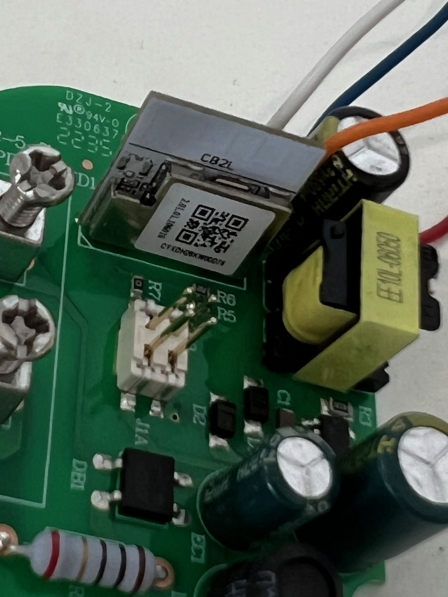

  • A Mirabella Genio RGB+CW/WW I002741 downlight from KMart was fully dumped and prepared for flashing with tuya-cloudcutter.

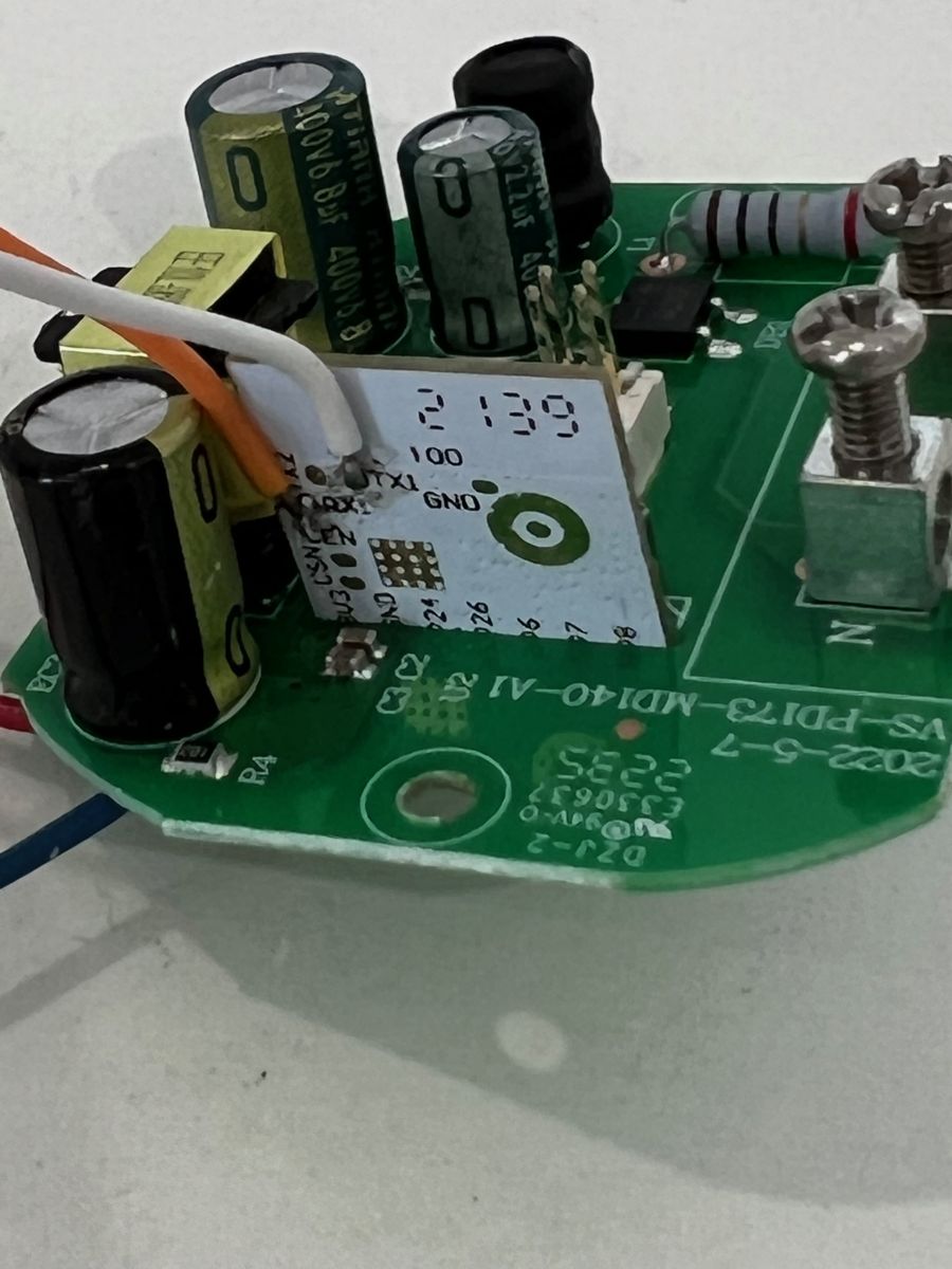

  • The lamp uses a BK7231N-based CB2L controller board, with flashing done from the RX1 and TX1 pads and the board powered through the capacitor pins on the GND and 3.3V rails.
  • The cloudcutter config defines Tuya, model I002741, and BP5758D_DAT on pin 7 plus BP5758D_CLK on pin 8.
  • After setting the config, the device needed a reboot and a manual `BP5758D_Map 0 1 2 3 4` command from the Web App logs to work correctly.

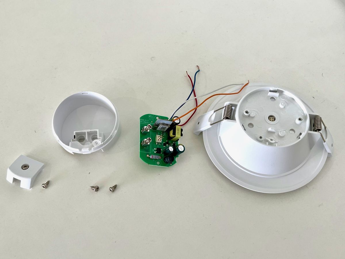

  • The enclosure is easy to open, with no glue, and the controller board can be removed after undoing the screws.
  • See below for how I flashed a Mirabella Genio RGB+CW/WW I002741 Downlight I purchased from KMart.
    I have done a full dump, and it can now be flashed using tuya-cloudcutter.
    If you do need to open it (although with cloudcutter this should not be required), this one is fairly easy, and there's no glue!
    - Make sure it is disconnected/unplugged from any power outlets!
    - Undo the only screw on the back and lift the cover
    - Undo the screws holding in the cable, and remove it
    - Undo the screw below where the cable was
    - Starting on the cable side, carefully pry the cover open, there is a click either side of where the cable comes in, and then one opposite

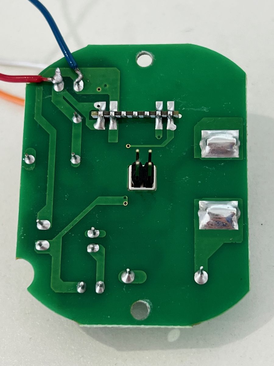

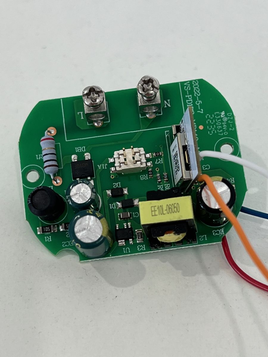

    - You can now access the controller board, if you undo the 2 screws in the controller board, it just pulls up and off
    Flashing involves connecting to the pads on the back of the CB2L board (specifically RX1 and TX1). I found it was easiest to connect to the pins of the capacitor across the GND and 3.3V rails.

    I found I needed to reboot the device after setting the config, and then run the following command (Launch Web App > Logs > command section at bottom) - not sure why this was not the default, or maybe I had some how changed it, but this worked:
