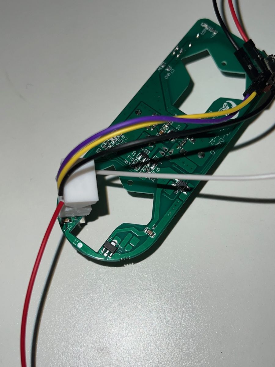

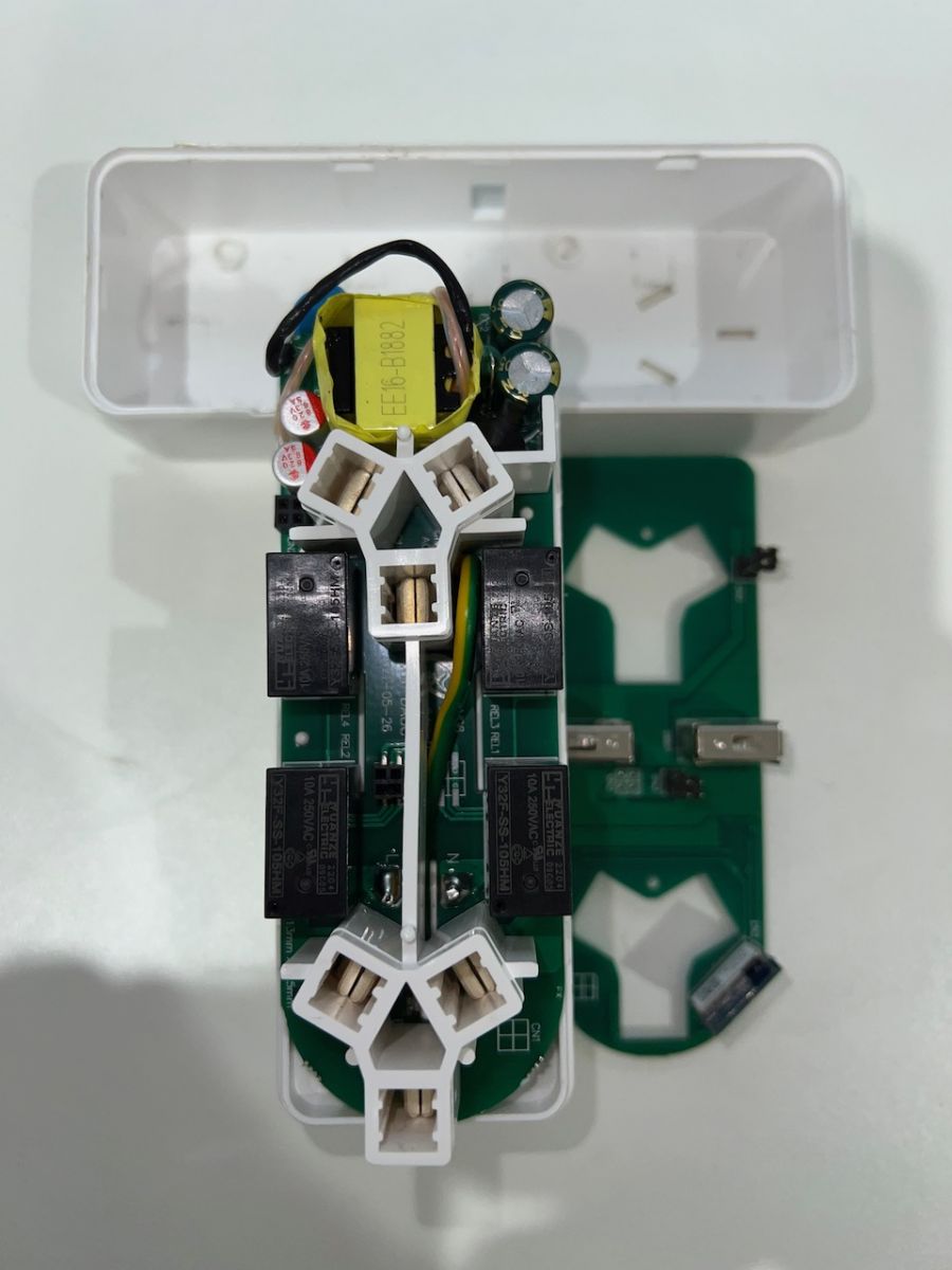

    I opened the device by using a sharp knife to crack the glue around the sides, once this is done, by carefully levering the side away from the top and working around, it'll come open. I pushed too hard several times causing cosmetic damage as I hadn't cut the glue hard enough.
    Once open, the top "logic board" just pulls off from the main board.
    Flashing Mirabella Genio Double Plug I004527: Step-by-Step Guide for KMart Model

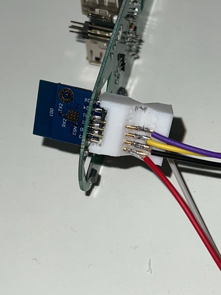

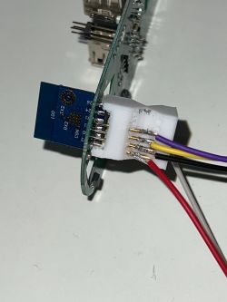

    Once this was open, using a pogo pin rig I made (uploaded here: https://www.thingiverse.com/thing:5905447 ), I made a dump and then flashed using BK7231GUIFlashTool. I powered the device directly via the 3.3v pin (using a DC-DC regulator board to step down from 5v to 3.3v as the USB-UART adapter I had kept dropping out):
    Flashing Mirabella Genio Double Plug I004527: Step-by-Step Guide for KMart Model Flashing Mirabella Genio Double Plug I004527: Step-by-Step Guide for KMart Model

    I really like how your devices have two relays per channel, so they cut off both N and L.
