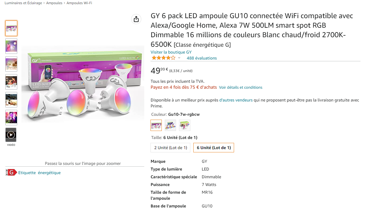

This is a short teardown of the GY gu10 which is based on BK7231N and it uses a tuya module CBLC9 and BP5768
Basic Info:
https://www.amazon.fr/GY-GU10-connect%C3%A9e-compatible-2700K-6500K/dp/B09M3677F7
