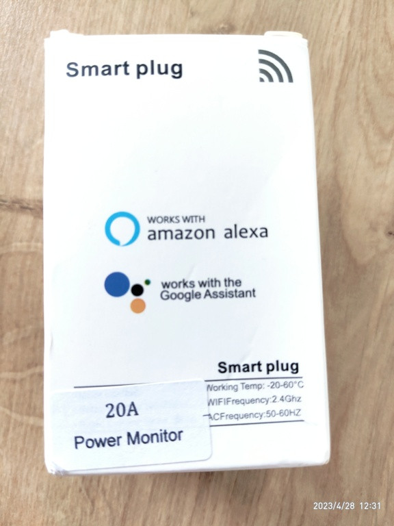

Plug purchased on ali in the promotion "3 items from" for 2.99 USD as 20A with energy measurement. The box is completely noname, there are also no inscriptions on the plug.
Plus there are two diodes - blue for wifi, red for on / off.
Link without promotion: link
Initially I was going to use it with domoticz with Tuya plugin but curiosity prevailed.
Attempts to upload via tuya cloudcutter failed.

Inside there is a surprise: a 16A relay, the thickness of the solder and the PE cable is not great.
I opened a dispute on ali and they gave back half the price without resistance.

Try peeling off the sticker covering some of the markings. https://obrazki.elektroda.pl/1811828600_1683050286_thumb.jpg [Read more]
