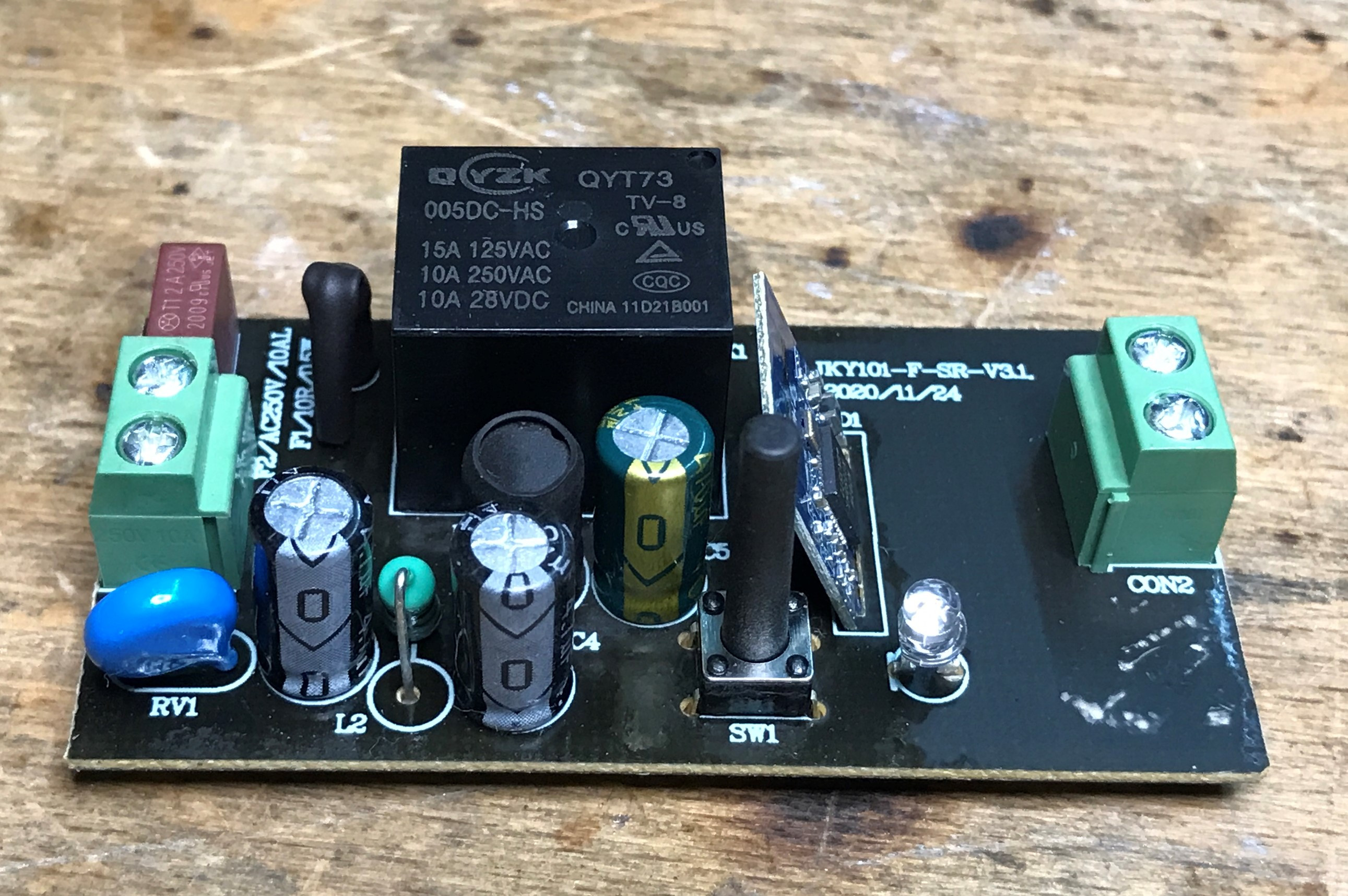

Interior of SHSB111W10 .
The casing is held in place by snaps.
The actuator is a relay at 5V, 005DC-HS QYT73, besides that you can also see a fuse, a varistor, an input filter, and part of a transformerless power supply, more precisely a small step-down converter.
The underside of the PCB will tell us more:
The power supply mentioned is implemented on a BP2905, I couldn't find its datasheet, but it's probably a similar circuit to this one:
Apart from that, there is also an AMS1117-3.3V, LDO regulator.

The outputs are compatible with TYWE2S, so you can swap the WiFi module for one with ESP<spanclass="notranslate"> .
The ESP-02S can be purchased for a dozen gold:
This is a very popular module format, compatible by pinout with CB2S, FL_M99_V1, TYWE2S, TYZS6, TW-02, WR2, WB2, WBR2, WR2E, WB2S, WA2 andXT-BL02.

Alternatively, you could solder out the WBR2 and solder in an equivalent on an ESP, e.g. ESP-02S or compatible, but this is unlikely to be financially worthwhile.
Anyway - the SHSB111W10 is not supported by my firmware at the moment, but I intend to look into it soon.
