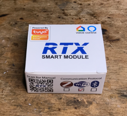

Today we release from the cloud another product that is easy to buy in our country - a double RTX relay compatible with the Tuya application. As a standard, I will show its interior, describe the process of changing the firmware (where to solder the wires, etc.) and then I will give its configuration OpenBeken (which GPIO is the button, which is the LED, etc).
Product purchase
One of my readers bought the product on a Polish auction site, and I got it just to upload it to him OpenBeken
and then give back to the reader. Thank you! This is always a good opportunity to do a review and analysis.
The relay was quite expensive, all PLN 75, but such prices are often as we buy in our country:

Kit contents
Let's see what we get for these PLN 75.
This time it's poor... not even screws. The product also does not have "wings" for attaching, although there is this plastic hook.
