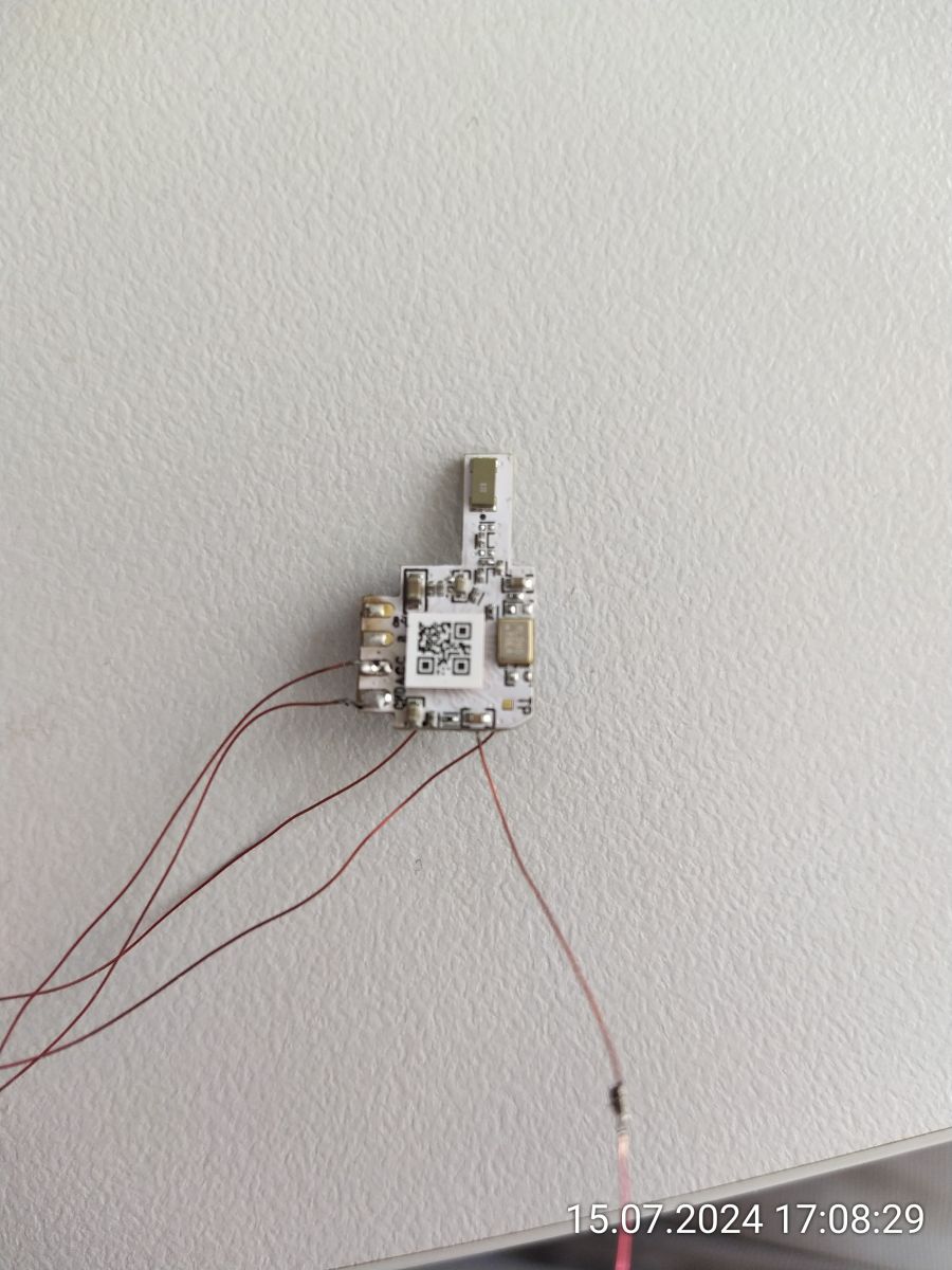

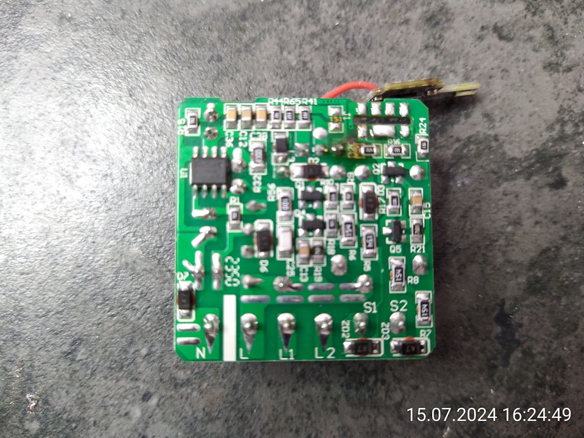

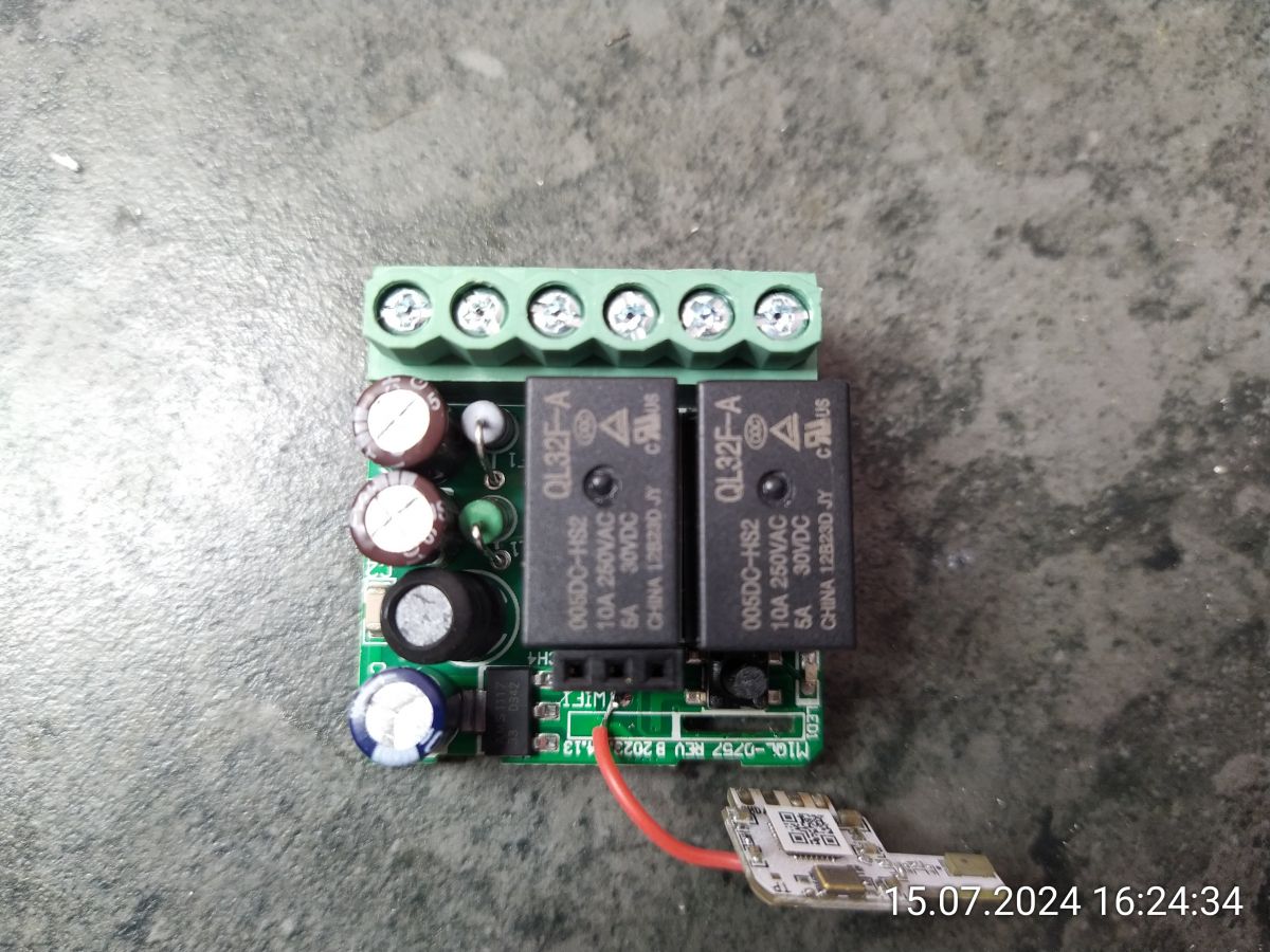

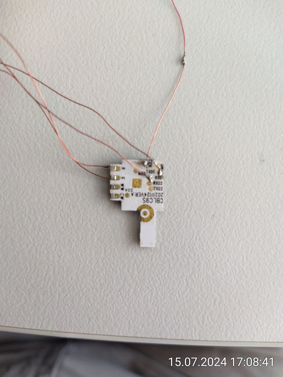

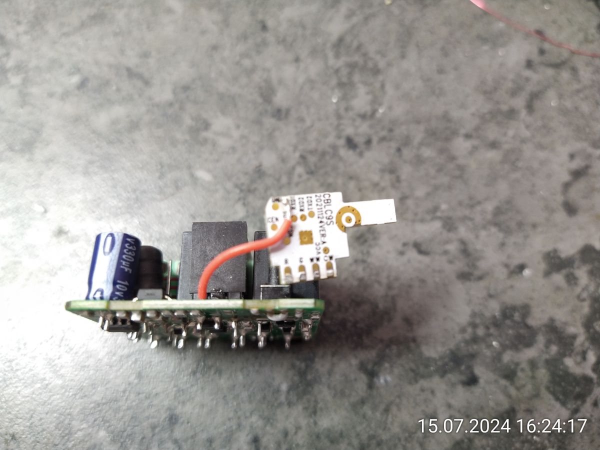

    This Curtain Module is a clone to RTX WCM1MR which also uses the CBLC9/BK7231N
    Board ID: MIQL-0757
    Rev. B
    2023.04.13
    PIN CBLC9 Board
    P6tbd
    P7relay
    P8tbd
    P9relay
    P24tbd
    P26tbd
    RXtbd
    GNDGND
    VCC3.3V

    i think this is software wise a clone of the QS-WIFI-S10-C04 i already posted. but hw layout is different.
    oh, i see its a RTX WCM1MR clone/OEM! exactly the same board.
