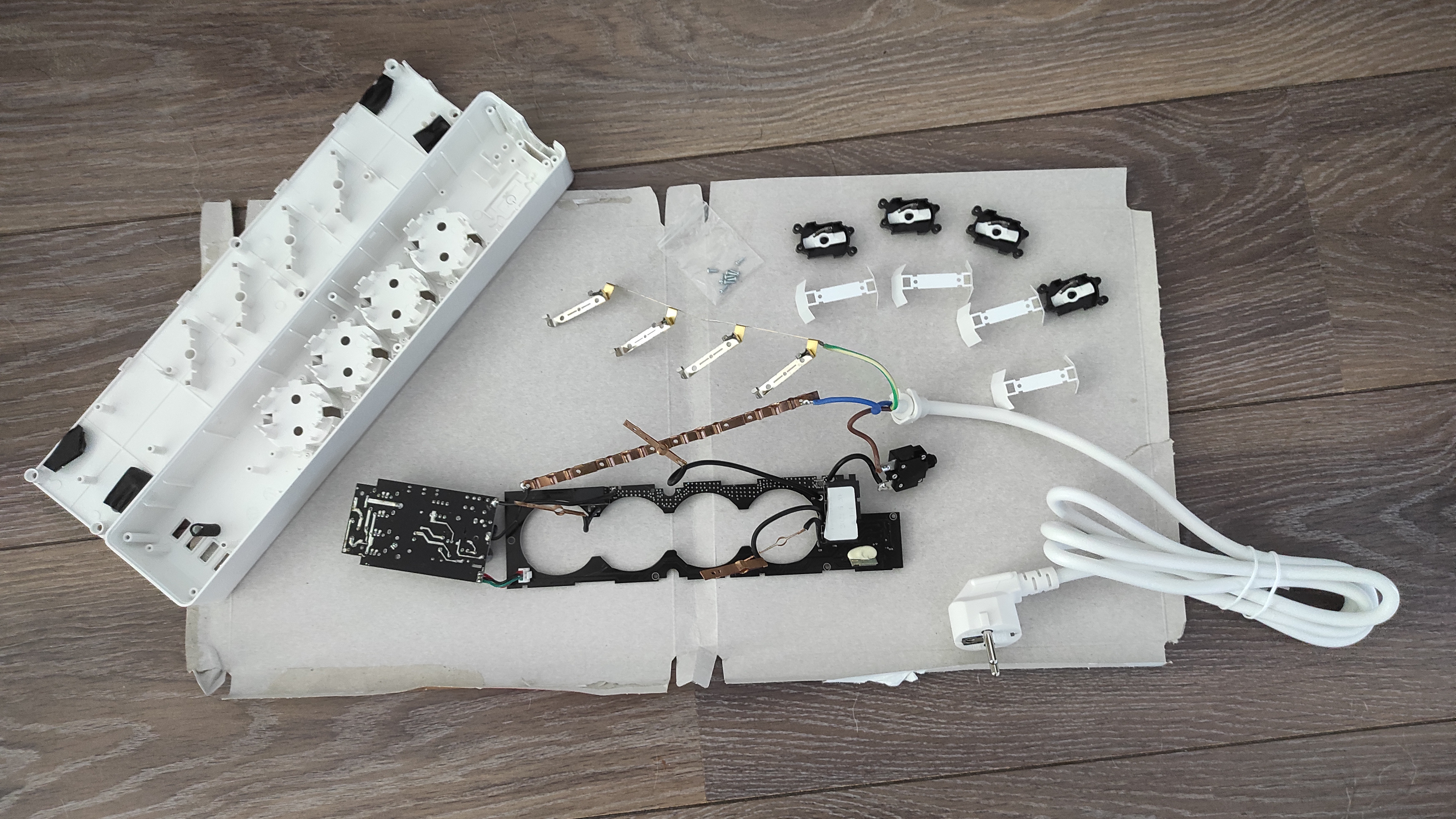

After profiting so much from the help I got here, I'm a bit proud but mainly happy to finally be able to add to the database! I managed to successfully flash a Tuya generic power strip with tuya cloudcutter. It looks quite nice, has 4 outlets that can be switched individually (their relays are hardwired to status leds), 4 usb connections that are switched together, a status led under the main button that can be controlled independently and that main button. The blackadder page underneath shows three buttons, yet I couldn't see any additional ones next to the main button.
On the device itself there is no device name whatsoever, on the package the product number ZLD-44EU-W is printed. After googling it looks like this power strip used to have an esp chip: https://templates.blakadder.com/ZLD-44EU-W.html, it now sports an CB2S chip and the GPIO numbers are also different compared to the ESP version.
I bought it via this link (it was on discount for 10 Euros less)
https://www.aliexpress.com/item/32864068545.html?
and it might be the same device as this one, that actually shares the product number:
https://www.blitzwolfeurope.com/spd/RSH-ZLD-4...LD-44-EU-W-SMART-WiFi-USB-charger-distributor
Only way to find out which chip it's using was to completely disassemble it, here are some pictures. Note: Also it's not needed to disassemble it with this howto, it might be good to do it anyway, as I noticed that the cables where not very nicely soldered to the contacts for the outlets and need some retouching.

Very good and detailed guide. I only slightly modified your post to use syntax tag for JSON code because it looks nice this way. Yes, you are right, even On5click exists :D I've created this event... [Read more]
jrhenk 22 Jul 2023 16:49
Hi! The config indeed looks nicer that way and thanks for the positive feedback! About the wifi flashing: I setup a Raspi 3 I had lying around a while ago only for cloudcutter and can really recommend... [Read more]
