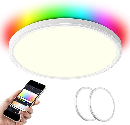

This is an older 2 pack Taloya Ceiling Light clone I bought back in '21 while the tuya chip flashing was just starting out, and shelved them. They are no longer available on Amazon https://www.amazon.com/Ceiling-Backlight-compatible-ambiance-ceiling/dp/B08T75TY8K but am posting in case this board shows up in other clones. It's using the WB3S (BK7231T) chip.
Round LED ceiling light with colorful backlighting and a smartphone for control.
