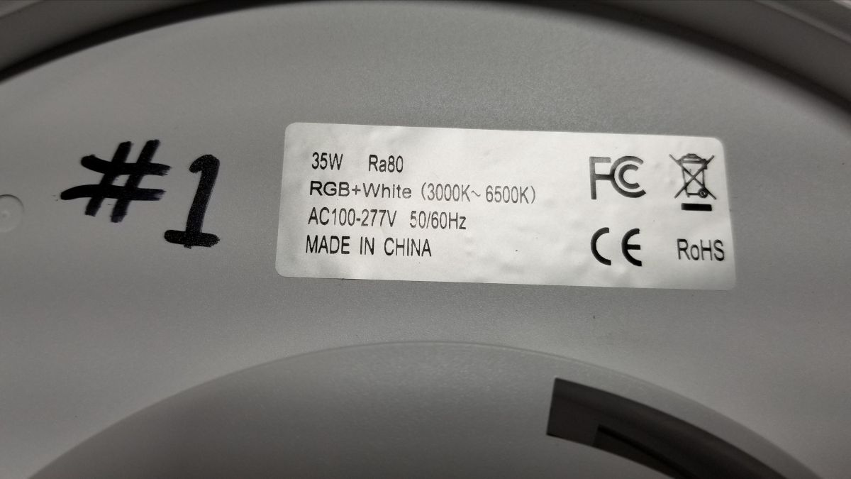

    This one is 35W compared to the 24W Taloya.
    Technical label on an LED ceiling light.

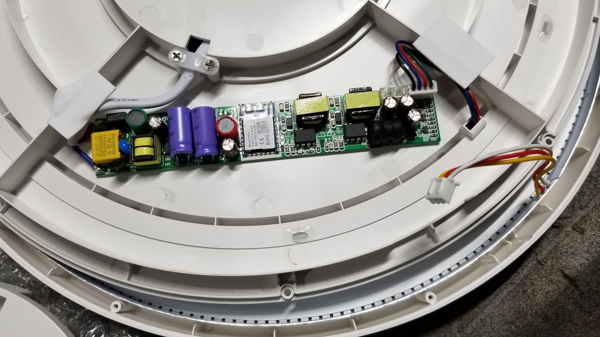

    Opening is the same as Taloya, remove the 8 screws.
    Interior of a cloned Taloya ceiling lamp with visible WB3S chip board.

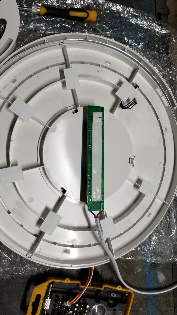

    Secured with double-sided tape so just pull off to remove.
    Ceiling lamp base of Taloya with visible circuit board.

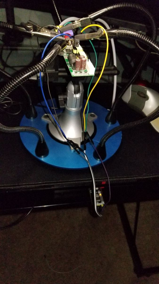

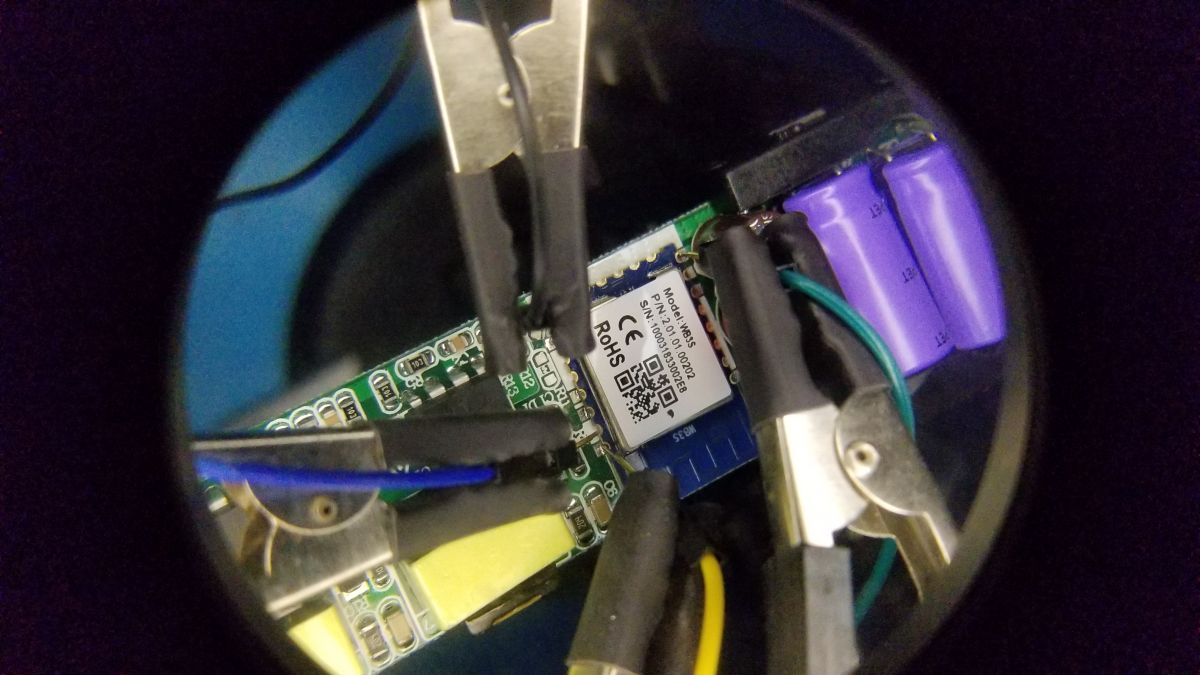

    As you can see the pads are really close to the capacitors, so rather than trying to solder wires, I used a third hand holding Dupont style breadboard jumper wires with 1.27mm pogo-pins stuck in one side, hooked up to an FD232 USB adapter and flashed with the BK7231 GUI flash tool.
    Circuit board with attached Dupont jumper wires and a robot arm.
    Close-up of an electronic circuit with a WB3S chip and connection wires.

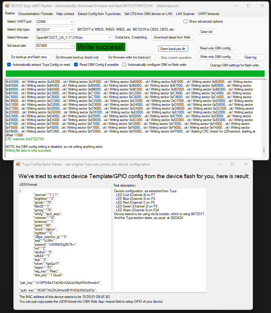

    BK7231T flasher interface with Write success result and extracted GPIO configuration.

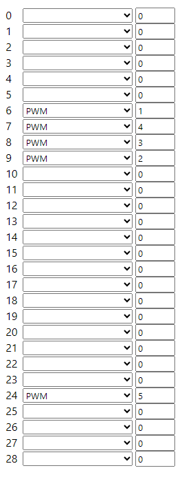

    After you flash, use the extracted pin configuration from the GUI Flash tool to set pins:
    - LED Cool (Channel 4) on P7
    - LED Blue (Channel 3) on P8
    - LED Red (Channel 1) on P6
    - LED Green (Channel 2) on P9
    - LED Warm (Channel 5) on P2
    Flag 12 to remember the last setting at power on.
    Pin configuration list for the Taloya ceiling lamp chip on a webpage.
    I did NOT have to set Flag 11 as I do not have an issue with the brightness, it's super bright on all settings.
