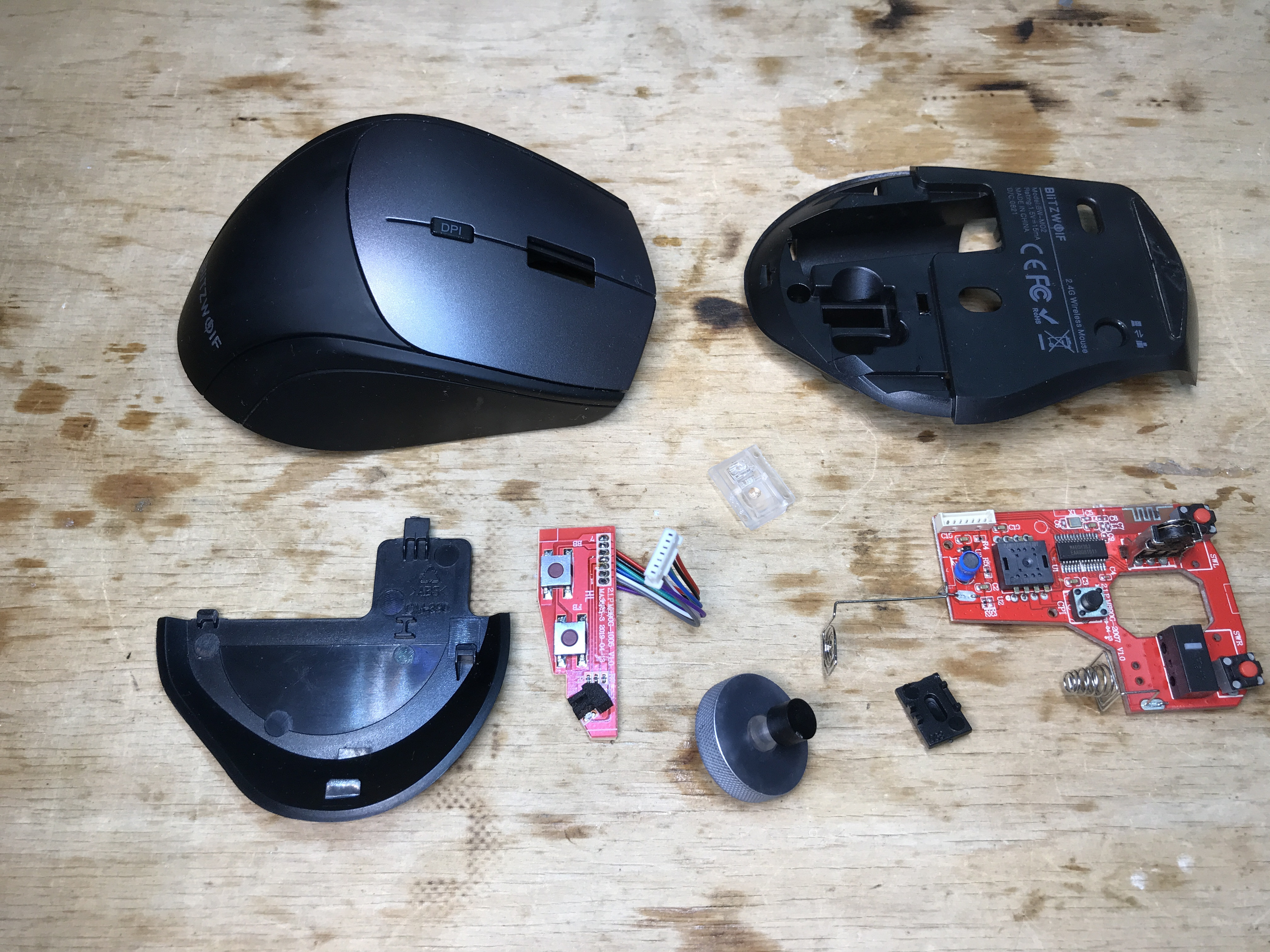

Disassembled parts of the BW-MO2 mouse on a wooden surface. BW-MO2 is a wireless mouse that is distinguished by the ability to control two computers, this control is switched by a small button on the bottom of the mouse. This mouse simply has two receivers - one for USB Type-C and the other for regular USB. This is very handy for me, as it allows me to operate two machines in the workshop at the same time, without installing solutions such as Barrier, Synergy or Mouse Without Borders.
Unfortunately, the mouse recently rebelled - so I had to look inside it and cleaned it on occasion. I invite you to a short photo gallery of the process.
Interior and cleaning of BW-MO2
There is only one screw on the bottom, on the other side holds the catch:

Unfortunately, the left mouse button continued to respond once in 3 attempts. I decided to replace it:
Circuit board from inside the BW-MO2 mouse on a wooden background
I didn't have such a button (or a matching one), and the mouse was needed "right away" so I cut the footrest out of plastic and soldered what I had:
Close-up of the BW-MO2 mouse circuit board with a replaced button.
After one fix and a few resizing, it worked. The mouse works like new.
