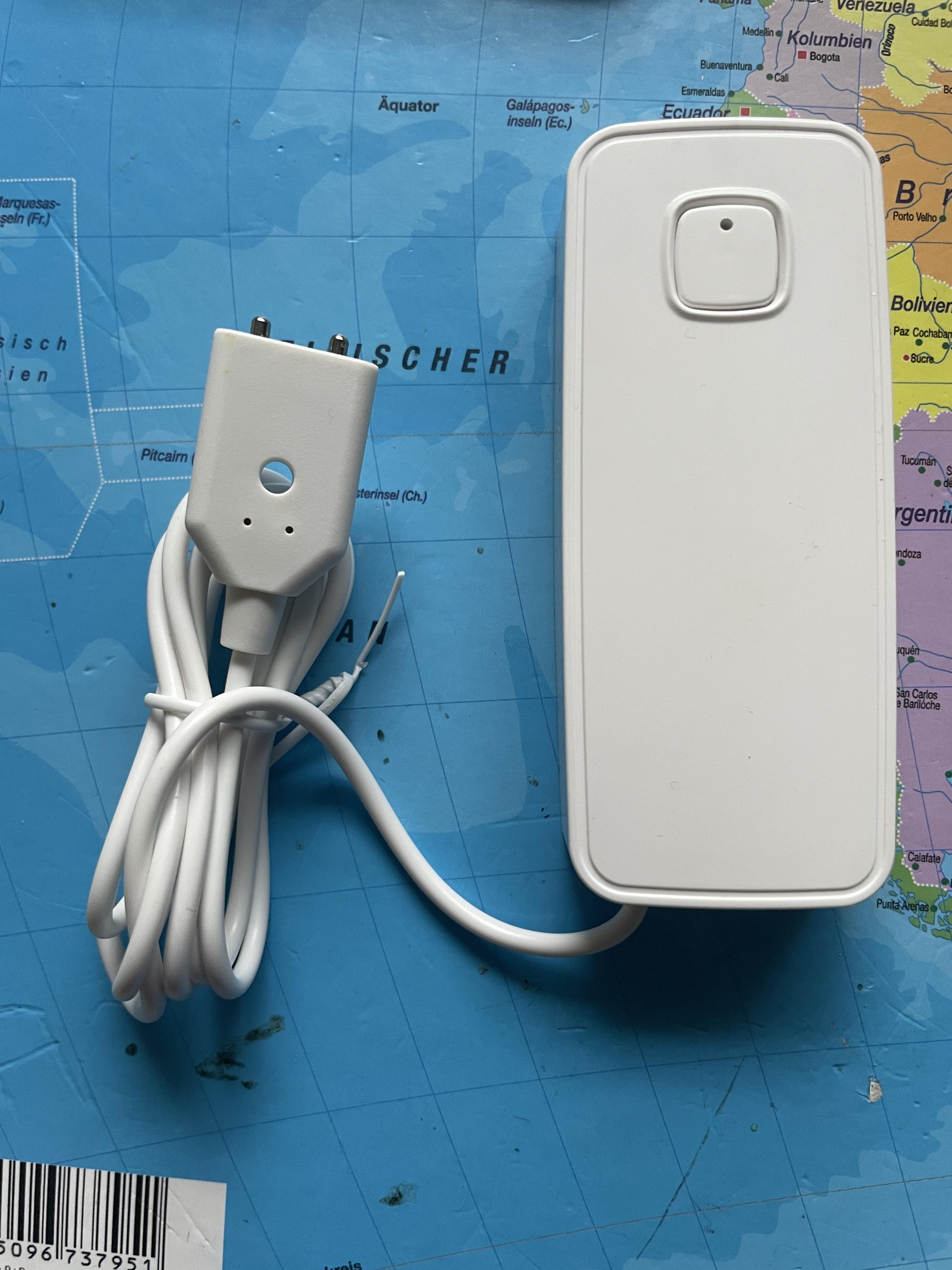

Just acquired another WiFi Water Leakage Detector from Aliexpress
https://de.aliexpress.com/item/1005005754072819.html
WiFi water leakage detector with a white sensor and cord on a map background.
which is a little different to this one here, but it essentially works the same way.
WiFi water leakage detector with open casing and packaging. Close-up of the water leakage detector PCB with labeled connections 3.3V, TX, RX, and Gnd.
It is powered with 2 AAA batteries, and as in the previous post, it simply goes to sleep, but does not wake up.
In order to make this work, I followed the same procedure as in the upper post and used a BC548 NPN transistor between 3.3V (+10k resistor), one pin from the sensor to base and the other one to the connector on the board.
Works as expected - goes to sleep, wakes up if you touch the sensor.
Close-up of a water leakage detector circuit board showing electronic components and wires.
The extraction from the flashing tool is incomplete and misses the relay, as the board has also a buzzer on the bottom. In order to use that one, you have to add it as a relay and configure it properly like this:

I don't know about battery consumption. I do NOT have any custom script, so I will see how long it "survives" without tweaking it.
