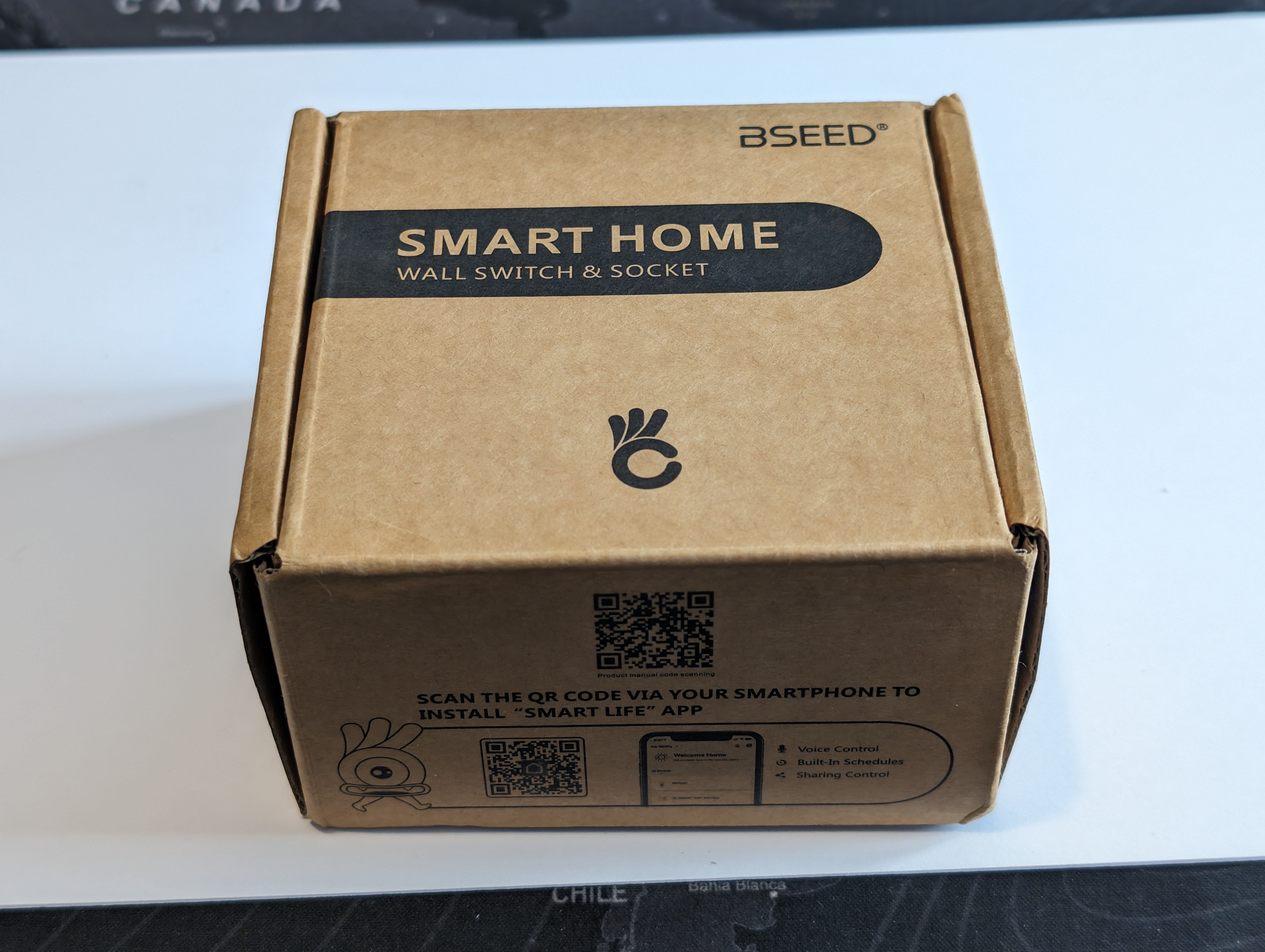

In this teardown I only had the 2 Gang version of the switch available.
Cardboard box labeled SMART HOME WALL SWITCH & SOCKET from BSEED.
Like a lot of the smart switches, this does require a neutral at the switch.
