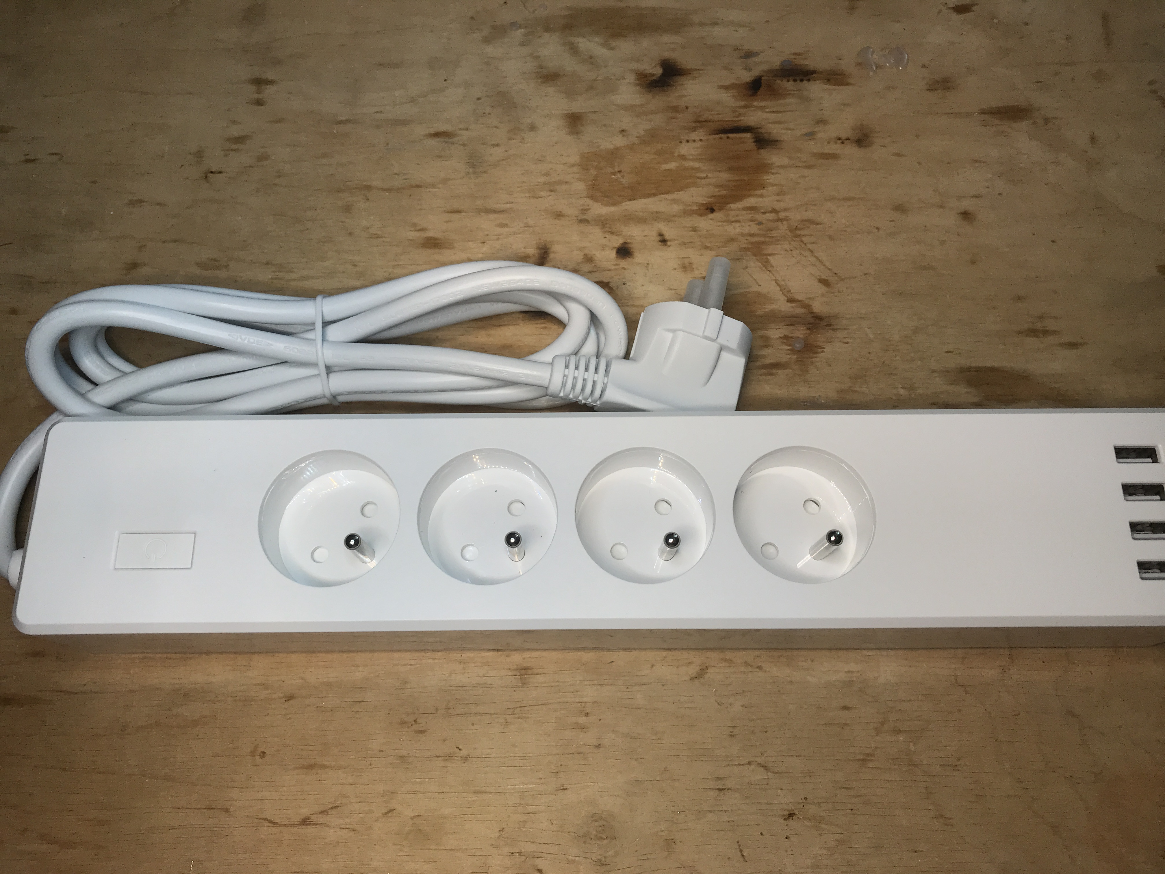

[TYWE2S/ESP8266] Woox R4027 four-slot WiFi controlled USB power strip
p.kaczmarek2  6 2157 Cool? (+5)
White four-socket power strip with built-in USB charger. I will present here the interior, a short test and a firmware change of a four-slot power strip/extender that also offers a rather powerful USB charger, all controlled via WiFi. This power strip allows us to control each socket individually and, in addition, to switch on or off the entire USB charger module, which is essentially built around five relays. In addition, I will also point out that the quality of this product is not as low as it usually is, there is even an overcurrent protection inside!
Purchase Woox R4027 In a Polish shop it costs 140 zł:
Woox Smart power strip with four sockets and four USB ports
The seller praises it very much, although in my opinion the downside is that it has to work with Woox cloud, but I will also solve this problem in this topic:
Woox Smart Power Strip WiFi with four AC sockets and four USB ports
Technical parameters, 4A USB current capacity?
Technical specifications of Woox R4027 power strip with built-in USB charger and WiFi features.
Let's see what the product looks like in practice:
Green packaging of Woox R4027 power strip with graphics and feature descriptions on the back. Green packaging of the Woox R4027 multi-socket strip with features described in multiple languages. Packaging of the four-outlet Woox R4027 power strip with USB charger. . Close-up of the Woox R4027 power strip technical specifications. Woox R4027 four-socket power strip with USB ports. Label of Woox R4027 power strip with technical data on a wooden background. Instructions:
User manual for Woox R4027 power strip. Woox Wi-Fi power strip user manual page. Instruction manual for setting up the Woox power strip with the app. Instructions for setting up the Woox R4027 smart power strip. User manual for Woox Smart Power Strip. Section of the user manual for the Woox R4027 smart power strip.
Current capacity test A short test with LD35 and LD25 loads shows, that the strip can provide up to 4.5A, which is 0.5A more than promised by the seller. This is very good.
Two load testers with LED displays on a table. Two electronic load testers with fans on a wooden surface. Two LD35 and LD25 test modules with LED displays showing current values. Interior of Woox R4027
List has screws hidden under the feet, but the screws require a triangular screwdriver:
Nameplate of the Woox R4027 power strip with technical specifications.
