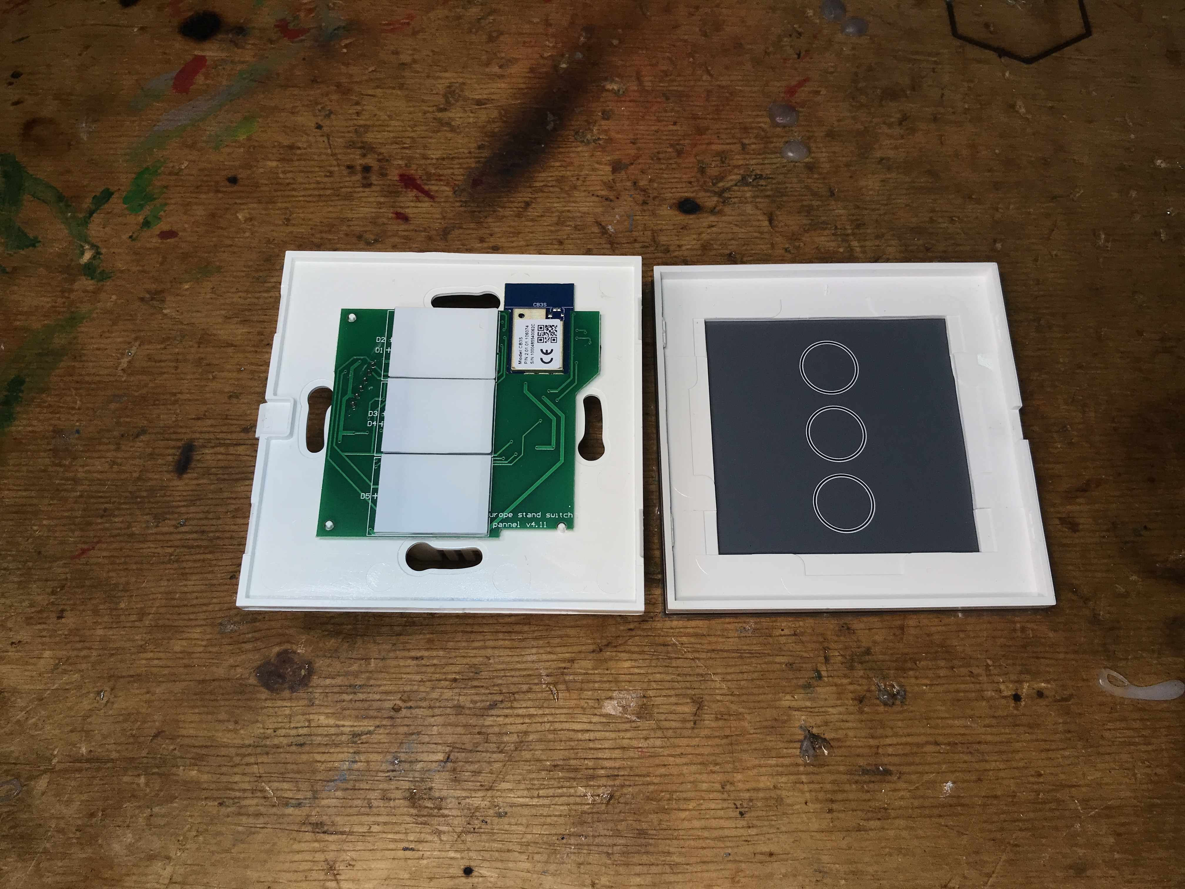

Interior of AVATTO TS02-EU-W3
We question the front:
Interior of AVATTO TS02-EU-W3 light switch with visible CB3S module.
There is a CB3S module inside, you can upload https://github.com/openshwprojects/OpenBK7231T_App
On the back of the PCB you can also see the button controller:
Interior of AVATTO TS02-EU-W3 switch with visible electronic components.
This chip is ADS TS04 2052:
Circuit board with a module and electronic components.
This time the AMS1117-3.3V is not on the front board, but together with the power supply, which here is based on OB25133JP:
Close-up of the internal components on a circuit board. Interior of the AVATTO TS02-EU-W3 switch with visible electronic components on the PCB. Close-up of a circuit board with several electronic components, including OB25133JP. Close-up of the circuit board inside the AVATTO TS02-EU-W3 switch.
so we have an isolated flyback converter here, this is quite typical in this type of switches, and in "smart switches" (modules) I often see non-isolated step down converters:
