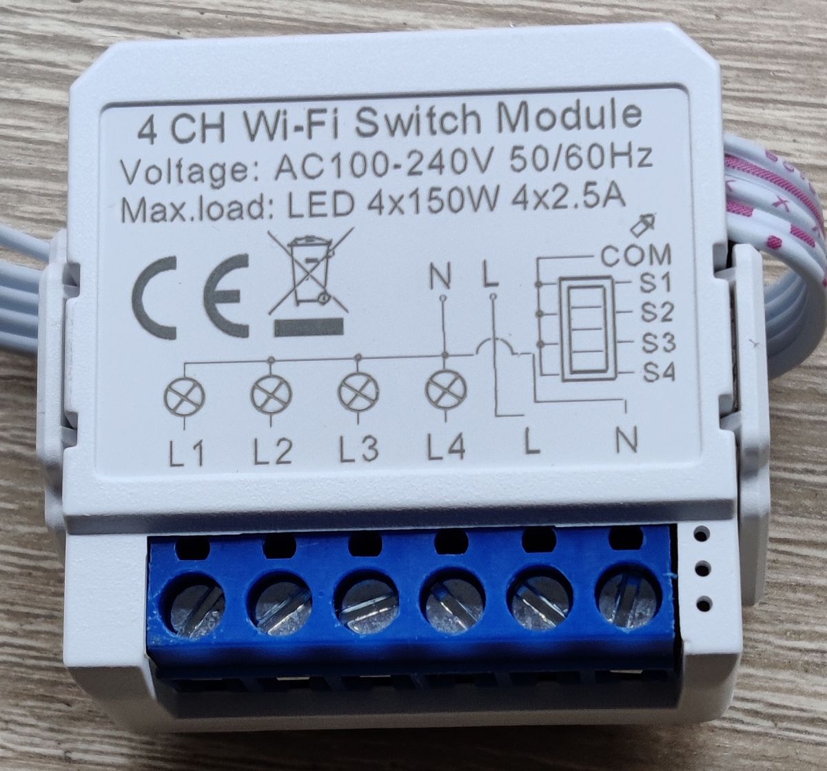

    Hey, guys!

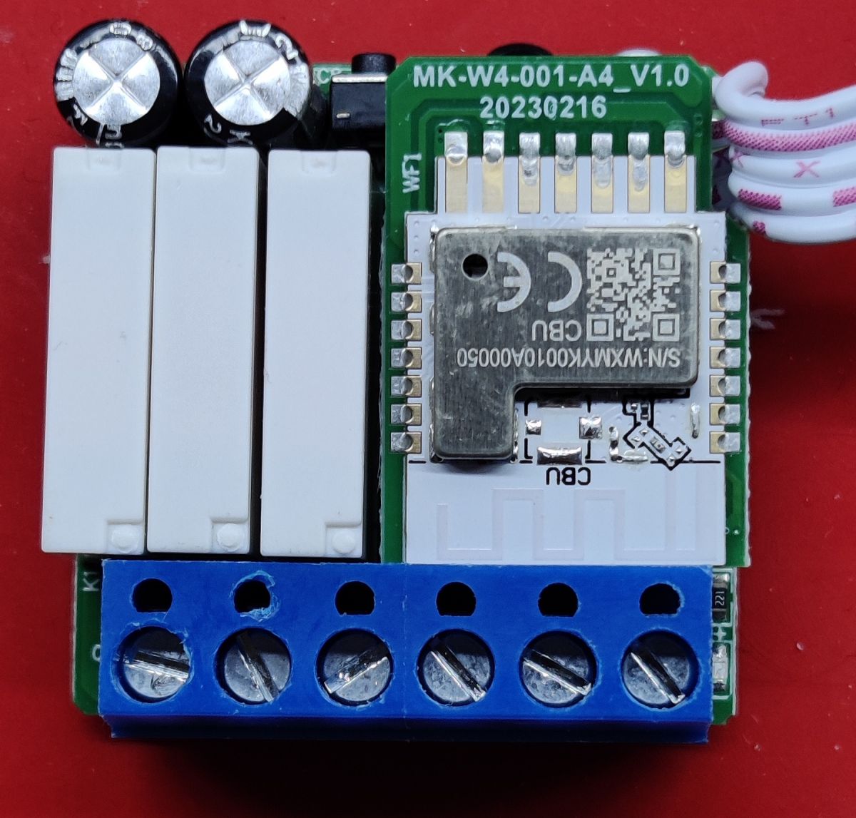

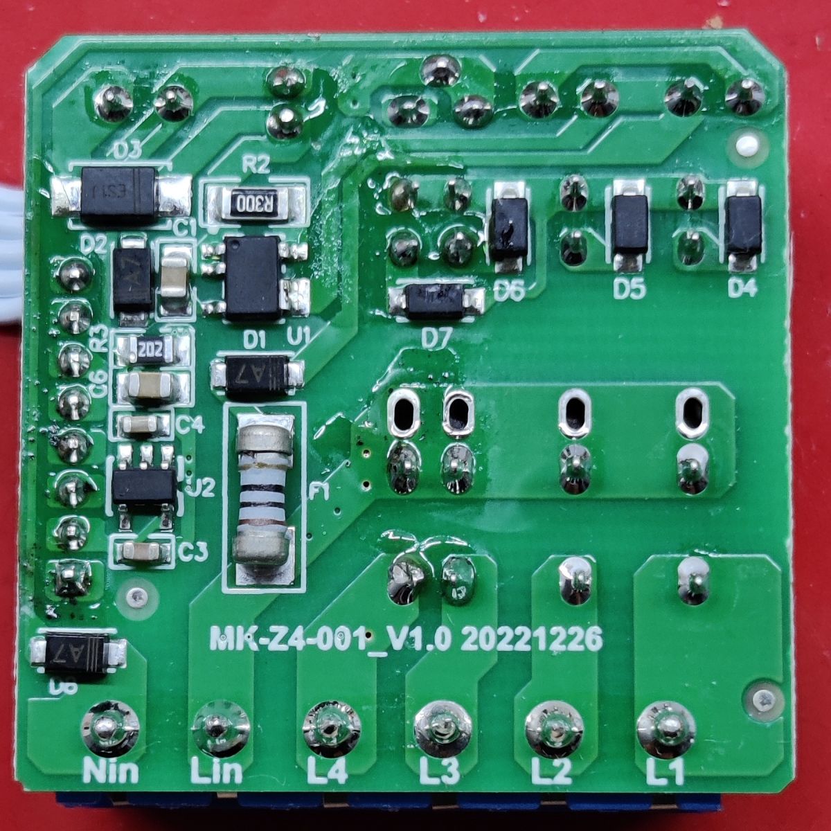

    Some AVATTO WSM16-W4 4-gang WiFi relay modules just arrived. I can't find one described here, so I added info about them here.
    I have 4 of them and have noticed they all have very weak WiFi signal. I have similar AVATTO modules 1- and 2-gang and WiFi signal is much stronger for them for the same conditions.
    This device is from already-known AVATTO series. 1- and 2-gang can be find in this forum:
    1-gang: https://www.elektroda.com/rtvforum/topic4044662.html
    2-gang: https://www.elektroda.com/rtvforum/topic4045441.html#21023178
    Here are some pictures
    Box of AVATTO 1CH Wi-Fi relay module.
    User manual for the WSM16-4 4-gang Wi-Fi switch module.
    AVATTO WSM16-W4 Wi-Fi relay module with connection designations.
    AVATTO WSM16-W4 relay module on a red background.
    Close-up of a circuit board with component labels.
    AVATTO WSM16-W4 Wi-Fi relay module on a red background.
    AVATTO WSM16-W4 relay module with visible cable connections and electronic components on the board.

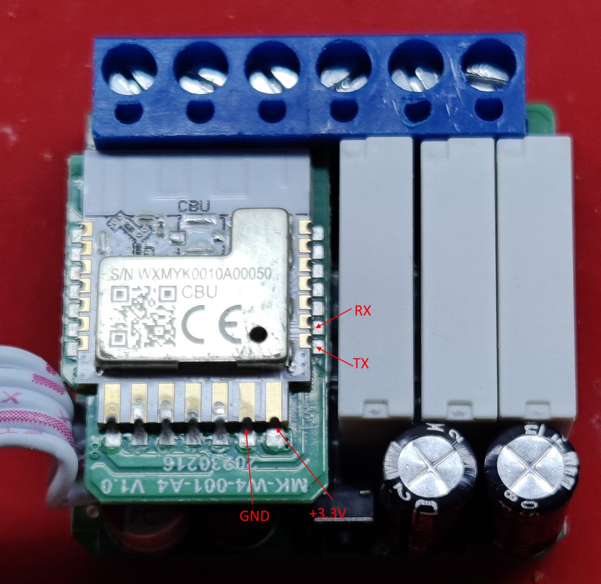

    Verbal description:
    - Pair/Toggle All Button on P8
    - TglChannelToggle (channel 4) on P22
    - TglChannelToggle (channel 1) on P14
    - TglChannelToggle (channel 2) on P16
    - TglChannelToggle (channel 3) on P23
    - Relay (channel 2) on P17
    - Relay (channel 1) on P20
    - Relay (channel 3) on P9
    - Relay (channel 4) on P28
    - WiFi LED on P6

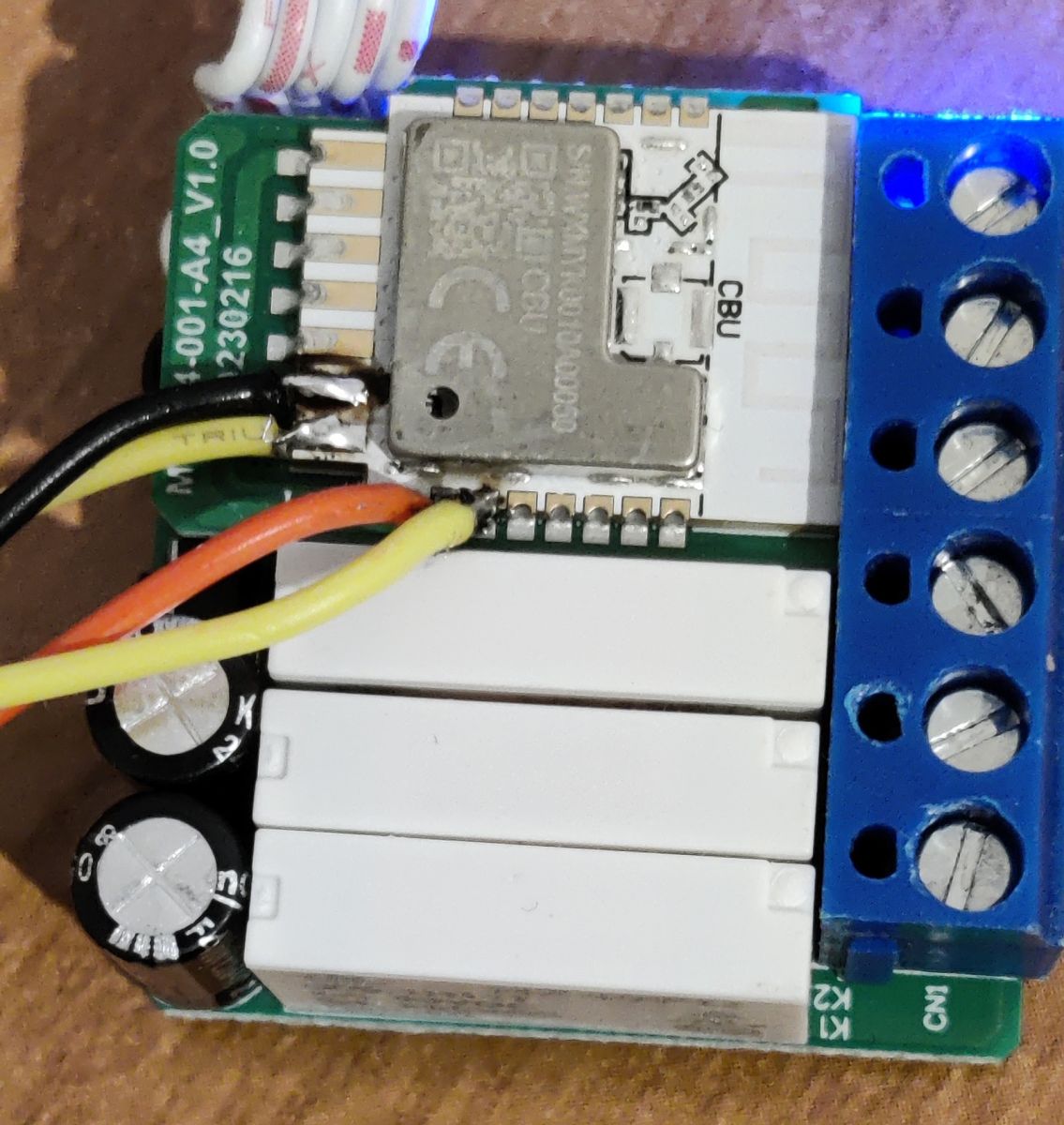

    Device seems to be using CBU module, which is using BK7231N.
    OBK Template:
      "vendor": "Tuya",
      "bDetailed": "0",
      "name": "AVATTO WSM16-W4",
      "model": "WSM16-W4",
      "chip": "BK7231N",
      "board": "CBU",
      "flags": "0",
      "keywords": ["Allegro"],
      "pins": {
        "6": "WifiLED_n;0",
        "8": "Btn_Tgl_All;0",
        "9": "Rel;3",
        "14": "TglChanOnTgl;1",
        "16": "TglChanOnTgl;2",
        "17": "Rel;2",
        "20": "Rel;1",
        "22": "TglChanOnTgl;4",
        "23": "TglChanOnTgl;3",
        "28": "Rel;4"
      "command": "PowerSave 1",
      "image": "https://obrazki.elektroda.pl/1384267700_1736605394.jpg",
      "wiki": "https://www.elektroda.com/rtvforum/viewtopic.php?p=21388042"
