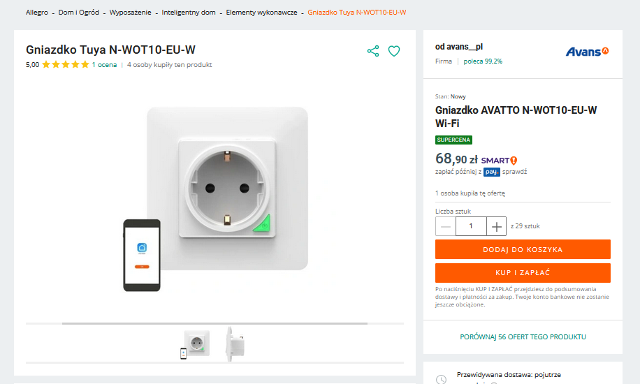

    Purchase AVATTO socket N-WOT10-EU-.W I received several pieces of this socket from a reader to upload his OBK, but normally this gadget costs PLN68:
    AVATTO N-WOT10-EU-W electrical socket and its price on a website.

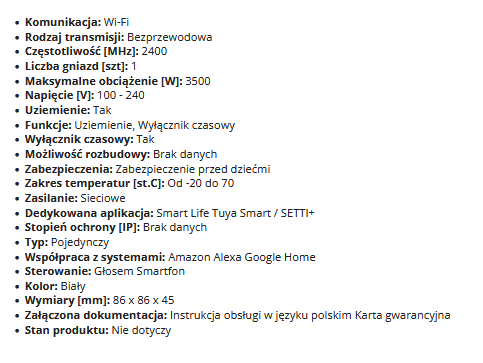

    Short specification, dimensions:
    Technical specifications of the AVATTO N-WOT10-EU-W electric socket. Let's see what we get after ordering:

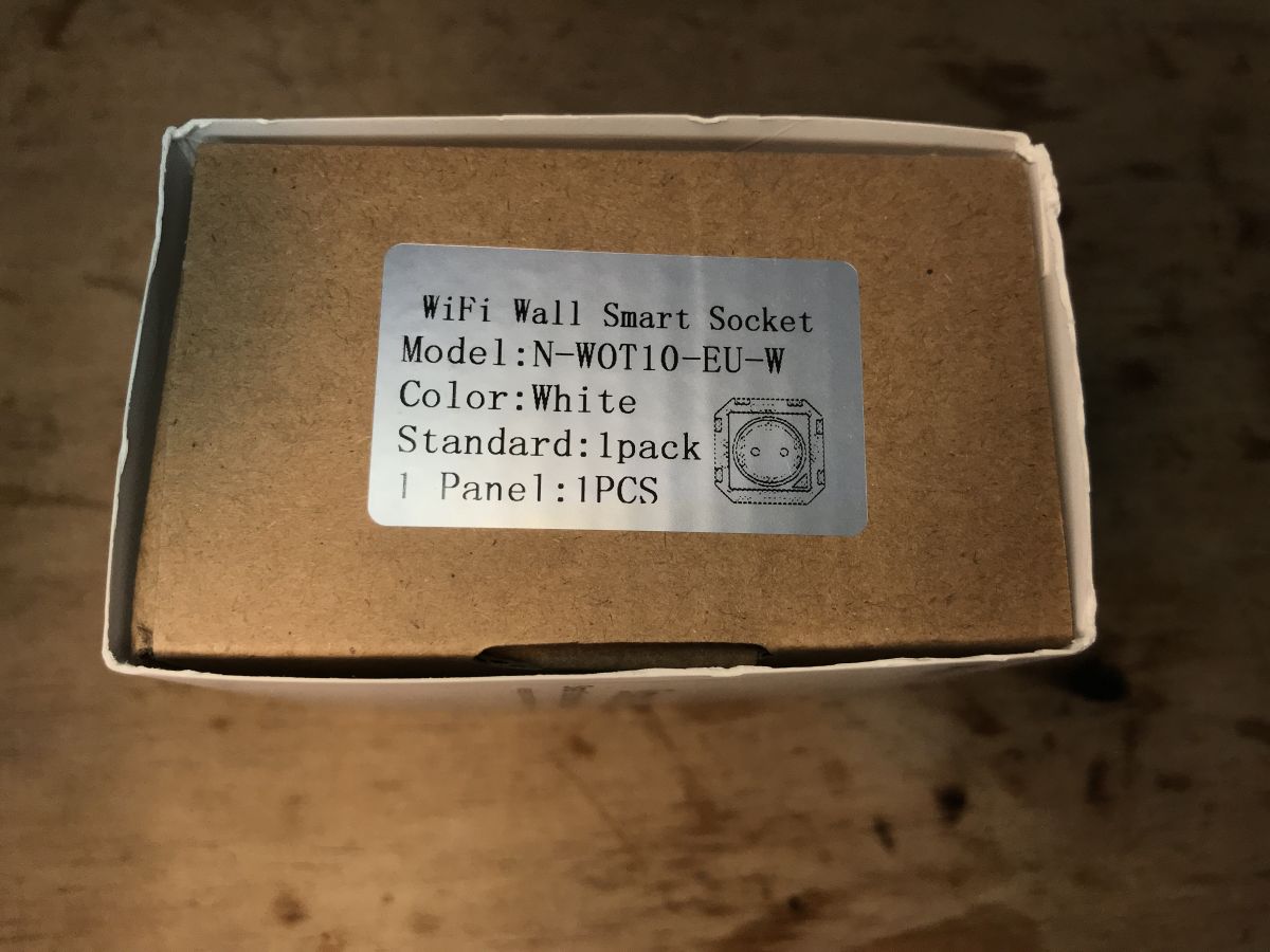

    AVATTO N-WOT10-EU-W socket packaging with importer label. AVATTO Smart Home product box on a wooden surface. AVATTO N-WOT10-EU-W socket packaging with manufacturer label. Full designation: N-WOT10-EU-W:
    Packaging of AVATTO N-WOT10-EU-W socket with label

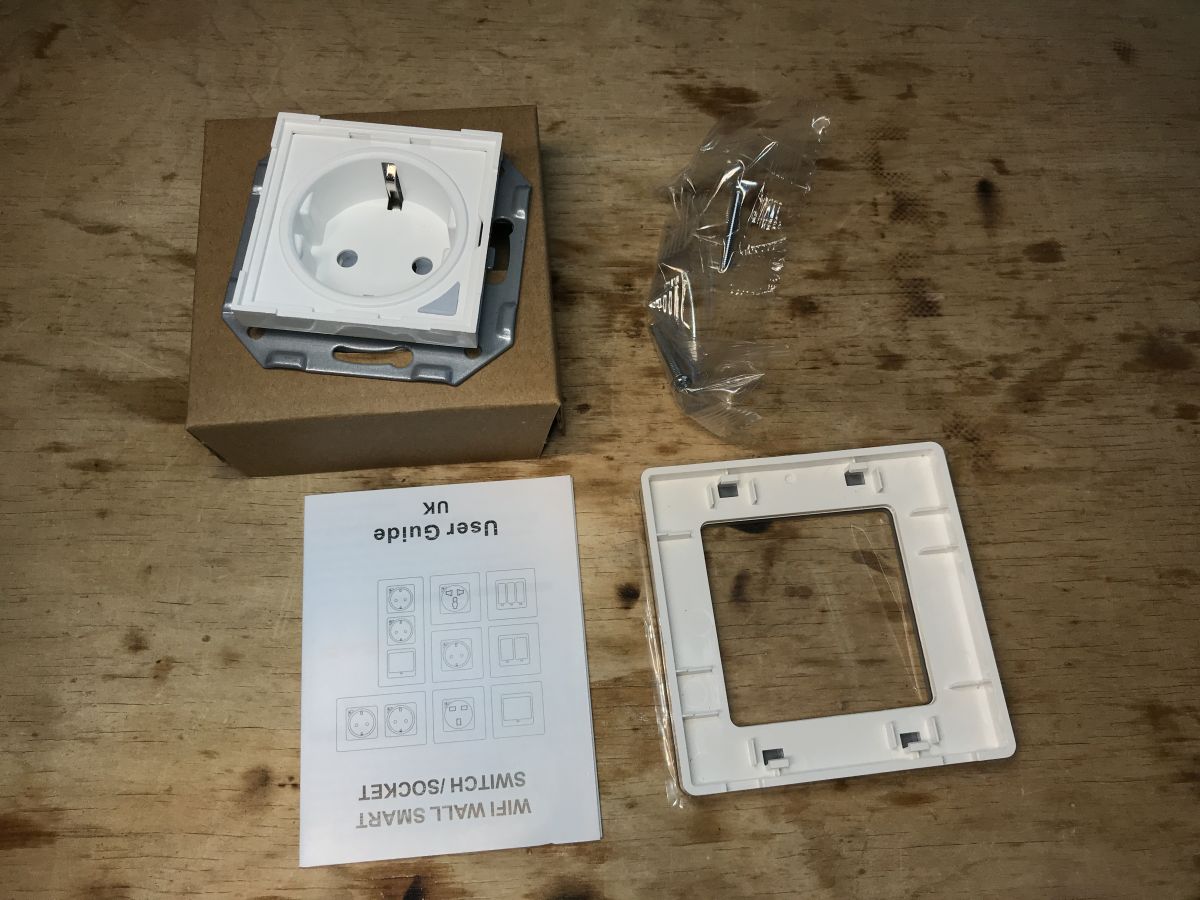

    Content:
    AVATTO N-WOT10-EU-W electrical socket in a box with manual.
    There is a manual in Polish:

    The whole set:
    AVATTO N-WOT10-EU-W socket set with instructions

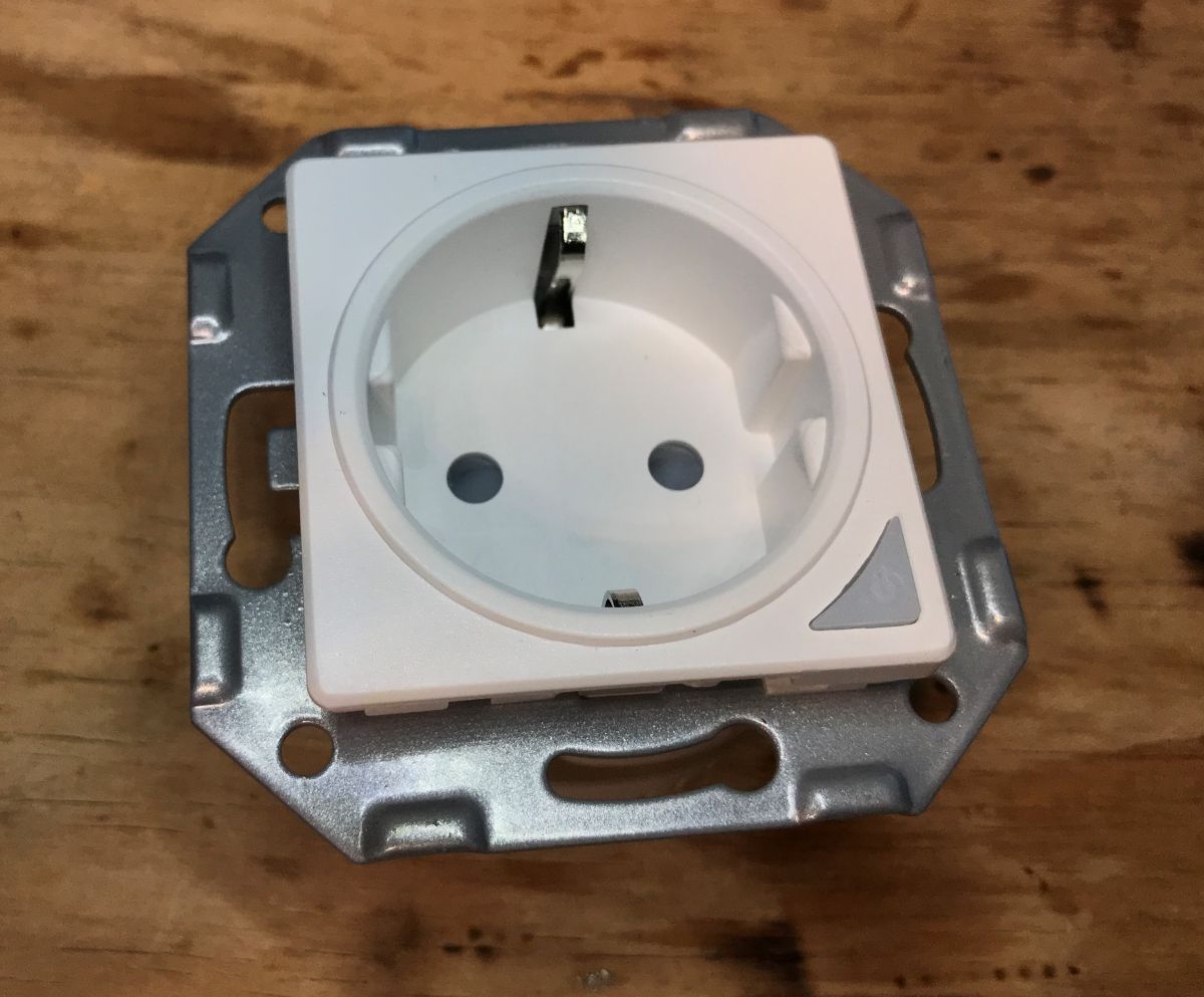

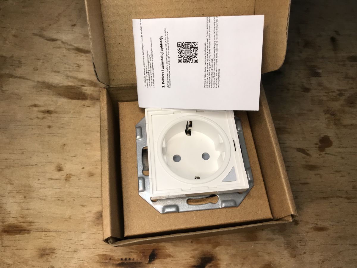

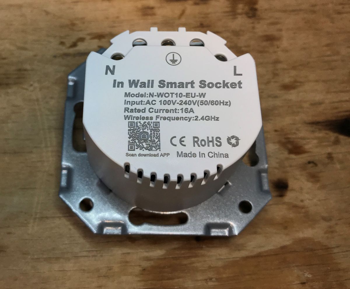

    Well, and the socket itself:
    AVATTO N-WOT10-EU-W electrical socket with WiFi and measurement features. AVATTO N-WOT10-EU-W socket with energy measurement capability

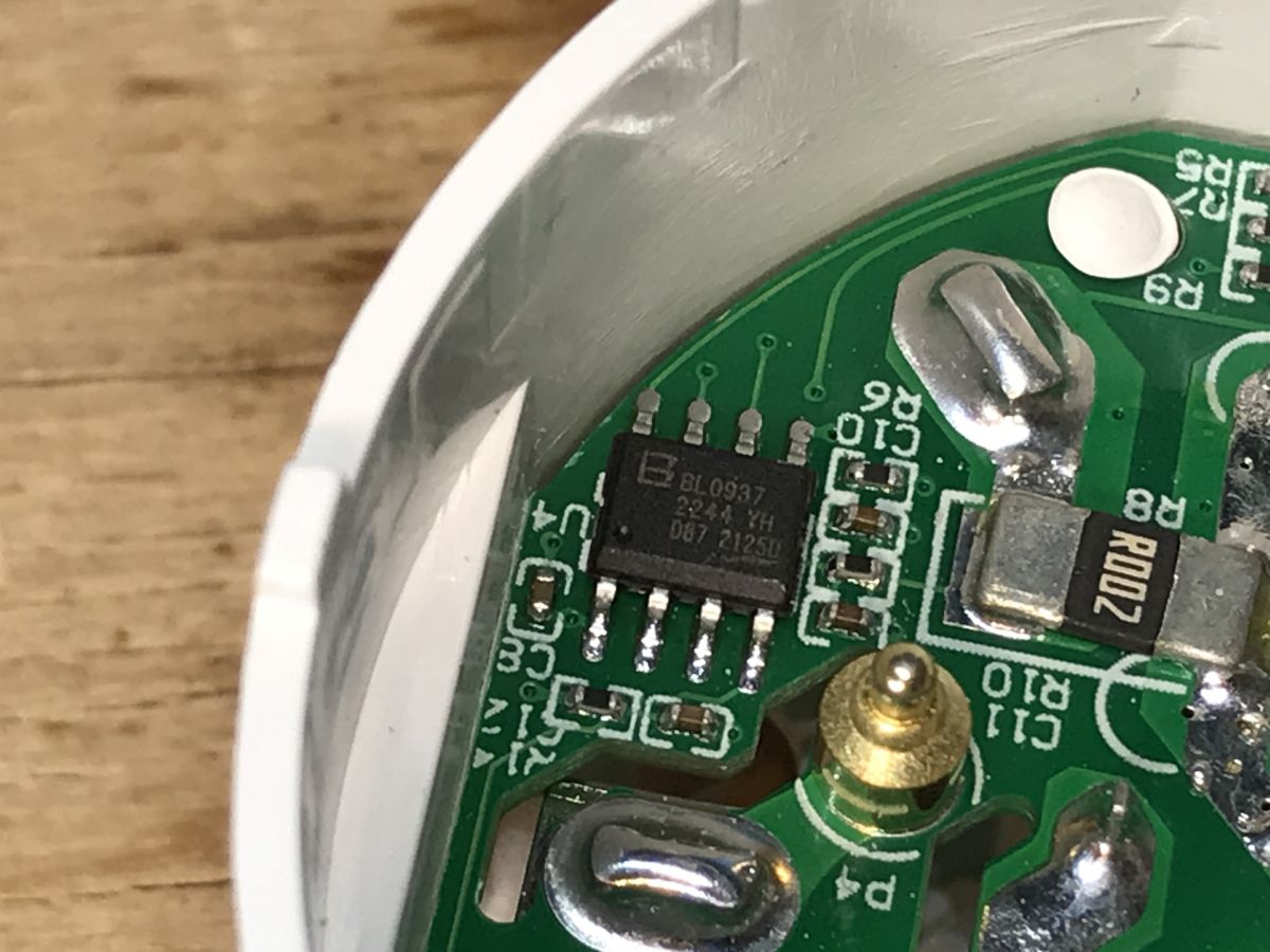

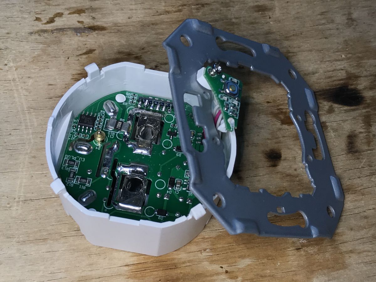

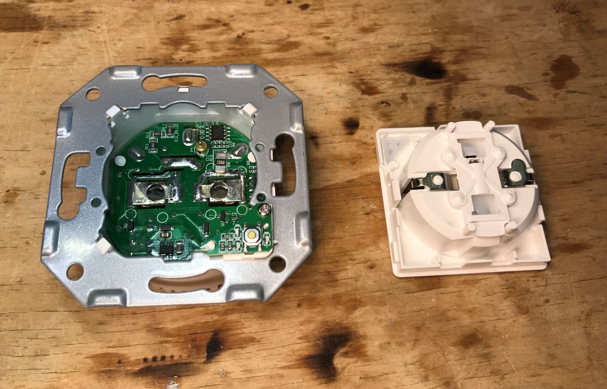

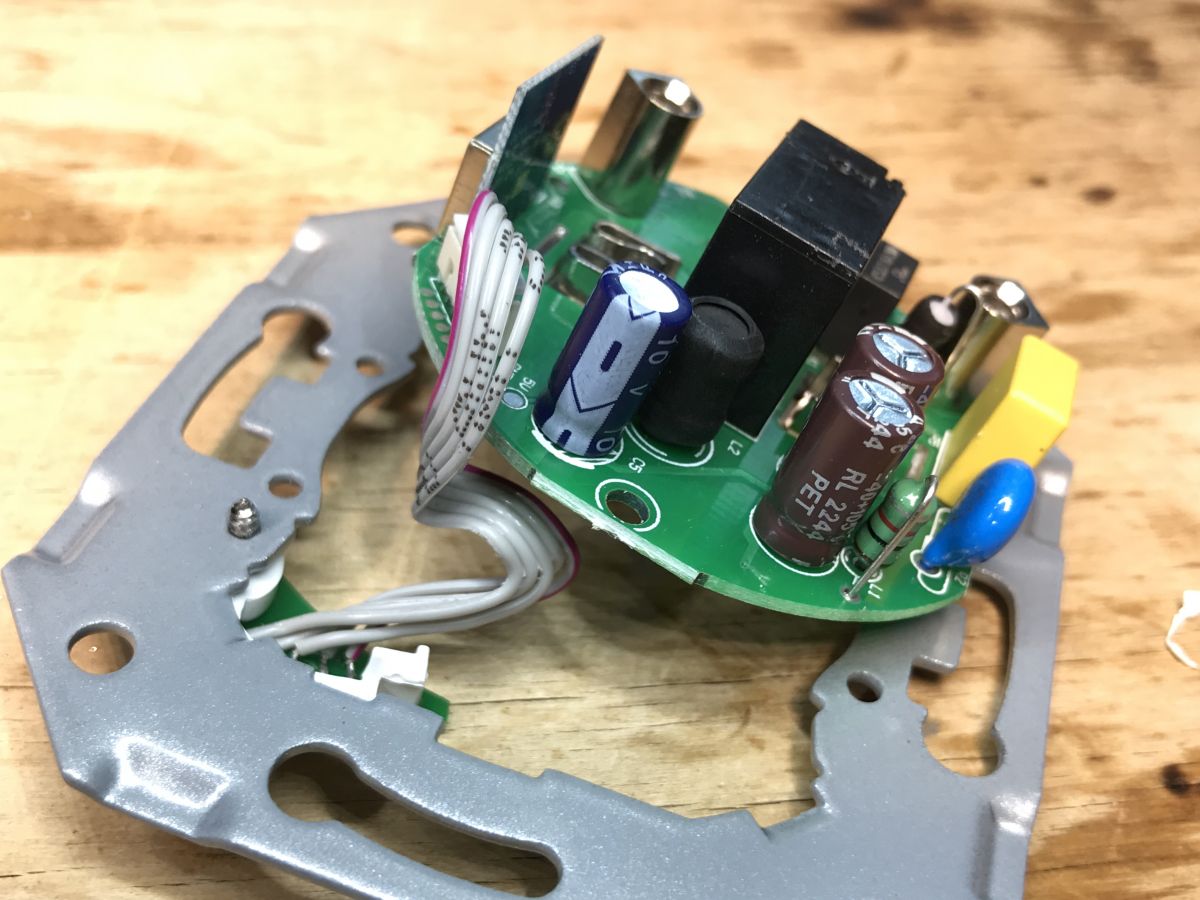

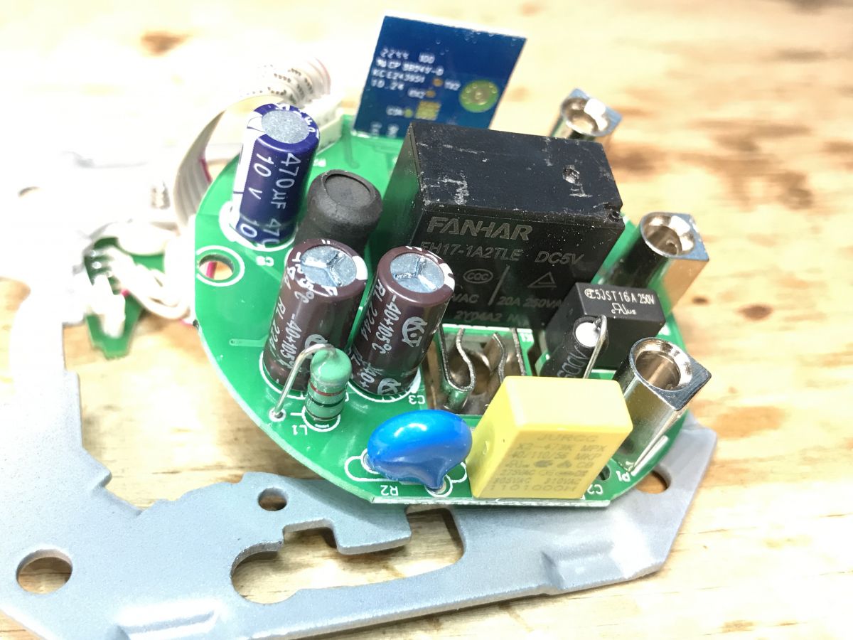

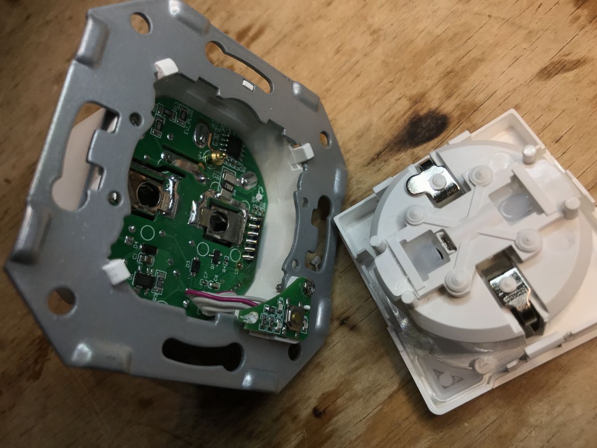

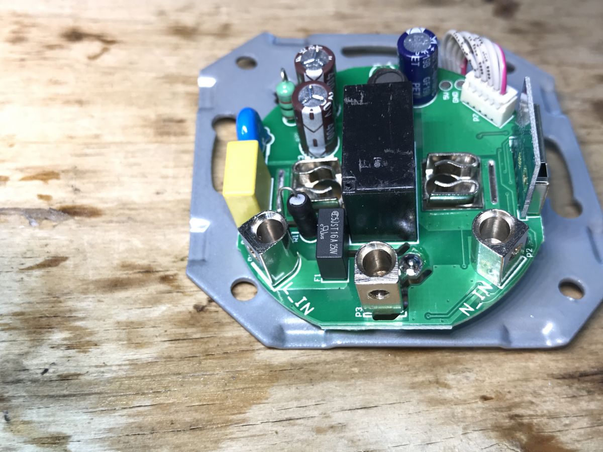

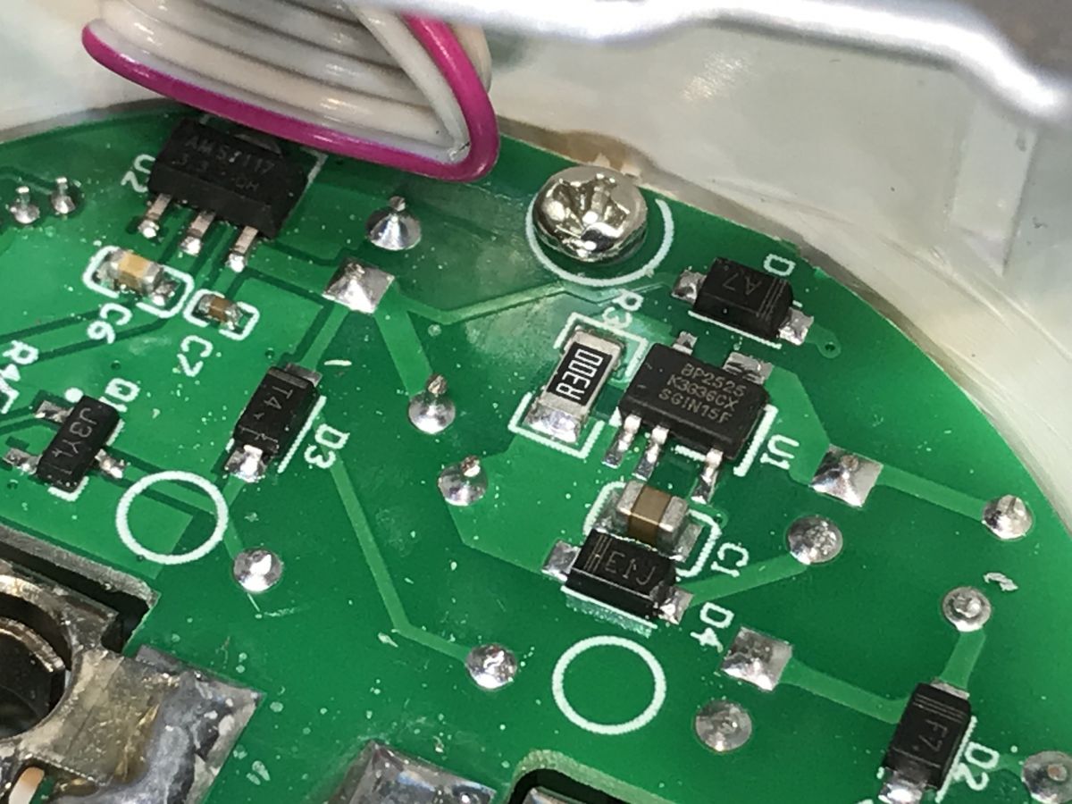

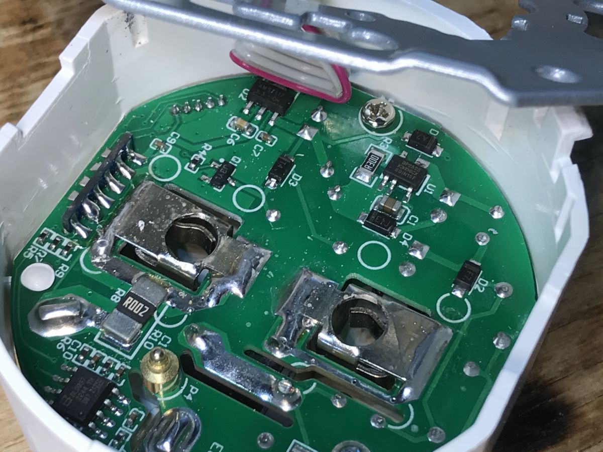

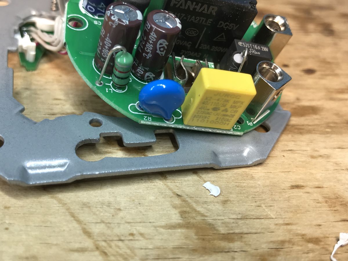

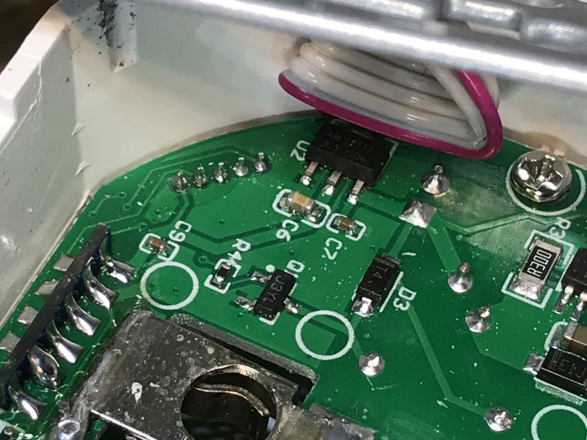

    Interior and firmware change I thought, that I would again be analysing a new PCB version and creating a new GPIO template, but not this time.
    This socket is practically identical to the Kraslaw piece already discussed:
    [BK7231N/CB2S] Socket with energy measurement SWP86-01OG For sure, vendors simply order the same products in China and then put their logo on them.
    Thus, I will simply just post pictures from the inside here:
    View of disassembled AVATTO N-WOT10-EU-W electrical socket with exposed PCB. Interior of AVATTO N-WOT10-EU-W electrical socket with visible PCB layout.
    Interior of AVATTO N-WOT10-EU-W electrical socket showing PCB. Circuit board with electronic components inside the AVATTO N-WOT10-EU-W socket. Close-up of the interior of an electrical socket with visible electronic components. Interior of AVATTO N-WOT10-EU-W electrical socket with visible PCB layout. Interior of AVATTO N-WOT10-EU-W socket showing PCB and electronic components. Interior of the AVATTO N-WOT10-EU-W electric socket with visible electronic components. Interior of the AVATTO N-WOT10-EU-W power socket with visible electronic components Close-up of the interior of an electrical socket with visible electronic components. Interior of the AVATTO N-WOT10-EU-W electrical socket with electronic components on the PCB
    All as in SWP86-.01OG.

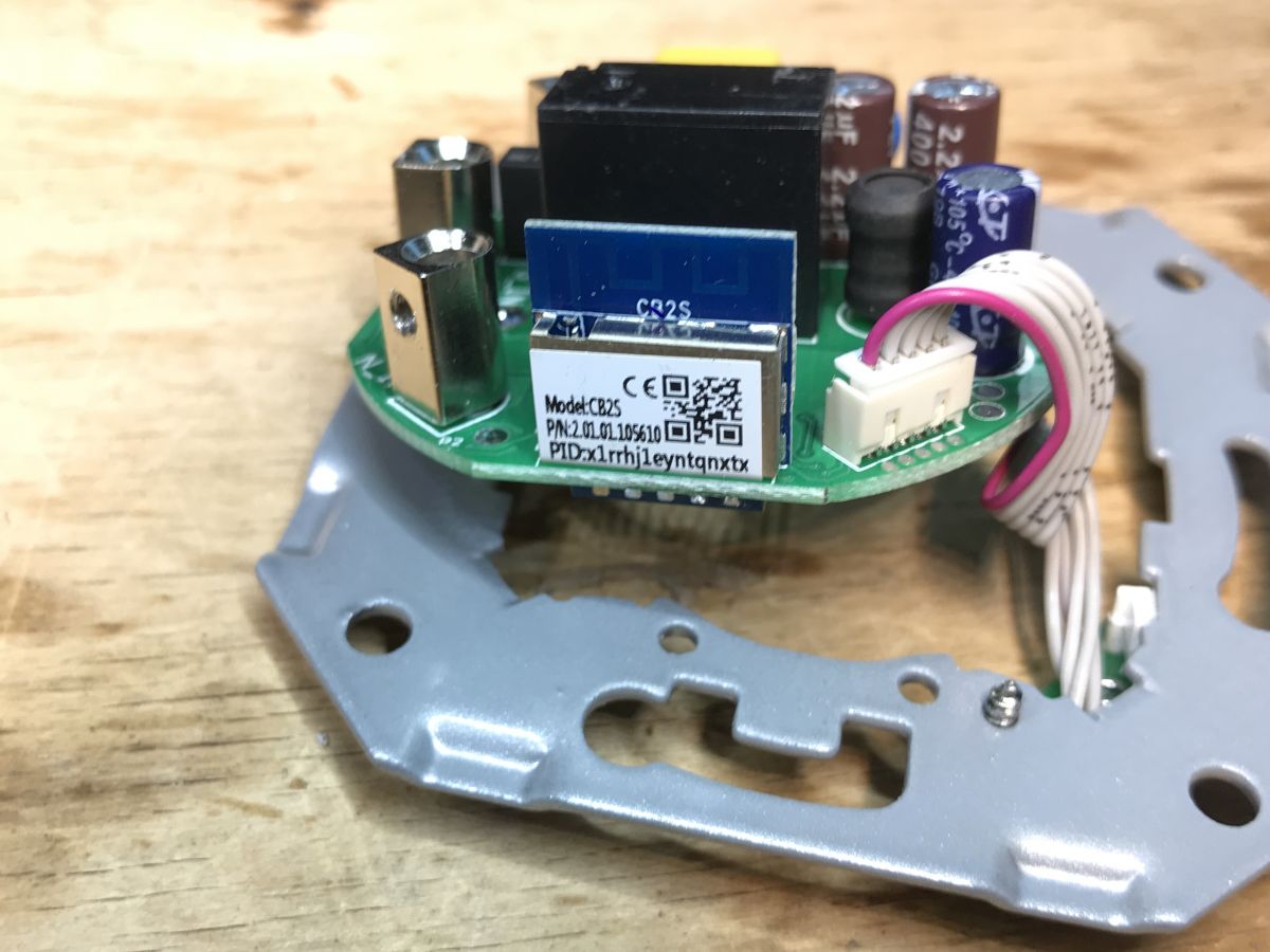

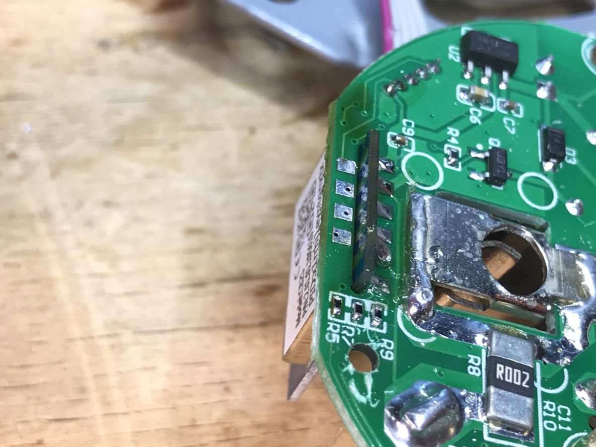

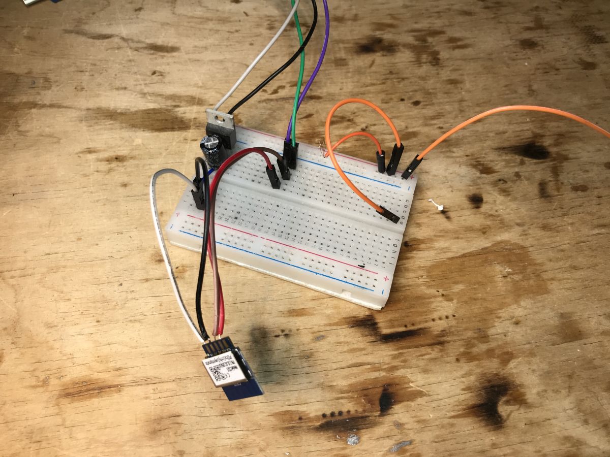

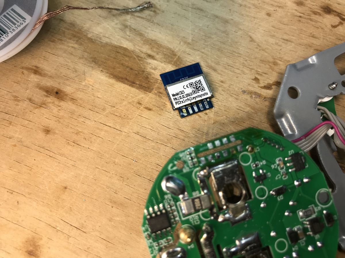

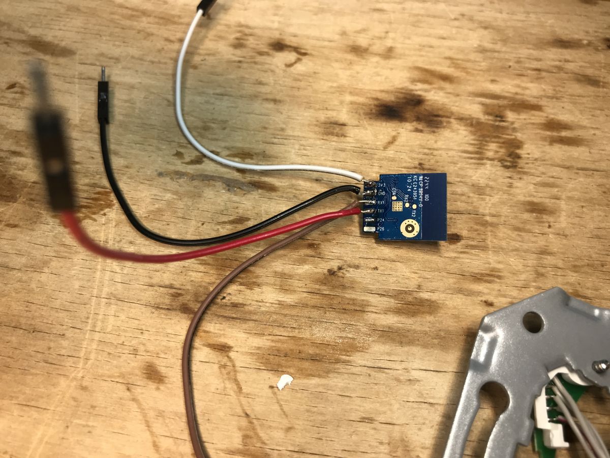

    In order to change the firmware I soldered out CB2S:
    Close-up of the interior of the AVATTO N-WOT10-EU-W electrical socket showing electronic components on the PCB. Close-up of the interior of the AVATTO N-WOT10-EU-W electrical socket. Interior of AVATTO N-WOT10-EU-W socket with the CB2S WiFi module removed. CB2S module with wires soldered to pins. Close-up of a breadboard with connected wires and electronic components.

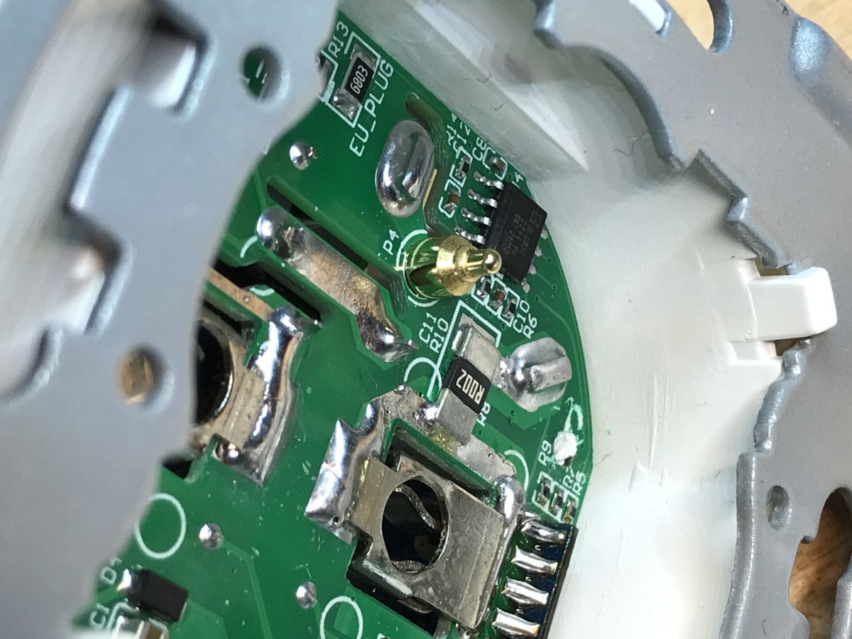

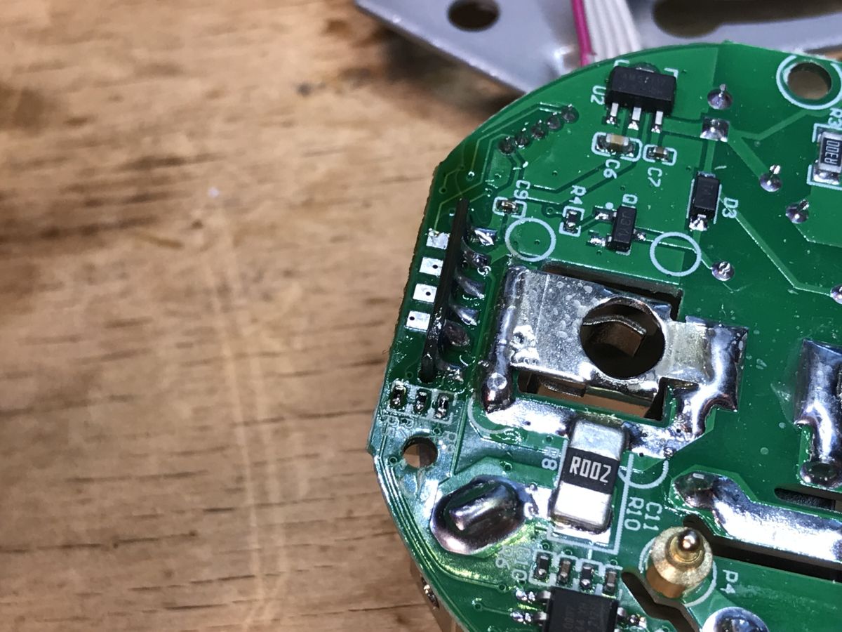

    I liked this mechanism for connecting the earth, there is a small pin on a spring that presses against the plate:
    Interior of the AVATTO N-WOT10-EU-W electrical socket showing the PCB. Inside view of the AVATTO N-WOT10-EU-W electrical socket.
    Other than that - all unchanged.

    The rest of the comments rather like the previous review - it's not so bad, in this type of product a varistor is a luxury.
