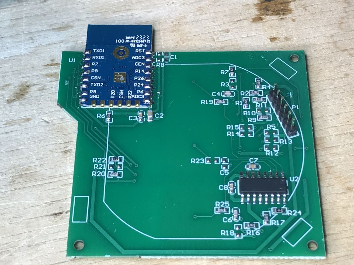

  • PCB of the TS02-EU-B2 dual black light switch with visible CB3S module.

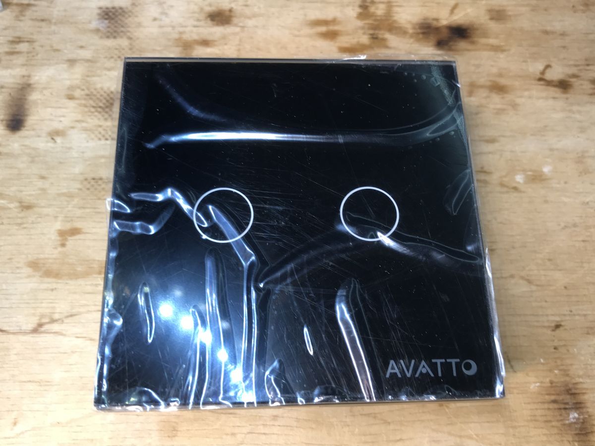

    Dual black WiFi light switch Avatto TS02-EU-B2 with product details.
    Product description - standard, but our goal is to change the firmware, so it does not concern us. This SETTI+ application is interesting, I haven`t tested it yet, but it`s probably another clone of the Tuya application.
    Black touch light switch AVATTO TS02-EU-B2 with two circular buttons and a smartphone beside it.

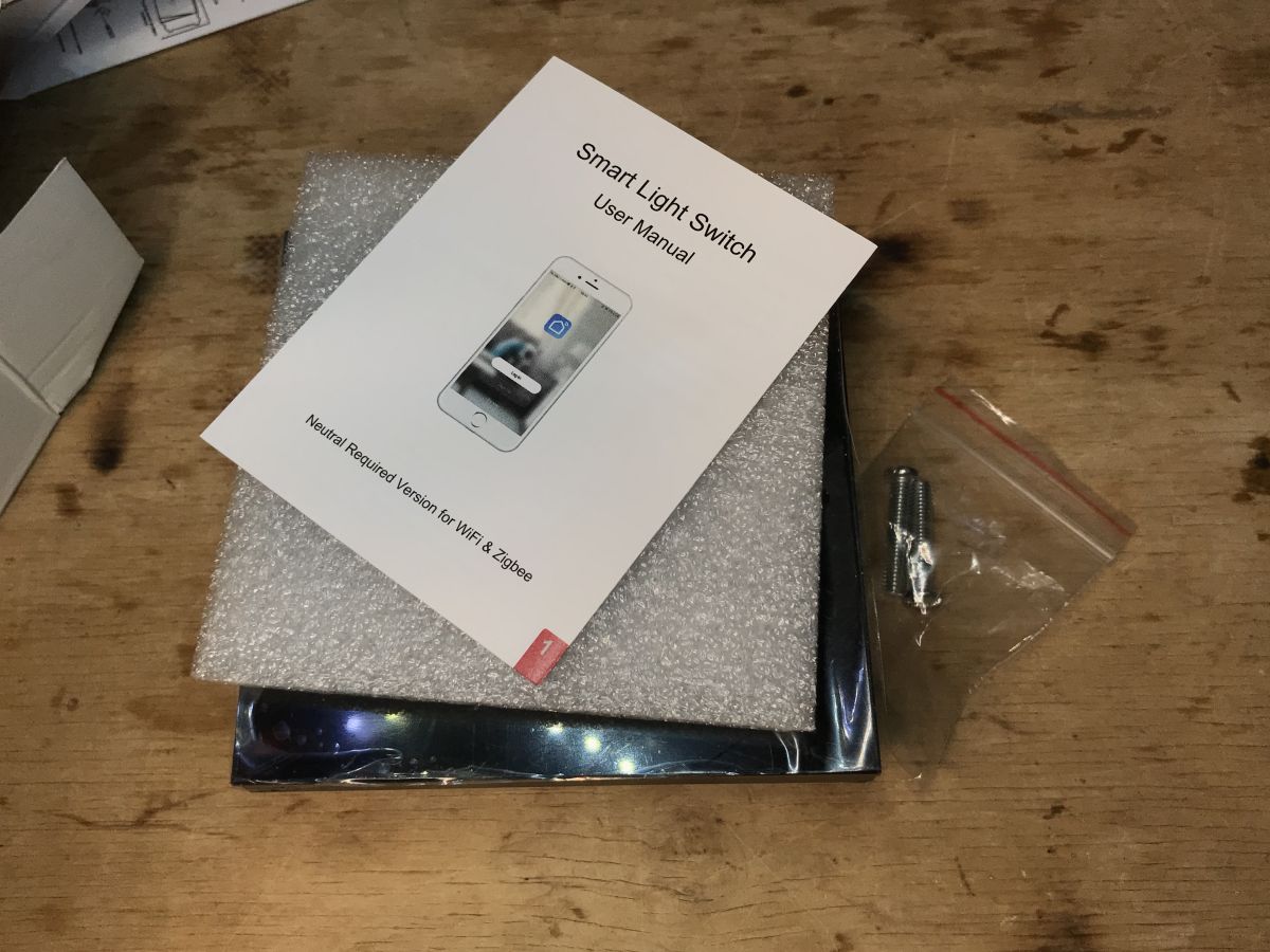

    The set includes mounting screws:
    Instruction manual and accessories for a black dual light switch.

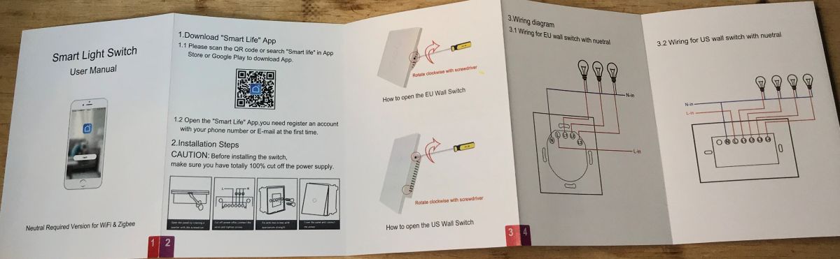

    Manual EN:
    WiFi light switch instruction manual with app guide User manual for a smart light switch in English.

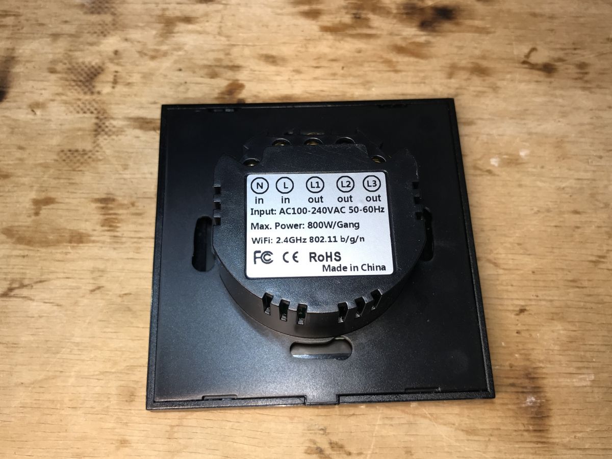

    And the switch itself:
    Black double light switch in packaging. Black dual light switch TS02-EU-B2 from the back on a wooden background.

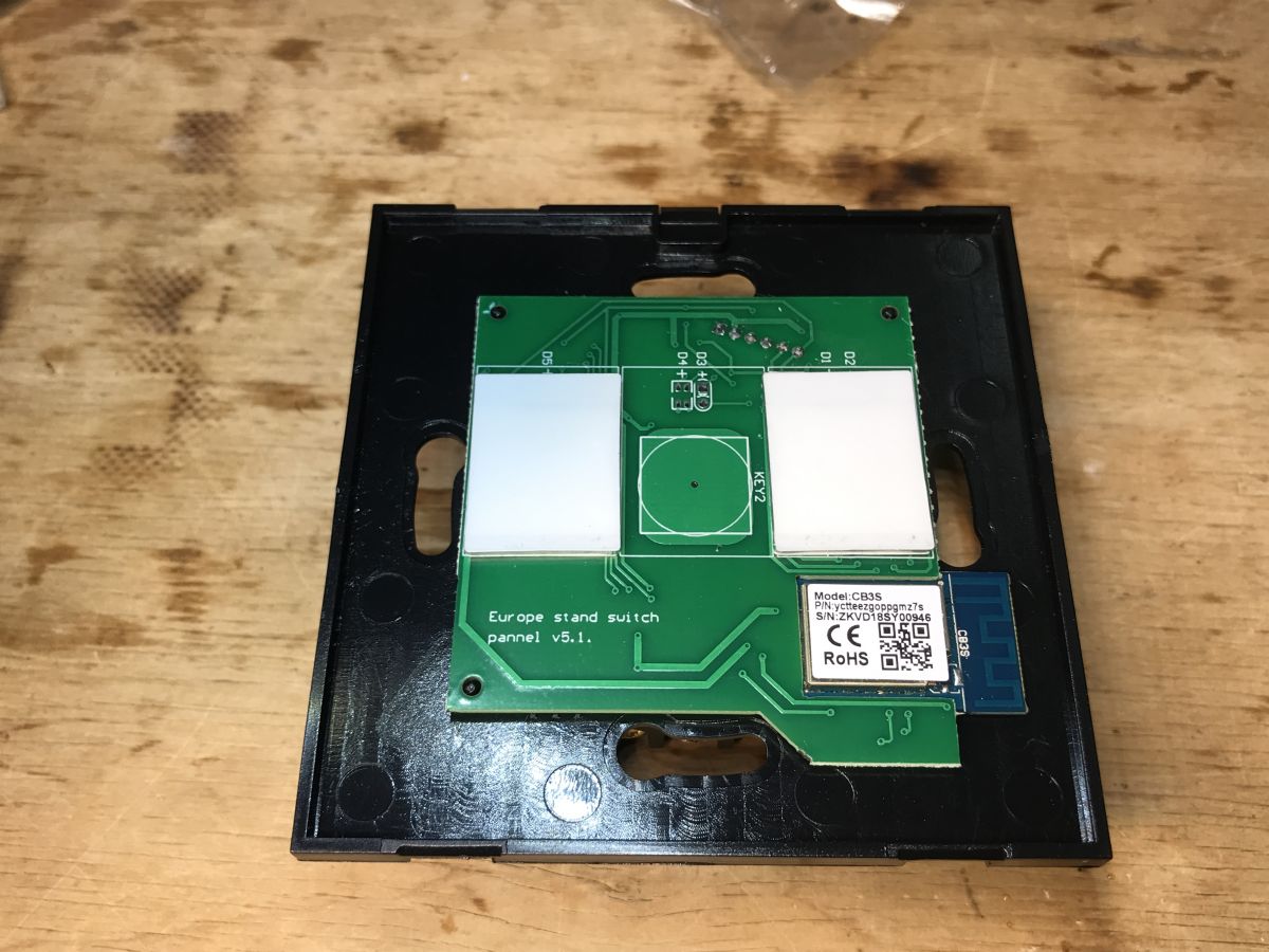

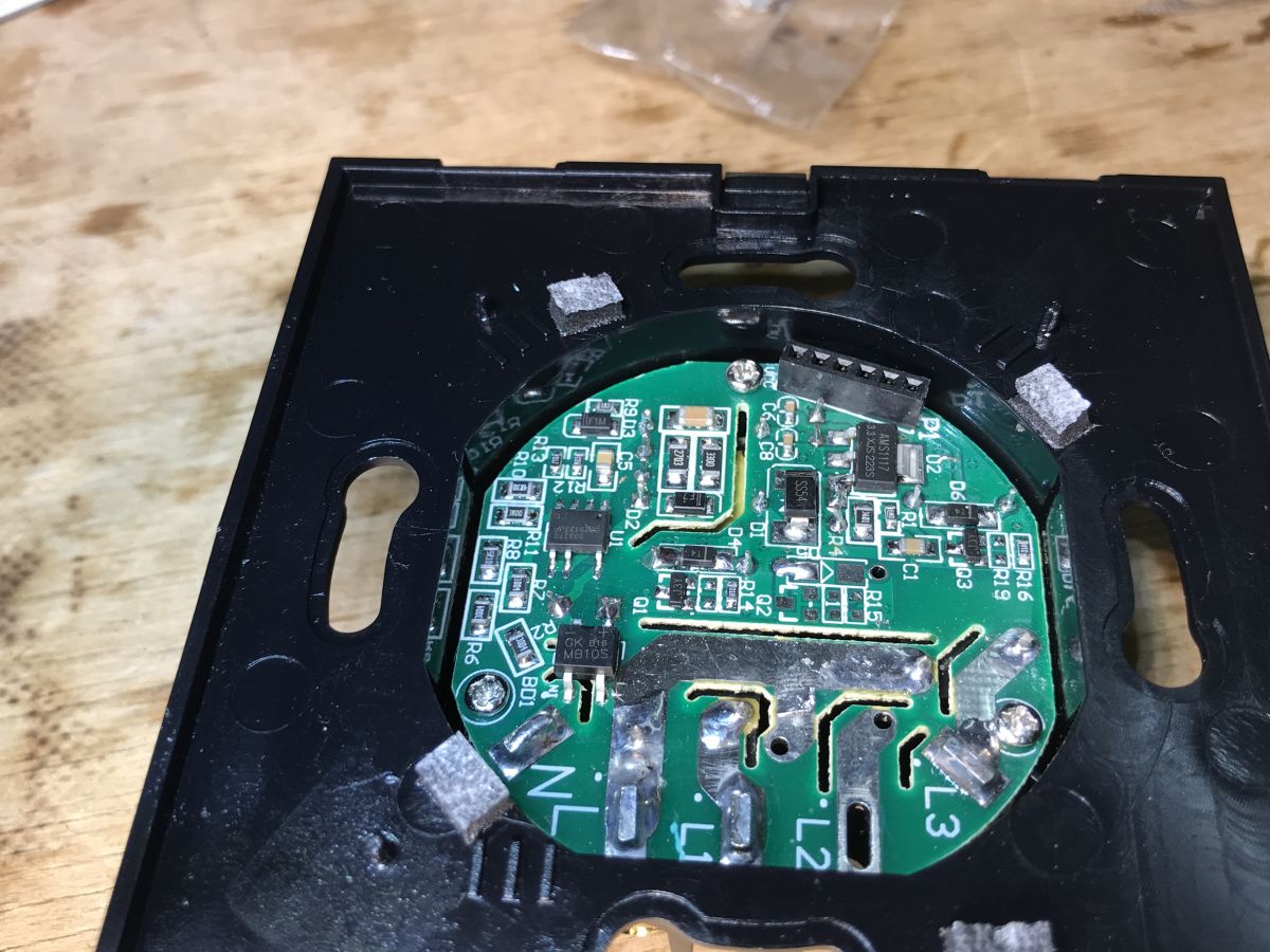

    Interior of TS02-EU-B2
    We are taking off the front. By the way, we also compare with white, triple version : :
    Close-up of the internal components of the black dual light switch TS02-EU-B2.
    The WiFi module is the same. One button simply wasn`t installed.
    Circuit board of TS02-EU-B2 switch with visible CB3S WiFi module.
    On the other hand, the tile is slightly different. The button controller has no marking, it has two more pins, and the element numbers on the descriptive layer have also changed.

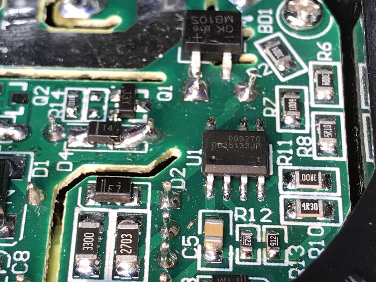

    Close-up of a PCB in the dual black light switch TS02-EU-B2 featuring the OB25133JP chip.

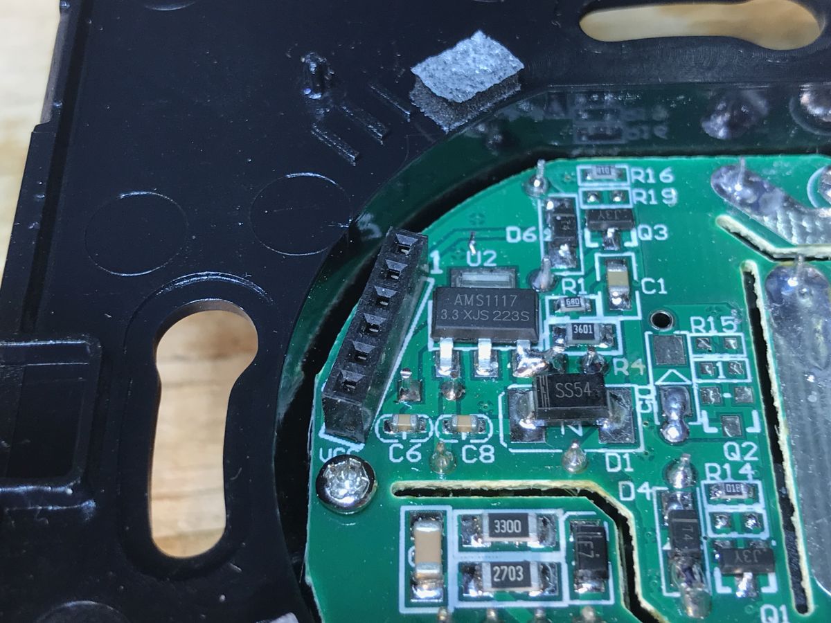

    The power supply is based on OB25133JP. It`s the same in the triple version.
    Here the LDO is also on the board with the power supply:
    Close-up of a circuit board with electronic components and markings.

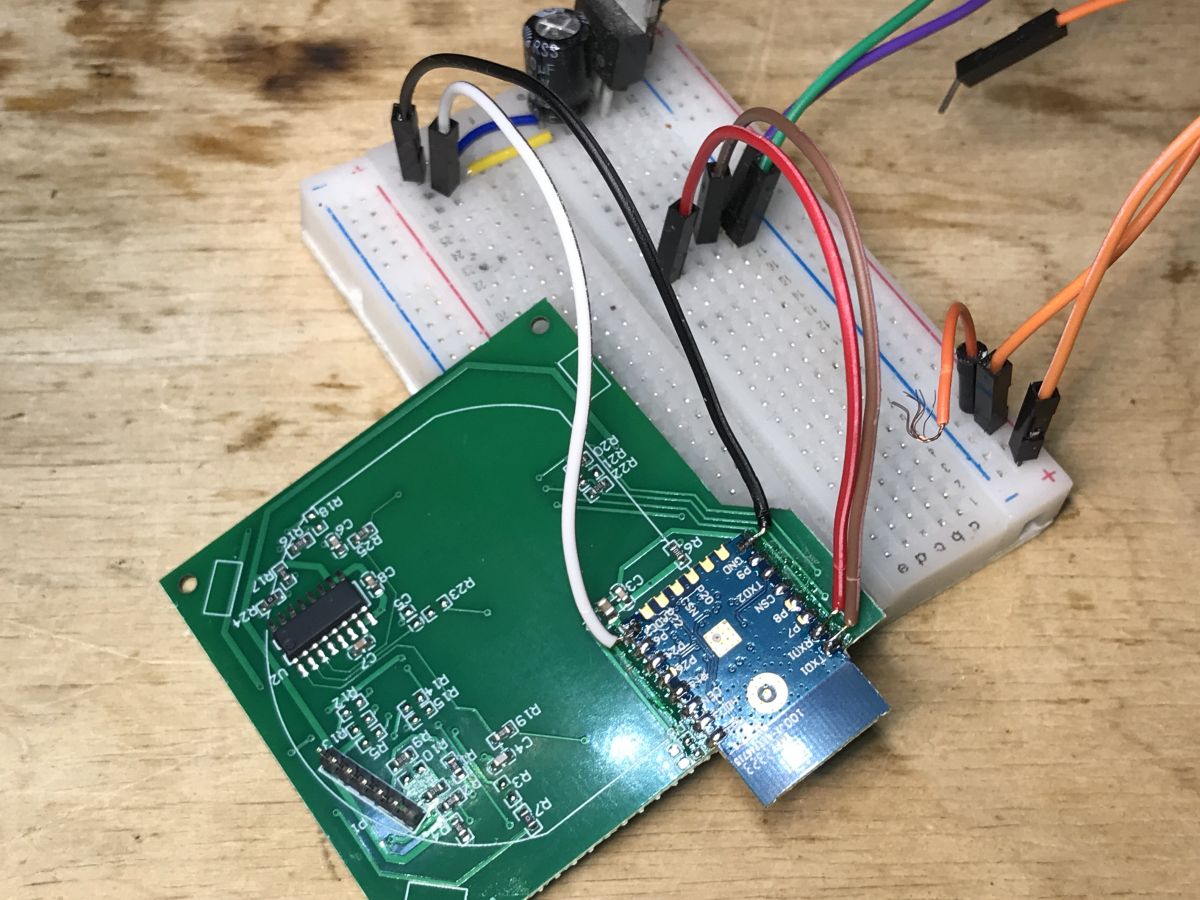

    Changing the TS02-EU-B2 load

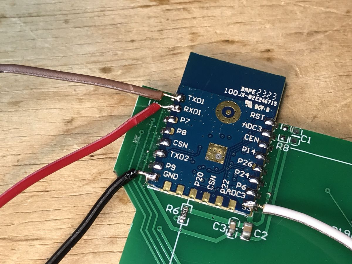

    Minor changes to the PCB do not matter here, we program CB3S as in the case white, triple version .
    A few photos:
    Close-up of an electronic module with attached wires. Circuit board with attached module and wires.

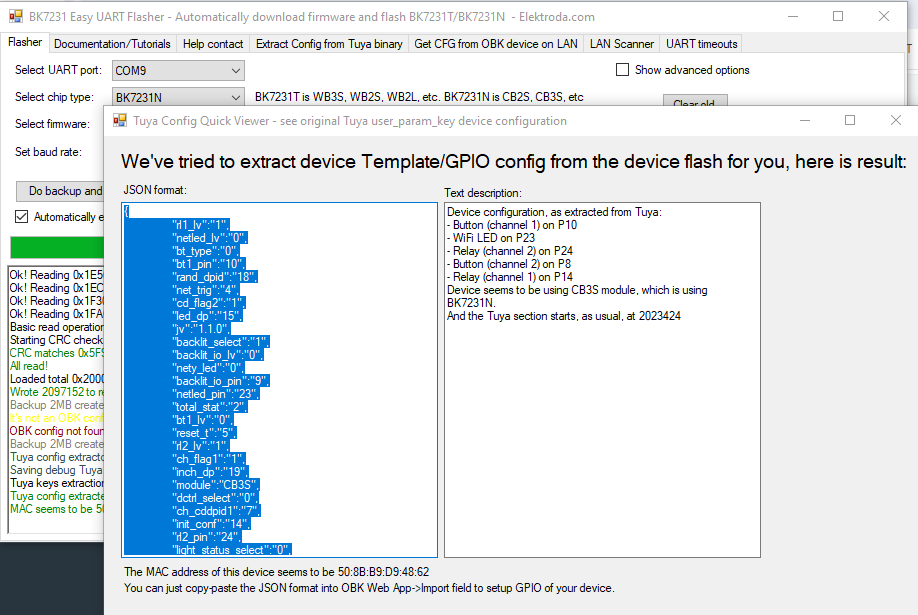

    Flasher rises to the challenge again and detects the configuration:
    Software interface for Tuya device configuration showing a JSON format parameter list.
    Tuya configuration:
    Verbal description:
    - Button (channel 1) on P10
    - WiFi LED on P23
    - Relay (channel 2) on P24
    - Button (channel 2) on P8
    - Relay (channel 1) on P14
    Device seems to be using CB3S module, which is using BK7231N.
