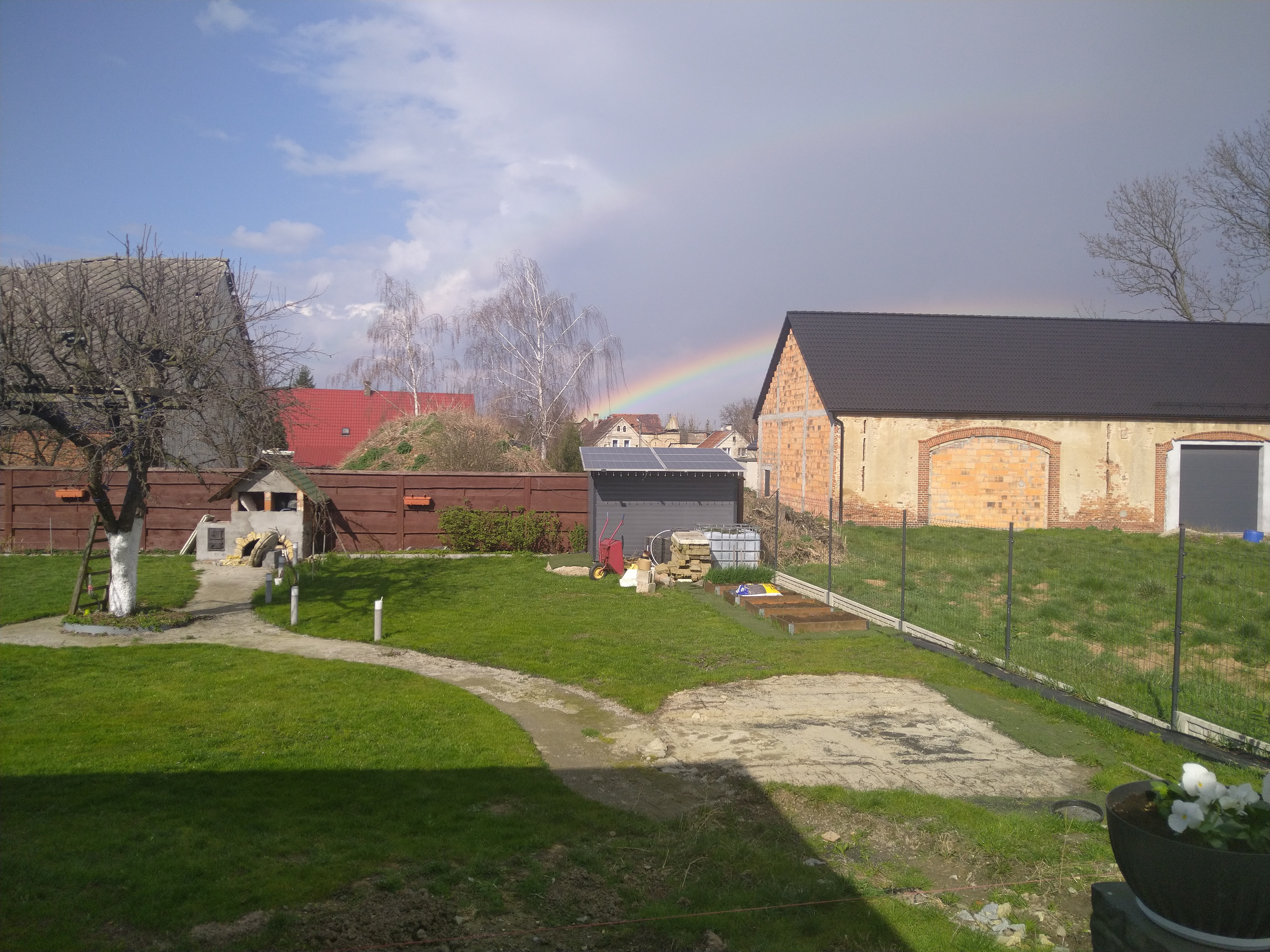

I had to build a garden shed 20 meters behind the house and it was a miracle that I didn`t start making the roof from metal tiles.
The location of the garden shed was ideally south, however, I wanted to tilt the roof south for aesthetic reasons with an angle no greater than 8°, and to my surprise, using a calculator for photovoltaic installations, it turned out that in the summer, such an arrangement of the photovoltaic installation can start production at more than an hour earlier, which also applies to the end of production.
The roof surface allowed for the installation of six panels with a total power of 1440Wp.
Garden with lawn, visible small garden shed and brick buildings in the background with a rainbow in the sky.
