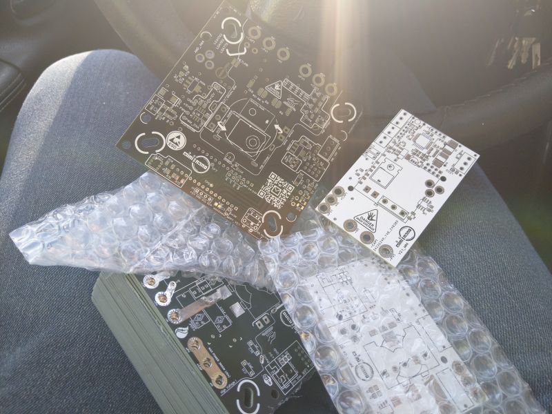

    #34 21019051
    dgproject
    Posts: 183
    Rate: 272
    sigwa18 wrote:
    The problem in such an application is DC above 24V, and often several hundred volts.
    Of course, I agree with this statement. The operation of the system with high DC voltage involves many additional points that must be taken into account for safe operation already at the design stage. A properly made system is half the success, on the other hand, the casing and protection against moisture, temperature increase, the possibility of electric shock, etc.
    It`s a bit like a switching power supply for an ordinary PC, where new units require up to 1200W of power. If we do not use appropriate protection, we will have a fire in the event of a failure.

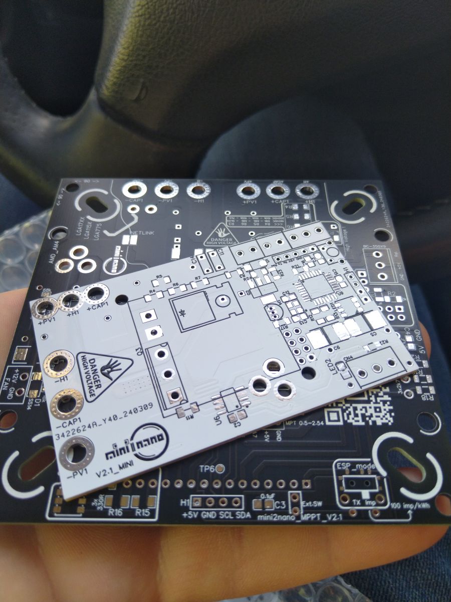

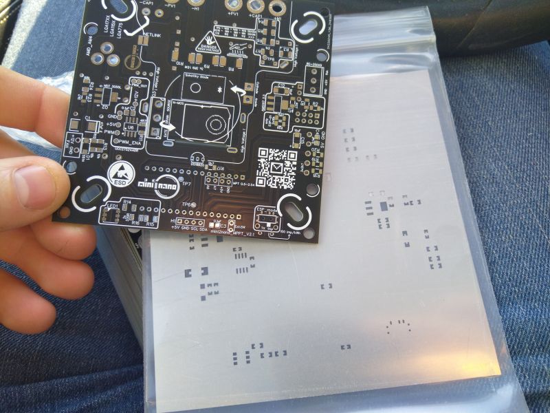

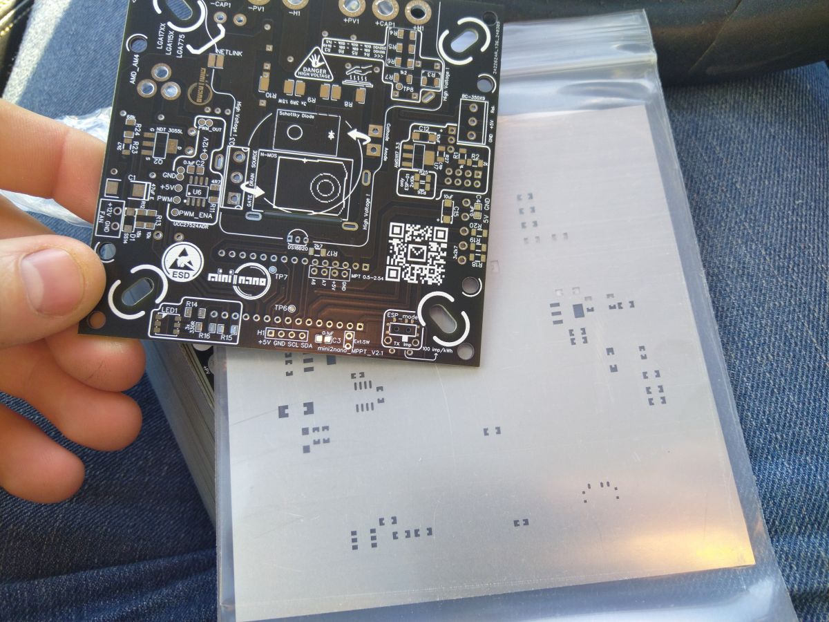

    On a different note, it turns out that time flies quickly and I have just received a shipment with new PCBs.
    This is what they look like...
    New PCB boards wrapped in bubble wrap on a lap.
    Two new PCBs stacked on top of each other on a hand with a car interior in the background. The boards feature markings and spots for electronic components.
    Close-up of a newly received printed circuit board (PCB) held in hand, with other PCBs in transparent packaging in the background.
  • Stencil fits and mini version shown

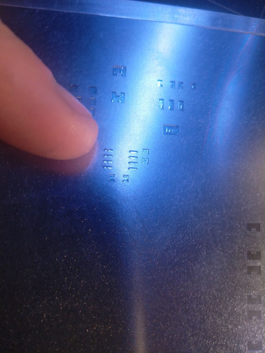

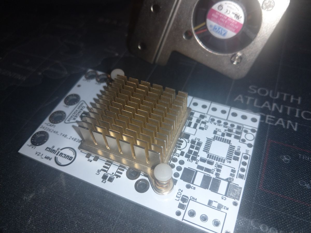

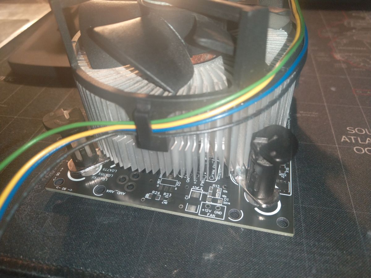

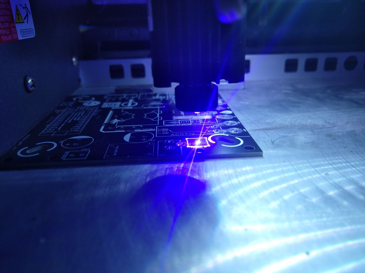

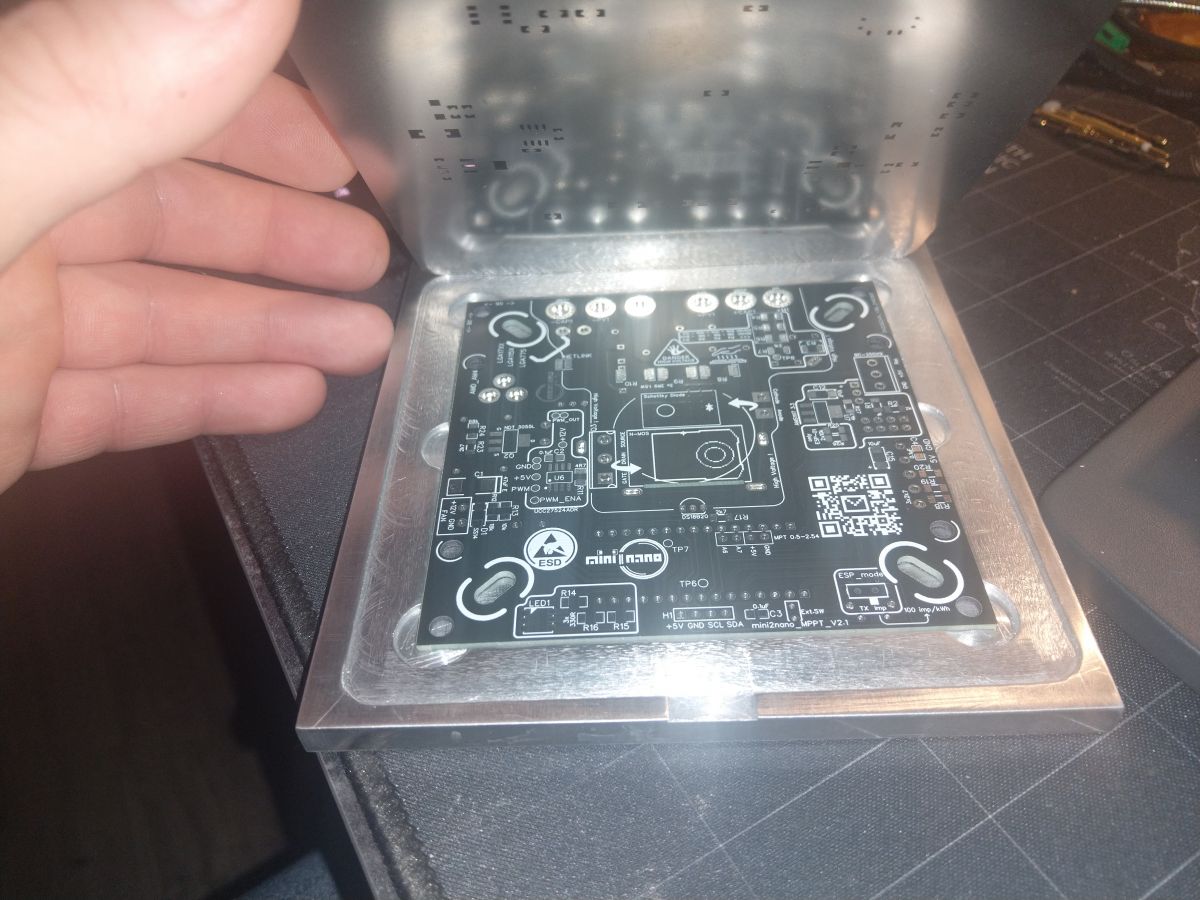

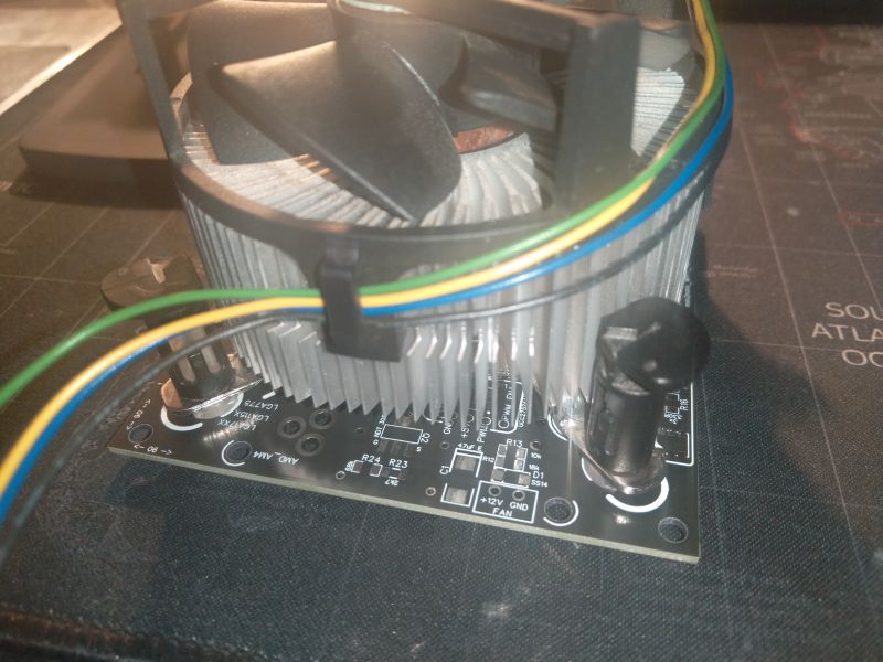

    #35 21020145
    dgproject
    Posts: 183
    Rate: 272
    A person holding a metal stencil above a black PCB.
    The stencil fits like a glove.
    A metal stencil with several holes, touched by a finger.
    Heatsink with a fan mounted on a circuit board with colorful cables.
    Holes for cooling as well.
    Circuit board with a mounted heatsink and cooling holes.
    This is what the mini version looks like.
    Testing circuit paths on a PCB using a laser.
    It`s time to sign and test the tracks.

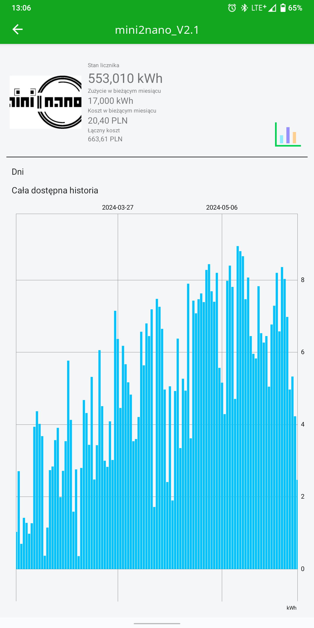

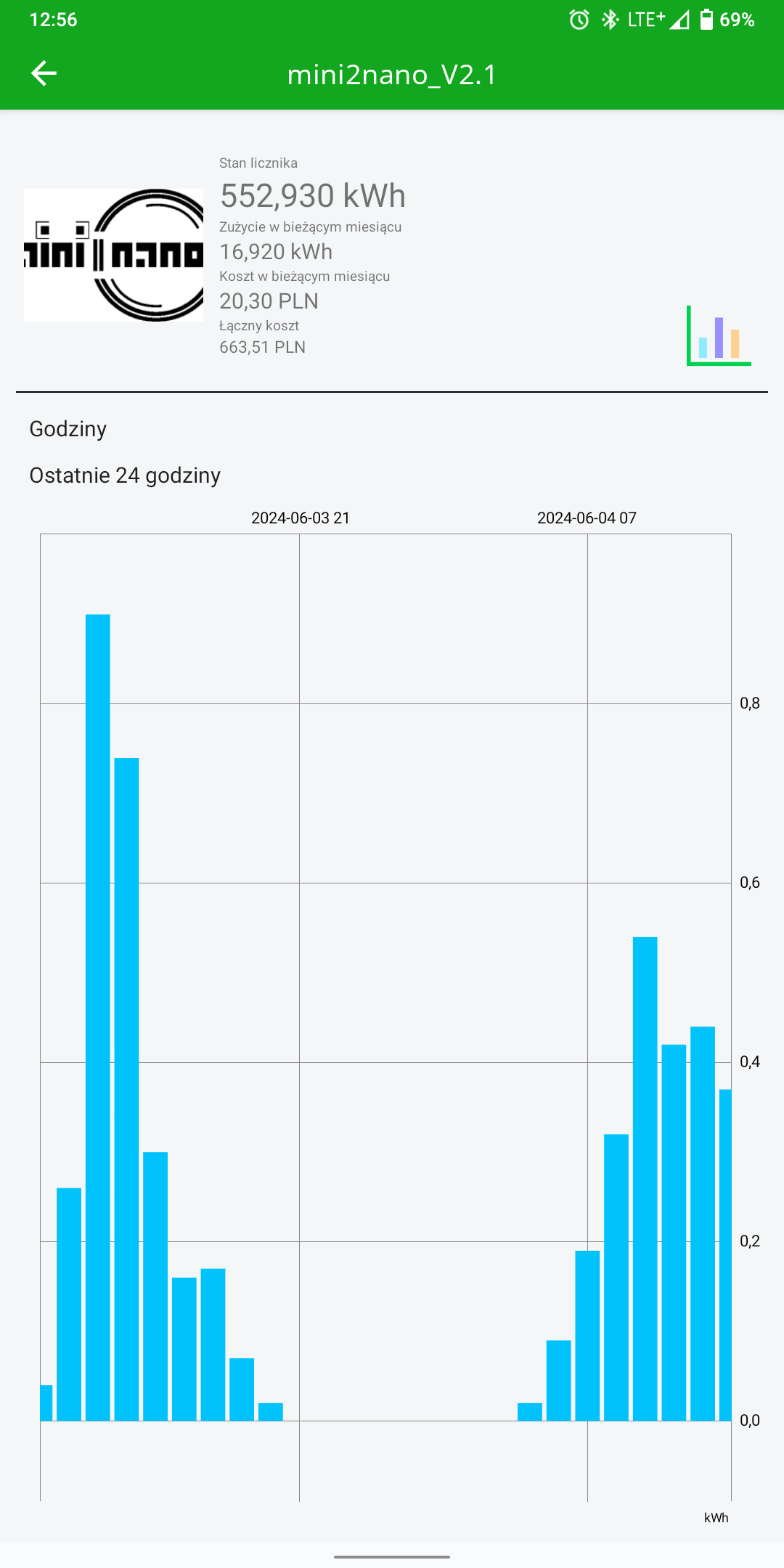

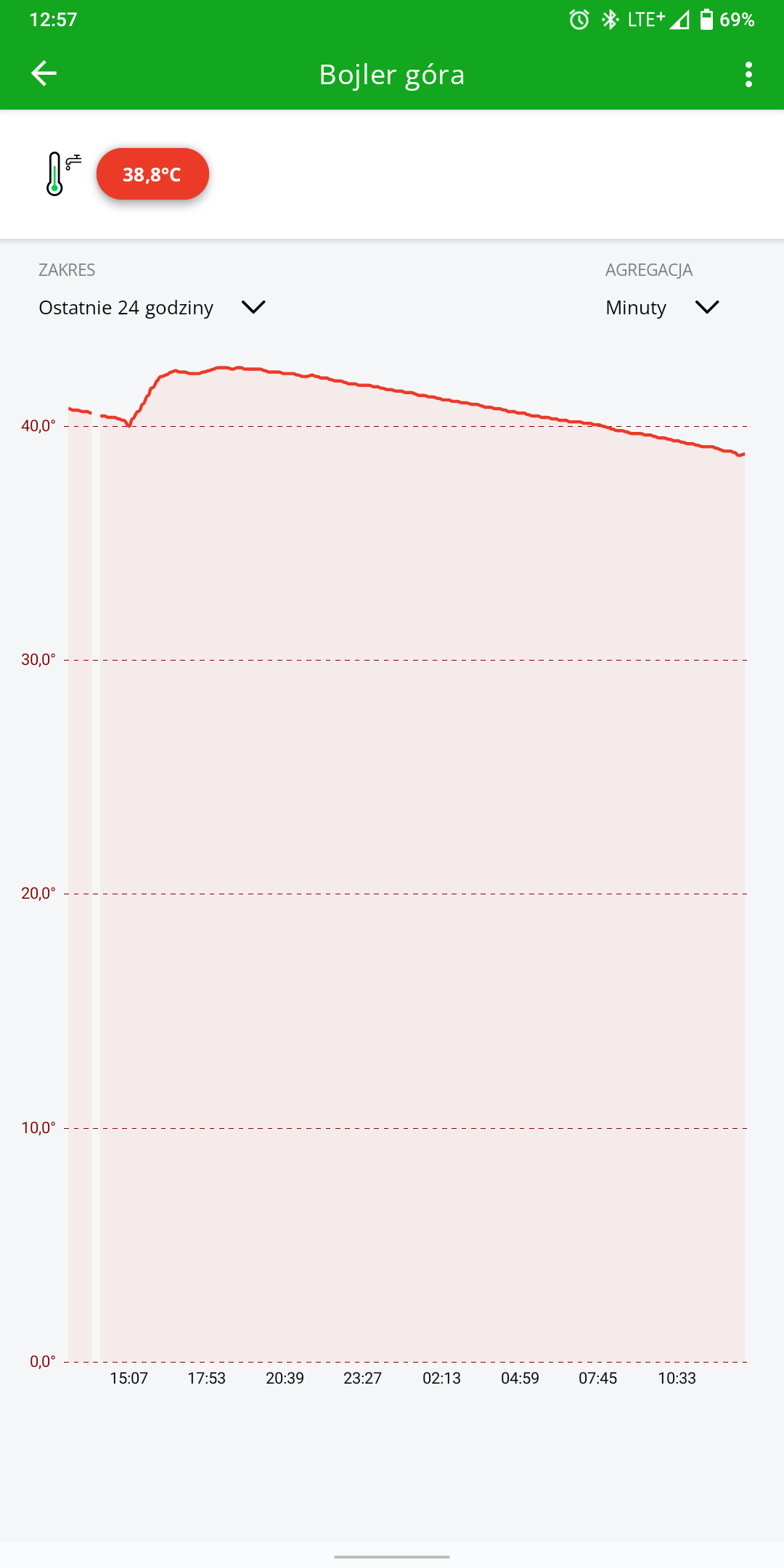

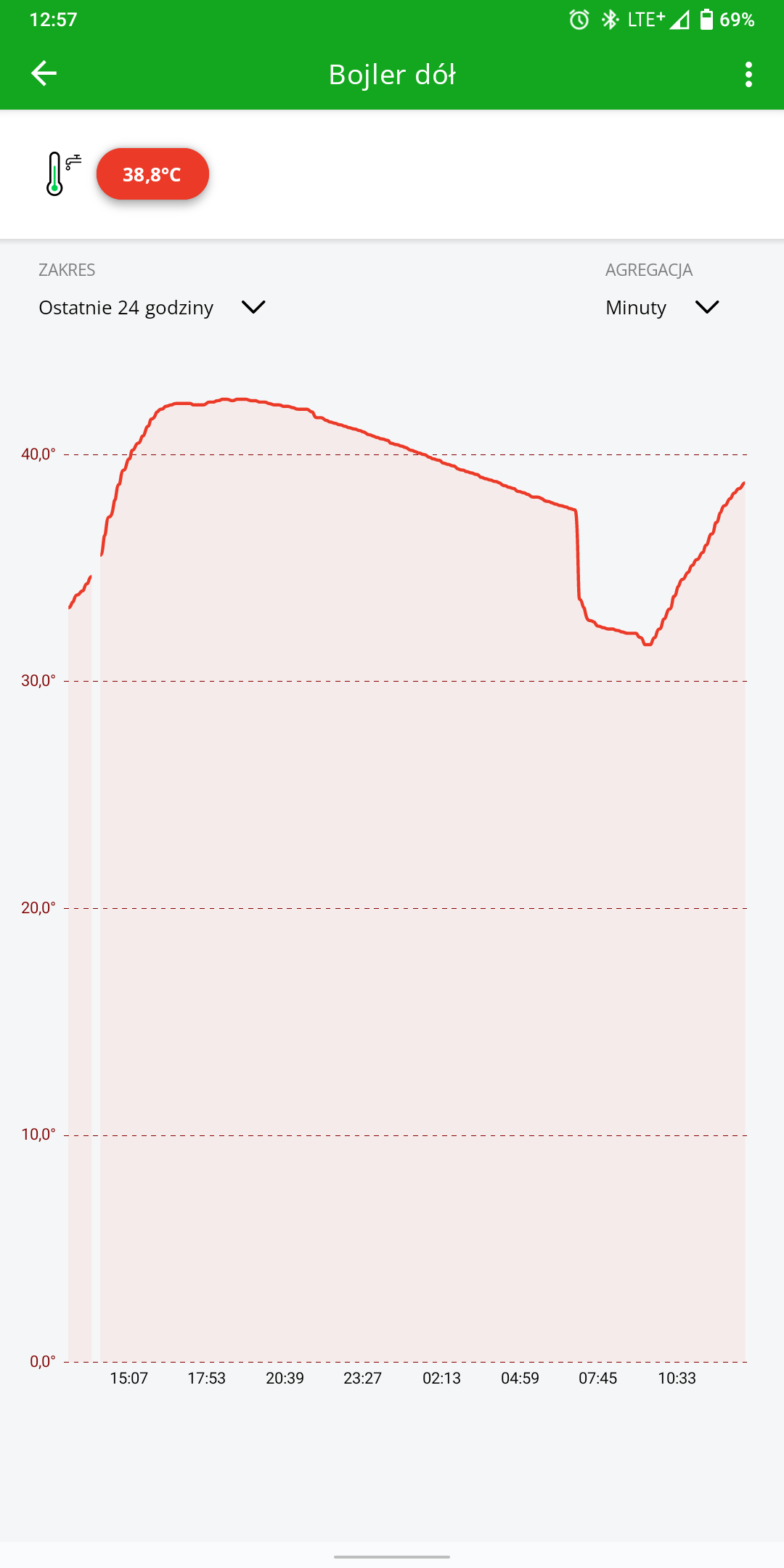

  • PV water heater still reaches 40°C in cloudy weather
    #41 21106917
    dgproject
    Posts: 183
    Rate: 272
    Screenshot from the SUPLA app showing energy consumption in kWh. .
    Hey, as an update on the progress of my project here are some screenshots of the measurements in the SUPLA app.
    The last two days have been totally cloudy, yet I still can't complain about the lack of hot water.
    Temperature chart of the hot water buffer from the SUPLA app. .
    Apparently the heater is only heating with a power of a few hundred watts, but as you can see the buffer temperature is rising.
    Temperature chart of the upper part of the boiler in the SUPLA app, showing data from the last 24 hours. .
    The top of the buffer reaches >40°C despite the bad weather conditions.
    Tomorrow, the sunshine will fortunately be hovering for longer.
    Screenshot of the SUPLA app showing energy consumption on a bar chart.
    This is the production from 17.02.2024 until 13:00 today.
    -Not a single milliwatt has been drawn from the grid.
    -Daily bathing habits unchanged.
    In my spare time I am putting together the final version of the controllers.
    I will try to post progress on my YT channel to which you are cordially invited.
    https://youtu.be/VUAgzR0TKas?si=sql0CCPMOywJMtFr

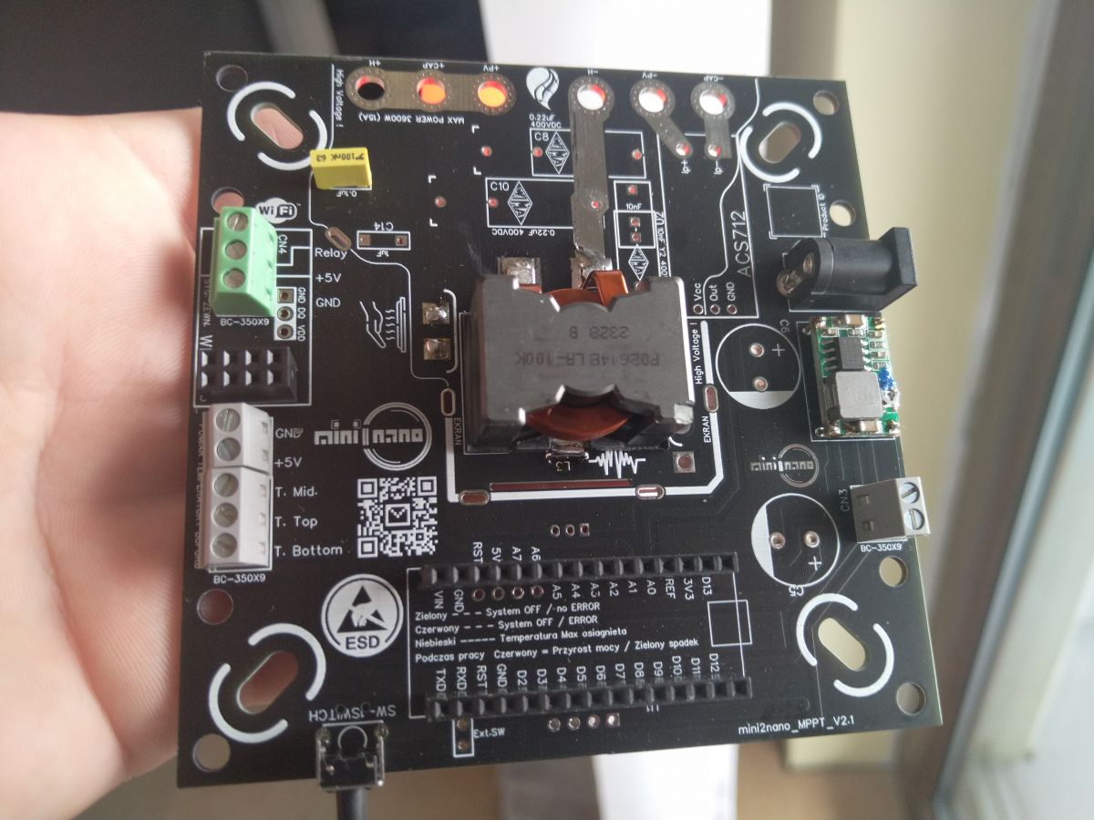

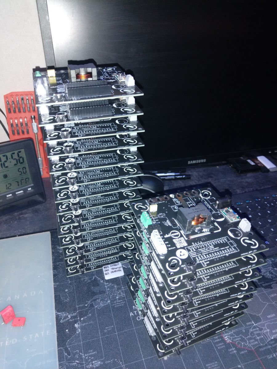

  • PCB batch completed with required component list
    #47 21152257
    dgproject
    Posts: 183
    Rate: 272
    Well, I managed to complete the remaining PCBs.
    I currently have over 20 pieces for sale that need retrofitting with a few components.
    Yesterday I received a shipment of the long awaited BURNS chokes.
    The boards require the addition of, among other things:
    -a suitable power Mosfet
    -Shottk diode
    -Arduino NANO
    -Pin sockets under the Arduino
    -ACS712 20A for current measurement
    -Display 2004 I2C
    -ESP-01s e.g. under SUPLA
    -Radiator with thermopad.
    -Socket 2.1 5.5 (for several boards unfortunately missing)
    -Capacitors
    The values of the individual components are plotted on the boards.
    The raster for MKP/ X2 capacitors allows several variations.
    I will make the full batch for Arduino available to those interested, with descriptions, schematics etc.
    I am currently completing the design of a 3D printed enclosure, which I will present on my YT channel.
    https://youtu.be/sZMFd6LIkH0?si=g4favhgzJBzlSOHm

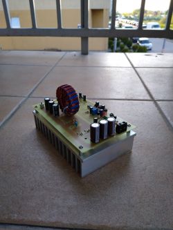

  • Buck converter core and frequency mismatch causing losses

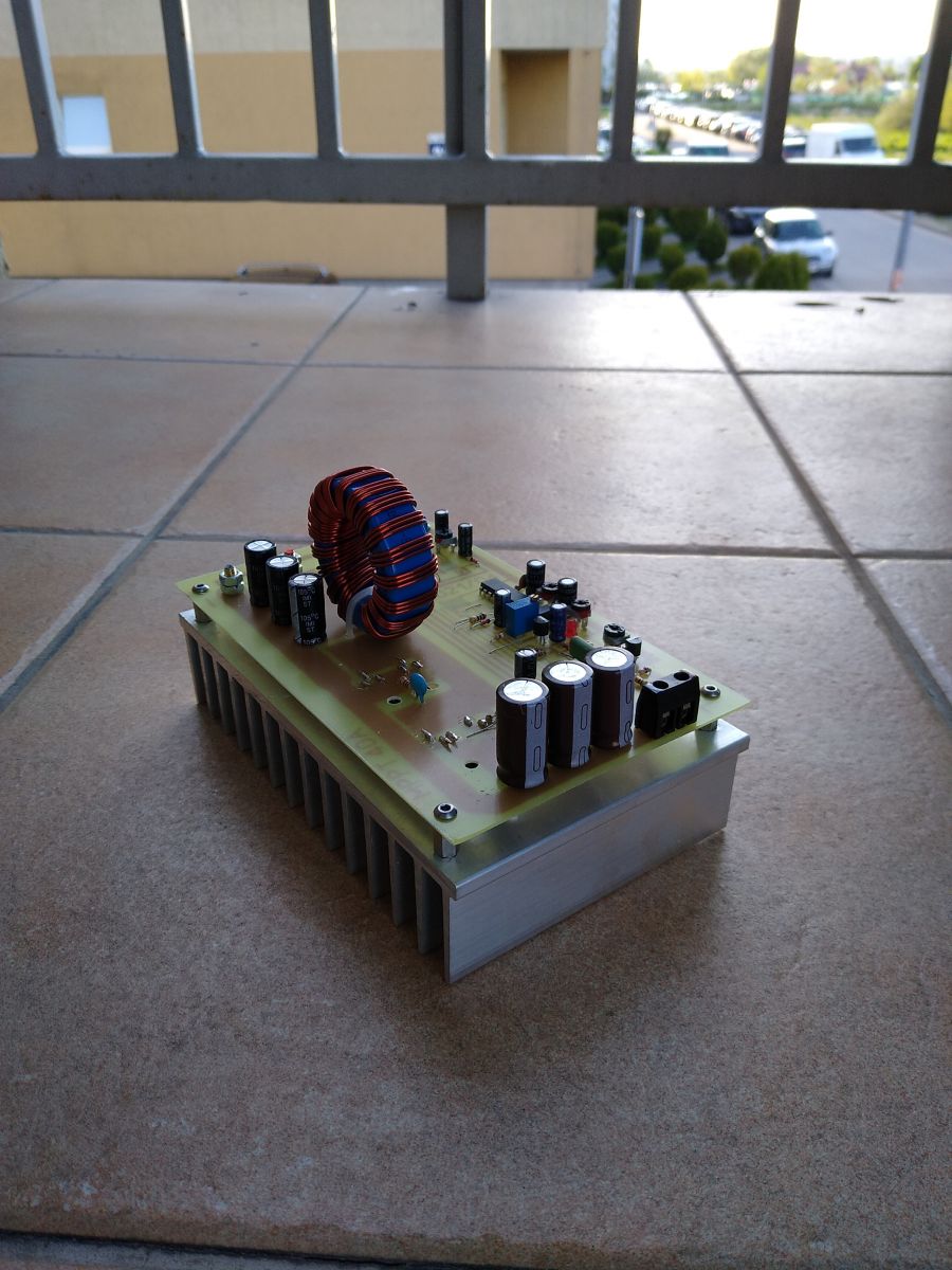

    #49 21171406
    Kwazor
    Posts: 2483
    Help: 184
    Rate: 530
    Hi !
    Nice how it all worked out for you except : the power inverter.
    I'm surprised that no one here has caught the massive error in this design.
    1 issue :
    -It is possible to change the frequency for the PWM signal in the range 2kHz - 17kHz
    Too small a core ( AL too and number of turns) here you need an ETD core at least with a large AL to make it work like a real BUCK inverter ( you wouldn't have such mosfet heating and that tells you about the surge current it gets when the key is switched on)--.
    What does it give ( i.e. it doesn't give because there is no chance it is a piece of wire and a noise generator ) when there is a big mismatch between source and load
    Do an I U In / I U Out measurement (it would be nice if you connected an oscilloscope to the output) I would not be at all surprised what the waveform is (yes I know the heater can tolerate everything) but the capacitors on the input heated up what ? ( didn't you wonder ? ) I know they work and what they do but they have a difficult job and the storage coil is asleep....
    For example, my inverter had 66V 5A and the output was 12V 26A (this is a car battery) and there was no voltage matching 1:5
    And I take a calm measurement on the input and on the output ( U ripple 0.1V was)
    Why is there no ( almost ) electrolytic capacitor on the output of the inverter ? ( I see only MKT /MKP ? ) because it would boil it .( I did a test in DCM mode --- the input capacitor firing was and the racing ones were swollen....
    If you want even better results, study again the principles of buck converter design (it will heat up, but here, for the time being, the whole herd of input capacitors serves as a buffer), raise the operating F - in my case 80khz (after changing the coil)
    You will decrease losses on the key - you don't need a herd of capacitors on the input - EMI too - you have the possibility to do real power measurement on the output .
    This is what 1kW on 24V looks like with an input U of 80V :
    Power converter with a large coil and capacitors on a PCB. .

    The transistor in my case puts off a bit of heat on the heatsink due to the use of IRFP460 with high resistance during conduction.
    The whole thing runs on an Arduino, so the frequencies oscillate in the lower kHz range.

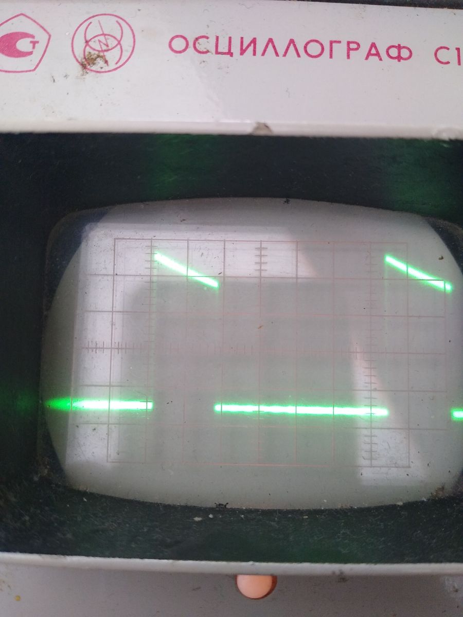

    Practically for the first year of playing with the project, the oscilloscope was constantly connected to the input and output of the controller.
    I am just finishing assembling a wall of these drivers and would be happy to demonstrate on the YT channel the ripple level and operating temperature of this circuit under a thermal imaging camera.
    I also started out with operational amplifier based inverters and frequencies in excess of a few hundred Hz, but this is nowhere near MPPT circuits.
    In my next project, the operating frequencies will not exceed 700Hz, there will be virtually no capacitors, and the PTC heaters will operate in cascade.

    Well then why did you give a diode and a coil ? ( to fill the circuit ? )
    Something you don't see yet but maybe it will guide you to an even better design....
    Analyse : the circuit at a mismatch of 1:8 ( that is weather poor the panels give 20% power ) R of the cells is greater than Robc ( normal )
    PWM 20% approx... 80% of the time it lies and this power you don't use ( normal because you can't key off )
    When the key is not working, you still have extra energy stored in the coil ( greater OUTPUT ).... less surge currents, the system runs smoothly (you have a 20R load, I have a 20mR load), didn't you wonder about the prototype system hanging up? Here you should already think about what causes it ... I call it Boom-Boom circuit - hard key on and a capacitor can give a big impulse and we have an EMP suspending the circuit (optionally the circuit of paths and ground point - this also likes to give a bite)
    The best thing is that the transistor shows when it gets a short circuit ( I had as I wrote the wrong program and the key started with 99% )
    This is not a fad of mine but 9 years ago I struggled with this matter and some lessons were learned....
    A good BUCK with this design will give excellent results....
    As for the small F of the arduino: you can always give an external generator and you have a higher F (I didn't have to because my proc gives up to 120Khz)

    What it will show you :
    An arrangement similar to yours :
    Advanced DIY controller for heating utility water from a photovoltaic installation. .
    Layout with full buck :
    Now see how much extra energy was given by the stored energy in the coil ( magnetised when the key is switched on --gives up when switched off .
    Yes you see it will also heat but it can be even better....
