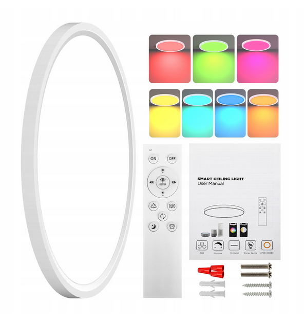

Tuya RGBCW LED ceiling light with remote, manual, and mounting components.
Today we are changing the software of the Tuya RGBCW 30W ceiling lamp in the "slim" version. The goal will be to free it from the cloud and connect it to Home Assistant. The presented ceiling lamp is characterized primarily by its compact design and additionally has a remote control, which surprised me a bit...
Purchase A228903
This model costs around PLN 100:
LED ceiling lamp RGB with remote control and WiFi app sales offer.
The description is usually praising the application and voice control, etc.:
Smart LED ceiling light with color and brightness adjustment, controlled by app and voice command.
The description includes the name: Graffiti Slim Ceiling Lamp:
The image shows a 30W Graffiti Slim ceiling lamp with accessories.
Set contents:
Let`s see what we get in practice:
