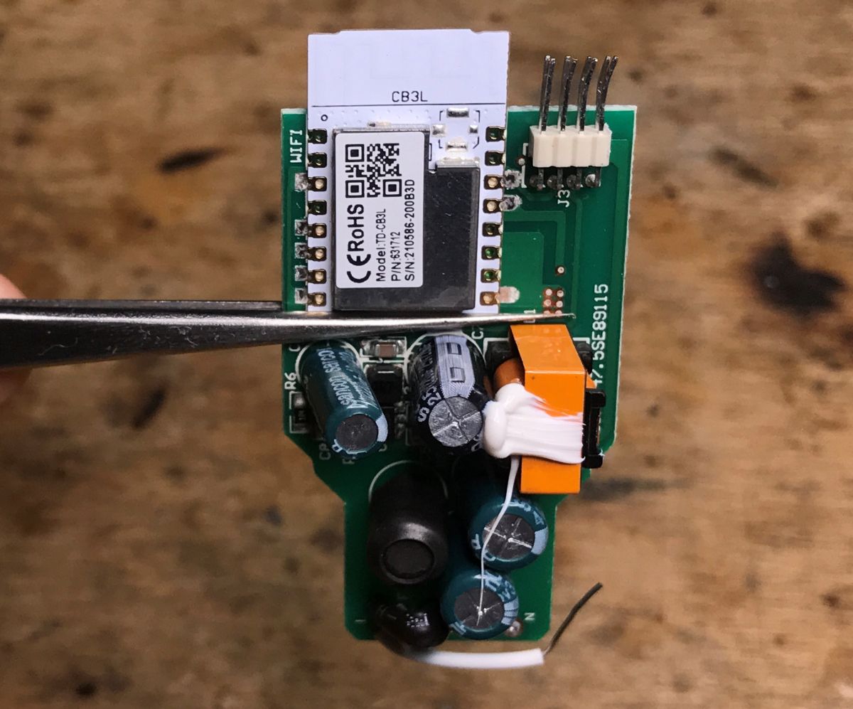

    Well, a board with a power supply / WiFi module and also with additional transistors for RGB:
    Kanlux S A60 LED lamp 11.5W E27 RGBCW [CB3L / BK7231N]
    The CB3L module is based on the BK7231N.
    In this case, pins RX and TX are easily accessible. You do not need to desolder the module.

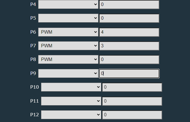

    Pinout for OpenBeken
    It is an RGBCW lamp, so it uses five PWM channels. Sequence as in the name - R, G, B, C and W. Below is the final PWM configuration:
    This is enough to control the color and color of light from the OBK level - as well as their brightness.
