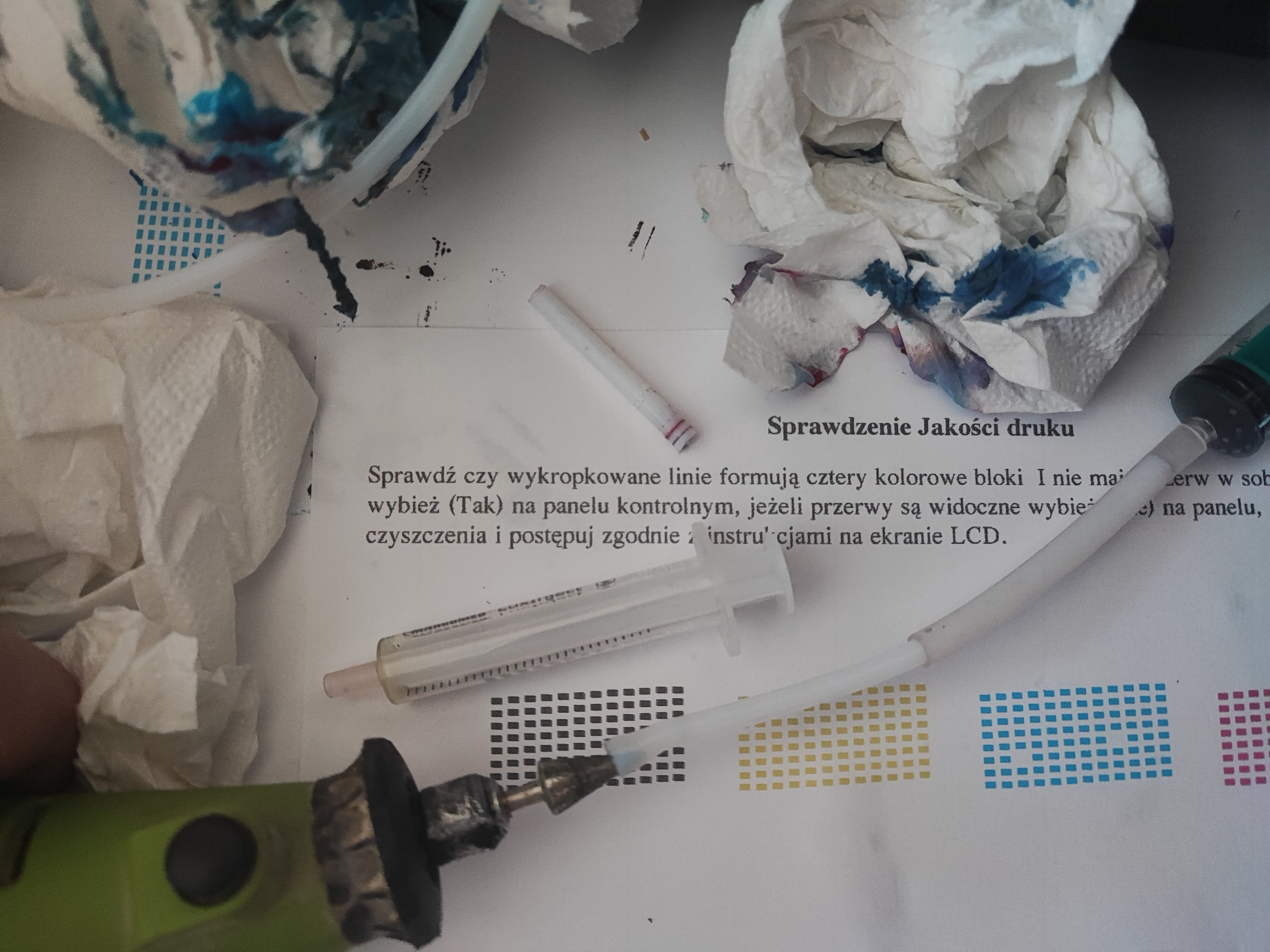

You have to clean the manual heads. There are kits available for this on the web:
Printer head cleaning kit with a bottle of fluid and a syringe. .
I, however, did not have this kit, although I recommend using this type of proven solution as much as possible. I prepared the mixture myself by hand and a syringe with a matching tube. I adjusted the tube to the required size with a dremel....
On the table is a makeshift printer head cleaning kit composed of a green syringe, a tube, and a multi-tool. .
This tube, by the way, is from my 3D printer, Ender 3 Pro, a filament guide.
Set up like this allows me to pump a bit of cleaning fluid into the ink tube, and you can also draw in a bit of ink - just to clear the passage.
Before the operation you release the head and leave it in the middle, once it's released you put a towel underneath it so you don't flood the printer with ink as a result of pushing through.
Syringe connected to the internal mechanism of a Brother printer using a tube. .
You have to be careful not to pump air in there! You have to keep an eye on the state of the syringe at all times; if the fluid runs out, you stop.
Any excess fluid is removed so as not to cause a flood.
Then you can still switch on the cleaning option from the printer itself from the menu, then this will help.

I let the cleaning run a few more times and since then the printer has been printing correctly. I find it useful for soldering, e.g. I printed myself the WB2S pinout so I don't have to keep it open on the computer all the time.
