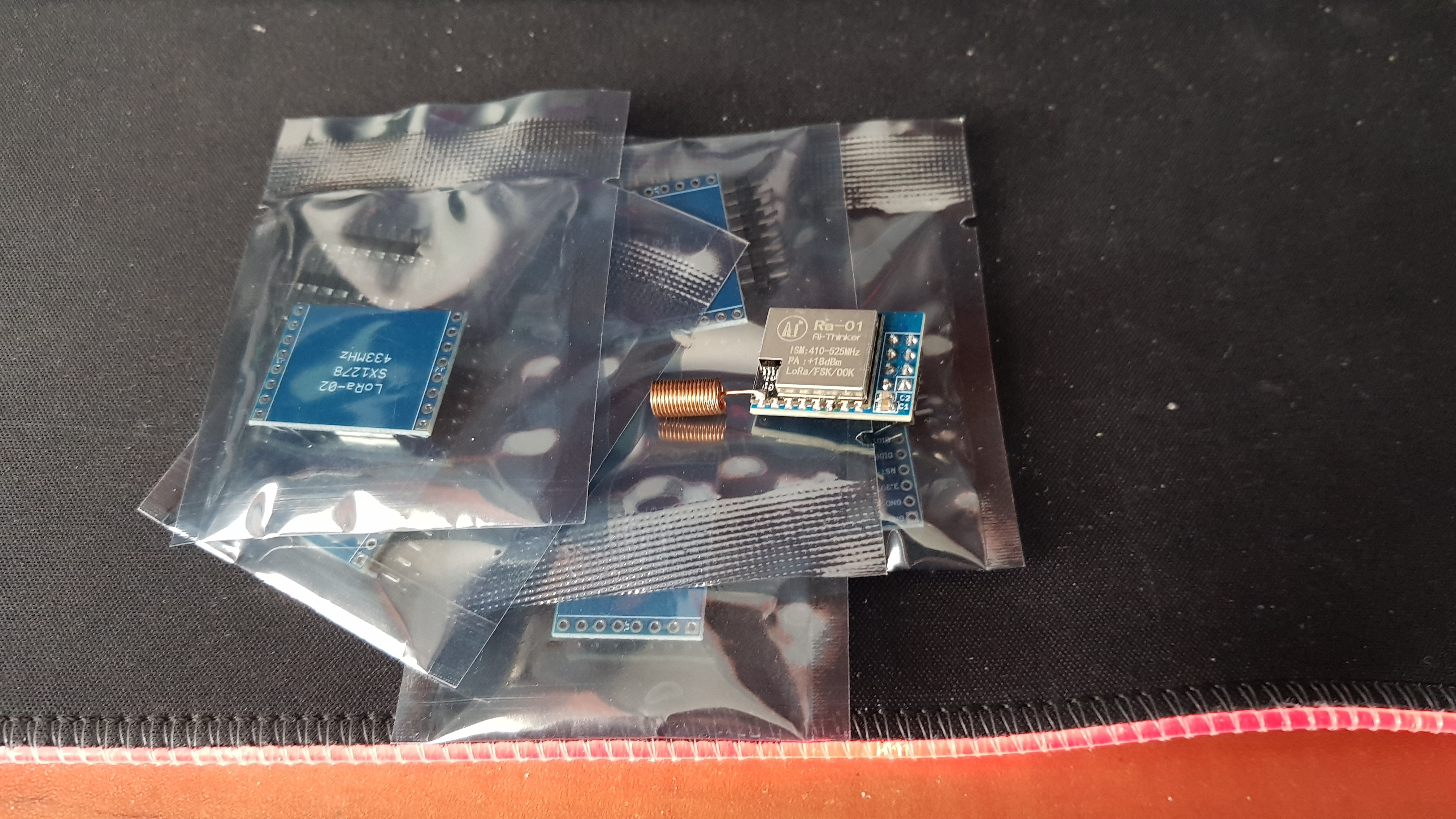

Some time ago I ordered some radio modules with the SX1276 chip for experimentation. After some time, I finally decided to get around to testing them.
