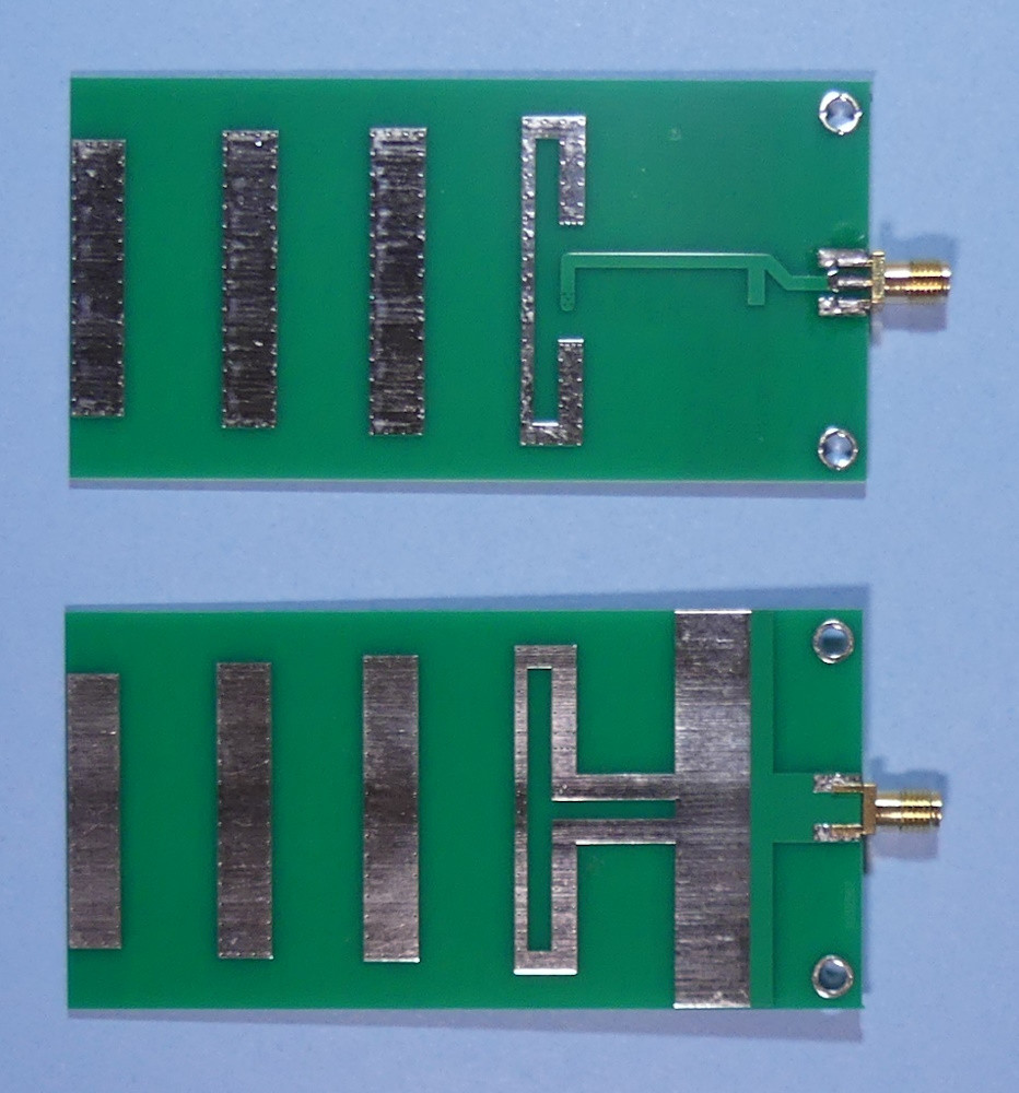

Two green PCB YAGI antennas on a white background.
There are YAGI Wi-Fi PCB antennas available on Aliexpress for the 2.4GHz band. However, I didn't need such an antenna for a typical Wi-Fi card. I'm using ESP32 modules with omni-directional antennas, which transmit information between two buildings about 300m apart after ESP-NOW. One module sends information, the other receives information, it is a one-way transmission. There is no visibility between the buildings, which are obstructed by trees and other buildings. The distance of 300m is not a special achievement, as one can find information about successful attempts with ESP-NOW at 1km with optical visibility.

The PCB shows three directors, a dipole and a reflector:
PCB YAGI Wi-Fi antenna with three directors, a dipole, and a reflector.
On the other side there is some magic with the paths concerning the w.cz ;)
Request for a hint as to what is going on here, is this some kind of impedance matching?

The magic mentioned may be the symmetrizer matching the impedance of the dipole to the coaxial cable. [Read more]
