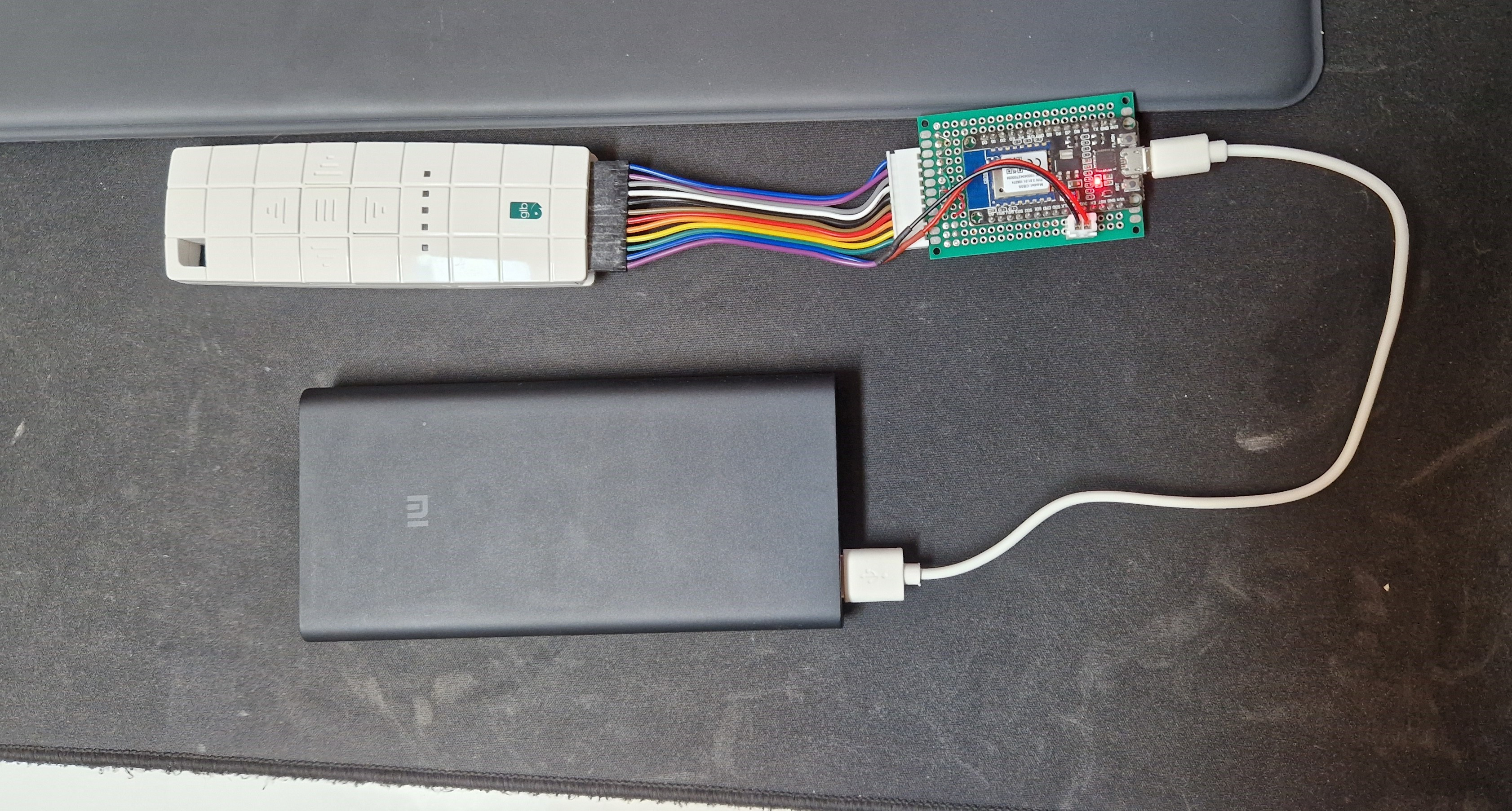

Many shutter controllers come with RF remotes but without WiFi connectivity, so they cannot be easily paired with Home Assistant. Luckily, it's always possible to simply inject remote button presses and intercept LED states with a simple WiFi module addon modification. Here I will show how to do it step by step in OpenBeken.
Project was done by @DeDaMrAz, I'm just doing support and documentation.
So, there are 5 shutters in total. They have one common remote.
Remote has 5 buttons:
- right/left (to select shutter)
- top/down (to open/close)
- middle (stop)
Futhermore, the RF remote has also a simple LED feedback (five LEDs) which tells us which shutter we're currently controlling.
The LEDs are either indicating room index (one of LEDs is lit), or a special "all rooms" mode (all LEDs are lit then).
That's a total of 10 GPIOs - 5 outputs (to control buttons), and 5 inputs (to read LEDs).

We didn't want to break the remote, or make it unusable without WiFi addon, so we decided to route out the signals to the male pin header:
Remote control circuit board with pins and button descriptions, side view.
It's time for some soldering. First, the wires were soldered to the pins:
Remote control for blinds with the case opened and attached wires.
Then, they were carefuly shorted and soldered to the appropriate pads:
Interior of an open remote with wires connected to the circuit board
Opened RF remote with exposed PCB and wires soldered to pins. Interior view of RF remote with attached wires.
Next step is the WiFi part. We can use any OBK device, but he had some NodeMCU mods at hand. @DeDaMrAz decided to use PC817's for buttons, however, in my opinion, that was not necessary - it depends on how the buttons are connected.
Wiring diagram of NodeMCU module with PC817 circuit
So, here is the WiFi board:
Prototype board with soldered wires and electronic components.
WiFi module board with attached wires.
The board can be seamlessly connected to the remote and the remote is still intact:
Remote control with a connected WiFi board via colorful wires.
Just please note that I'd recommend taking out the battery before connecting external supply.

The script watched LED input channels and translated each active state into a named room. When Channel 6, 7, or 8 changed, OpenBeken updated button colors and set the LAST SELECTION label to OFFICE, ROOM 1, or ROOM 2. It also wrote a numeric code into Channel 11 so Home Assistant could consume a stable machine-readable state. LEFT and RIGHT navigation handlers could also clear the remembered label back to NONE when no valid room was selected. [#21213596]
How was the special 'all rooms' mode detected in OpenBeken when all the shutter-selection LEDs were active at once?
The final script treated the all-rooms condition as a simultaneous LED pattern and then set a separate state channel. In the finished logic, if CH6==0 && CH7==0 && CH8==0, OpenBeken set Channel 9 to 1; otherwise it set Channel 9 to 0. That inversion matched the author’s final input polarity. A separate handler then translated the all-rooms state into ALL for the last-selection display and 4 for Home Assistant reporting. [#21213596]
What is the detection feature in this WiFi shutter remote mod, and how does it tell whether the original remote is connected to the OpenBeken board?
The detection feature is a dedicated input that confirms the remote is physically present and electrically seen by the OpenBeken add-on. The final script used Channel 10 as the detection status, then flipped the UI between DETECTED in green and NOT DETECTED in red. A loop checked that line every 2 s with if $CH10==0 then DETECTED else NOT_DETECTED. That gave the user a clear fault indicator if the remote or header connection was missing. [#21213596]
How do I publish a read-only OpenBeken channel to Home Assistant and convert numeric selection states into text like OFFICE, ROOM 1, ROOM 2, or ALL?
Publish a dedicated state channel, keep it read-only, and translate its numeric values in a Home Assistant template sensor. In this project, Channel 11 stored 0, 1, 2, 3, or 4 for NONE, OFFICE, ROOM 1, ROOM 2, or ALL. The author then used a template sensor in configuration.yaml to map those numbers into readable text, shown as Last used on the dashboard. That keeps OpenBeken simple and moves friendly naming into Home Assistant. [#21213596]
What should I check if the LED state readings are unstable or give false triggers when all five LEDs on the shutter remote are on?
Check where you tapped the signal, whether internal pull-ups are fighting the remote, and whether your polarity is inverted. The author fixed instability by reading before the LEDs, using dInput_NoPullUp on the LED channels, and adjusting the all-LED logic for the final signal polarity. False triggers were specifically linked to LED bias and inconsistent levels when many LEDs were active. If all indicators are on at once, verify the special all-rooms condition with a separate channel instead of inferring it from a single LED. [#21213596]
How does using a CC1101 RF module to control blinds compare with hijacking the original RF remote through OpenBeken inputs and outputs?
CC1101 control is a more direct RF approach, while remote hijacking reuses the original transmitter and its LED feedback. The thread says the CC1101 method was later tested successfully as a long-term project and was already working by December 4, 2025. The remote-hijack method, however, was fully demonstrated earlier with button simulation, room detection, and Home Assistant status mapping. Choose hijacking when you want faster reuse of known-good RF hardware, and CC1101 when you want native RF transmission as the next step. [#21771632]
