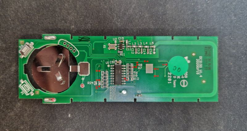

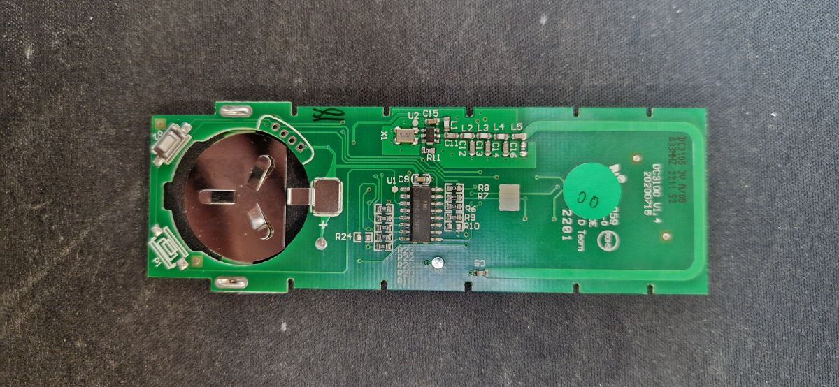

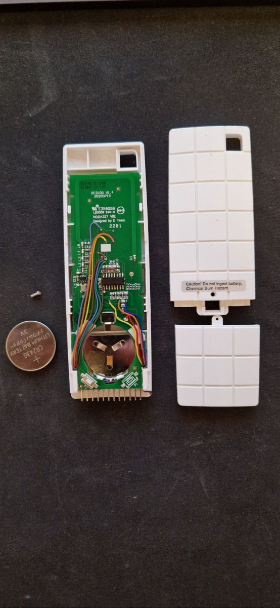

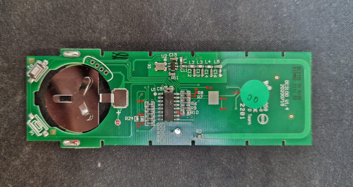

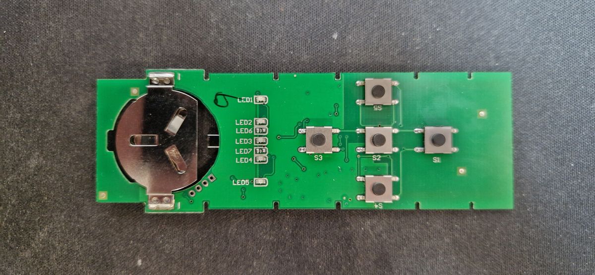

    Let's open the remote and look inside:
    Image of an electronic circuit board with buttons and a battery holder. Remote control circuit with visible battery compartment and electronic components.

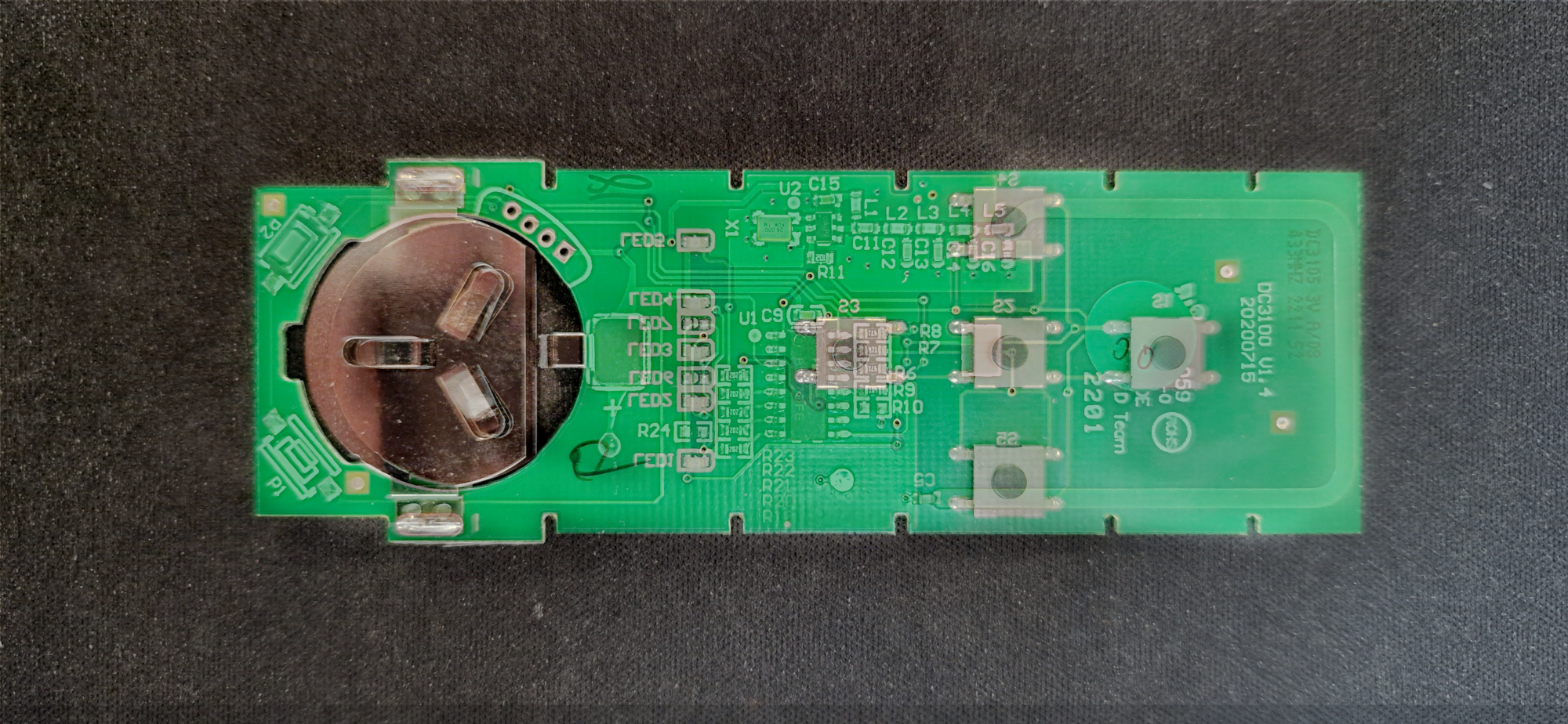

    We can also overlay both images on single picture for more clarity:
    Photo of remote control interior showing circuit board and battery slot.

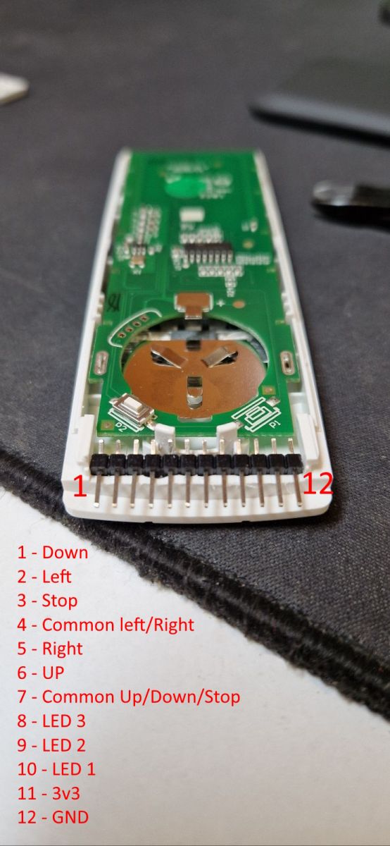

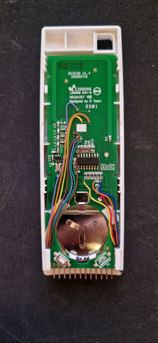

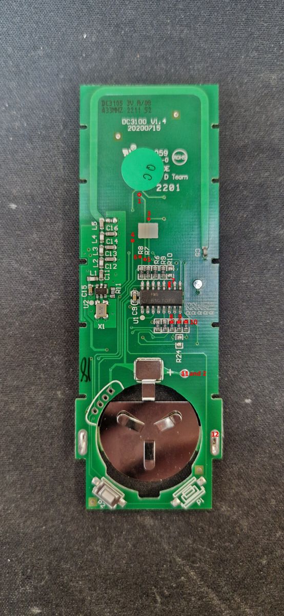

    The next step is to figure out how to read LEDs and control buttons. We need to find points where we can solder wires:
    RF remote control PCB with component markings.
    We didn't want to break the remote, or make it unusable without WiFi addon, so we decided to route out the signals to the male pin header:
    Remote control circuit board with pins and button descriptions, side view.

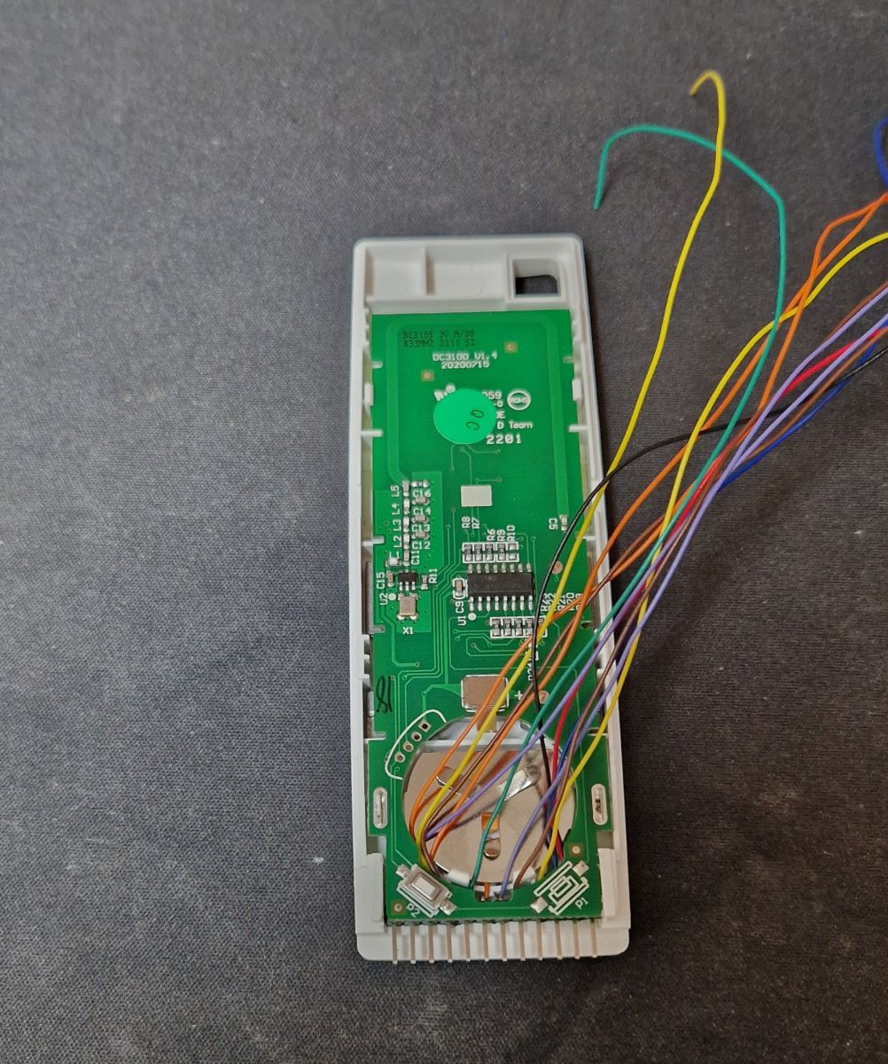

    It's time for some soldering. First, the wires were soldered to the pins:
    Remote control for blinds with the case opened and attached wires.
    Then, they were carefuly shorted and soldered to the appropriate pads:
    Interior of an open remote with wires connected to the circuit board
    Opened RF remote with exposed PCB and wires soldered to pins. Interior view of RF remote with attached wires.

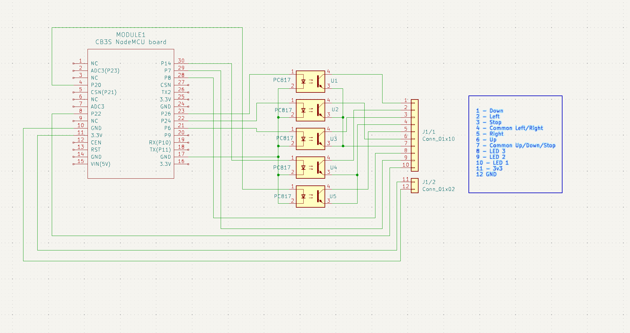

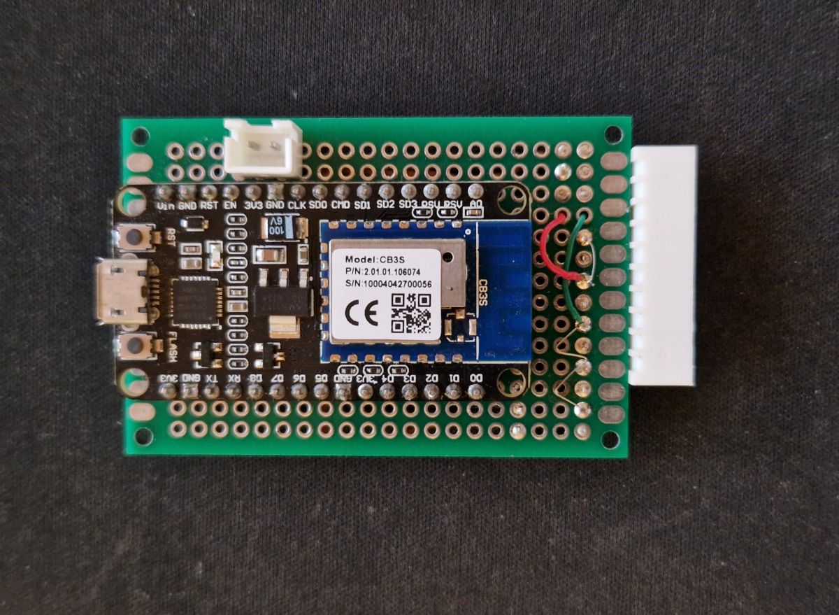

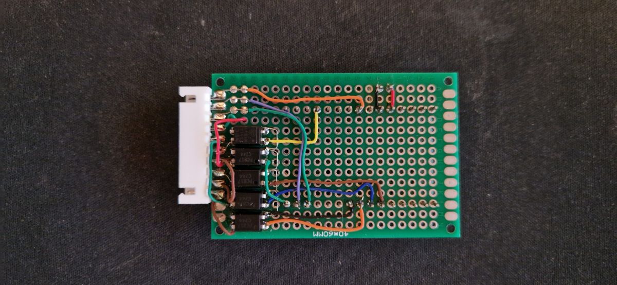

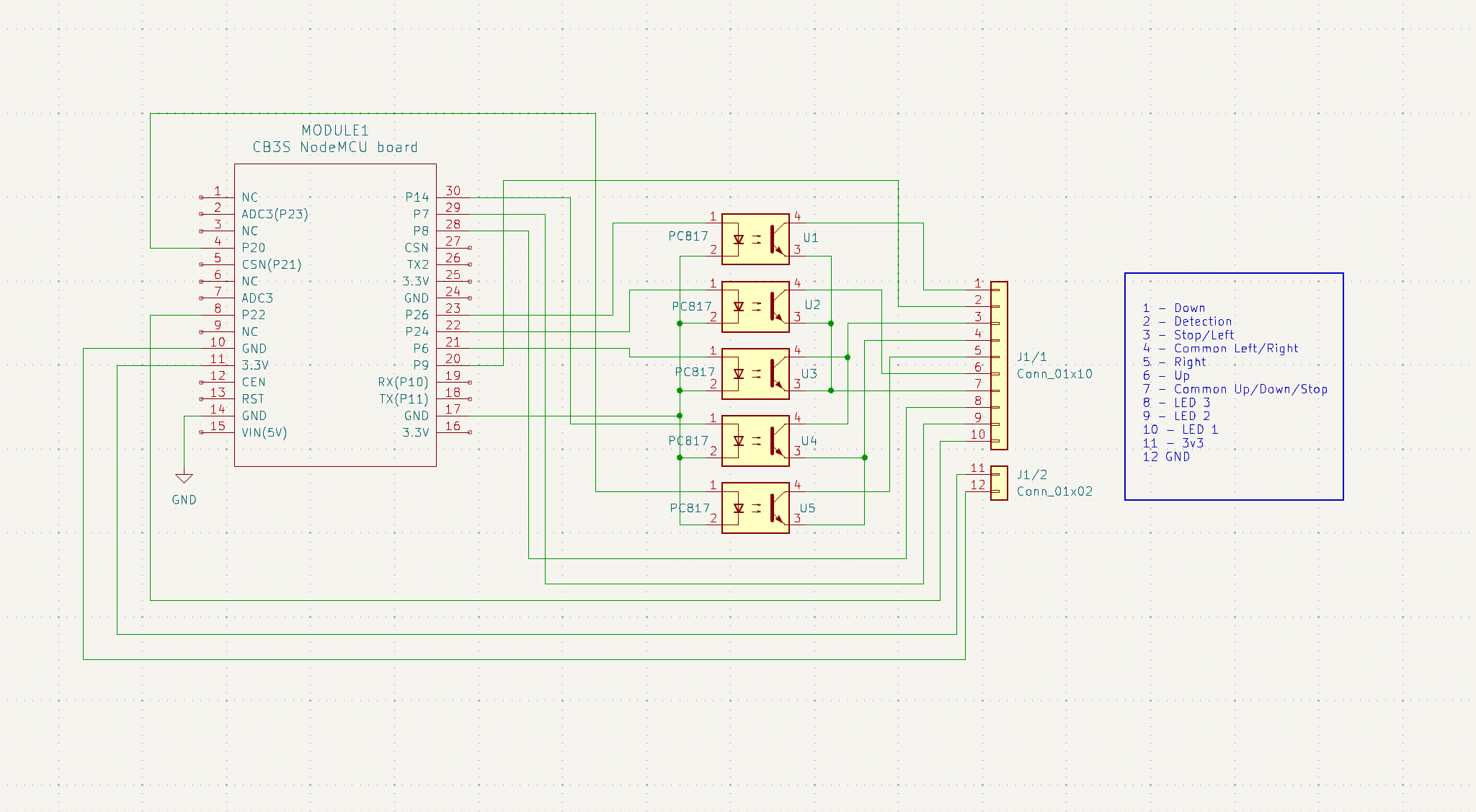

    Next step is the WiFi part. We can use any OBK device, but he had some NodeMCU mods at hand. @DeDaMrAz decided to use PC817's for buttons, however, in my opinion, that was not necessary - it depends on how the buttons are connected.
    Wiring diagram of NodeMCU module with PC817 circuit
    So, here is the WiFi board:
    Prototype board with soldered wires and electronic components.
    WiFi module board with attached wires.

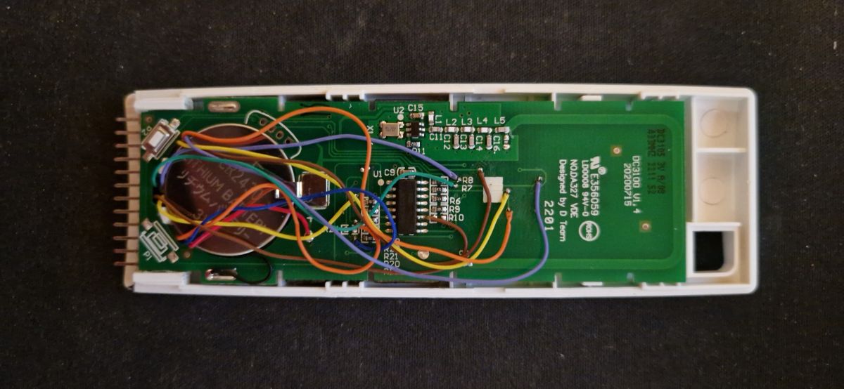

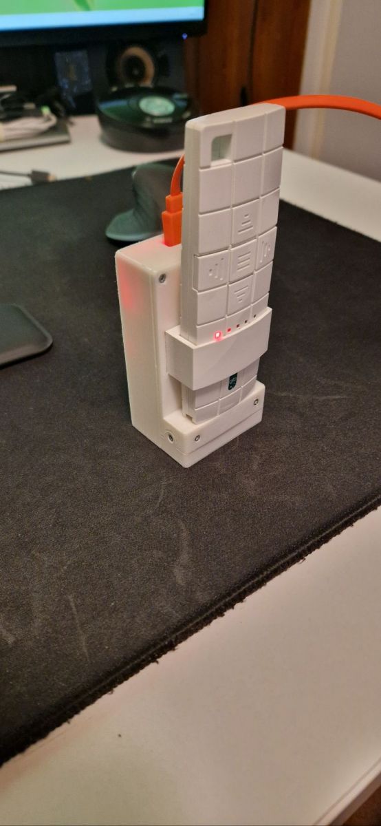

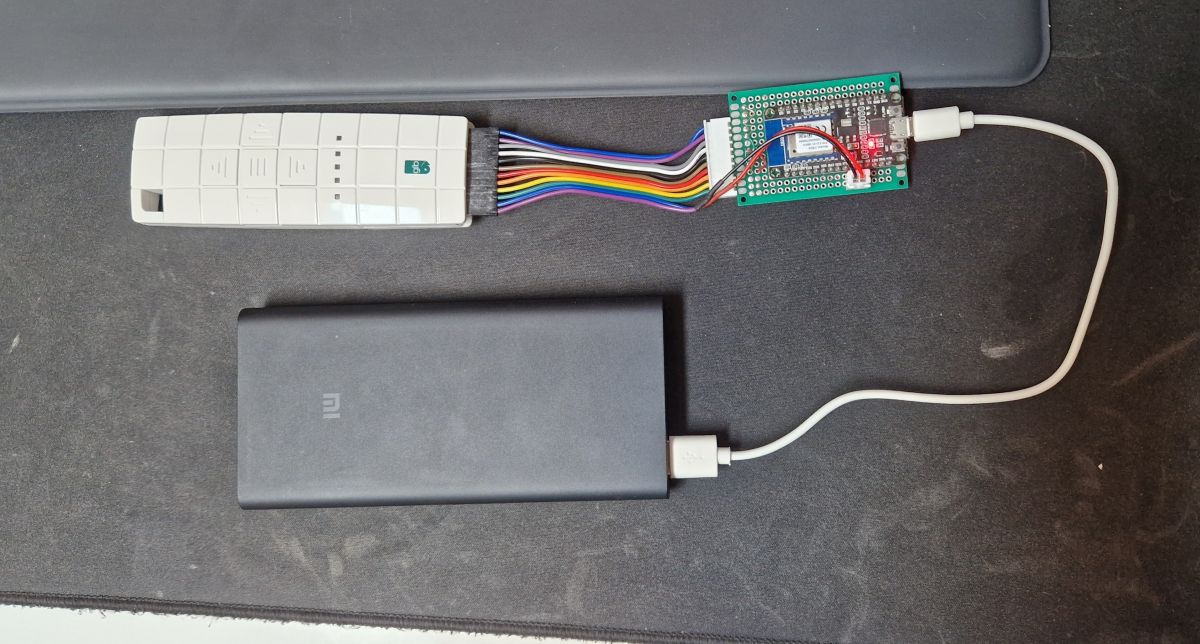

    The board can be seamlessly connected to the remote and the remote is still intact:
    Remote control with a connected WiFi board via colorful wires.
    Just please note that I'd recommend taking out the battery before connecting external supply.

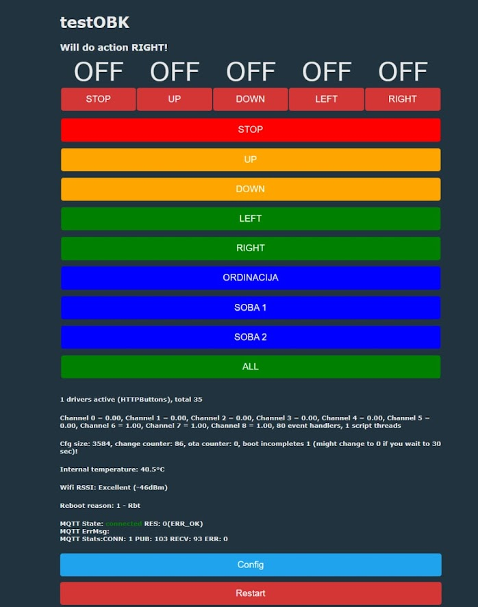

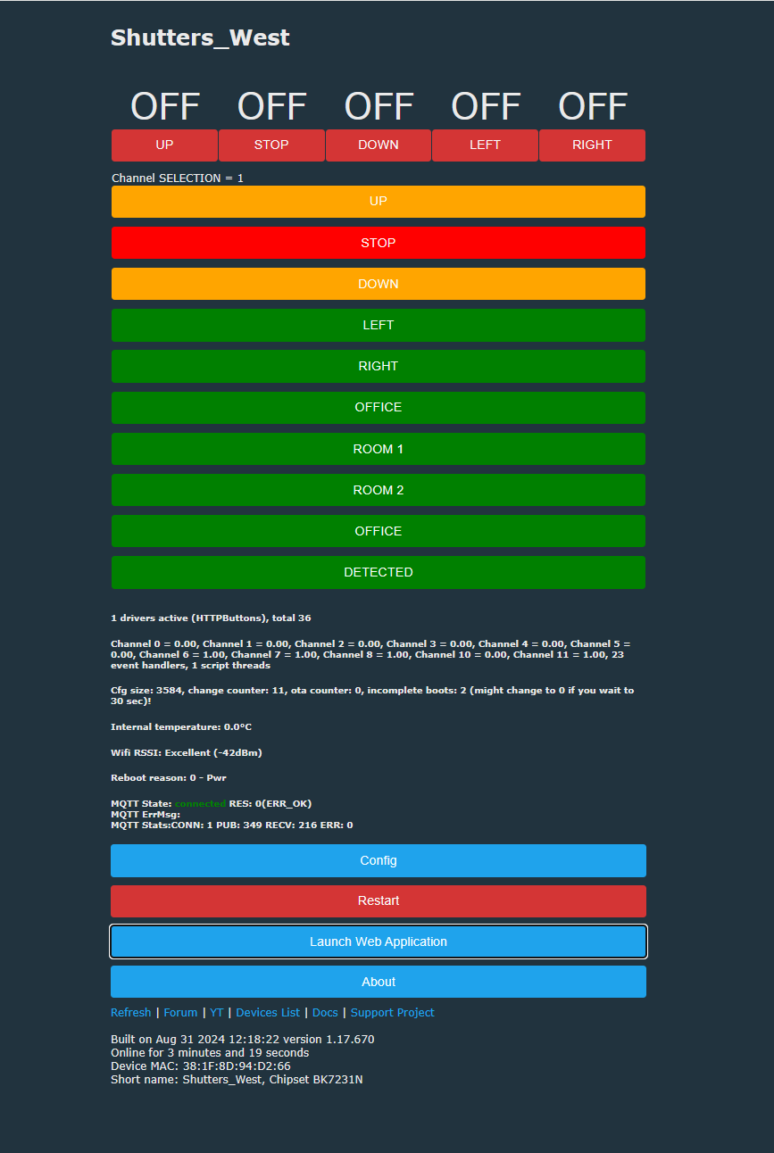

    And here is OBK panel (some buttons are not in English but it's just a demonstration):
    OBK system user interface with various control buttons.
    It's important to keep in mind that first buttons are indeed clickable and they send events, while the futher buttons just mimic the state of LEDs.

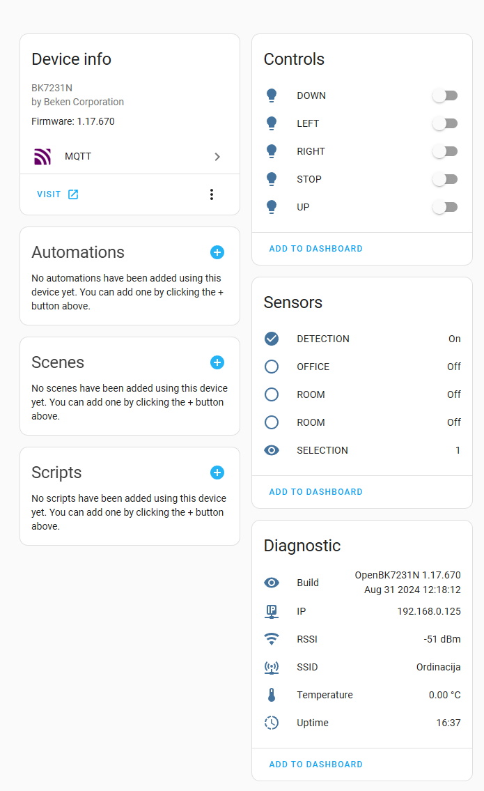

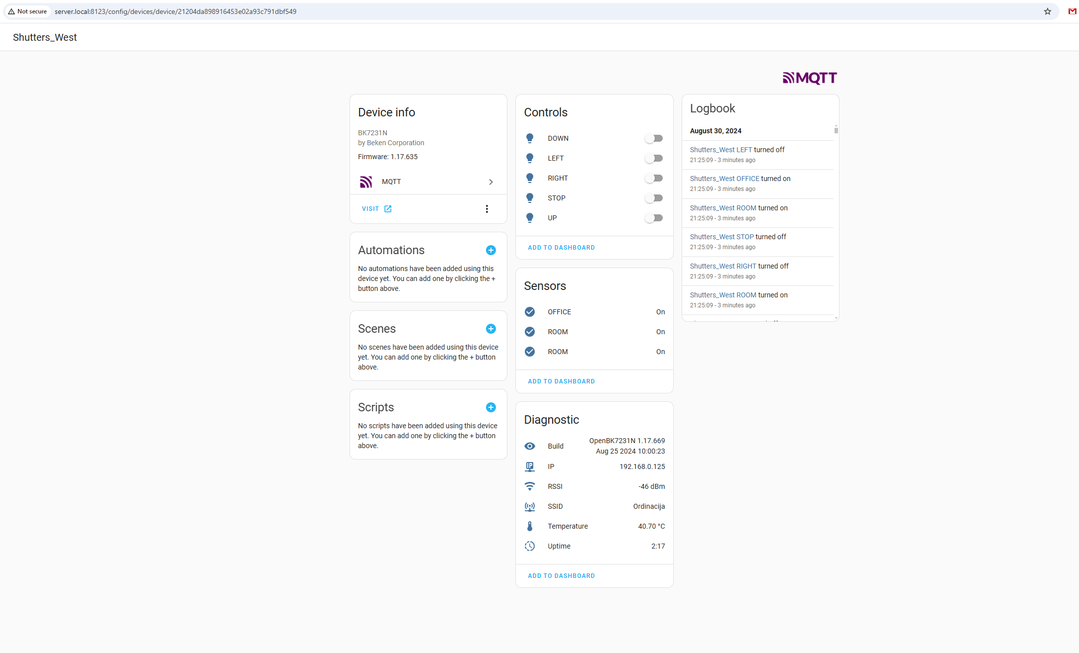

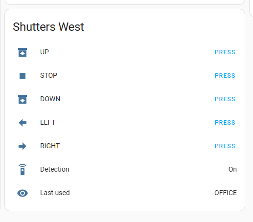

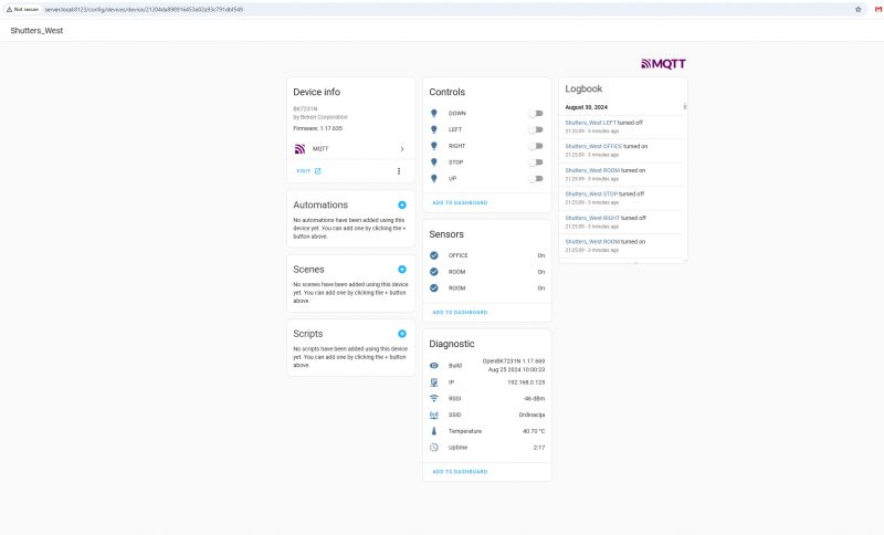

    We're also working on HA integration, but it's not fully read. Here's how automatic HASS Discovery sees this device:
    Screenshot of the BK7231N device control panel.
    The following already gives us ability to control shutters from there, but there is much more to be improved soon.

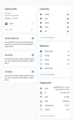

    A note on this project, this is still in very heavy development and I am adjusting things on the fly and still working on this but eventually goal is to add this to HA and make it 100% working. I will post updates if anybody is interested as I go.
    Many thanks to @p.kaczmarek2 for helping out with this!
    Added after 1 [hours] 44 [minutes]:
    I changed the design slightly to better handle LED's and added detection feature:
    PCB with electronic components and a battery holder.
    This will give me better reading as I am now reading before the LED's and so my signal has more consistency and no LED voltage bias in it.
    Also changed schematics/wiring for detection feature:
    Circuit diagram with NodeMCU CB3S module and optoisolators.
    To be continued...

    This was rather interesting and great learning experience for me, I've completed what I had in mind and I'll share more details now. Remember this project was highly dependent on the device I am using but overall it was a great experience and in principal this method of "high jacking" should work on whatever device.
    This is the pin setup I ended up using.

    //various aliases for detection and led readings
    alias NONE setButtonLabel 9 "NONE"
    alias DETECTED backlog setButtonLabel 10 "DETECTED"; setButtonColor 10 GREEN
    alias NOT_DETECTED backlog setButtonLabel 10 "NOT DETECTED"; setButtonColor 10 RED
    alias ZERO setChannel 11 0
    setButtonLabel 9 "LAST SELECTION"
    setButtonColor 9 GREEN
    setButtonEnabled 9 1
    addChangeHandler Channel4 == 1  if $CH9==0 then NONE
    addChangeHandler Channel5 == 1  if $CH9==0 then NONE
    addChangeHandler Channel6 == 1 setButtonLabel 9 "OFFICE"
    addChangeHandler Channel7 == 1 setButtonLabel 9 "ROOM 1"
    addChangeHandler Channel8 == 1 setButtonLabel 9 "ROOM 2"
    addChangeHandler Channel9 != 1 setButtonLabel 9 "ALL"
    setChannelLabel 10 DETECTION
    setButtonEnabled 10 1
    //reporting the state to HA
    addChangeHandler Channel6 == 0 setChannel 11 1
    addChangeHandler Channel7 == 0 setChannel 11 2
    addChangeHandler Channel8 == 0 setChannel 11 3
    addChangeHandler Channel9 == 1 setChannel 11 4
    addChangeHandler Channel4 == 1  if $CH9==0 then ZERO
    addChangeHandler Channel5 == 1  if $CH9==0 then ZERO
    setChannelLabel 11 SELECTION
    //publishChannel 11
    //loop for reading states of led's and detection
    again:
    if $CH6==0&&$CH7==0&&$CH8==0 then "setChannel 9 1" else "setChannel 9 0"
    if $CH10==0 then DETECTED else NOT_DETECTED
    delay_s 2
    goto again
    One thing to mention is that I set CH11 to be ReadOnly so I can publish the value to HA and convert it to meaningful reading with some customization in configuraion.yaml file.
    sensor:
      - platform: template
        sensors:
          location_status:
            friendly_name: "Last used"
            value_template: >
              {% set value = states('sensor.shutters_west_selection') %}
              {% if value == '0' %}
                NONE
              {% elif value == '1' %}
                OFFICE
              {% elif value == '2' %}
                ROOM 1
              {% elif value == '3' %}
                ROOM 2
              {% elif value == '4' %}
                ALL
              {% else %}
                UNKNOWN
              {% endif %}
    I created an template "last used" that I can then use against CH11 reading and convert that into text instead of numbers.
    Device in HA as discovered:
    Control panel for the BK7231N device with various options.
    Custom card in HA dashboard with that template used:
    User interface controlling shutters with buttons for directions and information on detection and last used option.

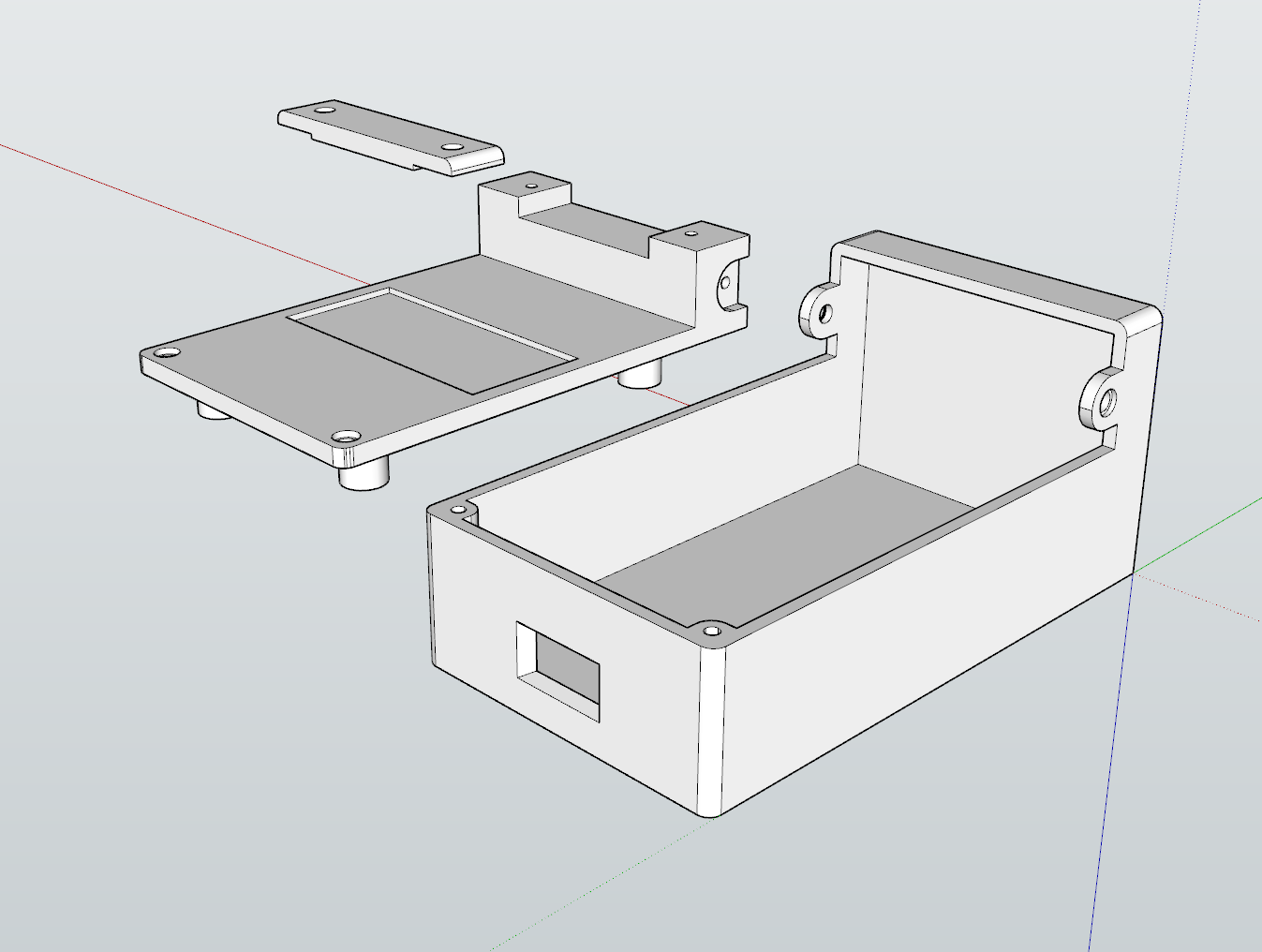

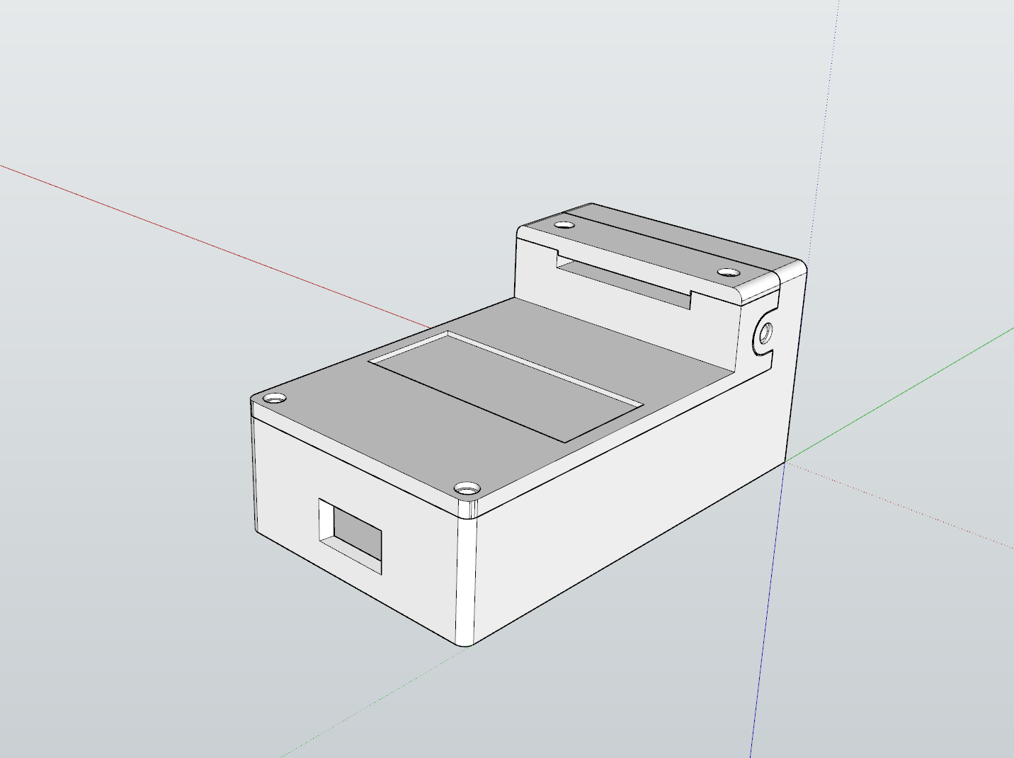

    In the end I decided to create a custom 3D printed case for it and went over several design iterations to confirm dimensions and tolerances, I believe it took me 8 or 9 revisions. I ended up with this for my final design.
    3D enclosure design consisting of two parts in SketchUp Prototype device enclosure created in SketchUp.
    I did that in SketchUp (as I am used to it) and attached are the files both original and exported STL.
    And finally this is what the device looks like along with OBK home page:
    Electronic device mounted in a white 3D-printed case
    Control panel for Shutters_West with control buttons.
    Everything works as intended together with HA integration and control.

    Since this was my long term project I decided to test out CC1101 RF module and control it and then use it to control all my blinds, it has been done and working so expect CC1101 integration at some point into OBK I guess...

What is a PC817 optocoupler, and why might it be used for injecting button presses into an RF remote?
A PC817 can isolate the Wi‑Fi board electrically from the remote while still simulating a button closure. "PC817 is an optocoupler that transfers a control signal through light, providing galvanic separation between two circuits while behaving like an isolated switch path in low-speed control tasks." In this build, the output Rel pins drove PC817 devices so the OpenBeken board could press the remote’s 5 button lines with less risk of directly tying grounds or logic domains together. [#21213596]
PC817 optocouplers vs direct GPIO button injection in an OpenBeken remote hack — which approach is better and when?
Direct GPIO injection is simpler, but PC817 optocouplers are better when the remote’s button circuit is electrically uncertain. The documentation notes optocouplers were used here, while the supporting author also states they were not strictly necessary if the button wiring already matched safe GPIO injection conditions. Choose direct wiring for fewer parts and choose PC817 for isolation, safer experimentation, or unknown button topology. The project’s final hardware stayed with PC817 on the button outputs. [#21210711]
