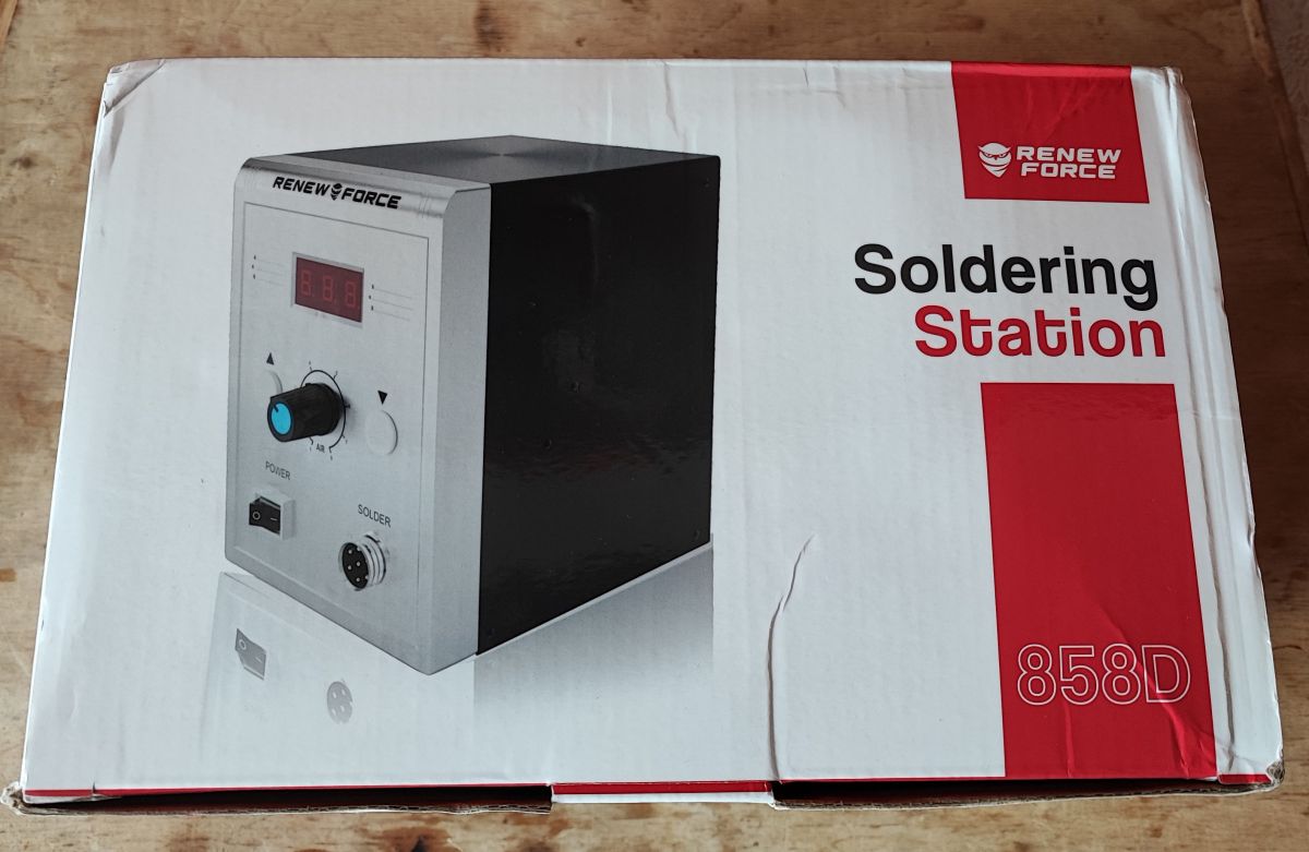

Box of Renew Force 858D hot air soldering station. .
Today I'm testing a classic, budget 858 hot air soldering iron possible to buy for as little as PLN25-30 often appearing under different versions and names, such as DexXer 700W, or 858D, 858A, etc. I will check if this station is able to solder components from the motherboard at different temperatures and try to measure the resulting temperature at the nozzle output and present it on graphs.

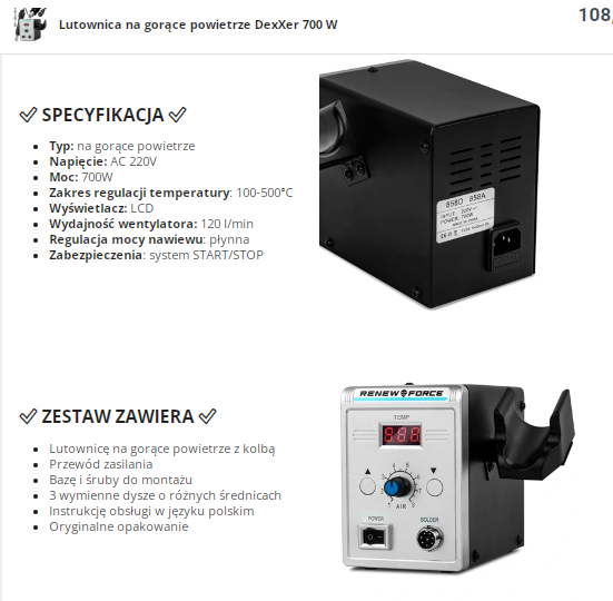

Here is some information from one of the sellers of this station, specifications:
Specifications and set of the hot air soldering station DexXer 700W. .

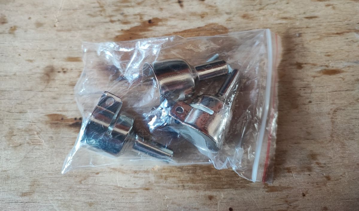

Here we have three basic nozzles with diameters of 3.5mm, 6.5mm and 9mm:
Set of three metal hot air nozzles in a plastic bag. .

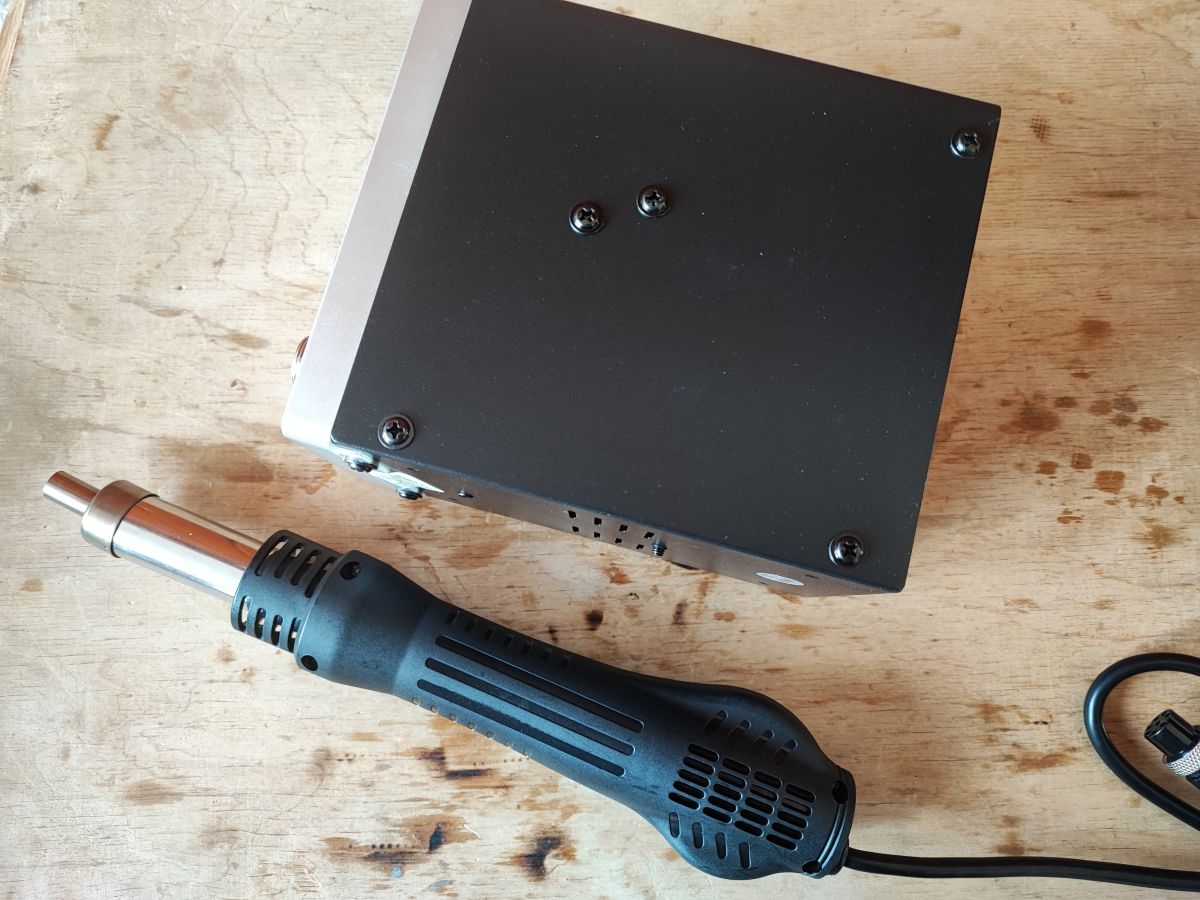

And, of course, the station - zero extra bits:
Hot air soldering iron 858 and station on a wooden surface. .
There is also a flask carrier (I didn't take a photo).

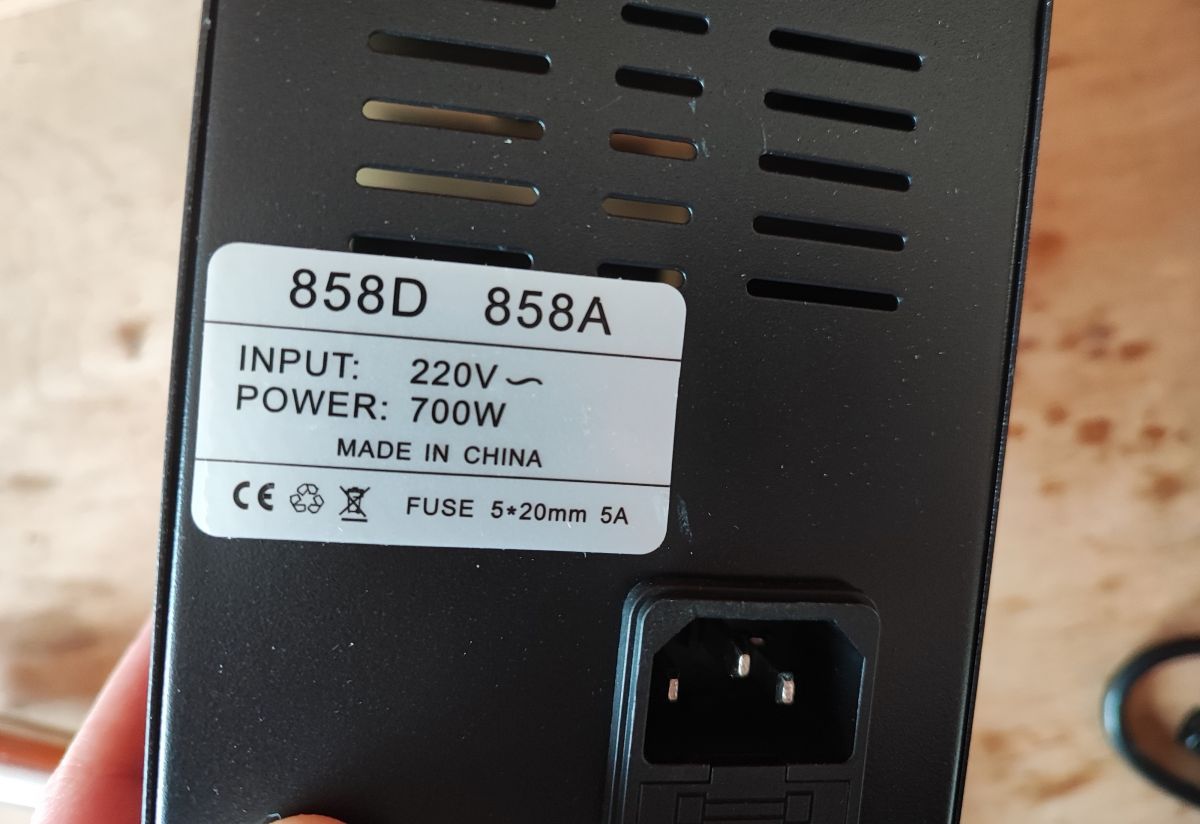

700W, 5A fuse:
Nameplate of soldering station 858D/858A. .

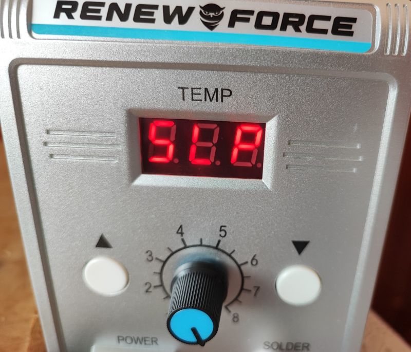

For blowing we have a classic potentiometer, for temperature control we have a 7-segment red display:
Control panel of a Renew Force hot air soldering station with temperature display. .

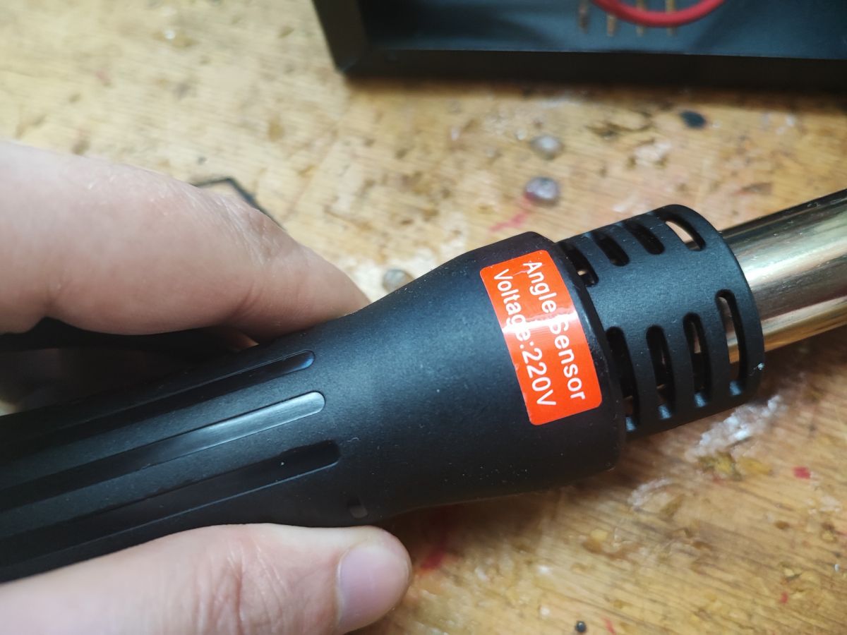

The sleep (detection of the station put down) is realised by a sensor based on the tilt of the flask:
Close-up of a black hot air soldering iron with a sticker labeled Angle Sensor Voltage 220V. .

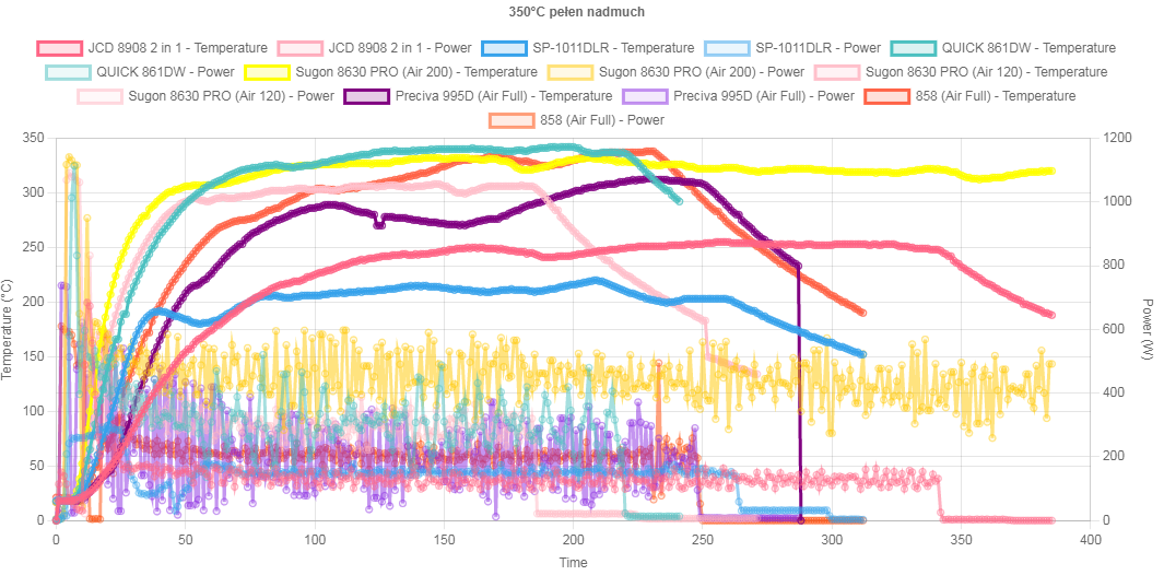

Such games of soldering a component out of scrap in time may be fun, but it's also better to measure something. The standard assumption here is to use the highest blowing, although in many cases it could be reduced (then it could also heat a bit harder), but that's the assumption I started with and it's hard to change anymore.

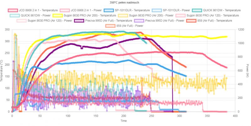

First a graph at 350°C:
Graph comparing temperatures and power of various hot air soldering stations. .
Interactive version:
https://openshwprojects.github.io/hotair/version4/350c.html
However, the feedback that the 858 is a classic and doesn't do badly was true. It even beats the Preciva station here, and interestingly enough, both of these stations claim 120l/m blowing at full setting, but I have not verified this.
Of course, heating up is about three times slower than in stations 10 times more expensive anyway, but does it make a difference to a beginner?

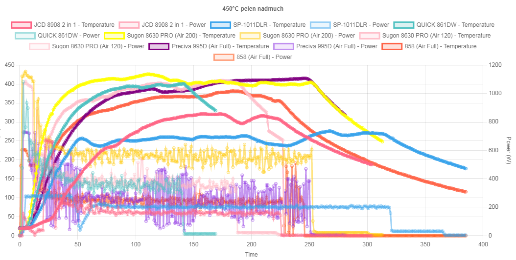

Now the graph at 450°C:
Chart comparing hot air soldering stations at 450°C. .
Interactive version of the graph:
https://openshwprojects.github.io/hotair/version4/450c.html
Here, however, the station does not beat the 2-3 times more expensive Preciva station. Initially it heats up faster, but then it lacks power. I recorded a maximum of around 380°C. The Preciva reached about 30 degrees more.

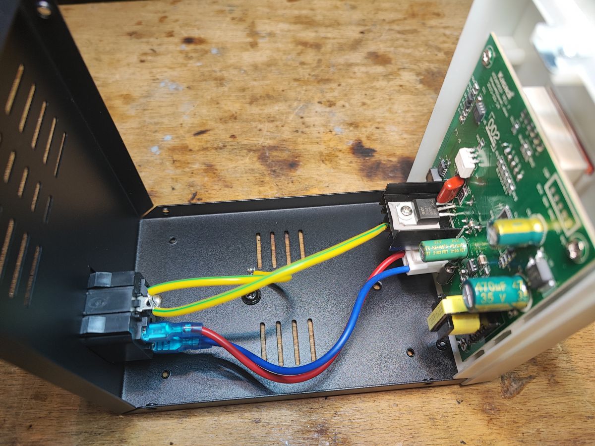

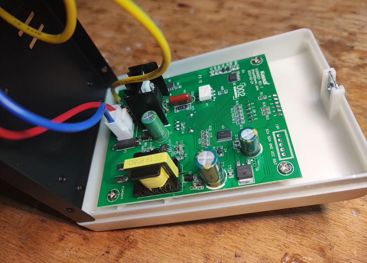

We remove the lid. Surprisingly there is a lot of free space inside, in fact the housing could be much smaller:
Interior of the 858 hot air soldering station with visible wires and electronic components. .
The PCB on the front panel contains everything you need - the power supply is there too, a tiny flyback of course:
Close-up of the interior of a hot air soldering station with a visible PCB. .

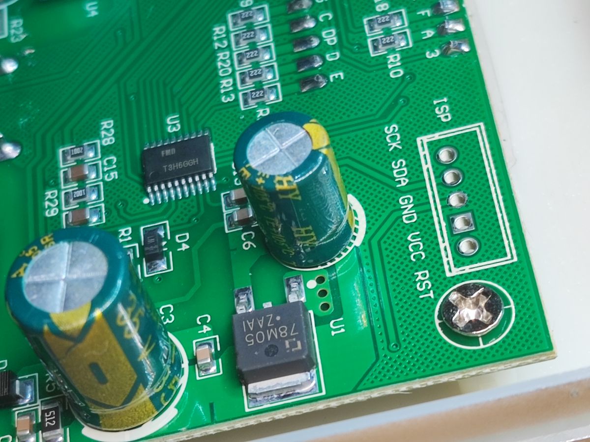

Connector with SDA, SCK and RST and power supply - could it be for programming? Via I2C something?
Close-up of a PCB with an integrated circuit and capacitors. .

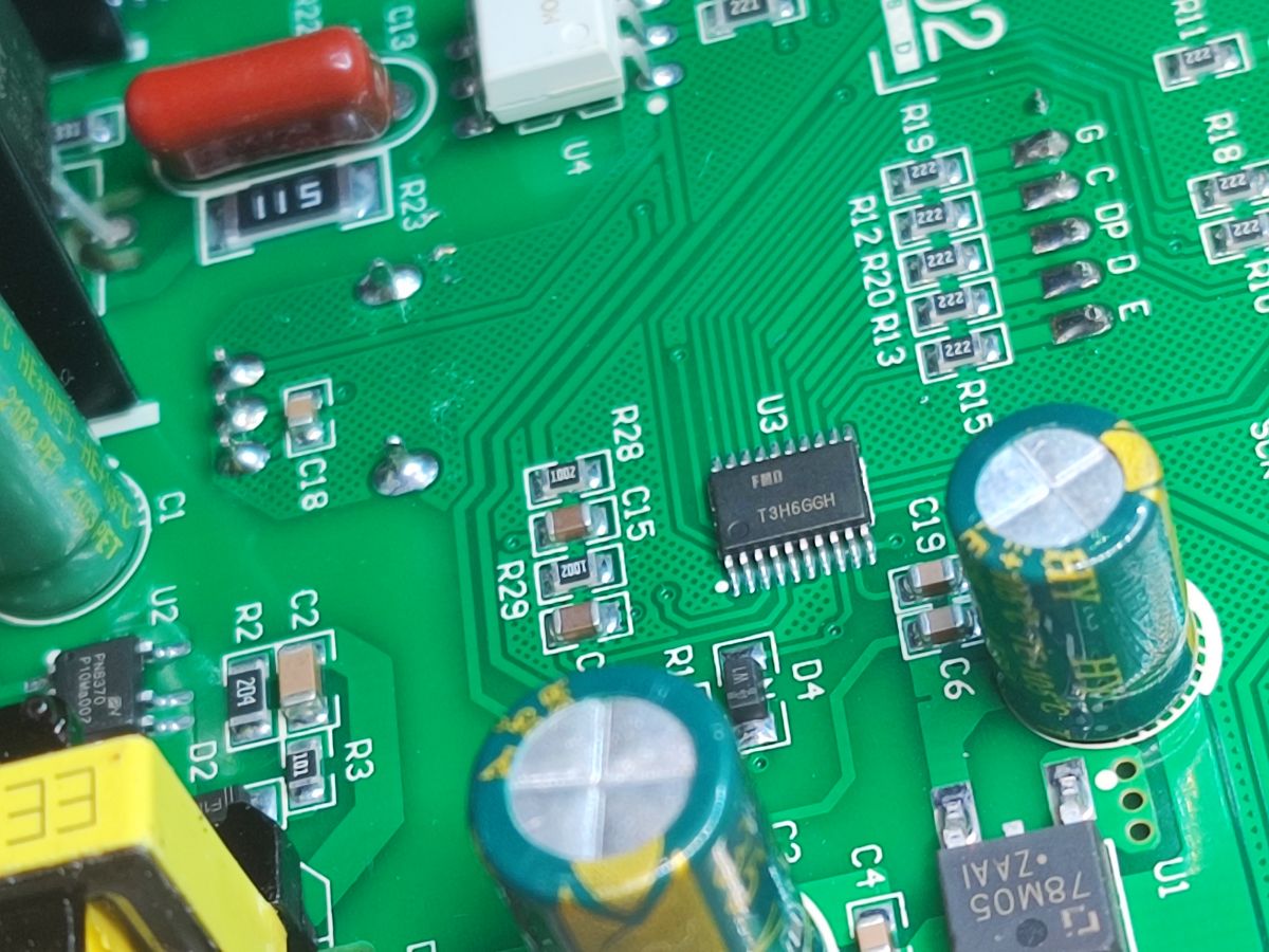

I think the main MCU is the FMD T3H6GGH:
Close-up of electronic components on a printed circuit board .

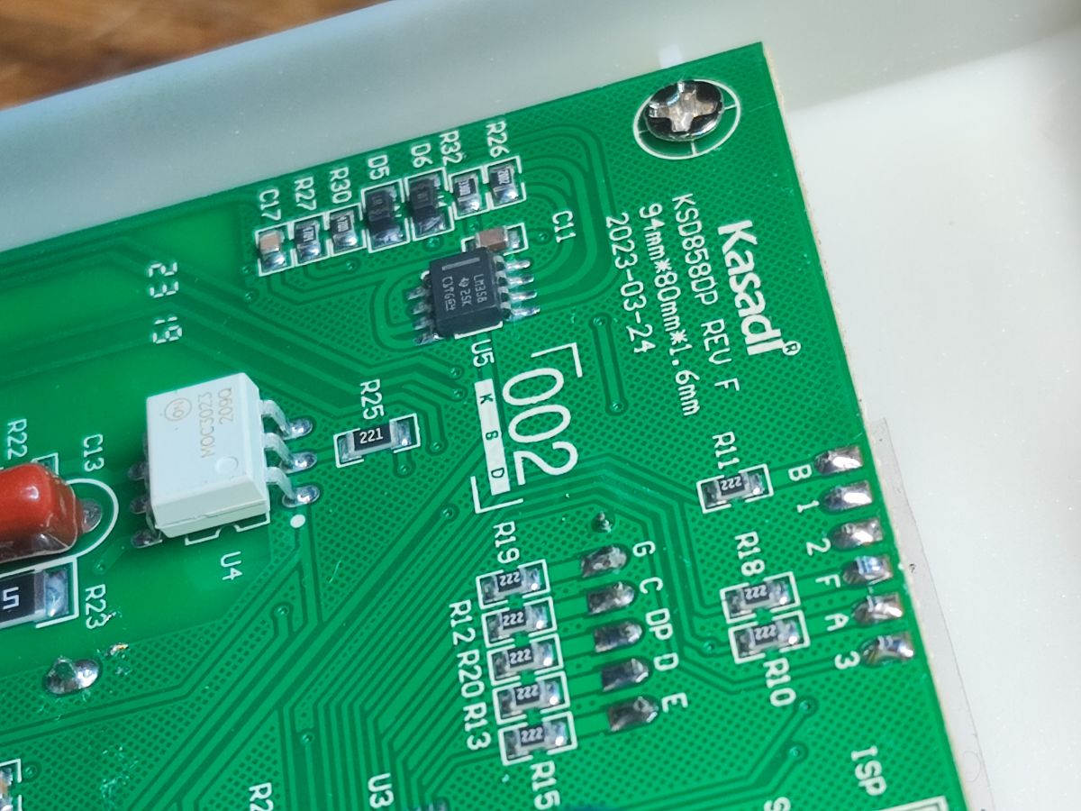

PCB designation:
Kasadi
KSD858DP REV F
2023-03-24
Circuit board of the Kasadi KSD858DP REV F soldering station. .

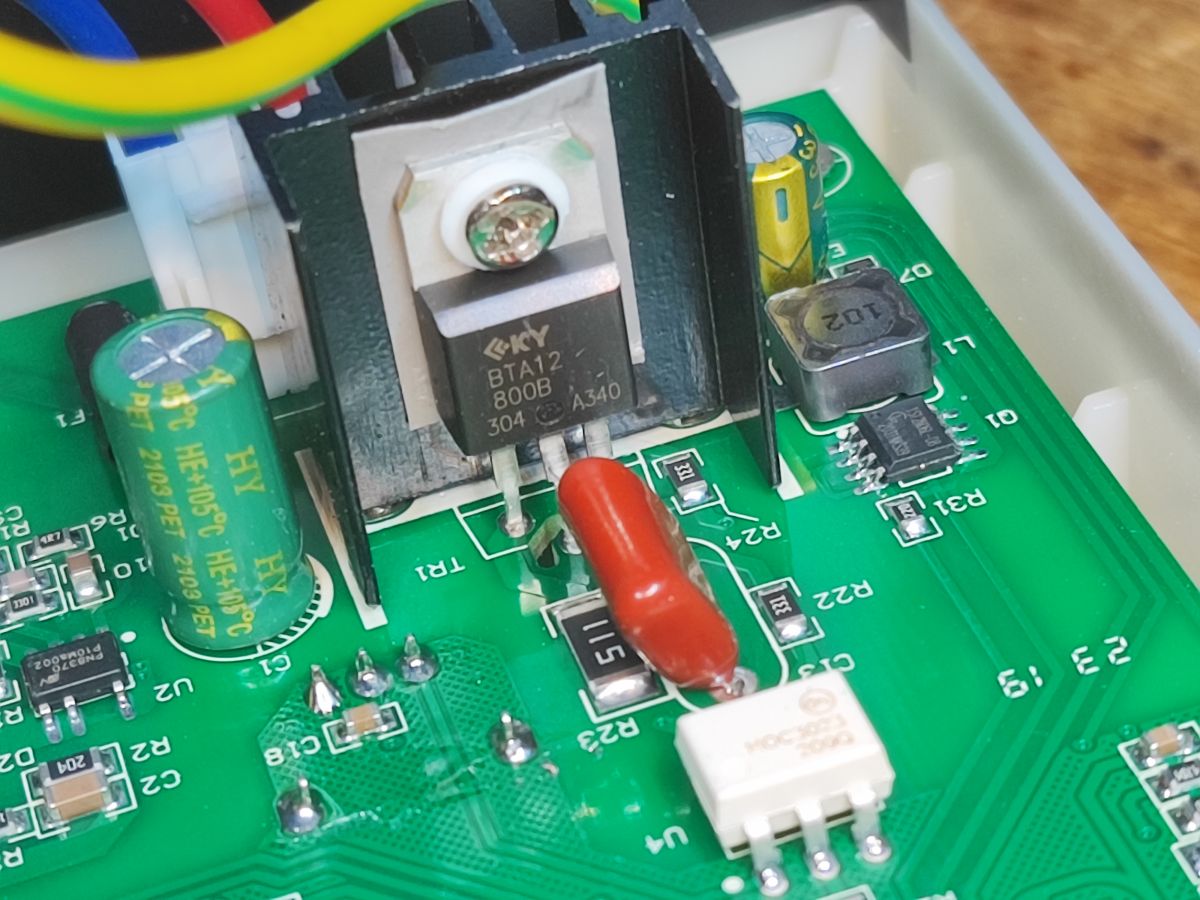

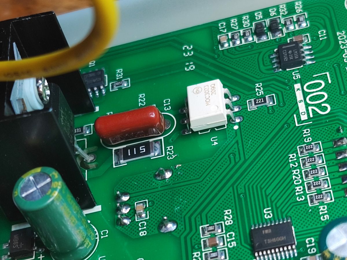

Executive part, optotriac MOC3023:
Close-up of electronic components on a green printed circuit board. .

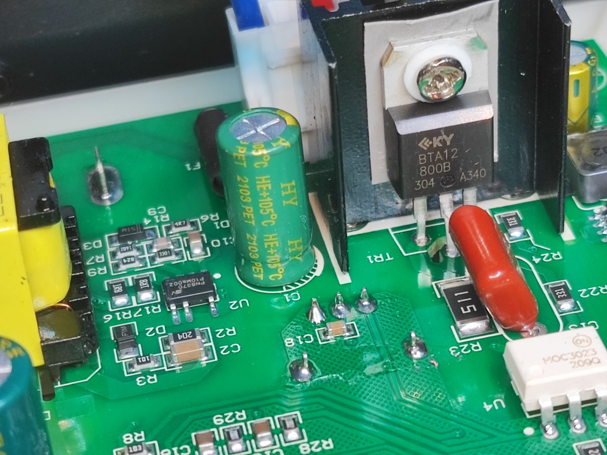

This optotriac in turn controls the BTA12 800B:
Image of the inside of a soldering station with visible electronic components. Close-up of the inside of a soldering station with a BTA12 chip and capacitors on a green PCB. .

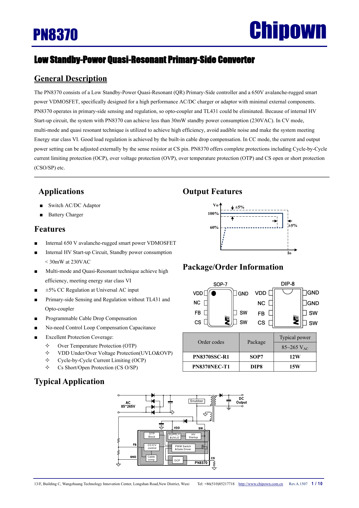

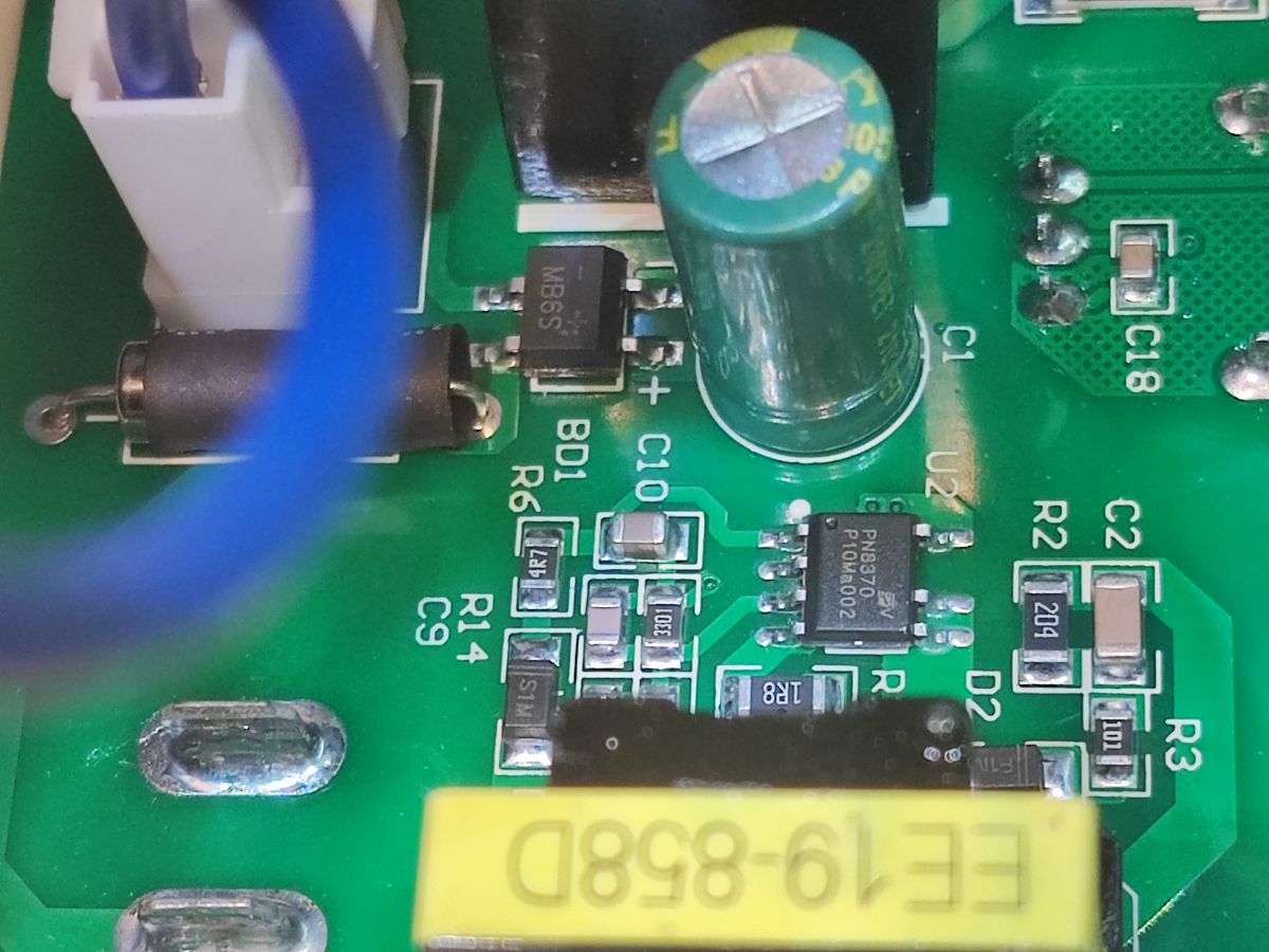

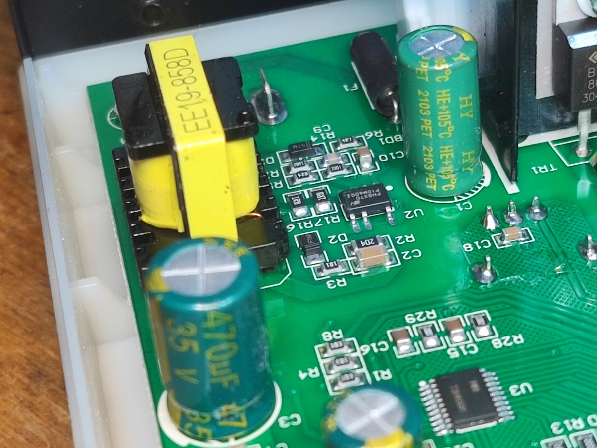

And the aforementioned power supply - it is based on the PN8370:
Close-up of the interior of a 858 soldering station showing electronic components on the PCB. Close-up of the internal part of the hot air 858 station with visible electronic components. .
Some information about the PN8370, including an overview diagram of such an inverter:
Page from Chipown's PN8370 technical documentation. .

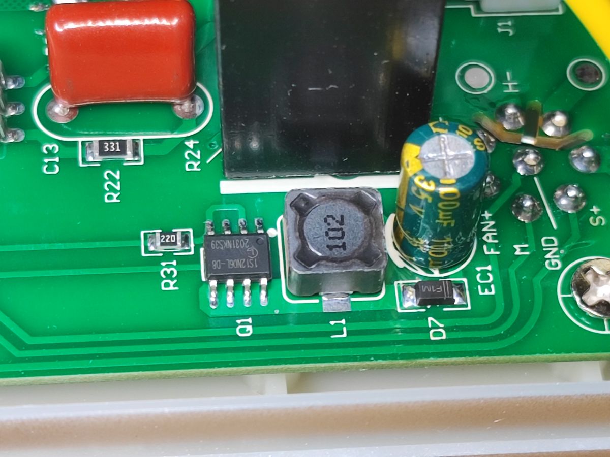

I spotted some more circuitry on board which I first thought was an inverter, but it looks like it's a 1S12N06L-D8 MOSFET, maybe an air supply control?
Close-up of an electronic circuit on a green PCB with a capacitor, inductor, and integrated circuit. .
