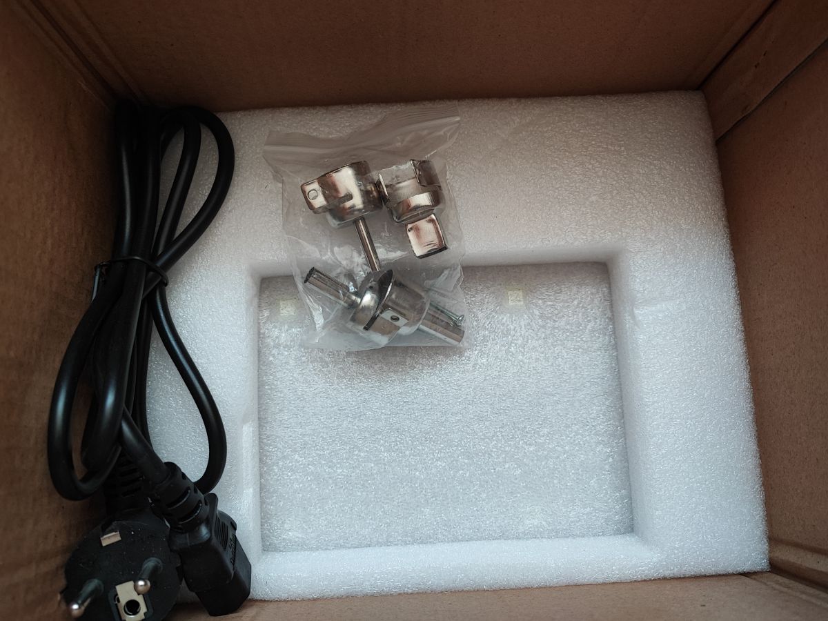

    We start as usual with a presentation of the packaging and kit:
    Packaging of Yato YT-82457 hot air soldering station. .
    Maximum air flow power is as usual 120l/min, similar to the other stations. I think of those I have tested so far only the Sugon 8630 PRO offered 200l/min.
    The kit comes with instructions and additional nozzles:
    User manual of Yato YT-82457 soldering station in a box Soldering station packaging with accessories .

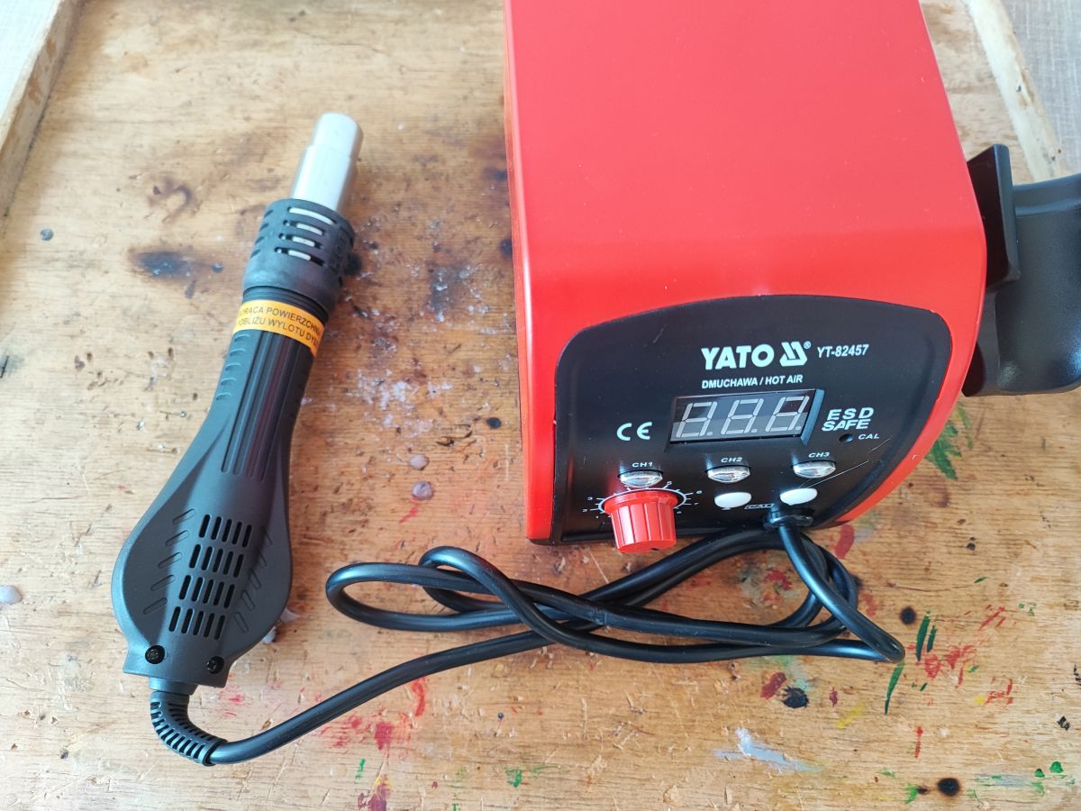

    And then there is the station itself:
    Yato YT-82457 hot air soldering station with blower. .

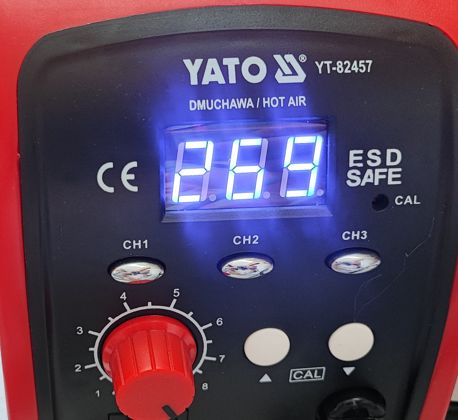

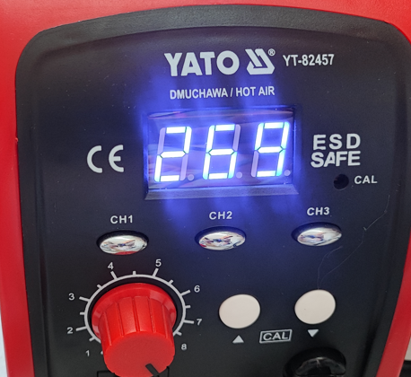

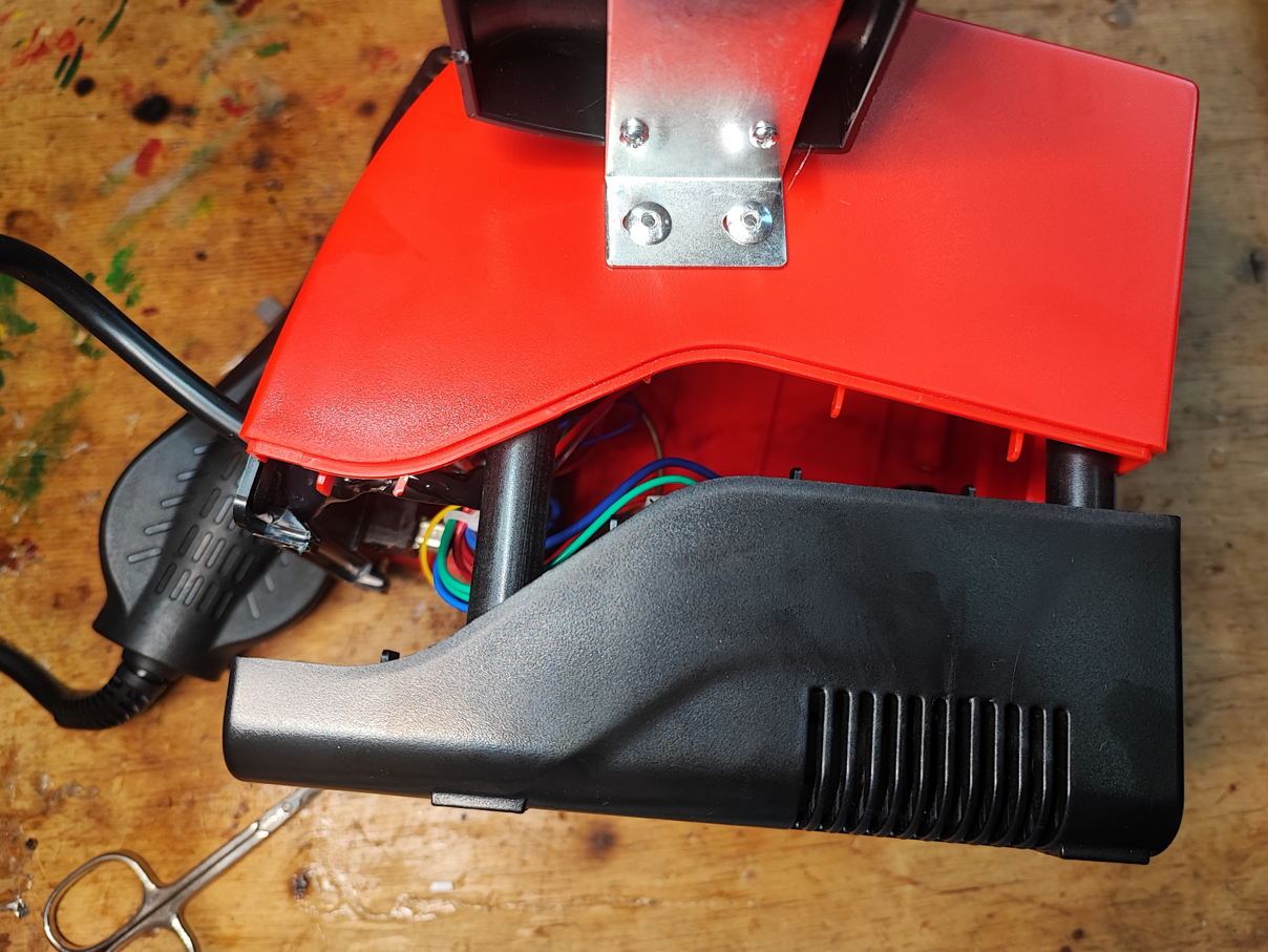

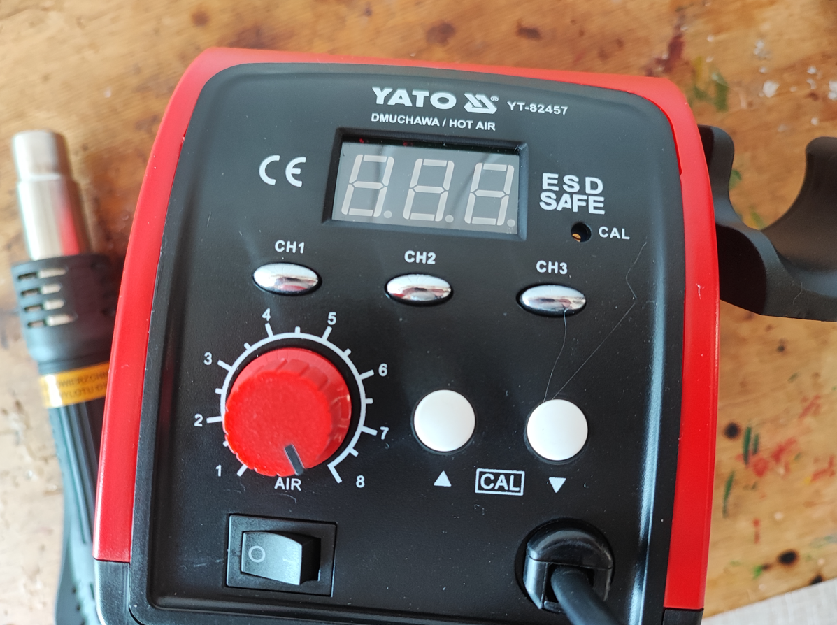

    Here is the first remark - this station has the possibility of setting three programmes which can make our work a little easier. The 858 discussed earlier did not offer this.
    Interior of the Yato YT-82457 soldering station showing wiring and a transformer. Control panel of the Yato YT-82457 soldering station with LED display and adjustment knob. Nameplate of the Yato YT-82457 soldering station Nozzle of soldering station with Polish warning label Close-up of the nozzle part of a Yato soldering station with a warning label. .
    The display is quite clear, while the casing seems to be quite cheap plastic.
    Control panel of the Yato YT-82457 soldering station with digital display. .

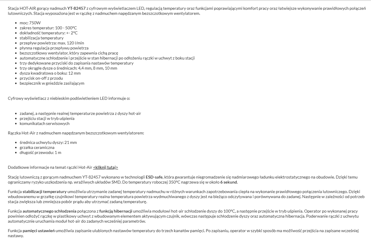

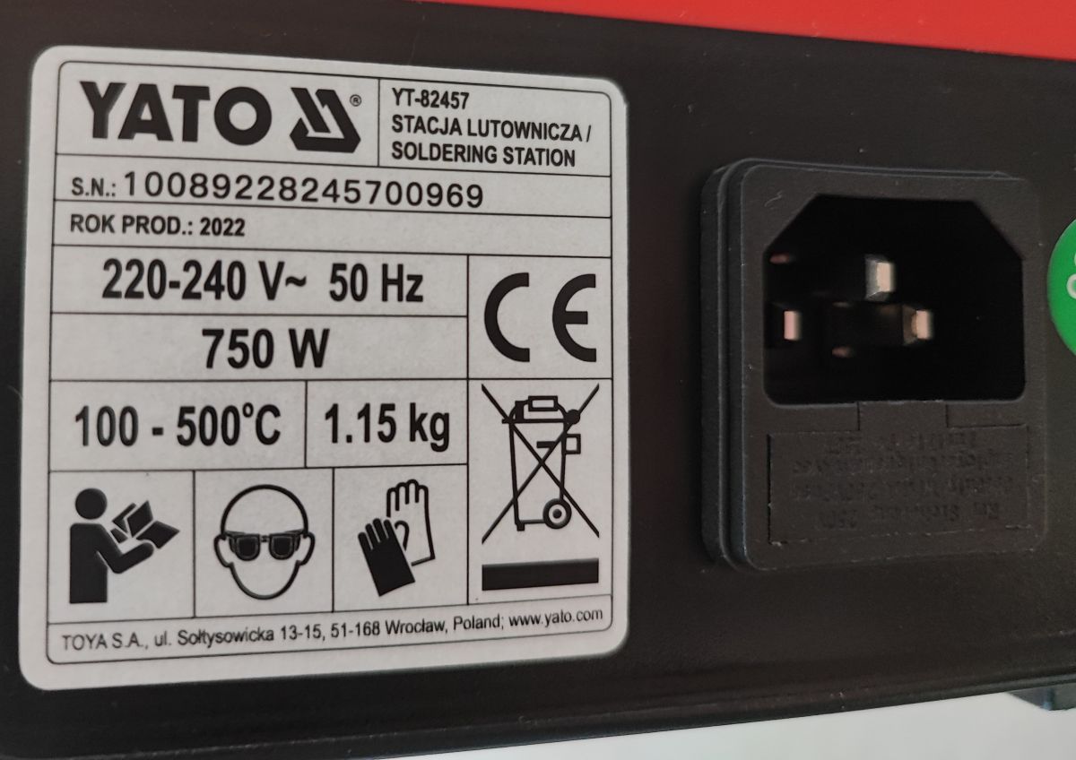

    Specifications and description in Polish:
    Specifications of the Yato YT-82457 soldering station. .

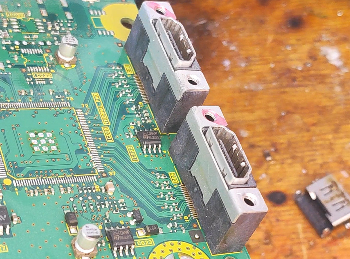

    400°C, soldering of the standing HDMI socket by heating on the other side of the PCB:
    Close-up of a motherboard with two HDMI ports. .
    It was possible to remove the socket without tearing the tracks or melting the socket itself.

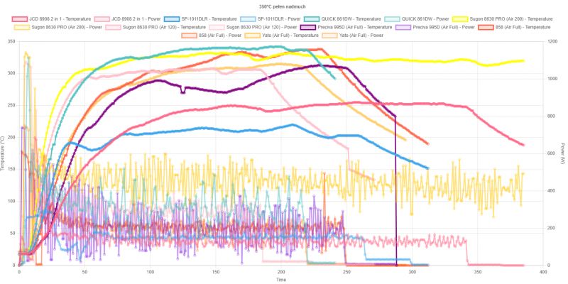

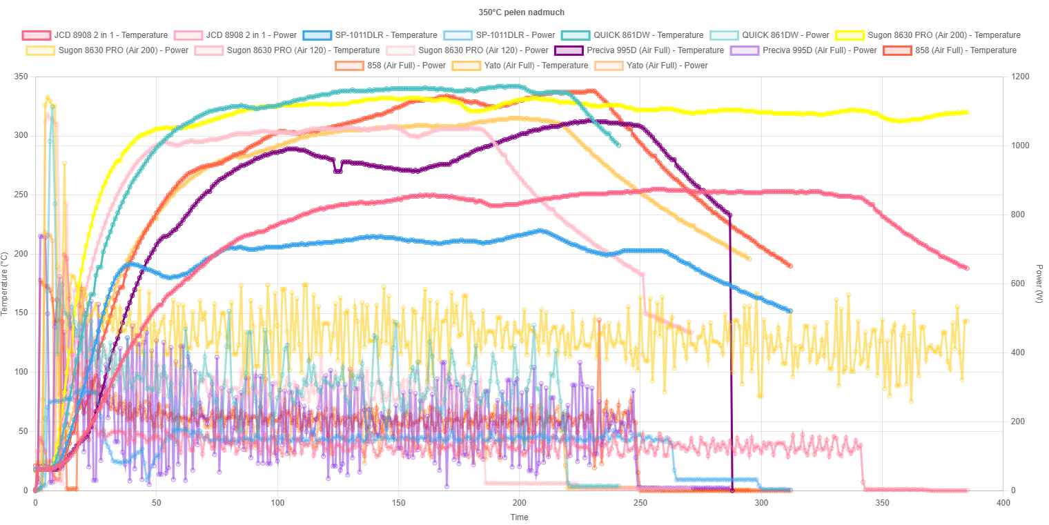

    I made the graphs based on my set up with a thermocouple:
    OpenBeken configuration for hot air testing - MAX6675, temperature and power logging .
    First a graph at 350°C:
    Comparison chart of temperature and power for hot air soldering stations at 350°C. .
    After about 100 seconds, the probe actually recorded over 300°C.
    Interactive version:
    https://openshwprojects.github.io/hotair/version5/350c.html

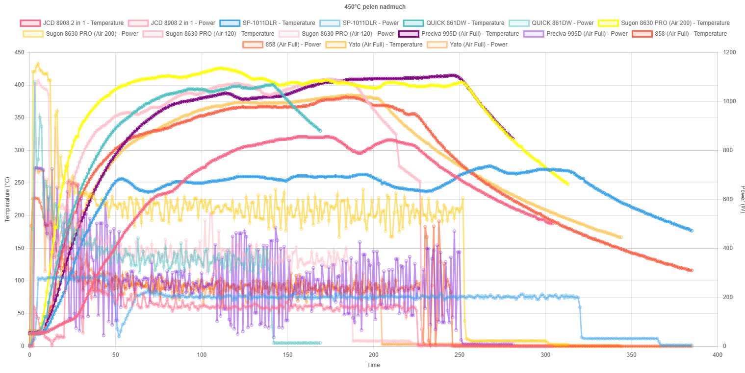

    Now the graph at 450°C:
    Graph comparing temperature and power of different hot air stations at 450°C. .
    After about 90 seconds, the probe actually recorded over 350°C, then the temperature already rose more slowly and approached 375°C in 200 seconds.
    Interactive version of the graph:
    https://openshwprojects.github.io/hotair/version5/450c.html
    The final evaluation will be in the last paragraph.

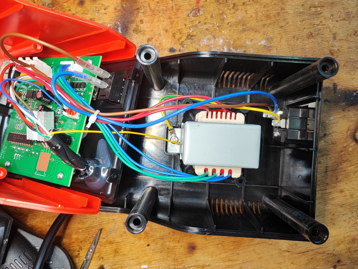

    We take a look inside:
    Yato YT-82457 soldering station undergoing technical tests on a workshop table. .

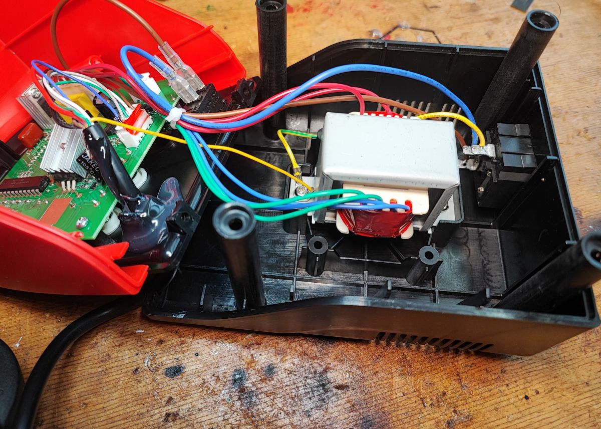

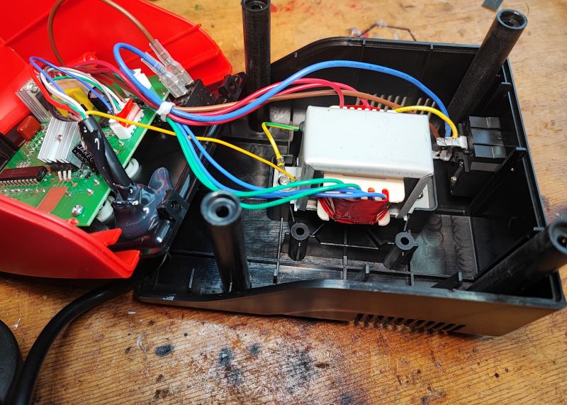

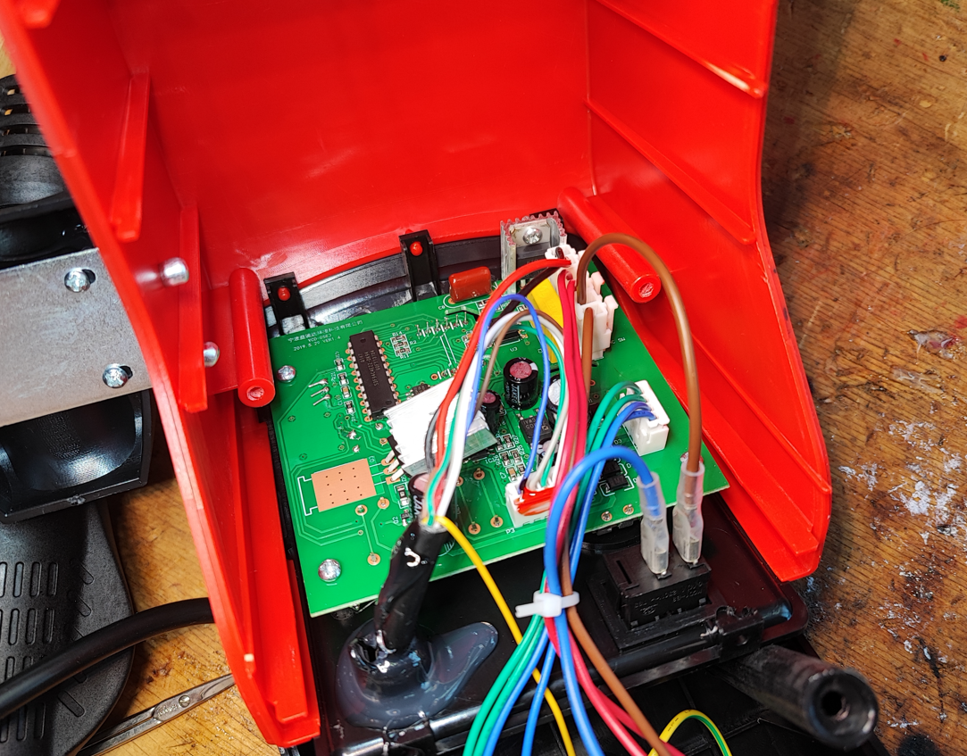

    The first thing that catches the eye is the 50/60Hz mains transformer. The 858 had a boost converter.
    Interior of the Yato YT-82457 soldering station. Inside of the Yato YT-82457 soldering station with visible wires and components. .
    Inside of the Yato YT-82457 soldering station .
    The ground is connected...
    Close-up of the interior of a soldering station showing electronic components. Close-up of the printed circuit board of the Yato YT-82457 soldering station.
    Close-up of the interior of the Yato YT-82457 soldering station showing the electronic circuitry. .

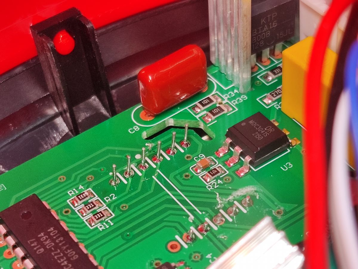

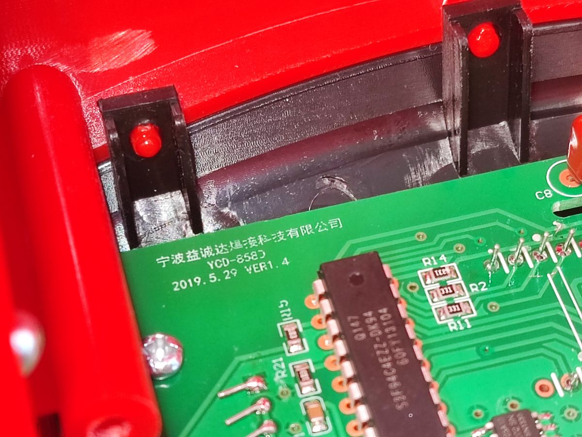

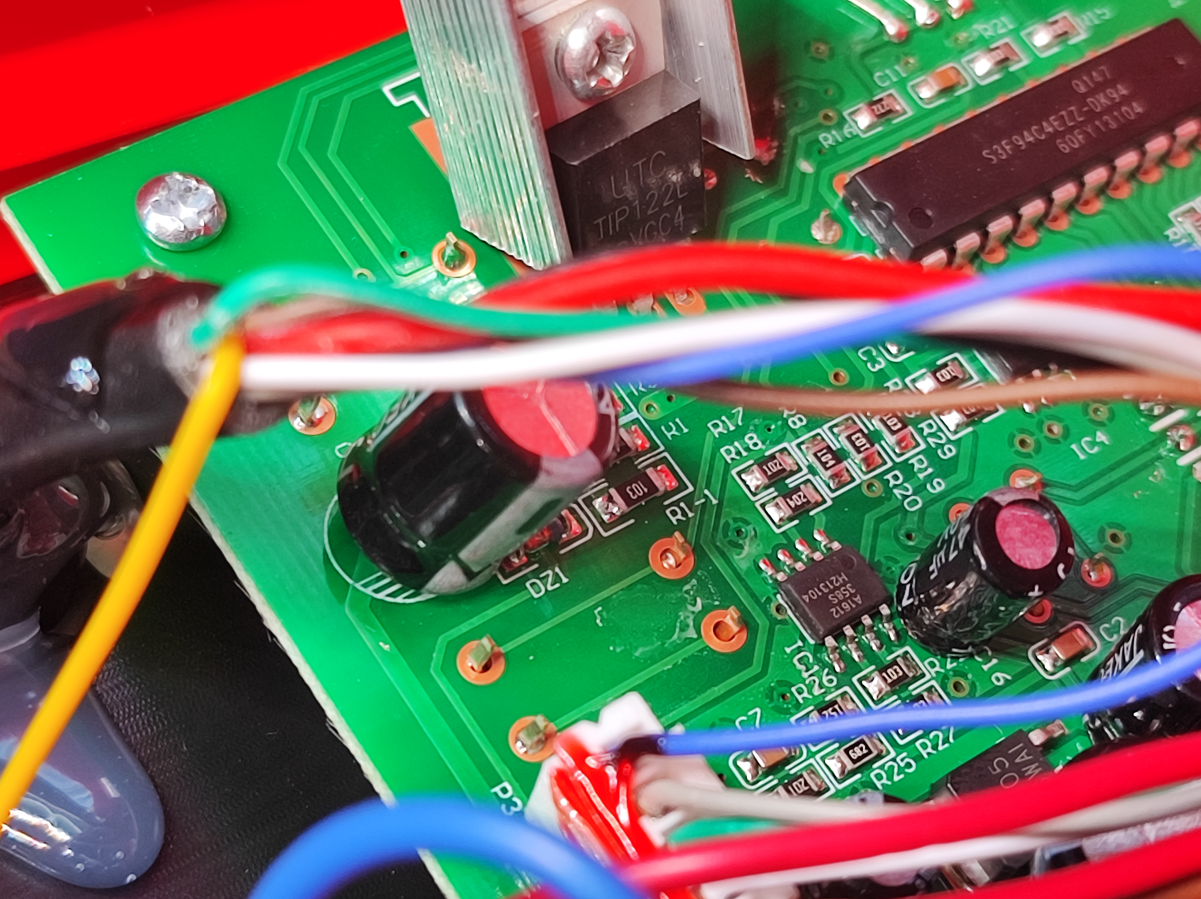

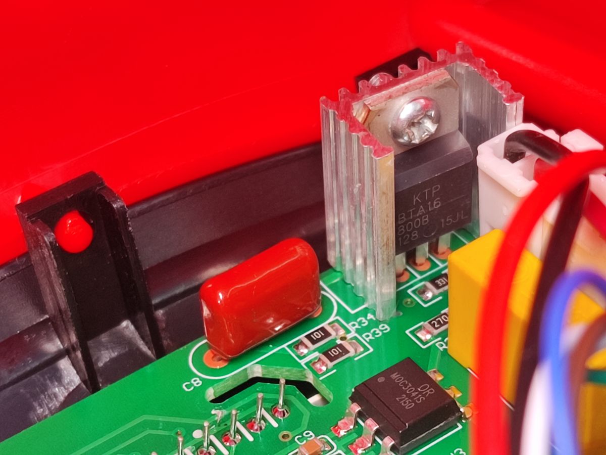

    Inside, the regulation is again on a BTA16-800B triac (in the 858 there was a BTA12), controlled by a MOC3041S.

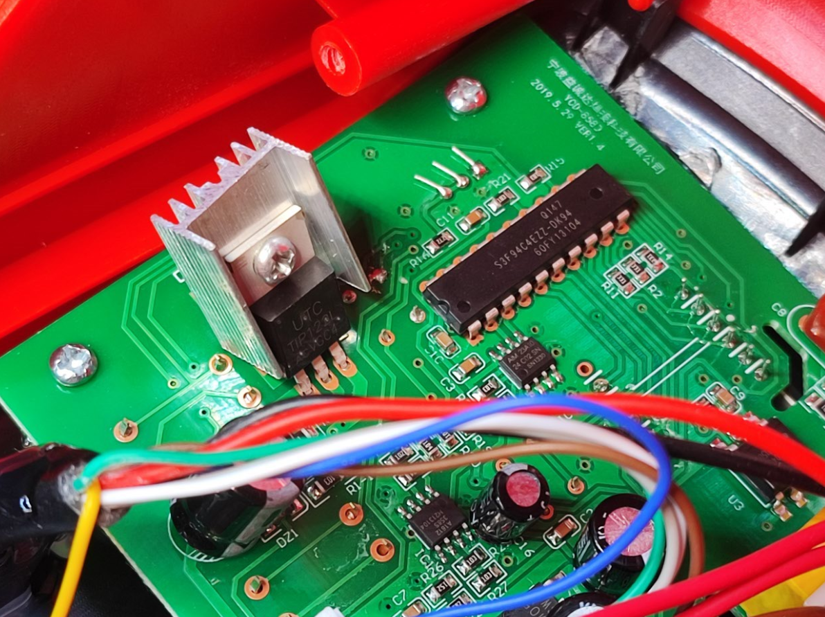

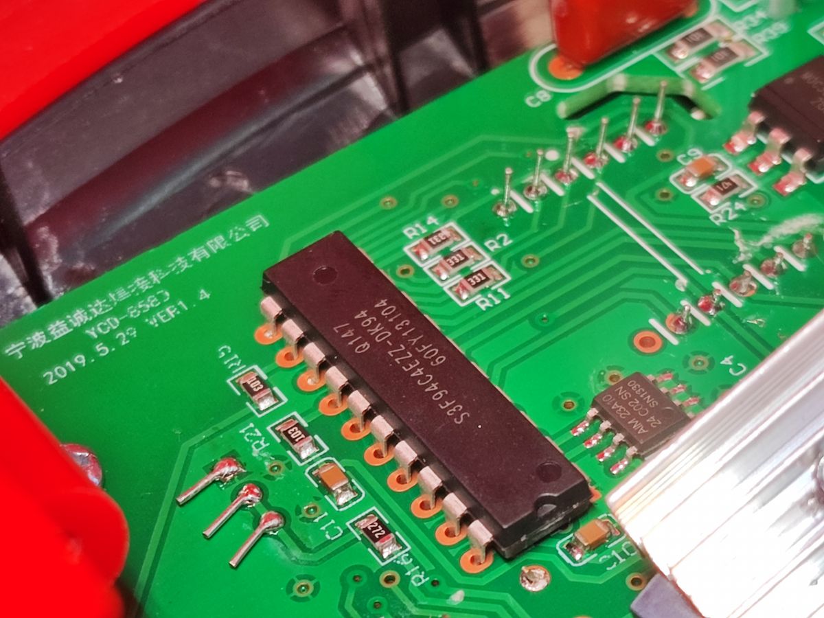

    The PCB designation is. YCD-858D. Well rather unsurprisingly, this is a very popular design.
    Close-up of the interior of a soldering station with a visible PCB and model markings YCD-858D. Soldering station mainboard with visible electronic components .

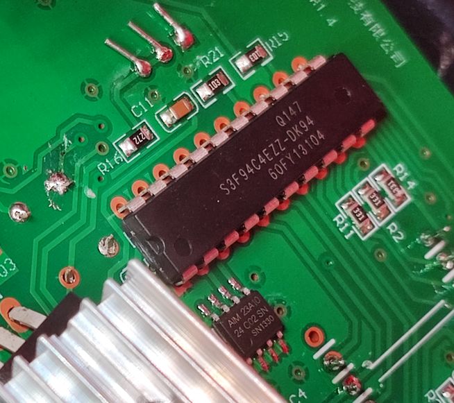

    The whole design is based on the S3F94C4EZZ-DK94 MCU. The microcontroller is manufactured by Zilog. Next to it I also see an EEPROM - 24C02SN, I wonder what they hold there, calibration, settings?
    Close-up of the internal components of the Yato YT-82457 soldering station.. Close-up of the interior of a Yato YT-82457 soldering station with visible electronic components .
    I was still interested in this transistor - it's a TIP122L, maybe from the air supply control? Interesting that it's mounted on an extra heatsink, although there's room on the PCB to solder it on. Maybe it was overheating in the previous version, hence the change?

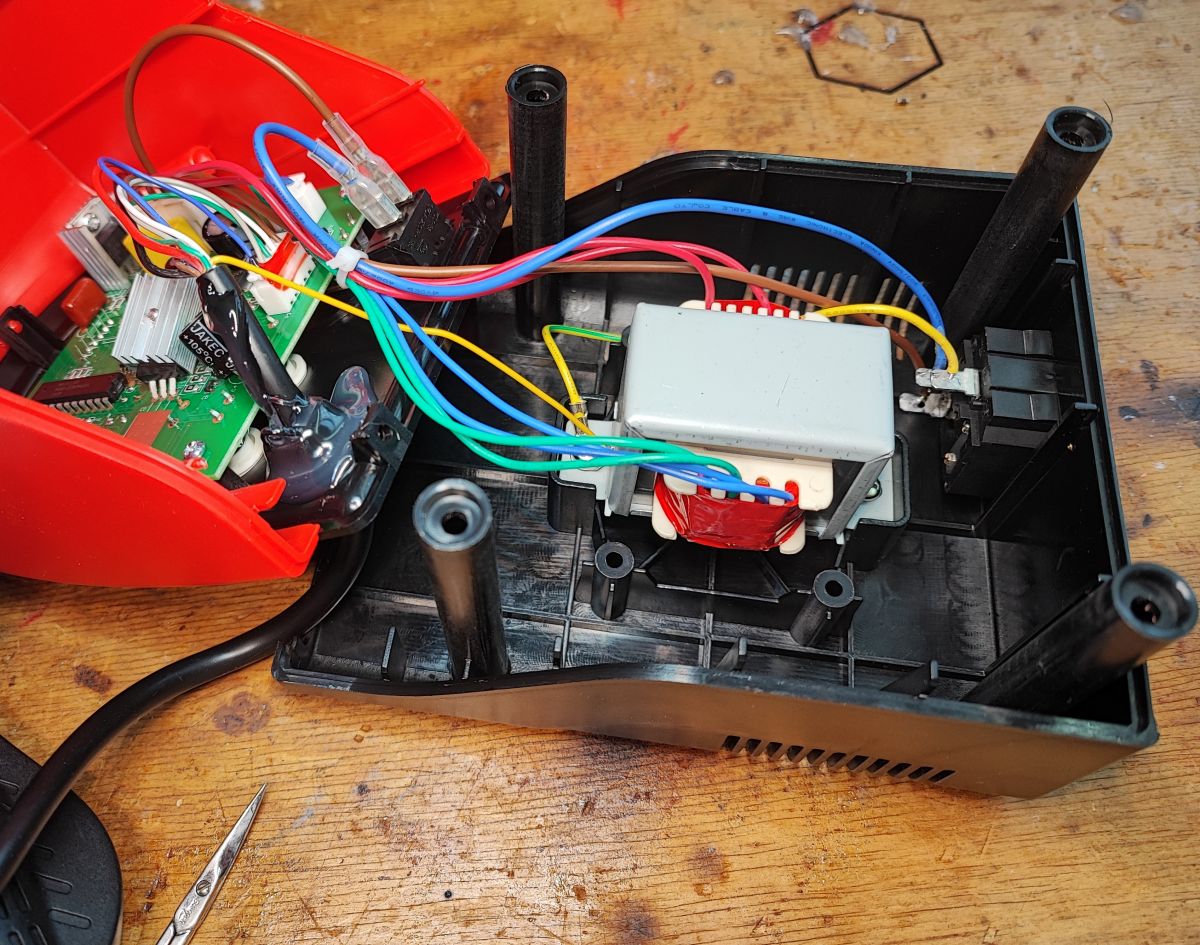

    A. The pictures don't do it justice, so I'm asking. What colour is the display?
    B. What's the deal with the heatsink and the bent transistor? How is the whole thing mounted?
    Inside of the Yato YT-82457 soldering station with visible wires and components. Close-up of the internal components of the Yato YT-82457 soldering station.
  • Heatsink left floating above the PCB
    #5 21299264
    Posts: 14763
    Rate: 12893
    The heatsink is hanging in the air, I was a bit concerned about that. It looks as if this transistor was originally supposed to be soldered to the PCB (and the copper spout was supposed to dissipate heat) but then it was decided to give a heat sink after all....
    I only gently bent the transistor to see its marking.
    The display is, in my opinion, light blue, although indeed I think I would have preferred it to be red, maybe then it would have been a bit clearer, but I don't pick on such details in a review.

    Well. a transistor that only miraculously does not break off during transport. Microswitches soldered on "in order to". And a solderless IEC socket...

  • A coil on a large copper area did not come off at 350°C after 2 minutes, but removal succeeded at 400°C in just over 1 minute. [#21298835]
  • Thermocouple logging showed the station reached over 300°C after about 100 s with a 350°C setting, and over 350°C after about 90 s with a 450°C setting, later approaching 375°C by 200 s. [#21298835]
  • Inside, the station uses a mains transformer, a BTA16-800B triac driven by MOC3041S, a YCD-858D-marked PCB, an S3F94C4EZZ-DK94 MCU, 24C02SN EEPROM, and a TIP122L on a separate heatsink. [#21298835]

How do the three memory programs on the Yato YT-82457 work, and what settings are worth saving in them?
They store three user presets and keep them even after power-off. The reviewer tested the memory and reported no complaints, so the feature works as expected. A practical setup from the thread would be: 1. save 350°C for lighter SO8 work, 2. save 400°C for larger joints like coils or HDMI work, 3. save 450°C for stubborn motherboard MOSFETs, all with high airflow because that was the main test condition. [#21298835]

What is inside the Yato YT-82457, and how does its internal design compare with the popular YCD-858D / 858 platform?
Inside, it looks very close to the common 858 family. The thread identifies a mains transformer, BTA16-800B triac, MOC3041S driver, YCD-858D-marked PCB, S3F94C4EZZ-DK94 MCU, 24C02SN EEPROM, and a TIP122L transistor on a separate heatsink. The reviewer explicitly says the construction is similar to the 858 and calls the YCD-858D layout a very popular design, which places this station firmly in that platform lineage. [#21298835]
Why would a hot air station use a mains transformer instead of a boost converter, and what difference does that make in practice?
In this thread, the practical difference is architectural, not a measured performance claim. The reviewer points out that the Yato uses a 50/60 Hz mains transformer, while the 858 he discussed earlier used a boost converter. He does not report a direct user-visible advantage from that alone, but he does show that the Yato still delivers workable heat on motherboard jobs, so the transformer-based build does not prevent effective budget performance here. [#21298835]
How accurate is the displayed temperature on the Yato YT-82457 compared with thermocouple measurements at 350°C and 450°C?
The displayed temperature reads higher than the thermocouple measurement point in the reviewer’s setup. At a 350°C setting, the probe recorded only over 300°C after about 100 seconds. At a 450°C setting, it recorded over 350°C after about 90 seconds, then rose more slowly and approached 375°C by 200 seconds. Those graphs show useful heating, but not a one-to-one match between display value and measured probe temperature. [#21298835]

How does the Yato YT-82457 compare with the Preciva 995D, Quick 861DW, Sugon 8630 Pro, JCD 8902, and SP-1011DLR for heating performance?
It sits in the middle of the tested group. The reviewer says the Yato YT-82457 and the 858 feel very similar at full airflow, the Preciva 995D is slightly better than both, and the Sugon 8630 Pro plus Quick 861DW outperform all of them by a wider margin. He also says the JCD 8902 2-in-1 and SP-1011DLR fall far behind, making the Yato a solid budget option but not a substitute for higher-end rework stations. [#21298835]
Why is the TIP122L transistor in this station mounted on a separate heatsink, and what problems could that layout cause over time?
The thread suggests it was moved to a separate heatsink because heat management on the original PCB position was not good enough. The reviewer notes that there is room to solder the TIP122L directly to the PCB, but the installed version uses an added heatsink, and he speculates this may reflect an earlier overheating issue. Another participant criticizes the mechanical execution, warning that a poorly supported transistor can risk breaking off during transport or long-term handling. [#21298835]
