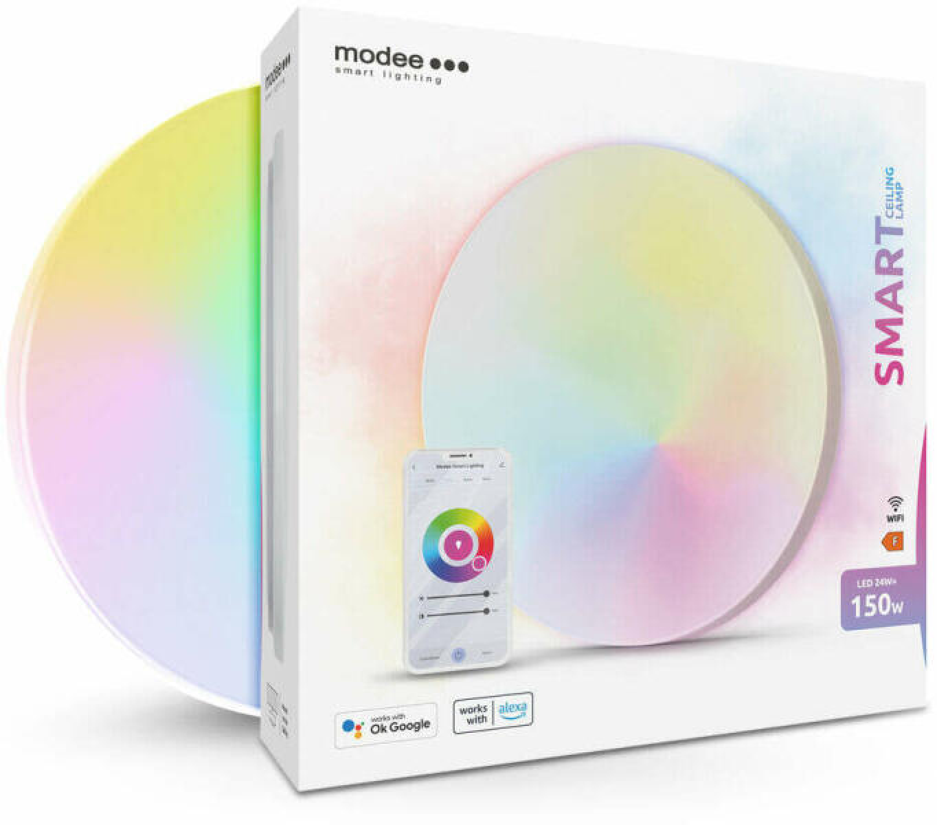

We bought some Modee LED 24W RGBCW lamps in order to realise lighting in the corridor based on them. Here I will show the inside of one of these lamps and the procedure for changing its firmware to free it from the manufacturer's cloud. Then we will also pair it with Home Assistant via MQTT, using automatic HASS Discovery.
