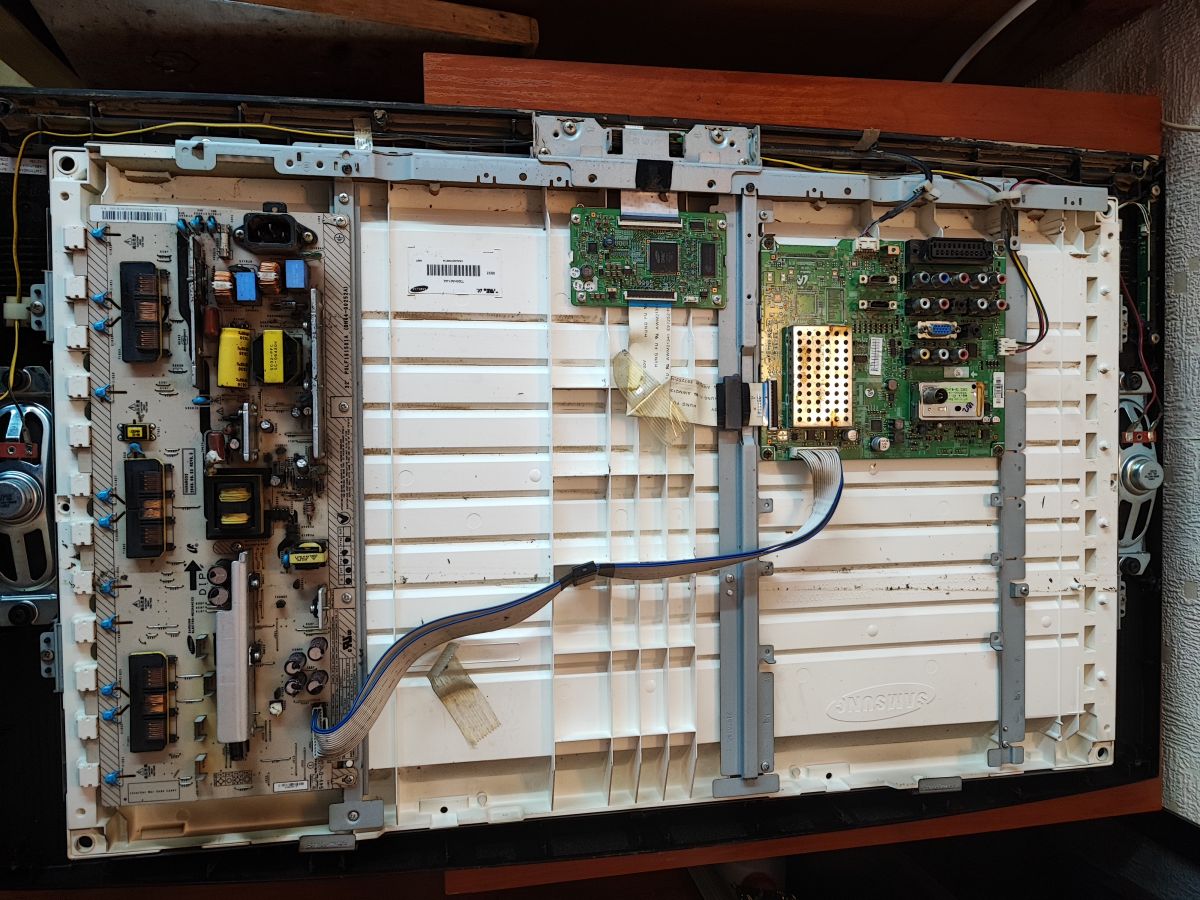

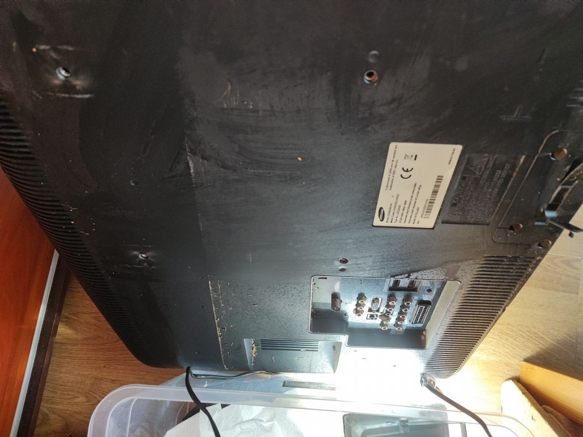

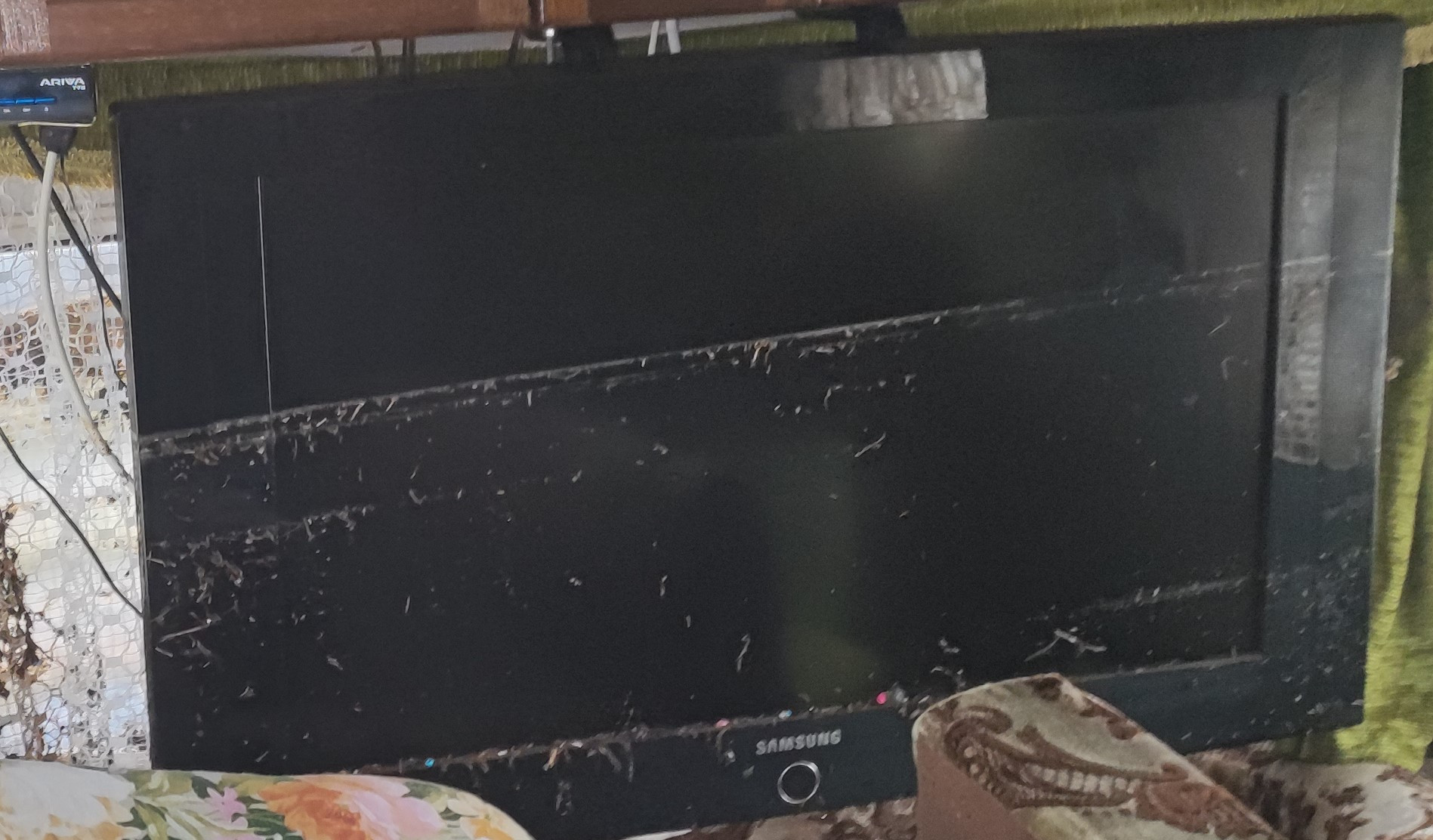

What does the inside of a TV set flooded look like? Is it still possible to get such a television working? How much work does it take to clean it, how deep is the water able to reach inside? Will a flooded Samsung still work? Let's find out! In this topic, I will just deal with such a TV, model LE32A330J1N.
The TV was flooded halfway through by water, you can basically see the liquid level in the picture. It was under water for about half a day, the electricity had been switched off earlier, so basically the worst of it had passed. However, it is, of course, all dirty:
Back of Samsung LE32A330J1N TV with visible dirt from flooding. .

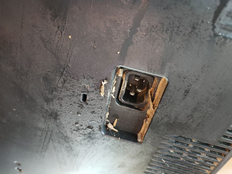

Silt has settled everywhere, even at the mains connector:
Power connector of a flood-damaged TV with visible silt deposits.

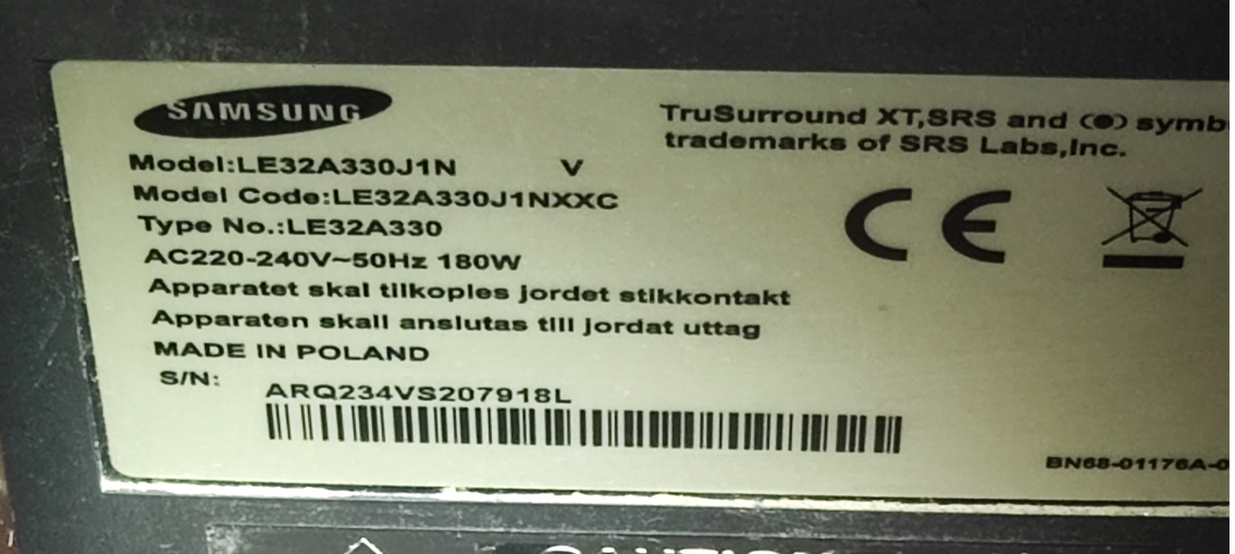

Plate:
Nameplate of Samsung LE32A330J1N TV with technical information.
I took care of the TV 3 weeks after it was flooded, so it had time to dry out a bit.

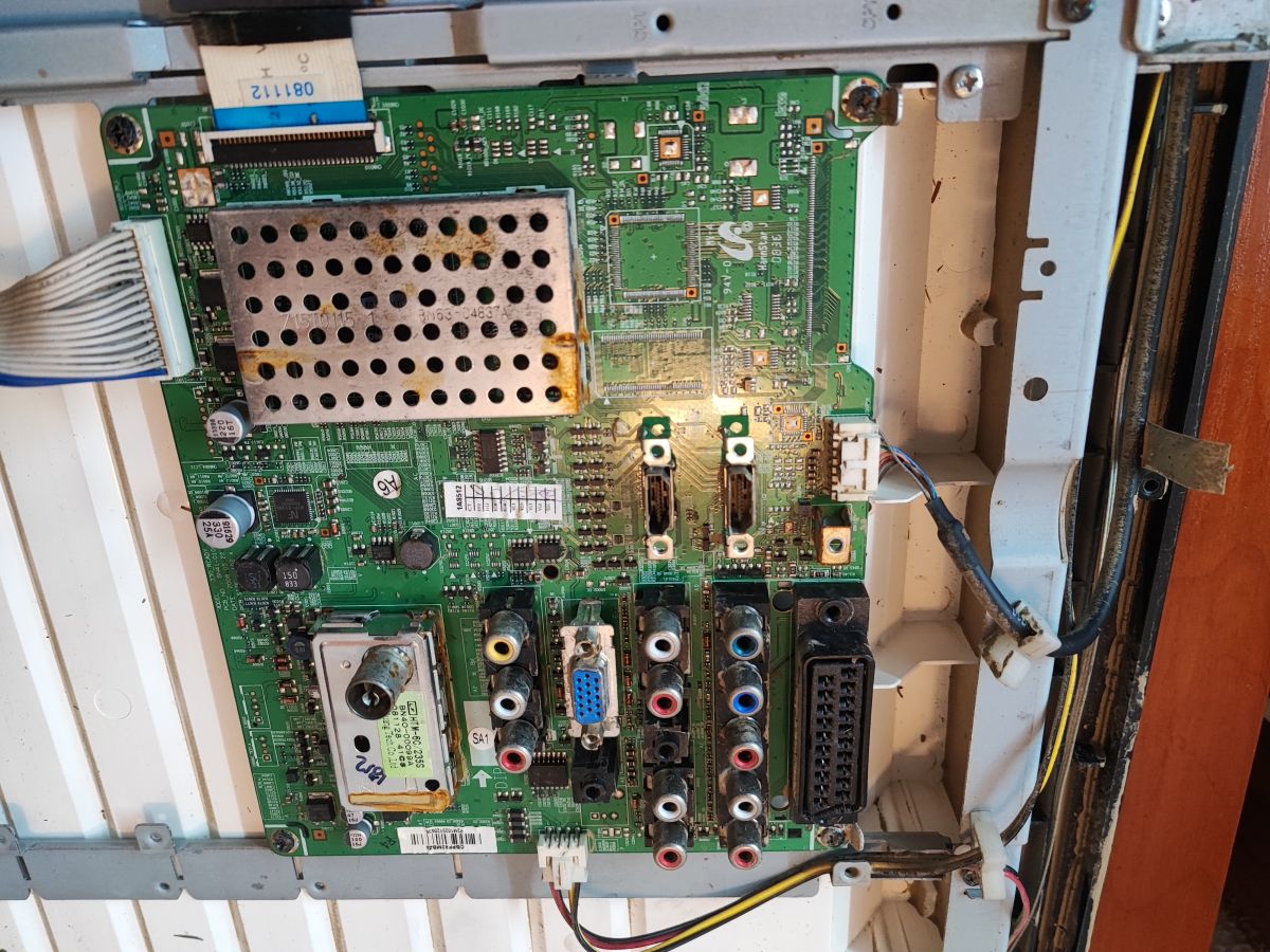

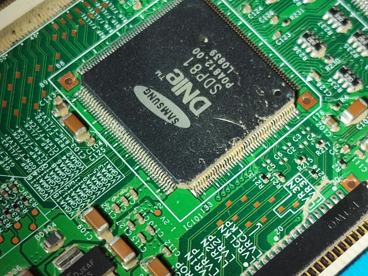

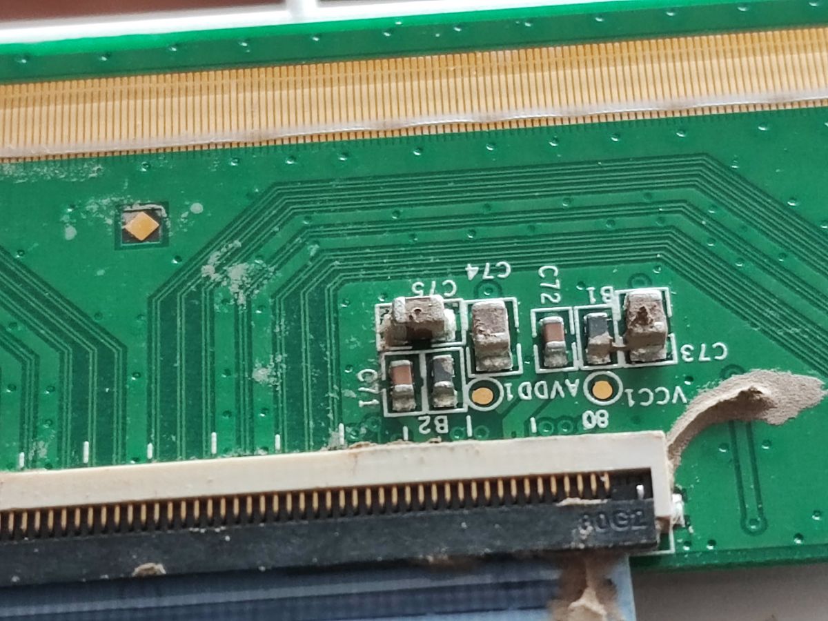

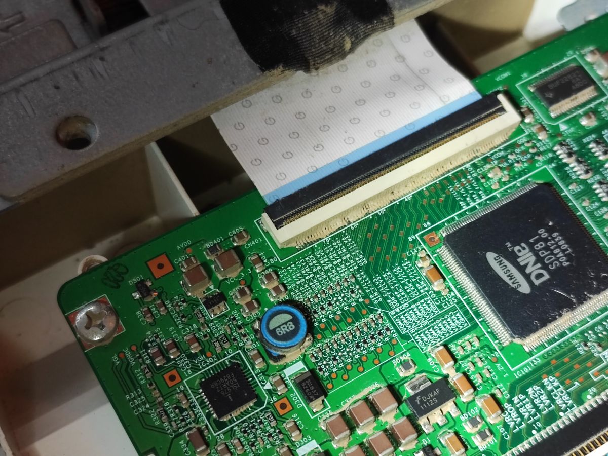

On the face of it, it's not too bad, I checked the coils and ICs for moisture, and most of them have already dried out. Nevertheless, there is still dirt on the PCB:
Circuit board inside a flooded TV with visible dirt. Flood-damaged Samsung LE32A330J1N TV with visible dirt on the circuit board. .

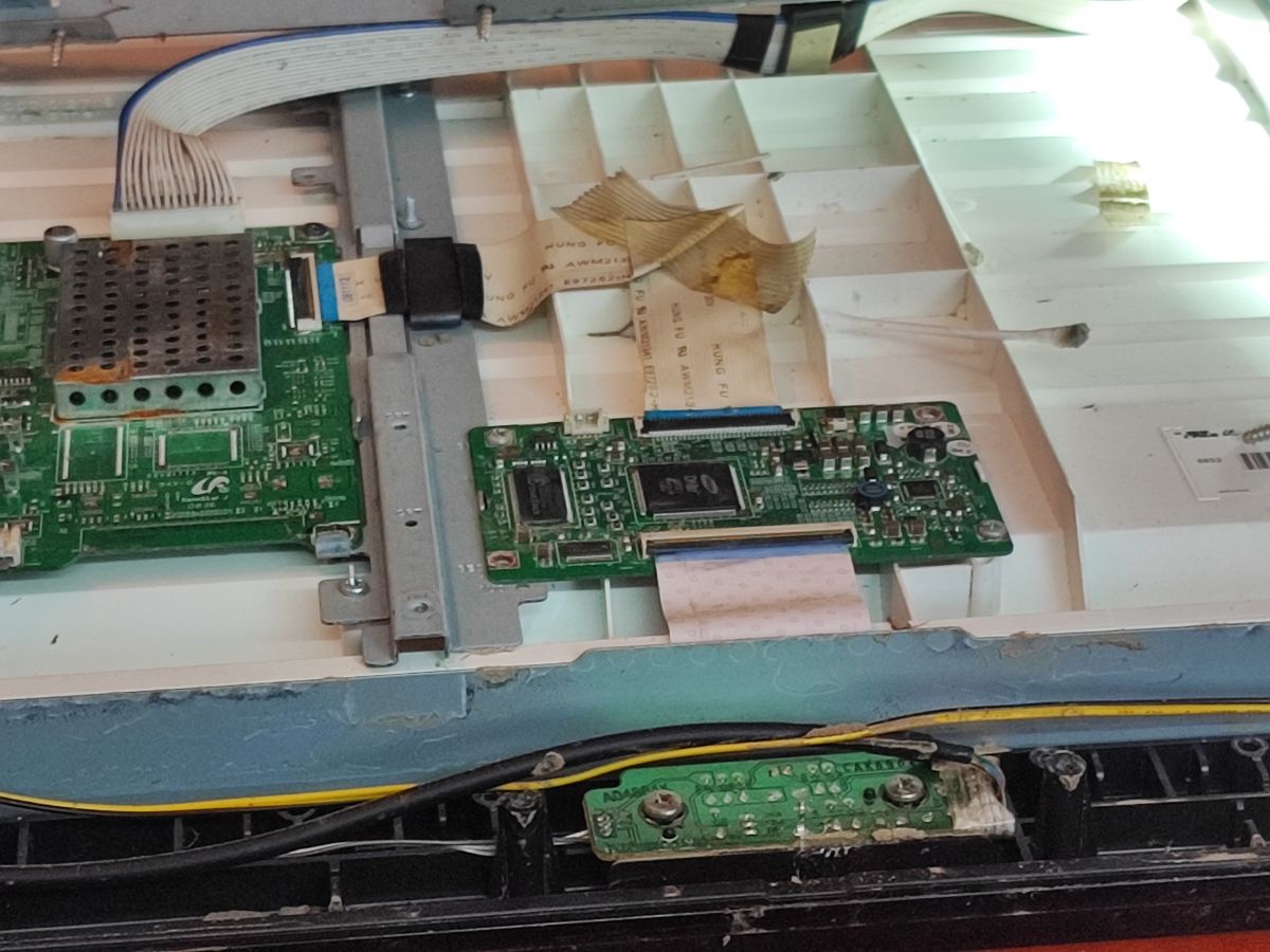

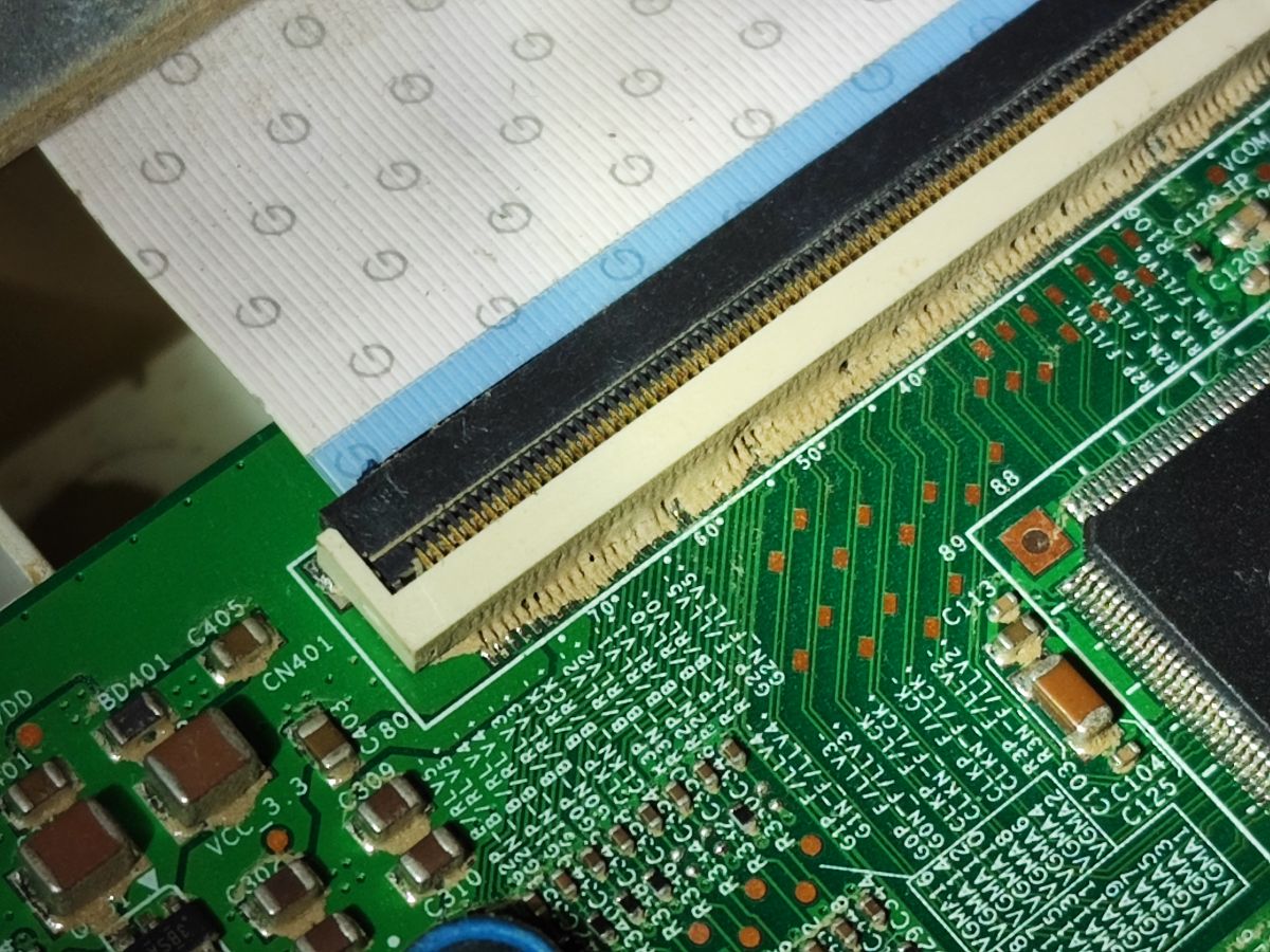

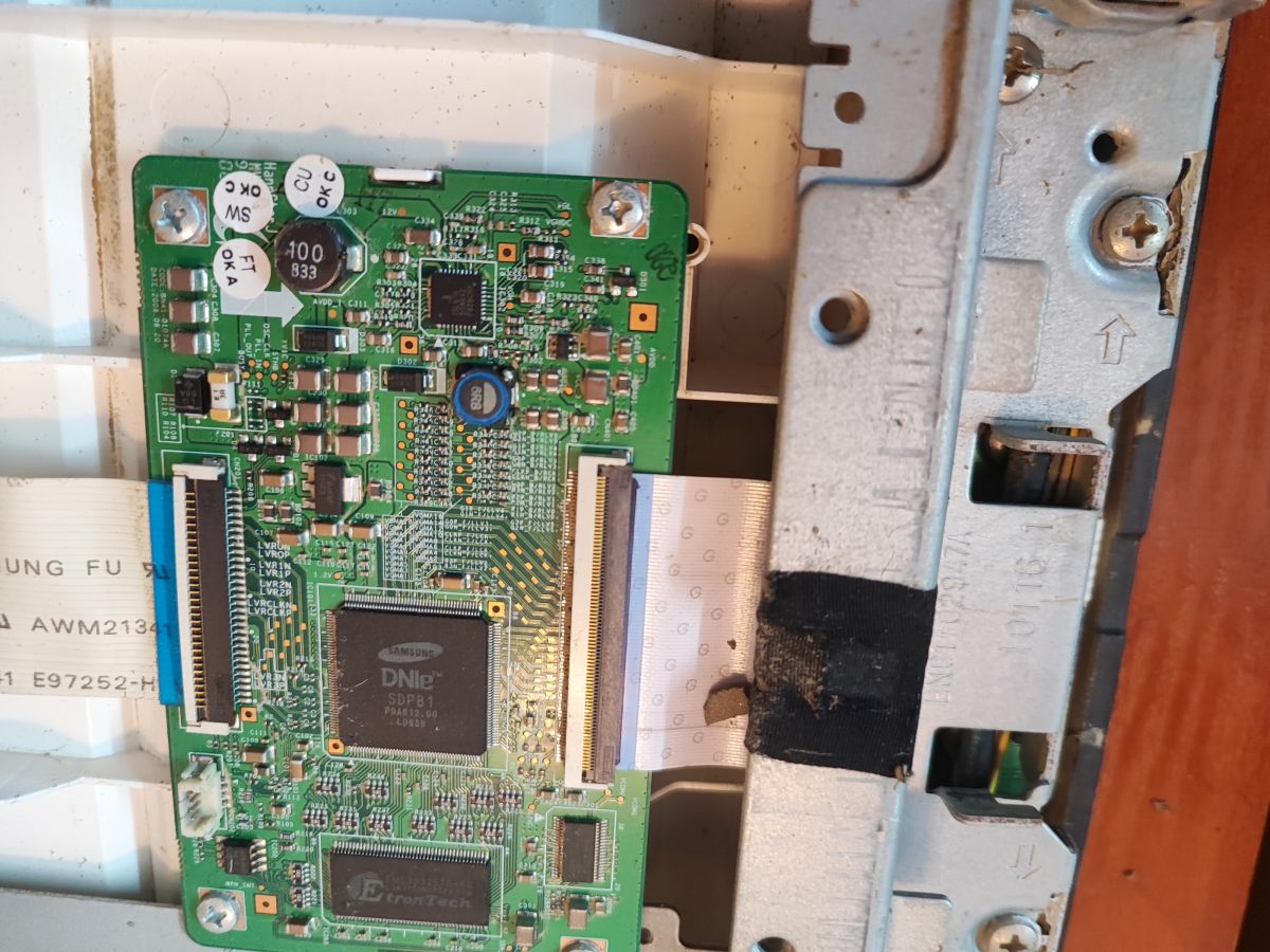

I cleaned the circuit legs with isopropanol, removed the ribbons:
Close-up of a PCB inside a Samsung LE32A330J1N TV. Close-up of a dirty integrated circuit and circuit board in a Samsung TV. Close-up of a dirty circuit board inside a television. .

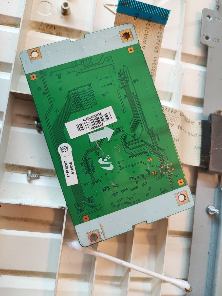

I also checked the other side of the tiles:
Printed circuit board with dirt in a flooded television. .
For the other tiles the same.

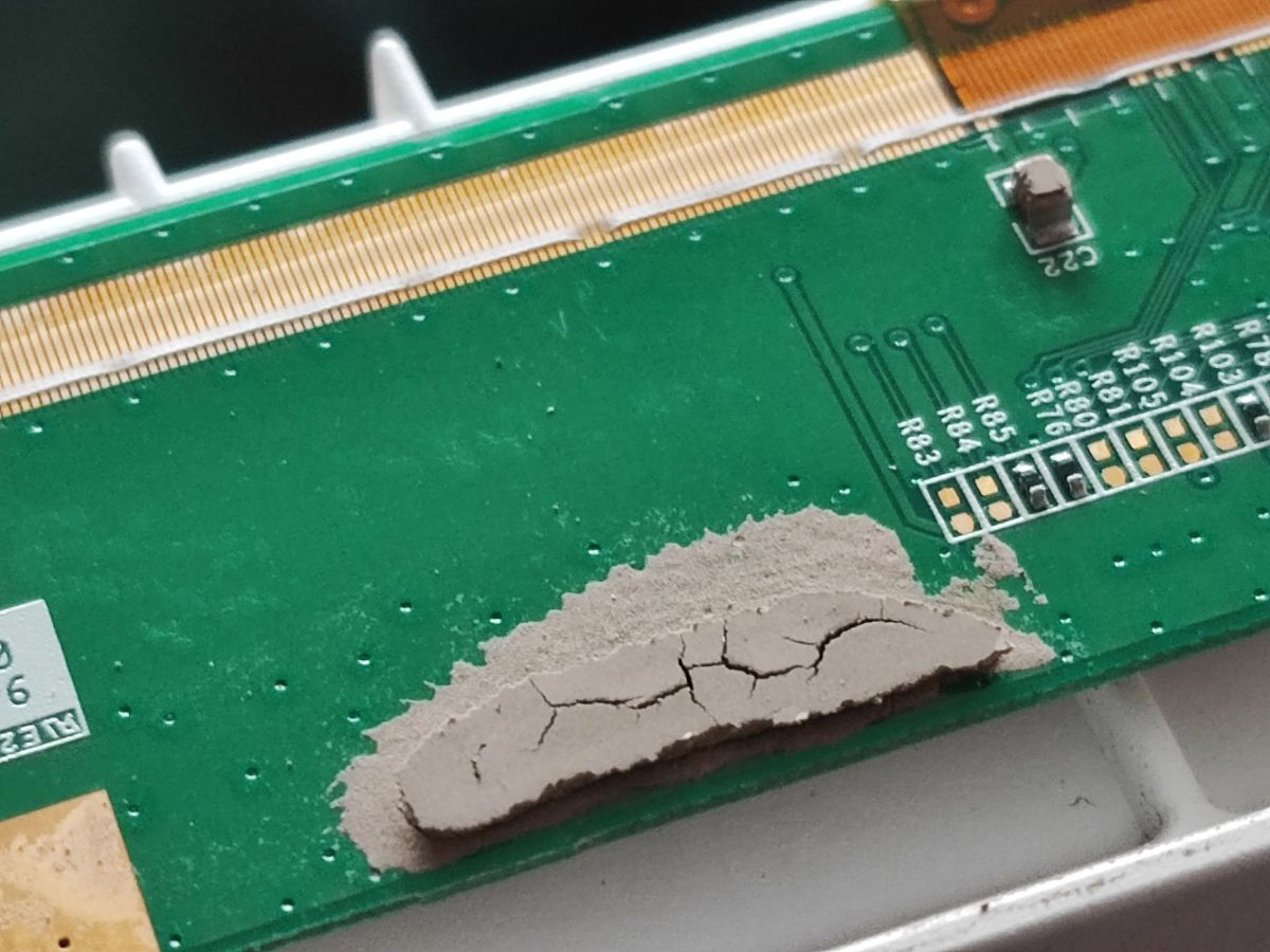

Unfortunately access was not good everywhere, but at least the electronics from the matrix can be accessed:
Interior of a flood-damaged TV showing electronic components and mud. .

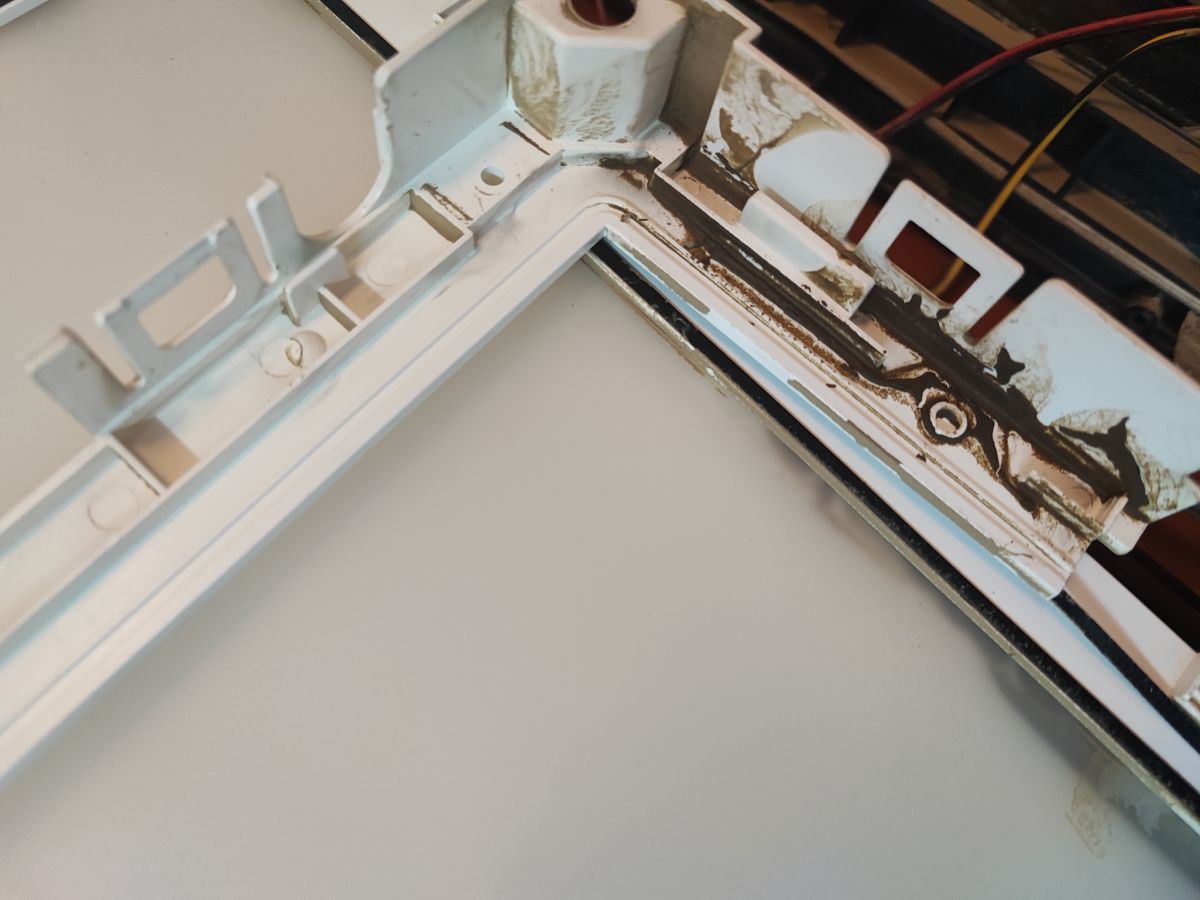

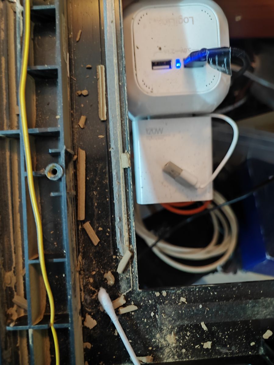

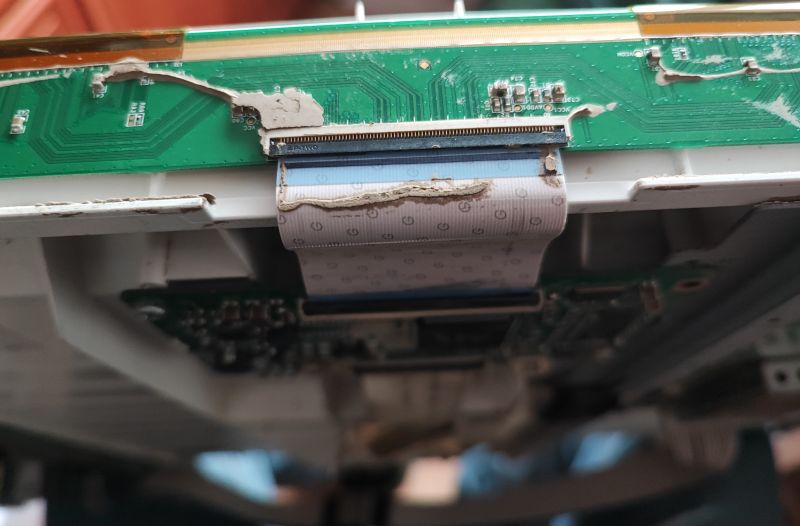

I then removed the plastic frame at the front. Inside were another supply of dried silt:
Dirty interior of a flooded TV. .

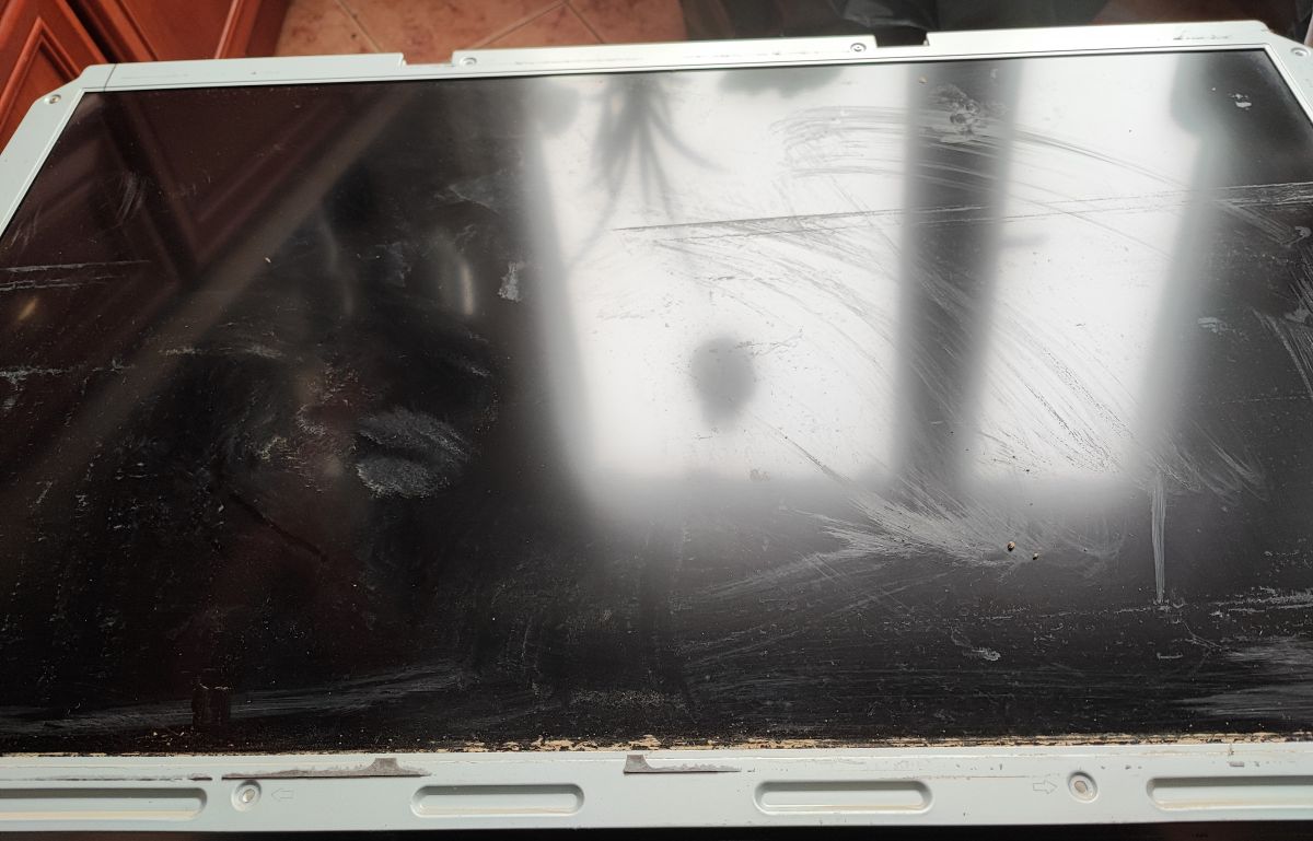

I then unscrewed the metal frame holding the matrix. Behind the matrix are still the polarising films and the backlight - here fluorescent tubes.
Dirty television screen after flooding. .

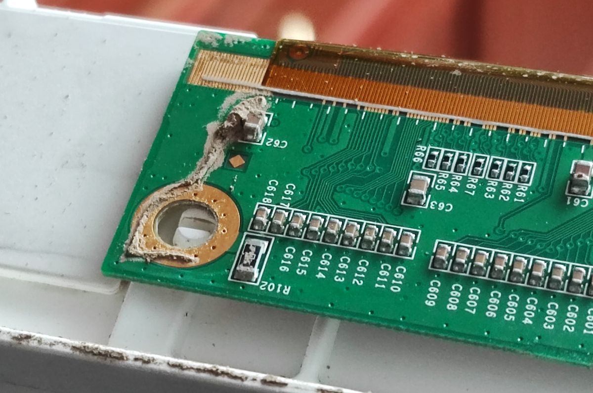

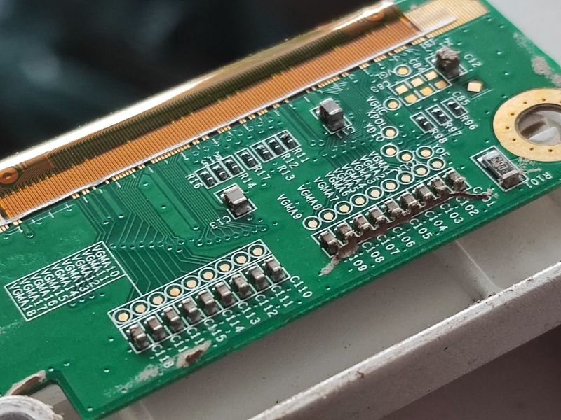

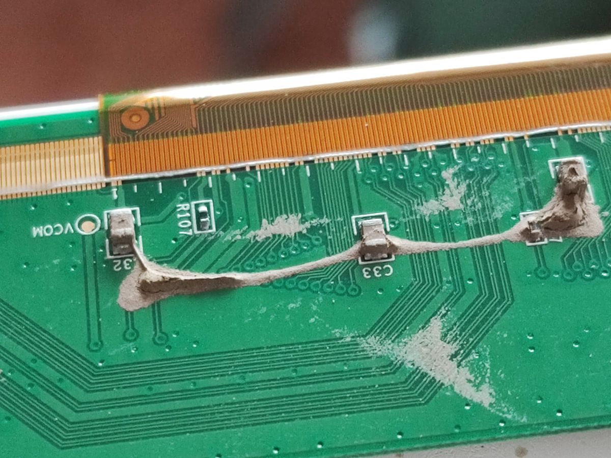

I cleaned the plates from the matrix:
Damaged circuit board inside a flooded television. Close-up of the inside of a water-damaged TV showing dirt on the PCB and ribbon cable. Dirty circuit board from a flood-damaged TV. Flood-damaged circuit board interior in a television. Flood-damaged circuit board interior in a television. Close-up of a dirty circuit board with silt deposits after flooding. Close-up of a dirtied circuit board inside a television. .

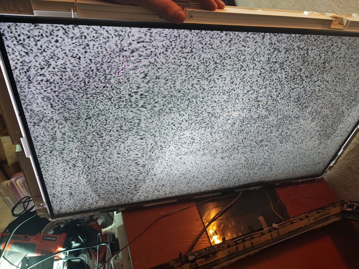

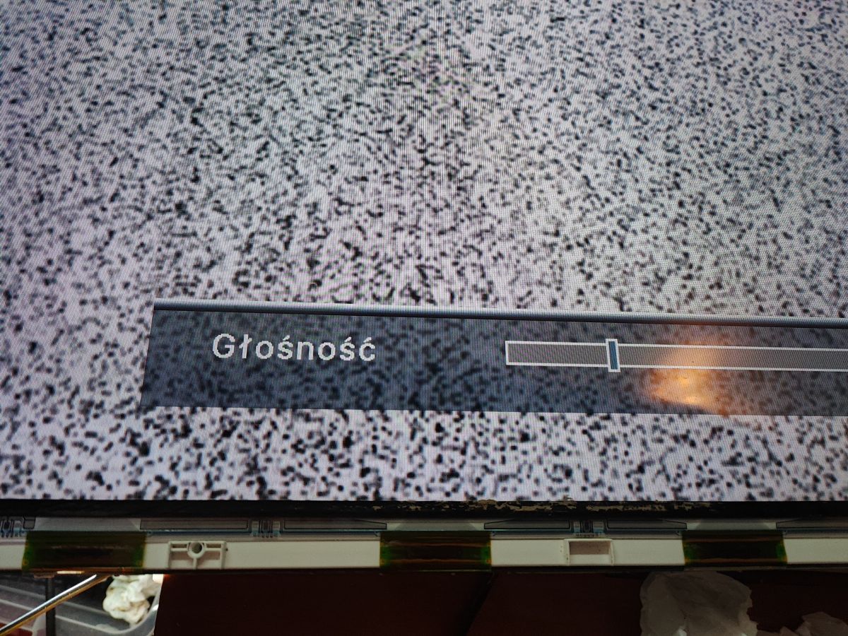

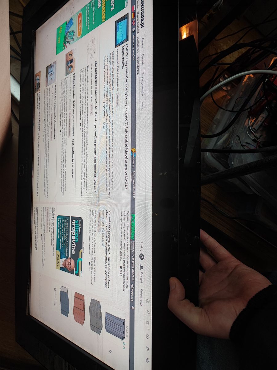

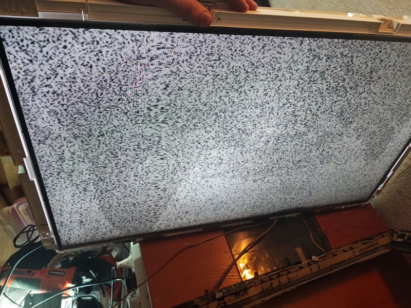

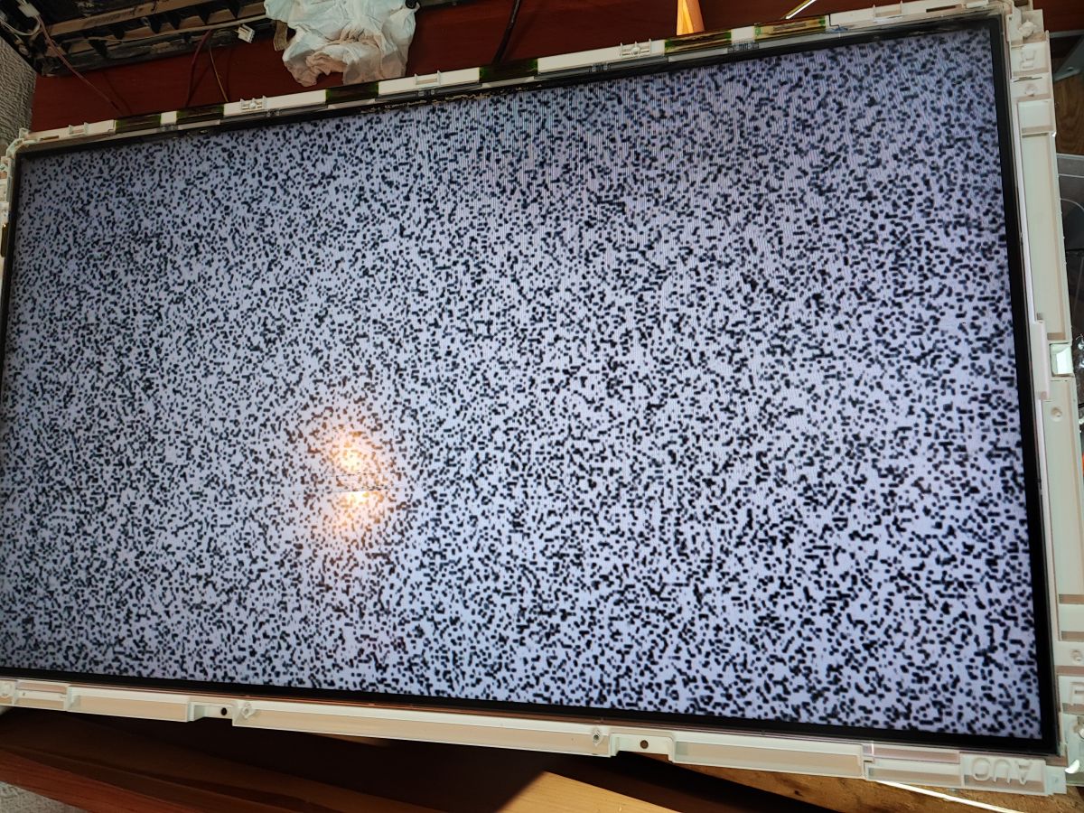

I then indulged in something slightly against the art - a premature test. I simply wanted to know if there was any point in playing at all. I just made sure that I was sure the moisture was removed from all the PCBs:
Television with an open casing displaying static noise. .

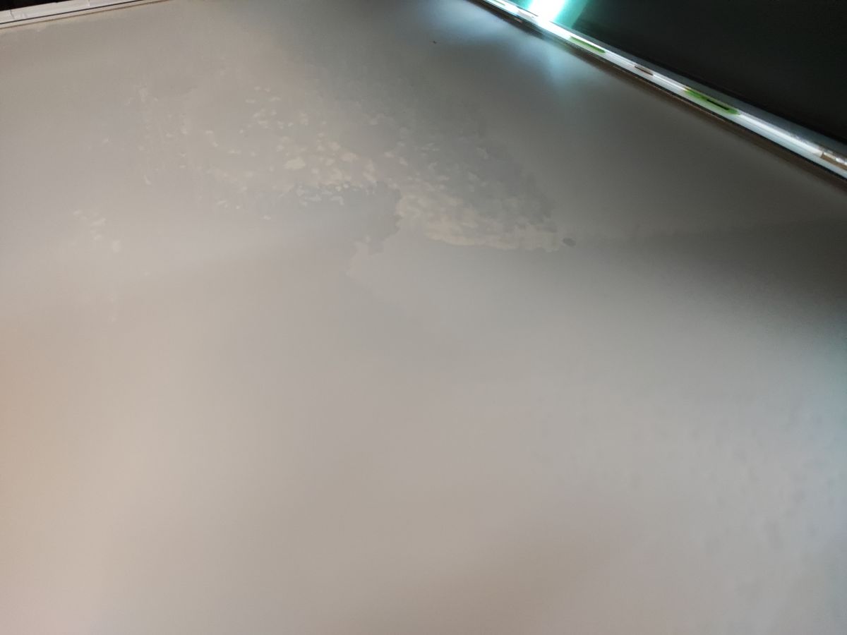

It works, but there is moisture under the die. So we remove the die:
Interior of a TV screen showing moisture marks .

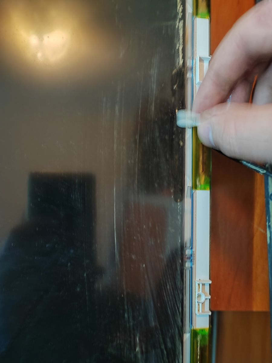

Dirt can also be removed from it:
Close-up of a hand holding a part on the side of a flooded TV. .

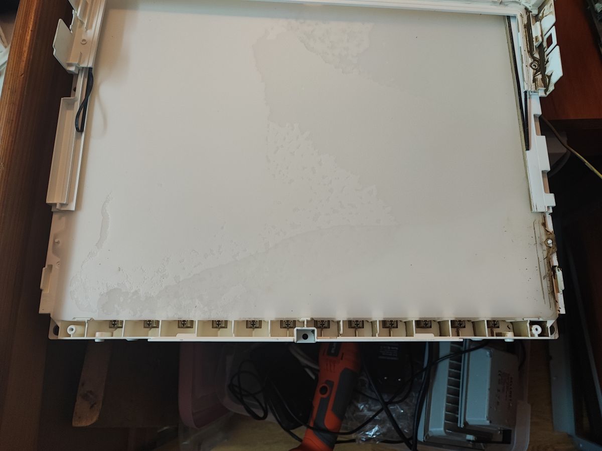

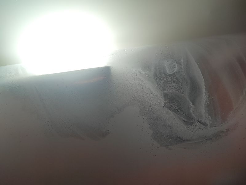

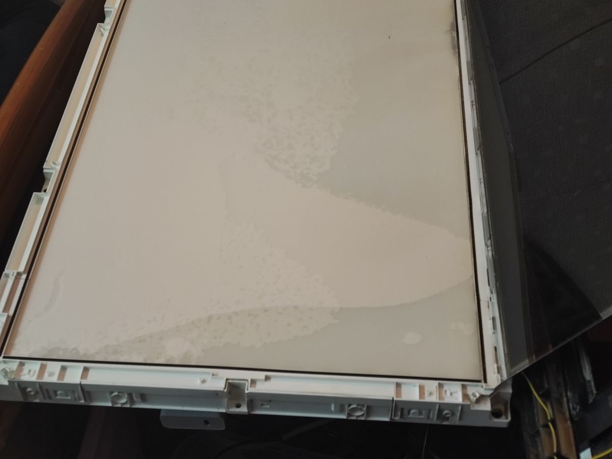

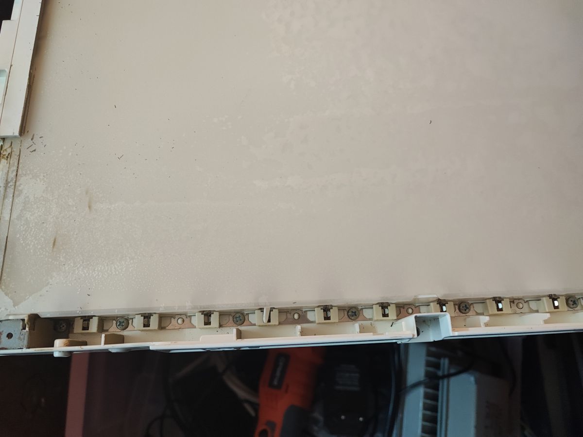

You can see the patterns from the moisture, the films hold water:
Lower part of the plastic frame of a flood-damaged TV with visible sediment and dirt. Image of a flooded TV screen with visible sediment and moisture stains. .
I took off the plastic "sides" so I could remove the foils. Even there the water arrived:
Dirt and silt deposits on the inner frame of a flooded TV. .

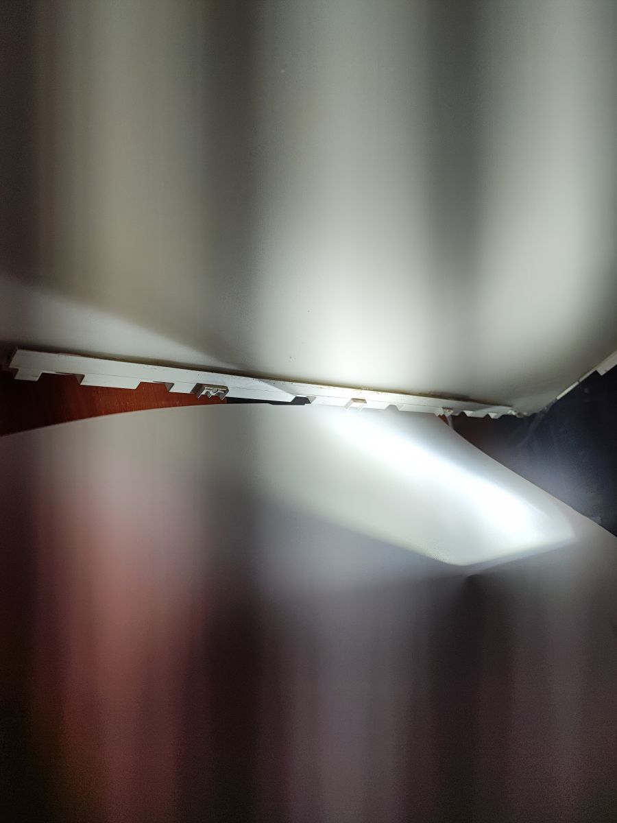

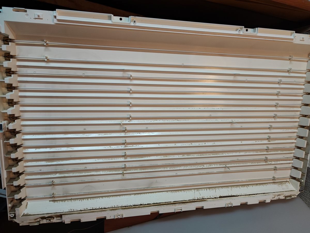

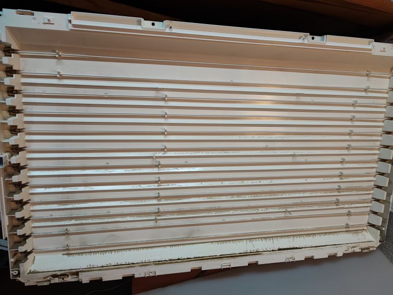

You can already see the attachment of the fluorescent tubes:
Interior of a flooded TV with visible sediment and water remnants. .

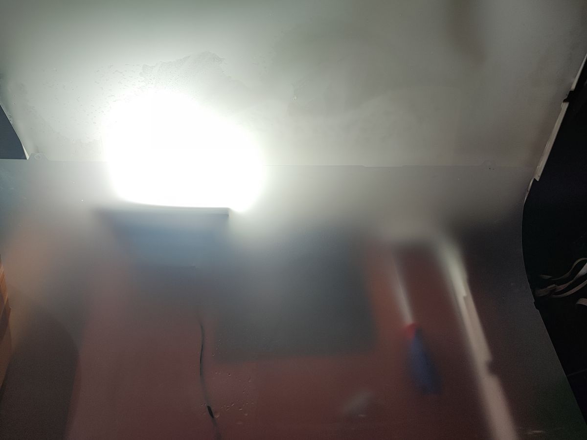

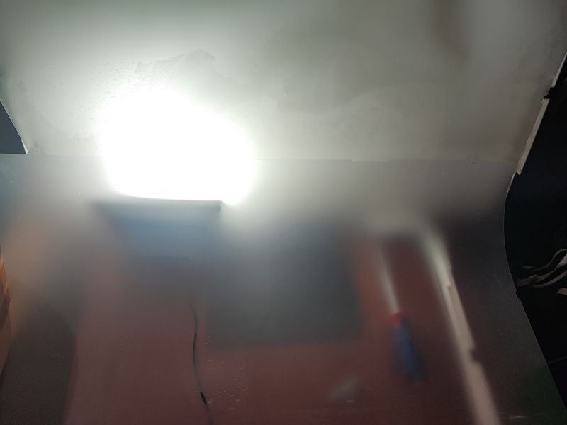

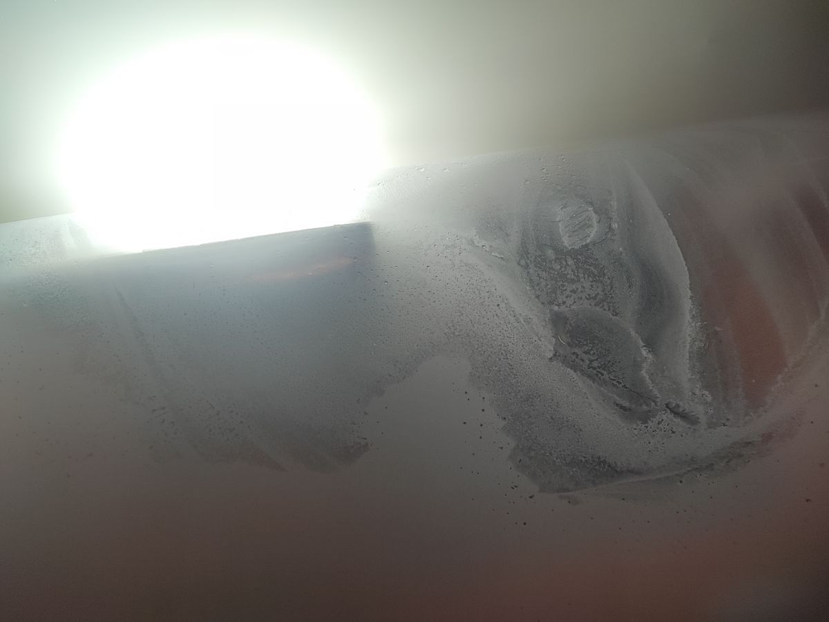

With a powerful LED lamp I dried and washed the films:
Moisture under the TV screen after flooding. Moisture patterns and dirt on the TV screen. .
Interior of a TV with visible traces of moisture and dirt, illuminated by a strong LED light. .

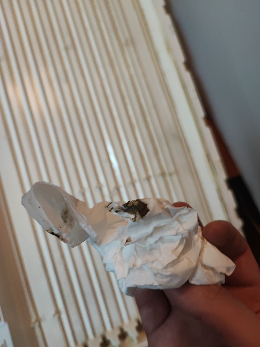

I got as far as the fluorescent tubes, where I also removed the moisture. The worst part was the grooves at the top and bottom of the screen, there was literally still water there.
Dirty tissue against the background of a damaged television. Dirtied back cover of a television after flooding .

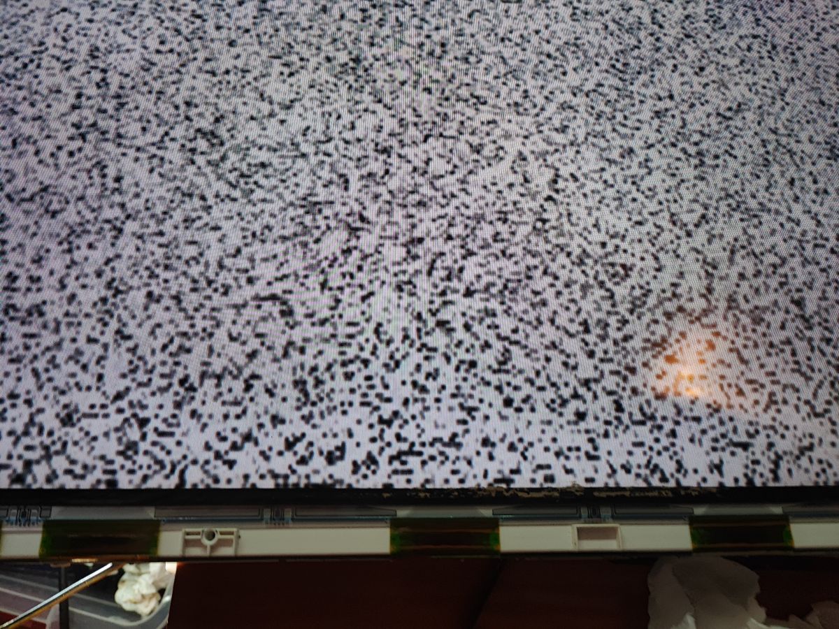

Time for another test:
TV screen displaying a volume adjustment bar against a background of static. Samsung TV with static on screen during post-flood test. Close-up of a TV screen with static and artifacts. .

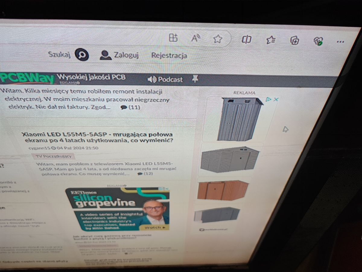

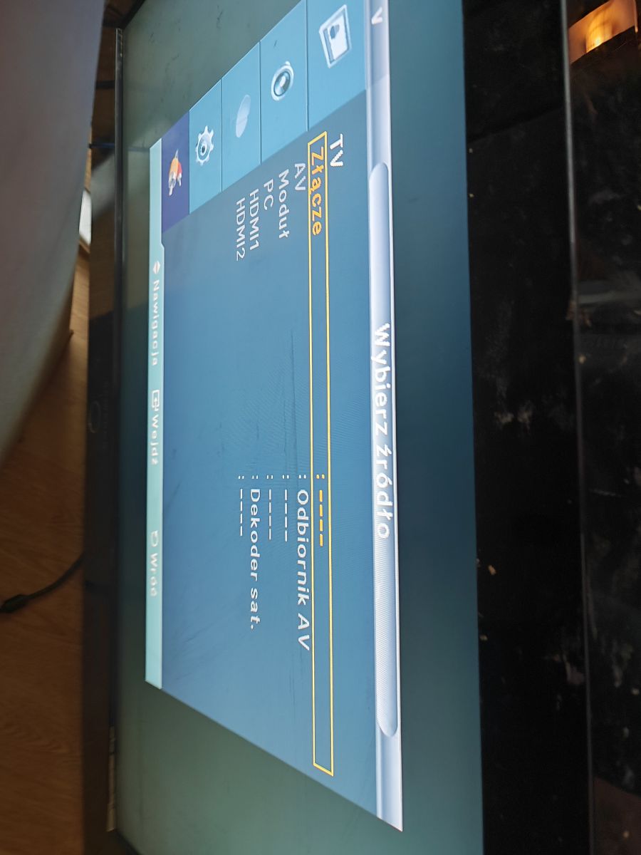

But will it pick up any signal? This is where there was a bit of a problem, because. the connectors didn't make contact and also had to be flushed with IPA in them.
TV screen displaying the source selection menu.

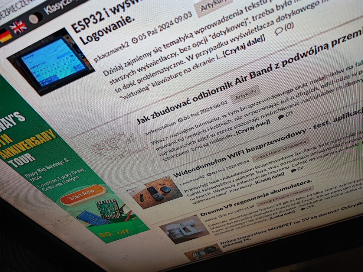

But with VGA it was possible to move:
Image of a TV screen displaying a website about electronics. Television screen displaying a webpage with technical articles. Close-up of a TV screen displaying a website with a discussion forum about televisions. .

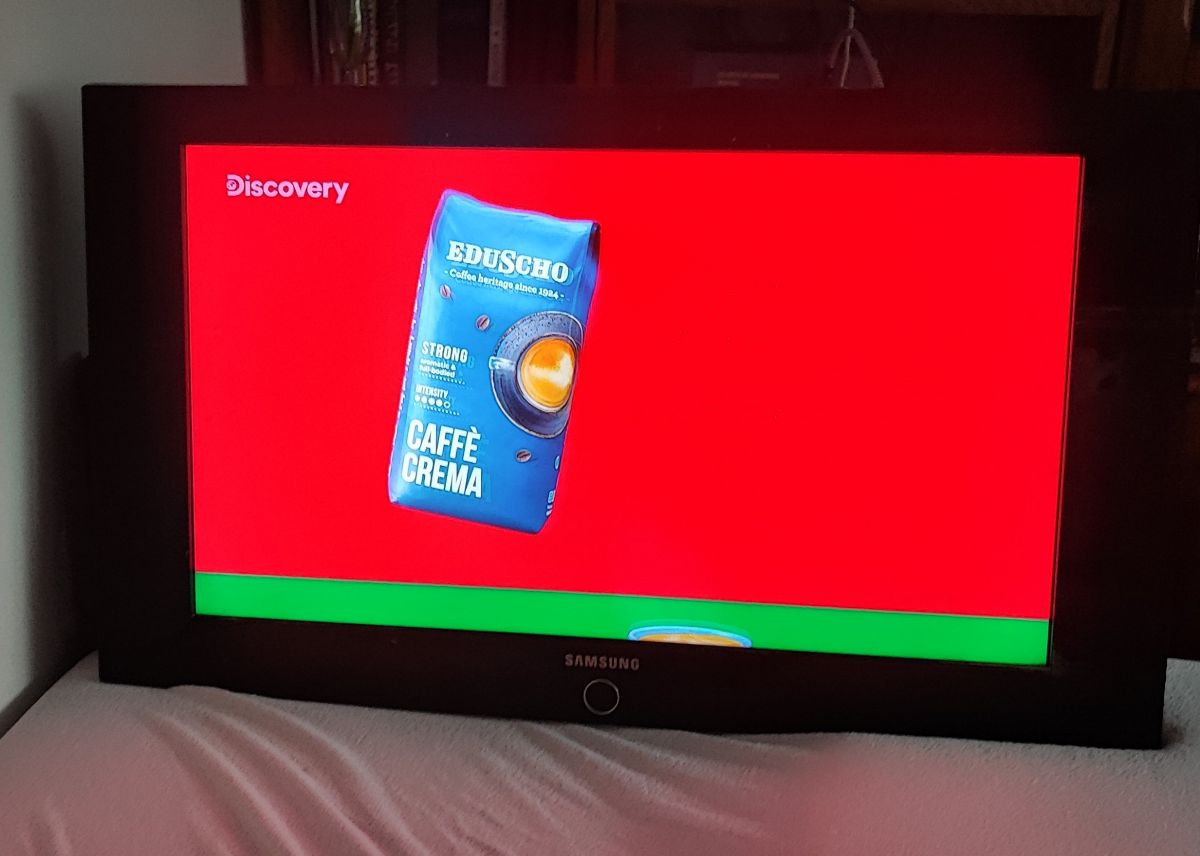

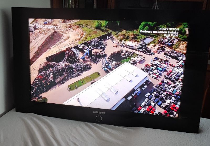

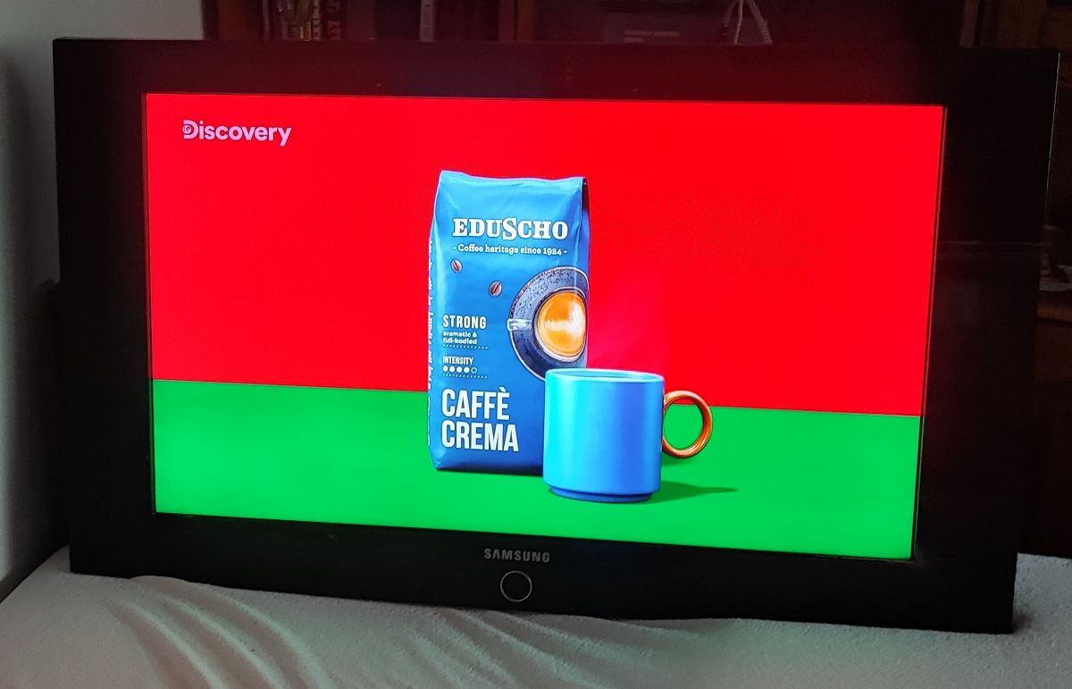

Then I also checked with the sat tuner - there is picture and there is sound, a complete success!
Image of coffee advertisement displayed on Samsung LE32A330J1N TV. Samsung TV displaying an Eduscho coffee advertisement. .

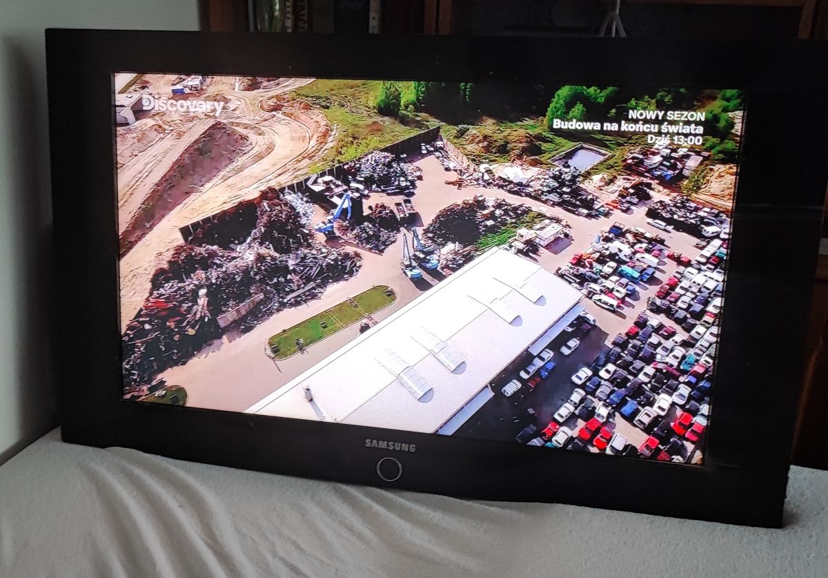

For the record, I should add that the keypad on the side of the TV also works, so I can navigate the menu, change the signal source, etc....
Samsung TV model LE32A330J1N displaying a television program.
Now all that's left to do is to summarise...
Was it worth it?
Well, for such an old model of TV, this was just an experiment rather than a major repair. Anyway, it was evident in the subject line,
that this is still a CCFL-based backlight model, not LEDs. In addition, I don't know if there won't be any further problems with this unit after a while, although it has been drying for a good three weeks. We'll see.
Apart from that, it's still worth bearing in mind the risks of flood water. I did my best to disinfect and clean the entire housing, just as I did to wash my hands after all the work, but even so, I would not urge anyone to repeat my experience.
However, in terms of cleaning the TV itself, the biggest problem was with the polarisers/diffusers behind the matrix which held moisture. You have to know how to take the whole thing apart and then put it back together again. The matrix is quite a sensitive component, one tap and all the fun is gone. I was also surprised that there was still literally water in the grooves (behind the films).
In any case - you can. Have you already made similar repairs, or do you scrap all flooded equipment straight away?
