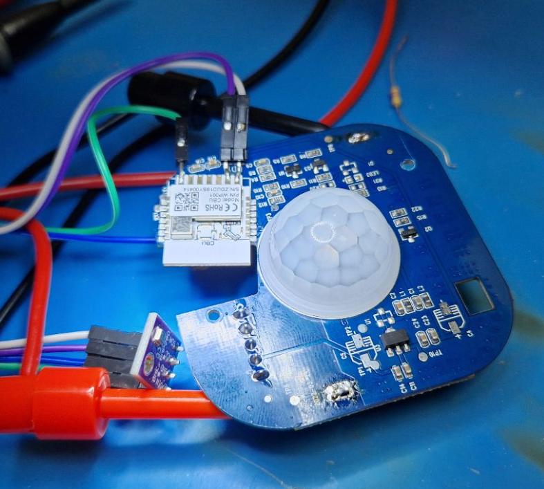

Electronic circuit board with attached PIR sensor and BME280 module. .
The BME280 is an enhanced version of the BMP280, which is capable of measuring humidity in addition to pressure and temperature. OBK allows you to easily add BME/BMP sensors to any smart device, the measurements from which can then be sent to Home Assistant or to our HTTP server via, for example, GET or POST requests. All fully scriptable. Here, I will show how to add the just-mentioned BME280 to a device with two free GPIOs, such as an LED bar controller, a PIR motion sensor, a garage door controller or just a simple "smart" relay.

Step 2: Connecting the BME280 .
The BMP280 controller also supports the BME280. We connect the sensor to the free pins, and remember the power supply. Then, in autoexec.bat:
We enter:
//startDriver BMP280 [CLK] [DATA] [ChannelForTemp] [ChannelForPressure] [ChannelForHumidity] [Adr8bit]
startDriver BMP280 7 8 3 4 5 0x76
The meaning of the arguments as in the commentary. We determine the CLK and DATA pins for the I2C bus. The number 7 in the example code snippet means P7 on the Beken platform, for other platforms it is worth looking at the Pins tab and there is a numbering spread. Then we specify the channel indexes for temperature, pressure and humidity.
The controller, named BMP280, also supports BME280 and automatically detects which type of sensor is connected.

This is what the paired device looks like in the PIR sensor + BME280 version:

Example of modification: PIR sensor + BME280 .
In the manner described here, we have modified the PIR sensor that I have previously described:
[CBU/BK7231N] Tuya PIR motion sensor Kraslaw 120°, deep sleep, battery powered .
We modified it to be USB-powered, which relieves us of the problem of power saving. The Temperature, Humidity, Pressure channels were added to the Presence - Presence channel, and we gave the corresponding pin the role of dInput, which is a digital input - 1 or 0. The result:
Home Assistant user interface displaying motion detection history from a PIR sensor. .
The device correctly performs a number of functions, and what's more, it can either be scripted additionally in OpenBeken (e.g. when a given temperature is exceeded, it switches on a relay or sends a GET packet to another device), or in Home Assistant (just like any other device in HA).
