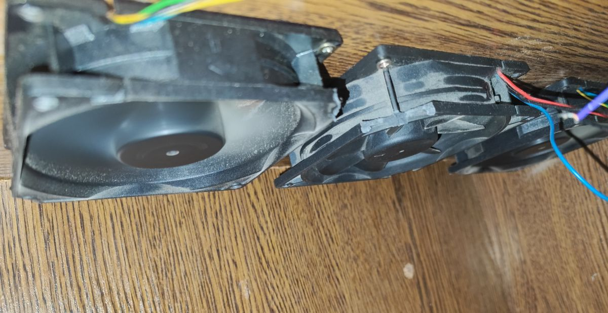

    - laptop is cooled by fans which are run at 5V currently. This is important information, because it will be used to simplify circuit later
    12V fans mounted on a wooden surface in a DIY setup.

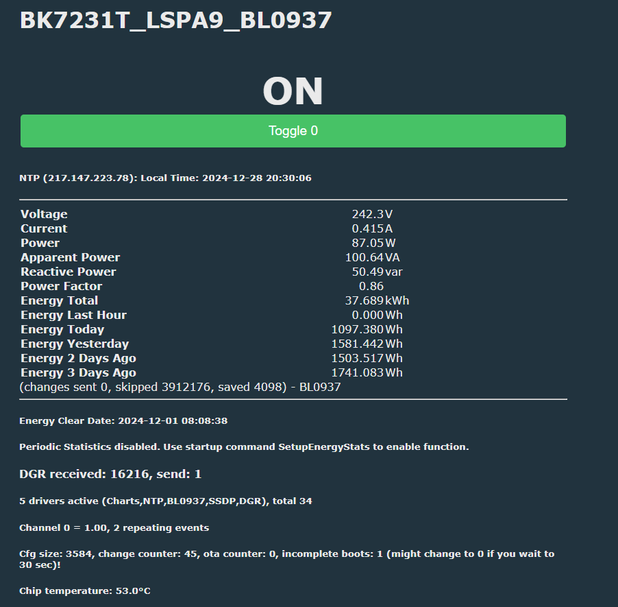

    - LSPA9 plug measures power usage:
    Energy measurement screen of the BK7231T_LSPA9_BL0937 device.

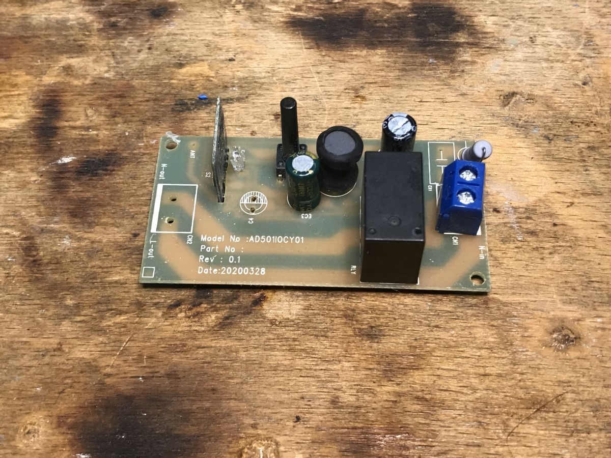

    DIY device for fans control
    My current fans don't work well with PWM, so I decided to go for relay instead. In the future, I may introduce PWM control as well, but now I just needed a basic ability to toggle them on and off. That's why I decided to convert broken 230V relay control to 5V:
    Printed circuit board with various electronic components on a wooden background.

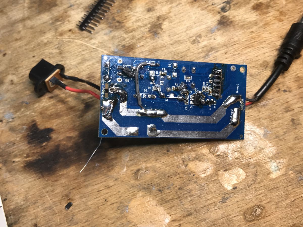

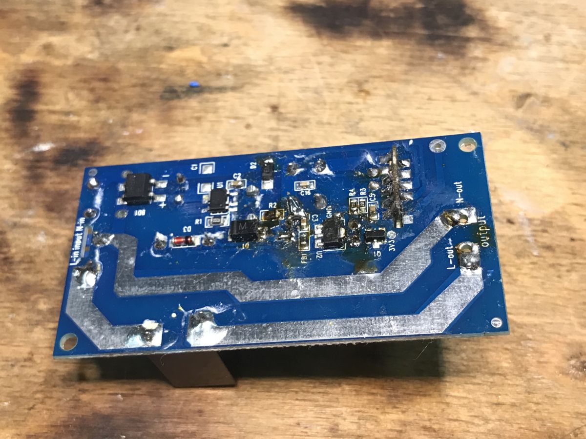

    Following switch module has a simple, mains-powered step down converter that provides 5V for the relay, which is later fed to 3.3V LDO that powers WiFi module.
    Close-up view of a printed circuit board with traces and electronic components.

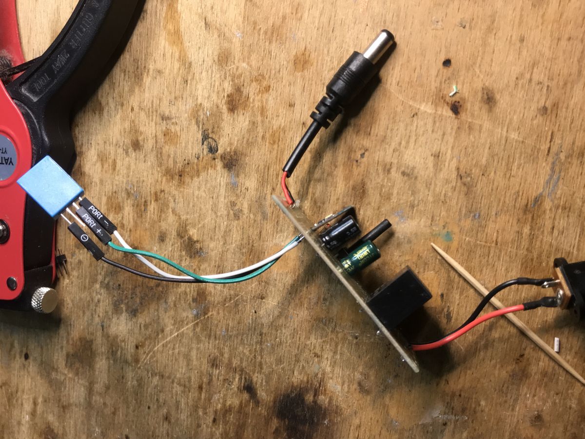

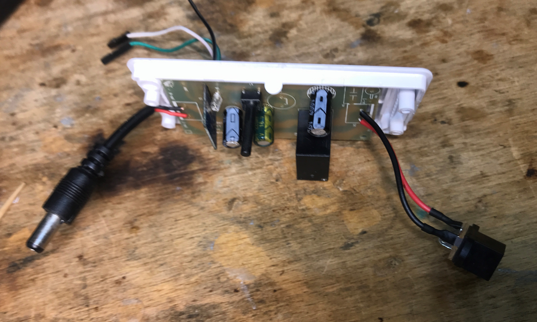

    In case of powering whole circuit from 5V, the first 230V to 5V step down converter is not needed, but remember that voltage higher than 5V may just burn the 3.3V LDO and the WiFi module. If you want to use 12V, a 12V to 3.3V step down converter is required.
    Final circuit:
    Image of a circuit board on a wooden surface with connected cables.
    I have also replaced full bridge rectifier with a simple diode, as the DC is here already at the input, and the extra diode is only used for reverse-polarity protection.

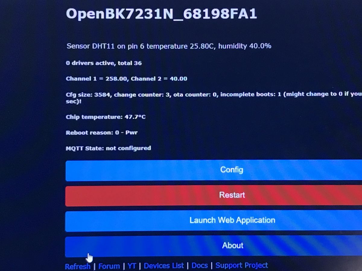

    DHT11 routed out for later experiments:
    DIY electronic circuit with wires and components on a wooden surface OpenBeken user interface displaying DHT11 sensor data

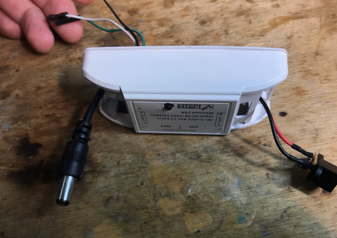

    Case:
    Modified switch module on a wooden surface. Modified smart switch with wires on a wooden table
    Setup for power measurement
    LSPA9 was already flashed, it only needed a script to report power usage to target device.
    I've decided to do it via HTTP GET command with Tasmota-style syntax:
    again:
    SendGET http://192.168.0.111/cm?cmnd=setChannel%202%20$power
    delay_s 0.5
    goto again
    Make sure that IP of the target device is correctly entered in the script, also make sure that it won't change (do MAC reservation on router).
    This basically sends the channel setting command:
    setChannel 2 $power
    and the $power is expanded to current power value from BL0937.

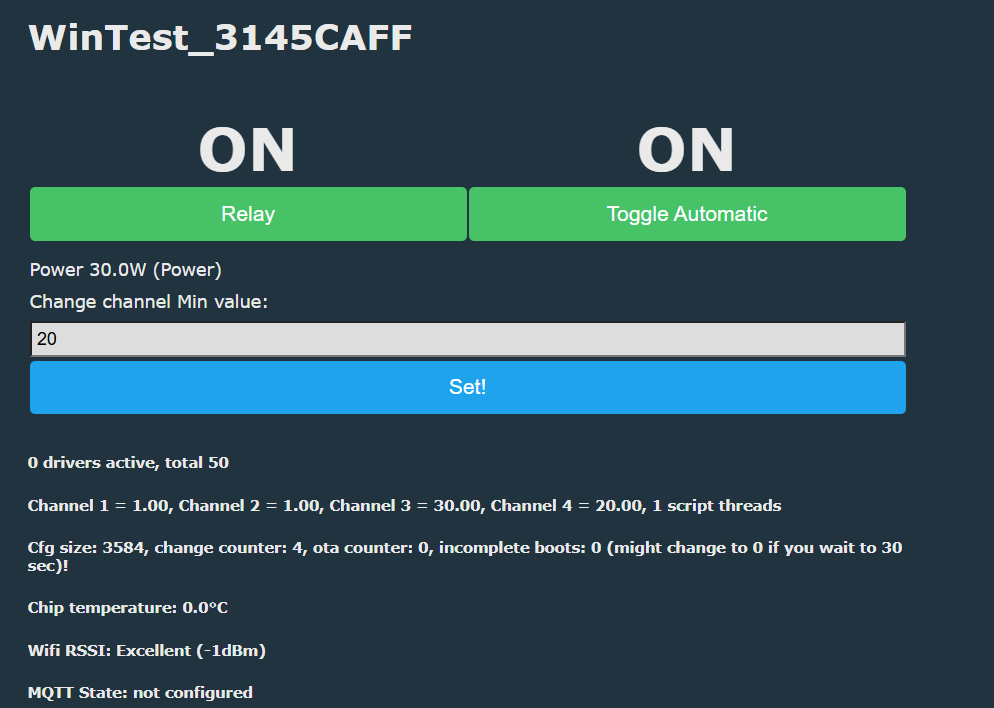

    Setup for relay device
    Relay device will have a bit more advanced script.
    I would like script to offer two modes:
    - automatic mode, where relay is set automatically to open or closed, depending on current reading and given margin
    - manual mode, where user can control relay freely.
    Futhermore, I would like the margin to be configurable on device GUI.
    Luckily all that is possible with OBK channel types:
    https://github.com/openshwprojects/OpenBK7231T_App/blob/main/docs/channelTypes.md
    Let's start writing script by deciding the channels we need:
    // main relay
    setChannelType 1 Toggle
    setChannelLabel 1 Relay
    // working mode
    setChannelType 2 Toggle
    setChannelLabel 2 Automatic Mode
    // received power [W]
    setChannelLabel 3 Power
    setChannelType 3 Power
    // min power to enable cooling
    setChannelType 4 TextField
    setChannelLabel 4 Min Power To Cool
    It might be also worth to save those channels in flashvars, so they are kept between reboots:
    // remember channels
    setStartValue 1 -1
    setStartValue 2 -1
    setStartValue 3 -1
    setStartValue 4 -1
    Now, we need to implement the main logic... the relay must be set to the value determined by the relation of given threshold and current reading. This must be done often, like every second or so, maybe 10 seconds... luckily it turns out it can be done with few lines:
    again:
    if $CH2==1 then setChannel 1 $CH3>$CH4
    delay_s 1
    If channel 2 is 1 (if mode is automatic), then set relay channel to the result of margin and value comparison. If channel 3 is larger than 4, it will yield 1, thus turning relay on.
    And here is the OBK panel for this script:
    User interface for cooling automation using OpenBeken.
    Using temperature sensor instead of the Power
