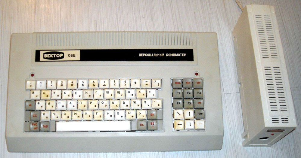

Soviet Vektor-06C computer with a numeric keypad and an external unit.

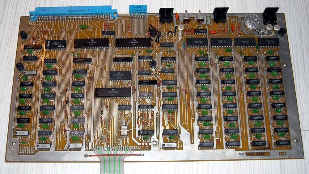

Like most other Soviet computers of the period, the Wektor-06C was equipped with the KR580VM80A processor, the equivalent of the Intel 8080, but it ran at a slightly increased clock frequency of 3 MHz (instead of 2.5 MHz). As standard, the Vector-06C had 64 KB of RAM, of which 8 to 32 KB could be used for video memory (respectively, user memory is 32 to 56 KB). In contrast, the size of the fixed memory was 512 bytes or 2 KB and contained only the program loading from the tape recorder, disk ignition or external ROM. Any other program, including BASIC, was loaded from a cassette or other external source.
The three-channel sound synthesiser was made on the KR580VI53 chip (a programmable timer chip, a Soviet copy of the Intel 8253). The processor and verb in this computer were the more complex components. The rest was realised on simpler chips with small-scale integration. Therefore, the Vector-06C contained almost 100 ICs (from 83 to 97 depending on the keyboard type). For comparison: Commodore 64C - 16 pcs, ZX Spectrum 128К - 29, MSX2 - 37. Admittedly, the Soviet copy of ZX Spectrum included a bit more, because this country lacked ULA (Uncommitted Logic Array) type circuits. Now, it can be said that this solution had some advantages - ease of repair and availability of components, and Soviet quality was not exemplary, hence fault elimination was not uncommon. As a result, Vectors are still used by enthusiasts today and they have no problems with repairs, which cannot be said of owners of the original ZX Spectrum or Amiga, even though the quality of their workmanship and the parts used was much higher.
Motherboard of the Wektor-06C computer with multiple integrated circuits.
Wektor-06C motherboard. Retrieved from https://www.computer-museum.ru/articles/personalnye-evm/971/

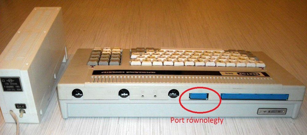

Soviet Wektor-06C computer with a visible parallel port.
The problem with connecting this peripheral was that the Wektor had a non-standard connector for Centronics interface printers, for this reason I had to make the cables myself. The Vector had some kind of software for text editing and printing, but I can't even remember the name. Another challenge was preserving the results of the work and then reusing them, as this was done via a tape recorder. After a couple of years I managed to buy a disk station driver and a station. Work became more comfortable. Especially since the manufacturer of this driver also developed (or adapted) the CP/M operating system for Vector.
