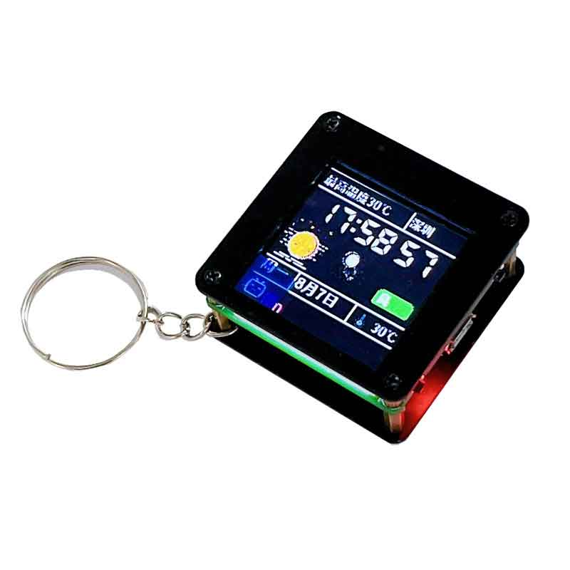

ESP32 C3 module with a colorful LCD display in a keychain format. .
This inconspicuous module is based on the ESP32 C3 and offers a 1.44" colour display with 128x128 resolution, controlled via SPI protocol. Here I will show how easy it is to get started with it, how it can be batch uploaded remotely (via WiFi), how to display a simple animation and compare the display speed between software and hardware SPI. In addition, I will check if an older esptool can handle the ESP32-C3....
The product often appears under the heading 'ESP32 C3 Desktop Trinket Mini TV Portable Pendant LVGL 1.44inch LCD ST7735' and can be purchased for around PLN40. I received the whole thing after purchase in such a box, properly protected:
