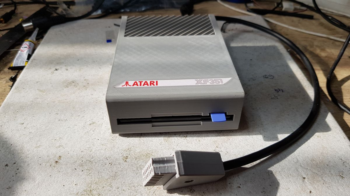

  • Built an Atari XF 351-style 3.5-inch floppy station for the 8-bit Atari series, based on the XF551.
  • Designed a new SMD electronics board in DipTrace from an online schematic and paired it with an IBM laptop drive.
  • Printed the enclosure in Hyper PLA on a Creality K1 MAX; the case took over 220 minutes, and the SIO plug used an internet model.
  • Added an FT232 module for SIO2PC and Aspeqt, installed a VL1772 controller with Hyper XF ROM, but the drive-number switch no longer fit.
Prototype Atari XF351 floppy disk drive with SIO cable on a white surface. .
Ot, Atari never made a 3.5" station for the 8-bit series. The XF 351 never got beyond the prototype stage. I thought I would change that ;) The choice fell on the XF551.

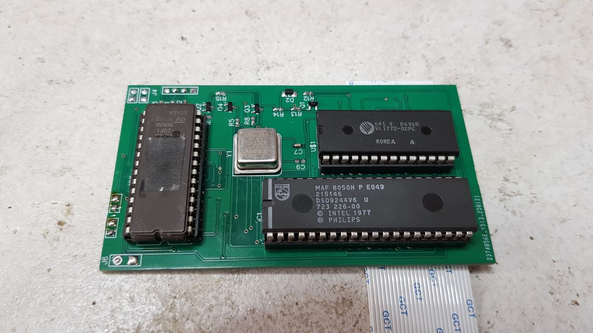

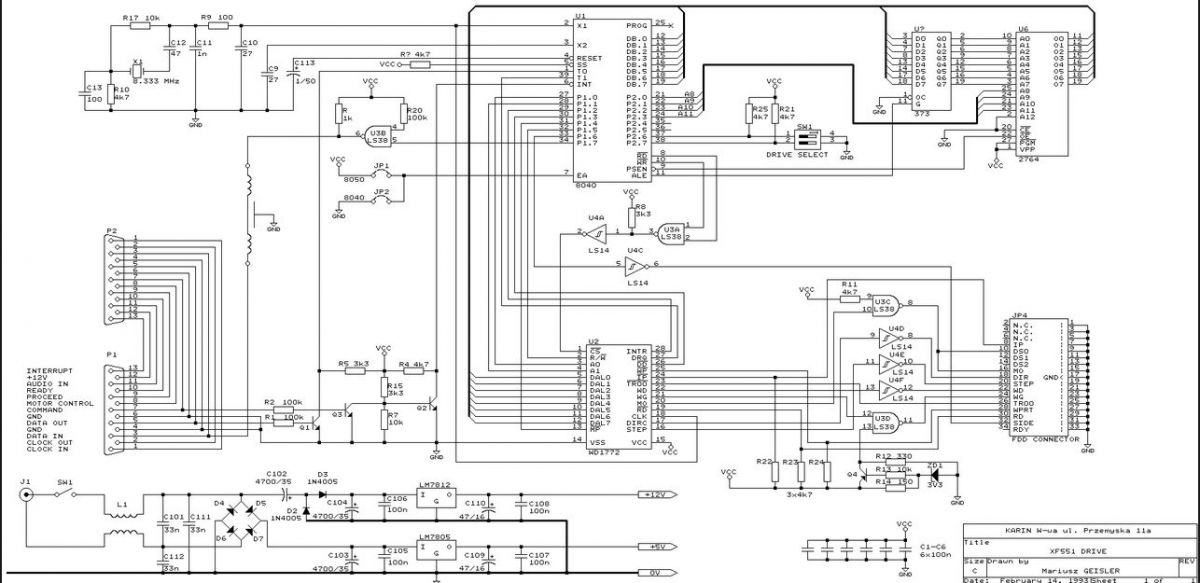

I built the electronics based on a schematic from the net. New board in SMD drawn in DipTrace, ordered from JLCPCB.
XF 551 schematic.
Electrical schematic of Atari XF551 floppy disk drive .
Plate.
Close-up of a prototype electronic board with integrated circuits .

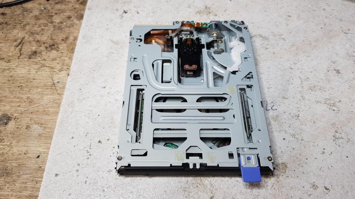

The choice of drive from a laptop was dictated by dimensions and availability. You can still buy new stock loungers. Here I have used the drive from an IBM laptop.
Close-up of the interior of an IBM laptop floppy disk drive. .

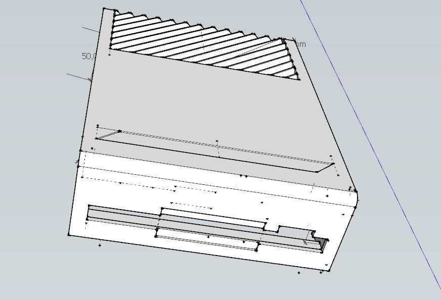

I drew the housing in SketchUP.
Design of an Atari XF551 disk drive case in SketchUp. .

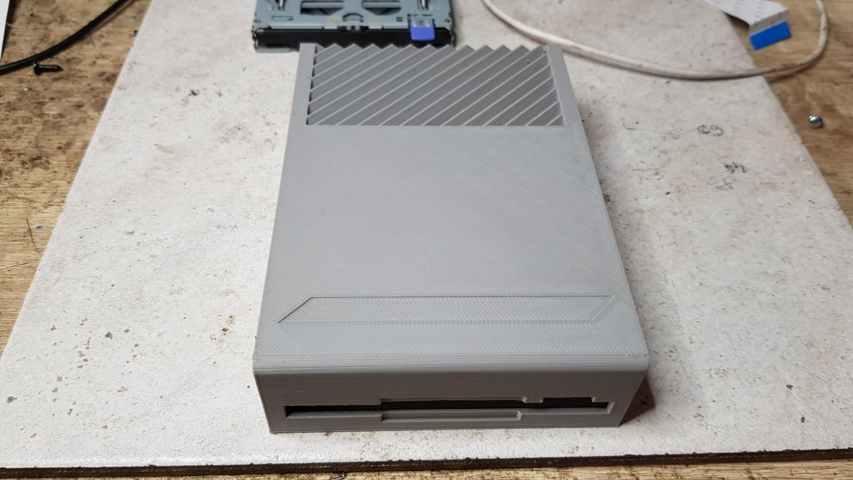

Printed from Hyper PLA on Creality K1 MAX. It could have come out better, but here I made a compromise between quality and speed. It takes over 220 minutes to print anyway.
Prototype 3'5 inch floppy drive case for Atari with gray diagonal striped pattern. .

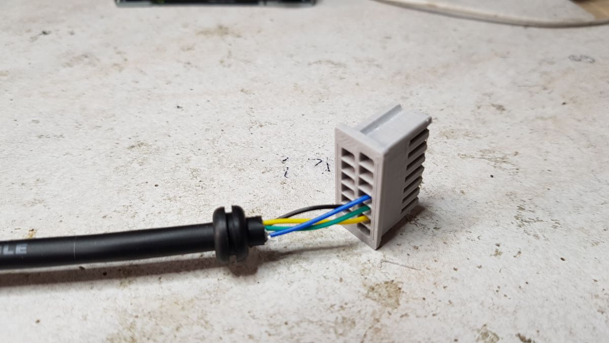

SIO plug to connect the station to the Atari printed from a model from the internet.
3D-printed SIO connector with wires. .

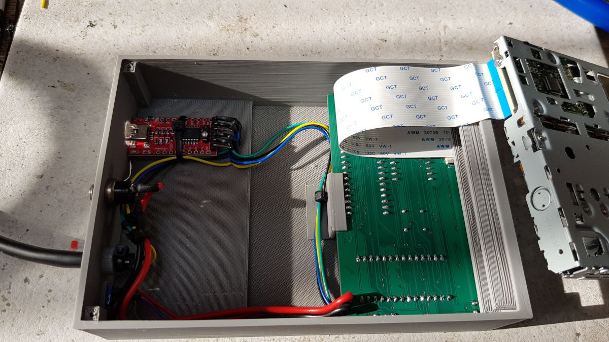

I also added a module on FT232 to communicate the station with the PC and the Aspeqt program to load disk images.
Inside view of the Atari XF 551 disk drive casing with visible cables and electronics. .

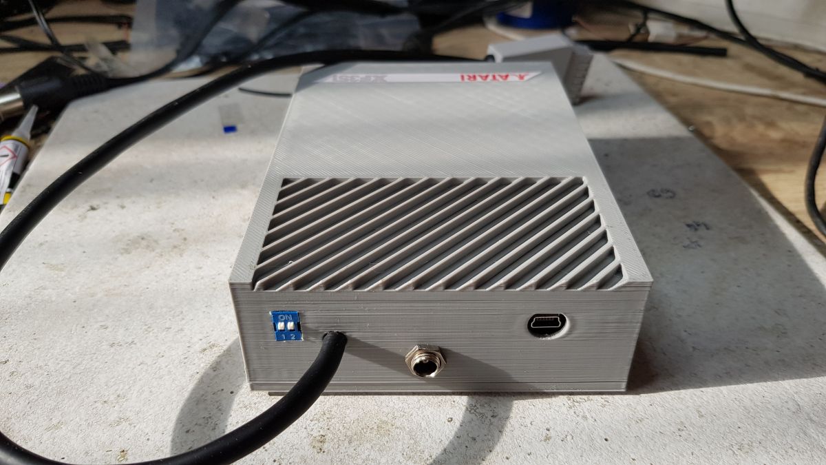

On the back of the drive is a switch to select the station number. D1 to D4. There is a power socket and a SIO2PC USB output. The switch didn't quite fit anymore, so I dispensed with it.
Prototype Atari XF 551 disk drive with custom-designed electronics and 3D-printed casing. .
I also managed to get hold of a WD1772 controller, a VL1772 to be precise (unfortunately these are hard to find and quite expensive), so I installed Hyper XF, an alternative ROM to speed up the station.

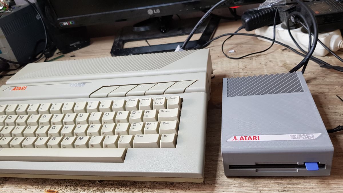

So there you have it ;) .
View of a prototype Atari XF351 disk drive with SIO cable on a white surface. .
Atari XE computer and prototype disk drive XF 351 lying next to each other on a desk. .

LA72 16 Feb 2025 16:35
And here it would be useful to provide a link to the author of the original. [Read more]
lombard1 17 Feb 2025 09:46
After all, there is the author's name on the schematic, and anyone who knows how to search will find the link. This is a very well-known interface for the eight-bit Atari. [Read more]

gregor124 23 Feb 2025 11:54
Link to diagram of the original: https://atariwiki.org/wiki/attach/Atari%20XF551/XF551_schematic.pdf The XF551 is a 5 1/4" station and here it is 3.5". Then I have a question, is it possible to write/read... [Read more]
