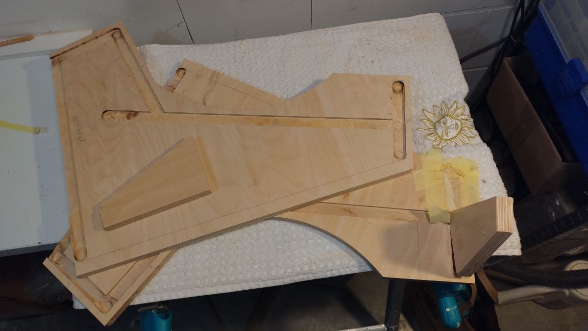

    With this year's lovely winter underway, I decided to create a Bartop slot machine. My main goal was the enclosure itself. It was intended to be as aesthetically pleasing on the inside as it was on the outside. Ultimately, the whole thing is supposed to be fun and evoke the nostalgia of my teenage years, when I was faced with the difficult choice of going for an Italian ice cream on a hot day or squeezing out the seventh sweat in an arcade. I'm sure the atmosphere of the 90s arcade skirmishes won't be 100% evoked, but a substitute and a momentary return to the past is enough for me, where the only duty was to take out the rubbish and do homework. The rest of the time was up to me to manage.
    Retro gaming arcade cabinet with colorful joysticks and buttons, placed in a bright room, with visible stickers on the cabinet. .

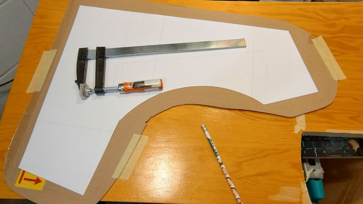

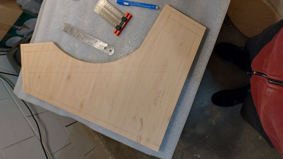

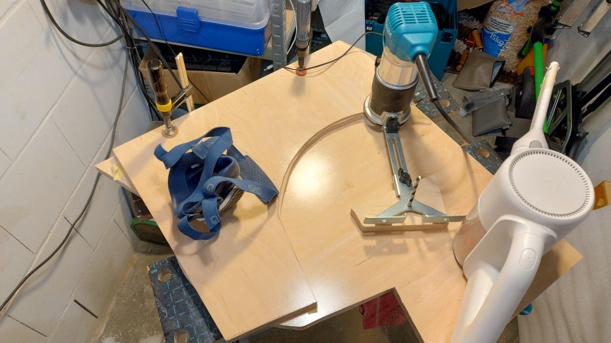

    Before I started, I looked around at other people's work. After making an initial selection, I set about building a template for the sides and then a cardboard model to test the ergonomics of the finished case.
    Side template for a Bartop arcade machine on a workshop table. .
    Cardboard model of a bartop arcade machine in a workshop. .

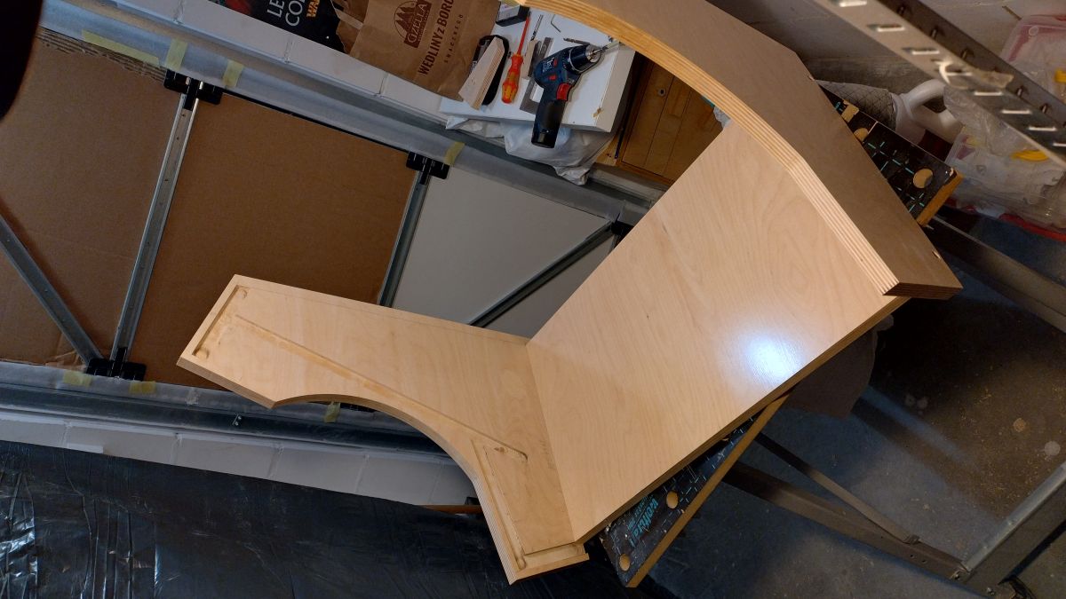

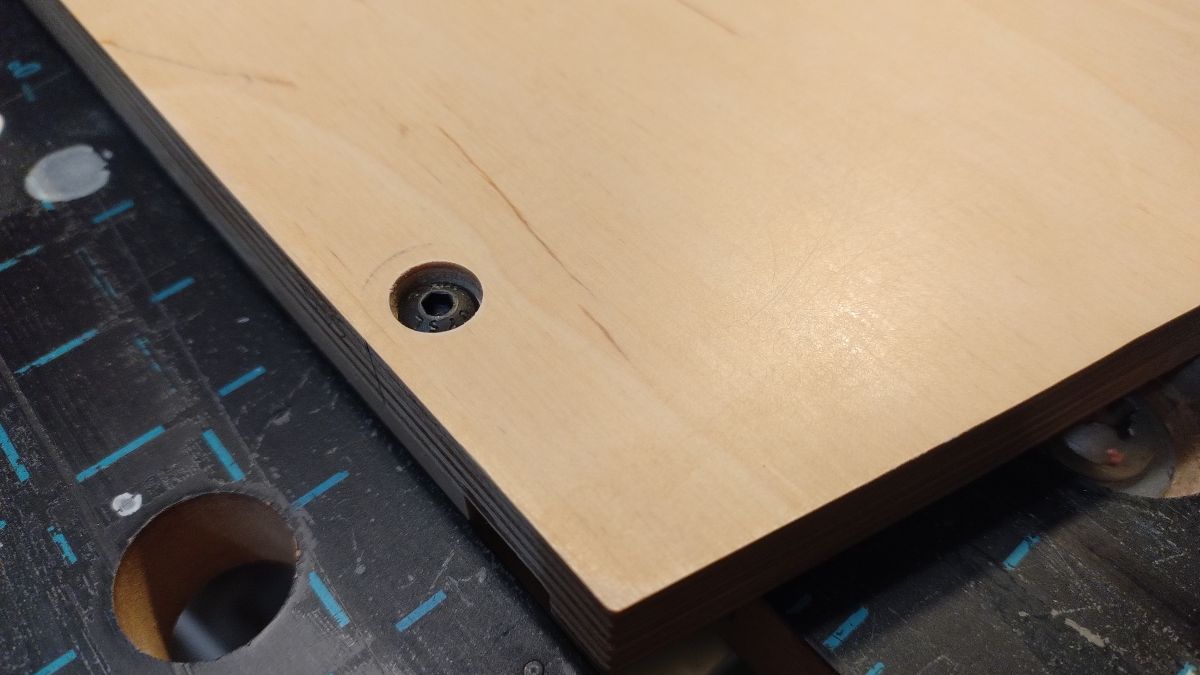

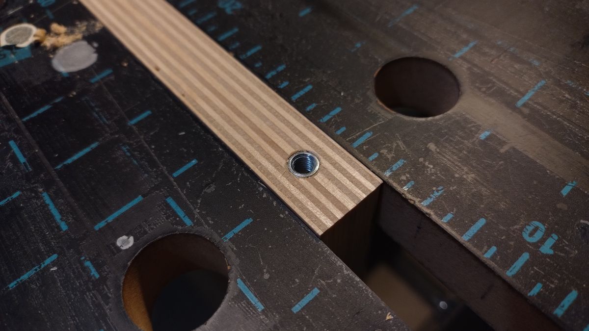

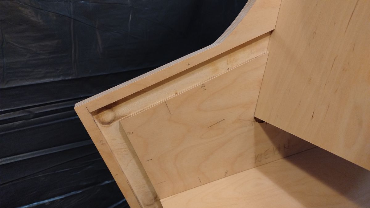

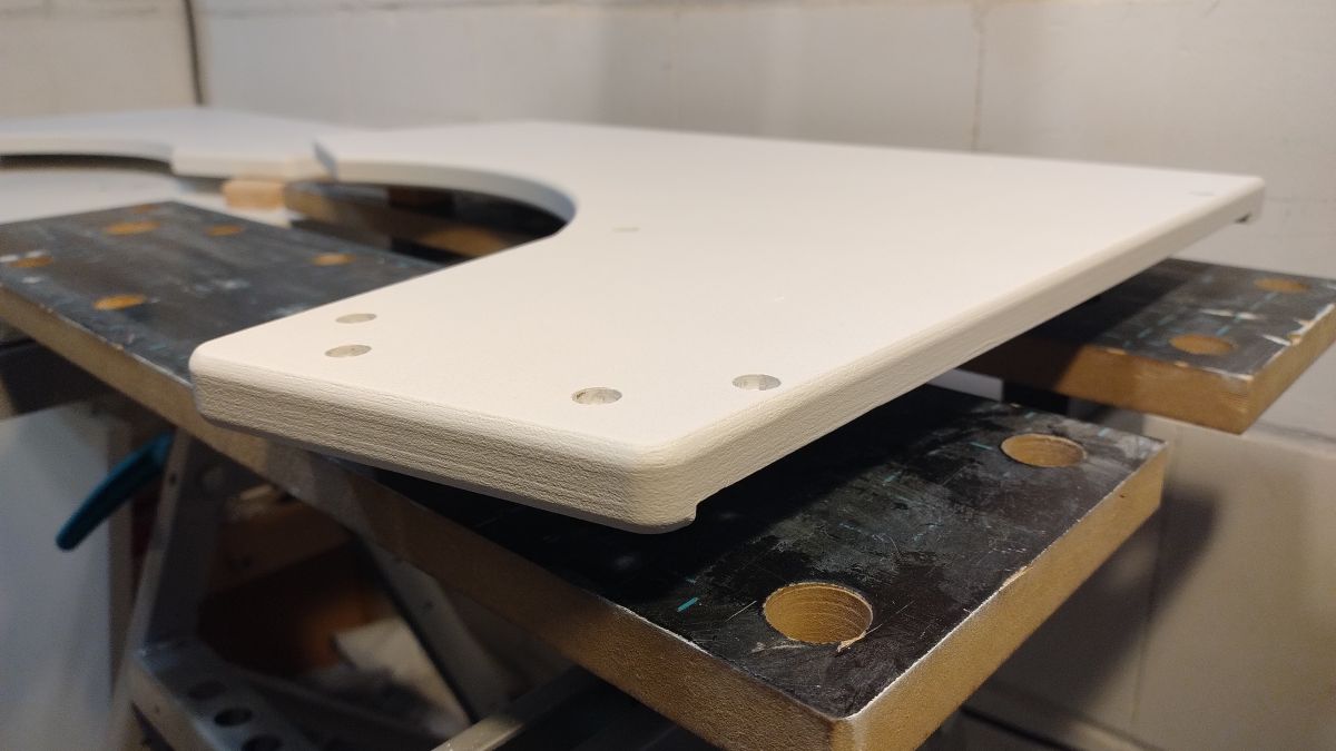

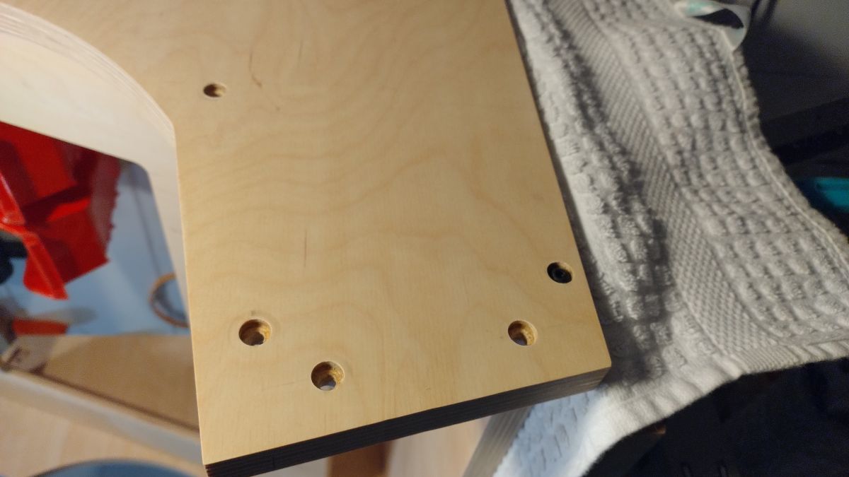

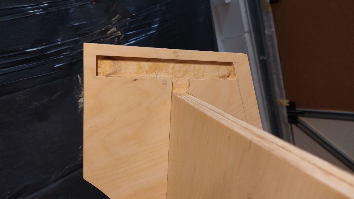

    I made all the connections with M5 screws and repair screws, threaded so that it can be easily disassembled if necessary.
    Plywood board with threaded insert on a workbench. .
    Close-up of a wooden board corner with a screw. .
    Wooden enclosure with holes for screws. .
    Close-up view of the side panel of a plywood arcade machine case. .

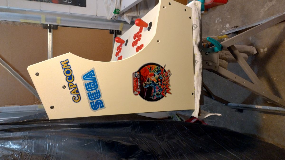

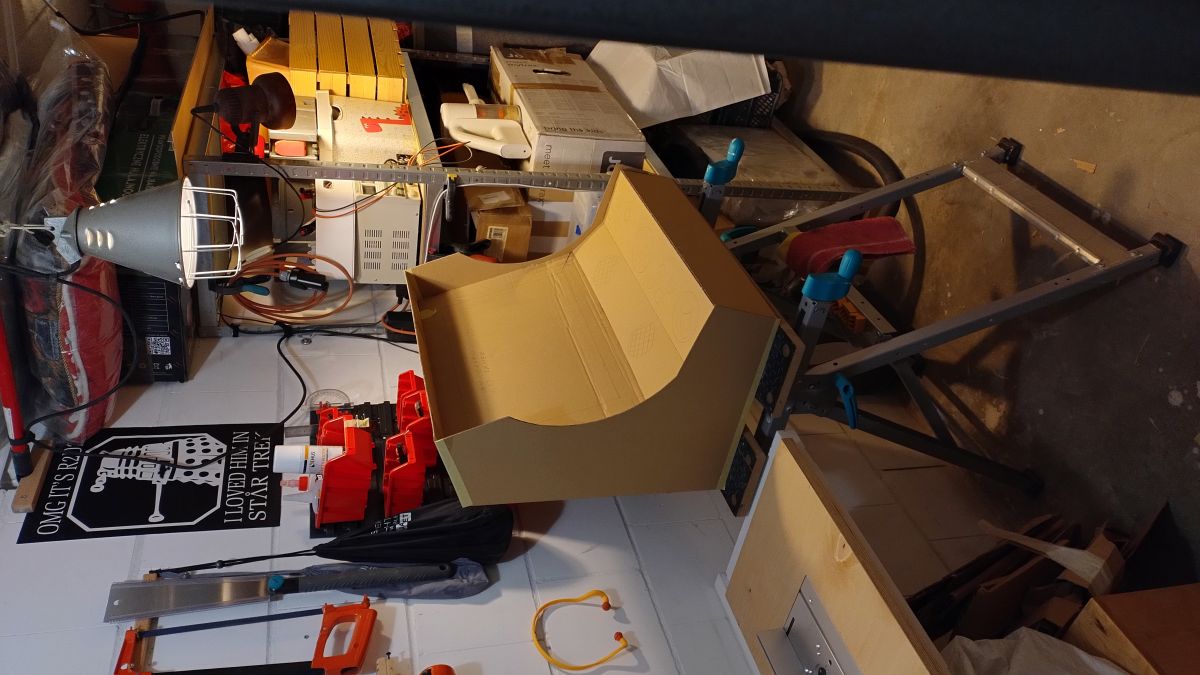

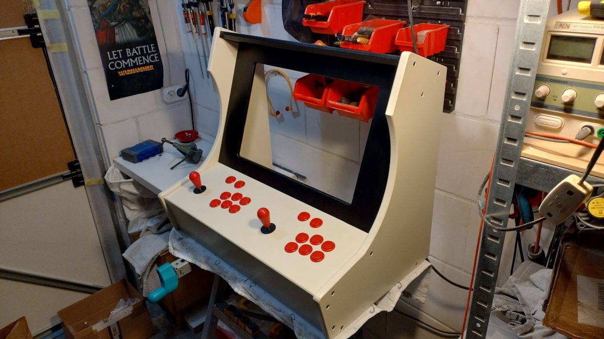

    - I made the case using 18 mm thick plywood.

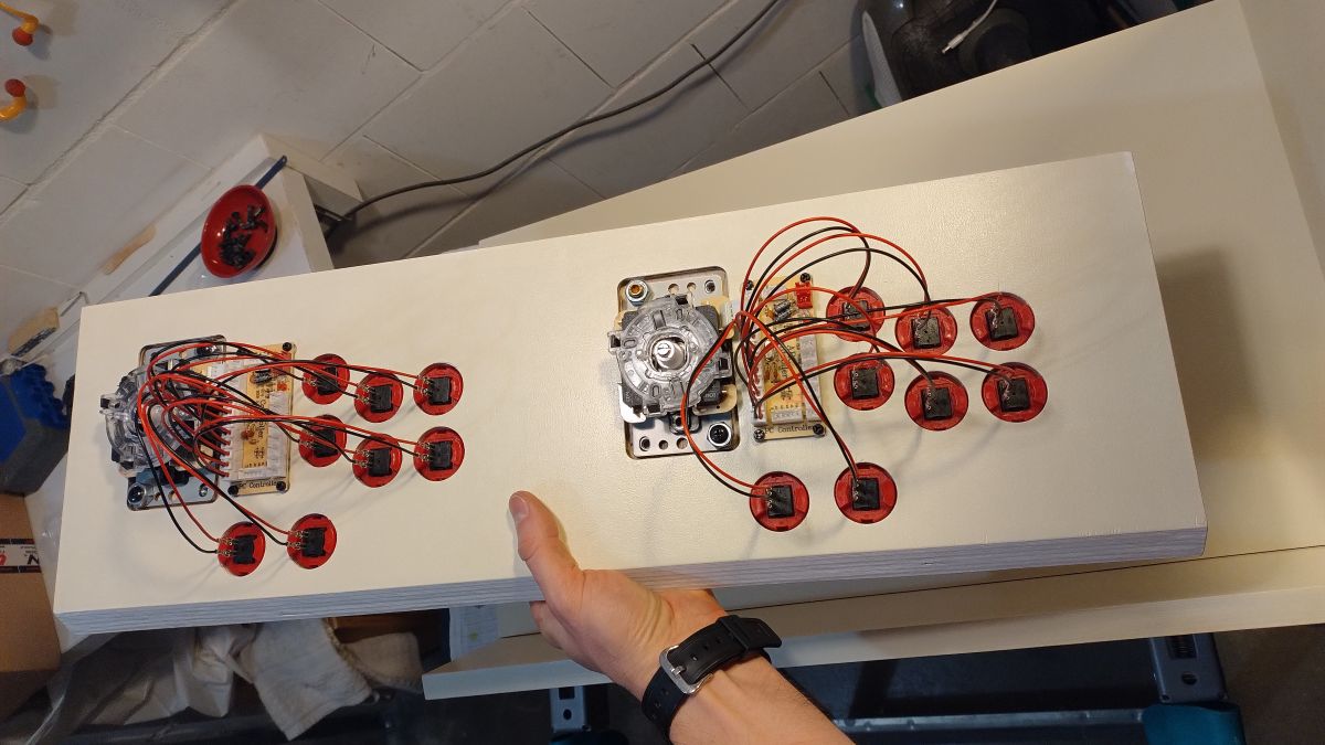

    - I ordered the set of buttons from AliExpress.
    - The stickers were also ordered from a dealer in the middle state.

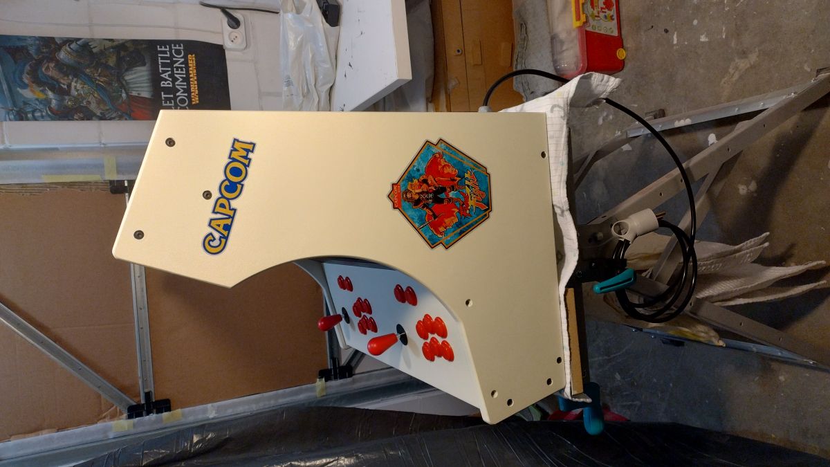

    - I painted the whole thing with matt acrylic paints, white as a primer, followed by two coats each of RAL 1013 'beige' paint and black. At the very end a layer of matt varnish. This is my unlikeliest part of the work, but very important as it gives the final finish.

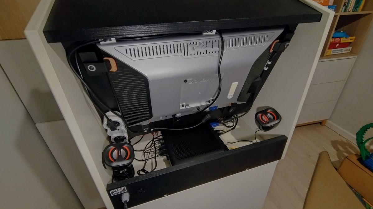

    - The monitor I used was an old one, lying in the basement and getting dusty, the computer was given to me by a friend on the condition that we drank a couple of beers each while playing the slot machine. USB powered speakers mounted on the back of the case.

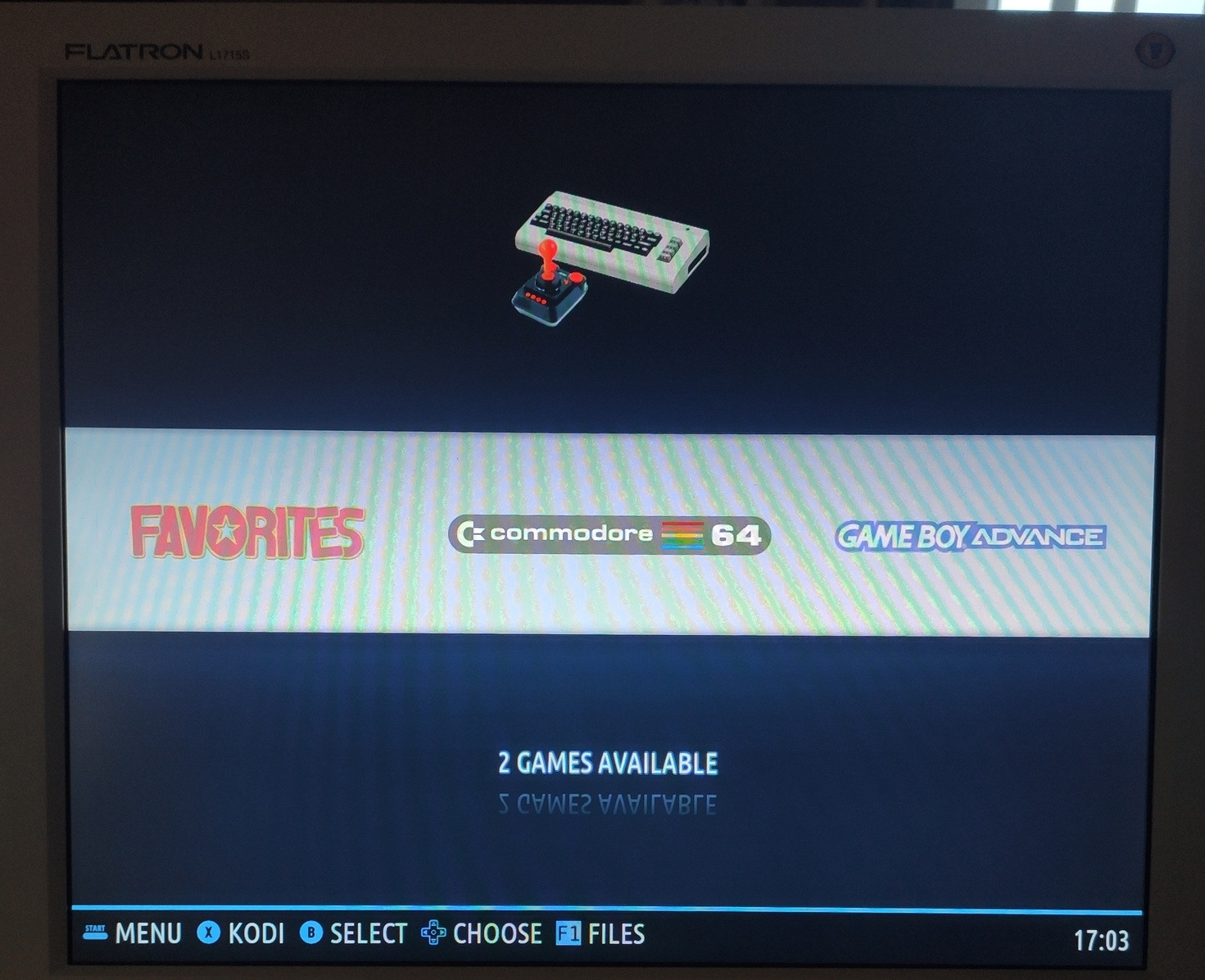

    - The whole thing runs on "Batocera" software.
    Plywood template for a Bartop arcade machine with measuring tools next to it. .
    Working on an arcade machine cabinet project in a workshop. .
    Initial stage of building a Bartop arcade cabinet from wooden plywood. .
    Wooden parts for bartop arcade cabinet on a workshop table. .
    Close-up of a wooden arcade cabinet assembly. .
    Close-up of plywood used in the construction of a gaming machine cabinet. .

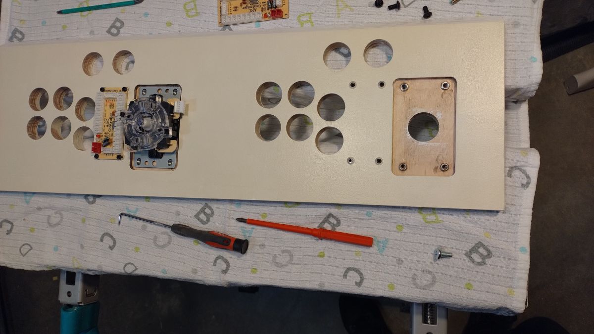

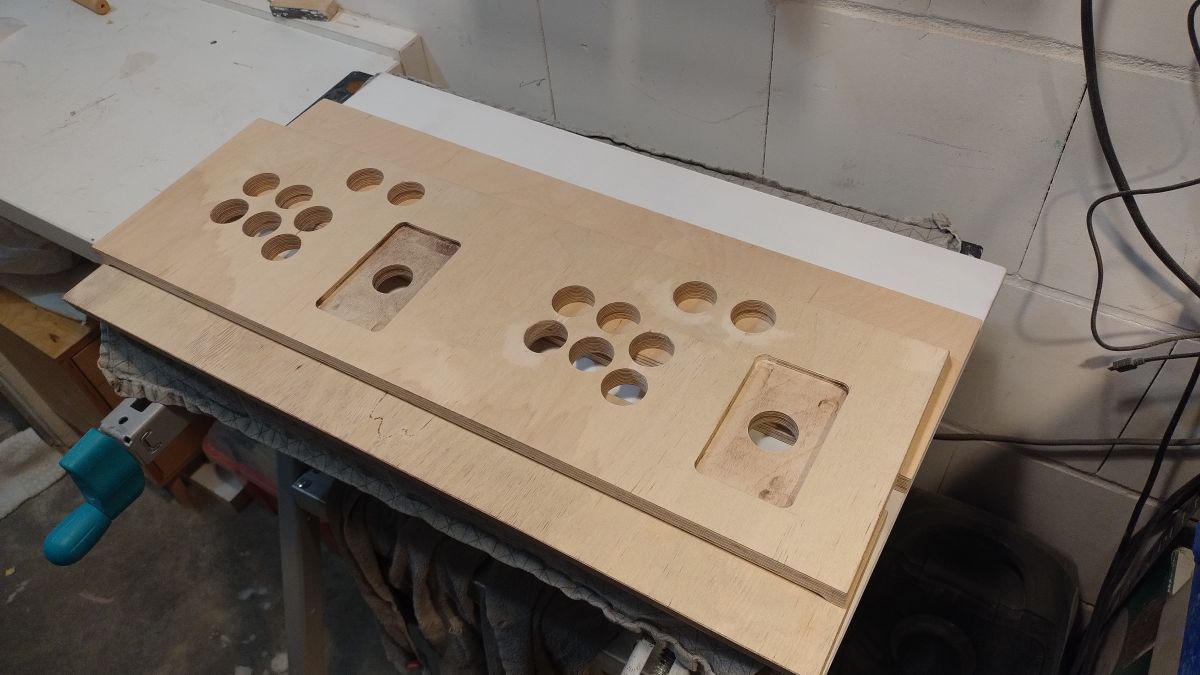

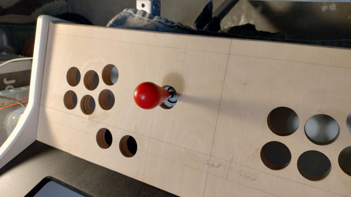

    Arcade game control panel with a wooden frame and a red joystick knob .
    Front panel of a bartop arcade game machine under construction, with holes for buttons and a joystick. .
    Plywood front panel of arcade machine with button holes. .
    A hand holding a game machine control panel with installed buttons. .

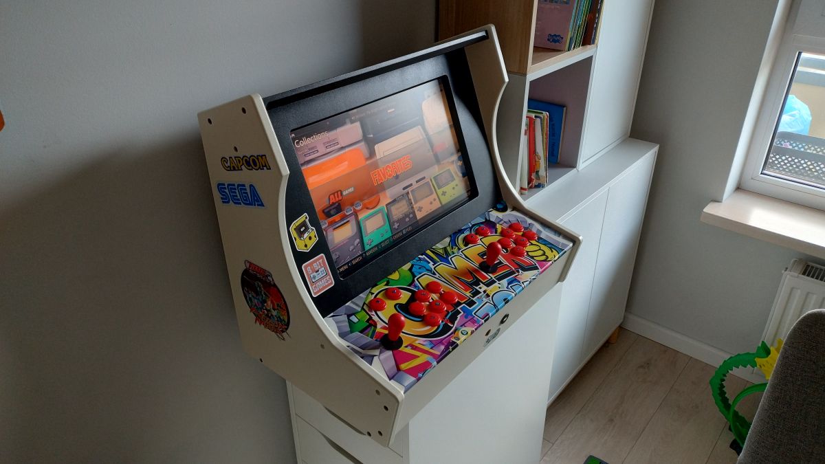

    Homemade bartop arcade machine with red buttons and joysticks on a white background. .
    Back of a monitor mounted in a homemade arcade game cabinet. .
    Wooden Bartop arcade game cabinet with Capcom, Sega, and Attack Mars stickers in progress. .
    Bartop arcade cabinet with Capcom logo, stickers, and red buttons. .
    Back of a Bartop arcade machine showing the monitor and speakers. .

    Super! A dream! They already sell off-the-shelf solutions and retro controllers on aliexpress, but in my opinion they are of questionable quality.
    I see you used an HP terminal ? How does it work for you? How about the performance ? They mostly use Raspberry. Joystick and buttons how did you connect it ? Some module and to a USB port ?

    - I bought the controllers as a set in which there was a set of buttons, joystick and module with USB. Plugging the whole thing in sees it as a normal gamepad, such a plug and play.
    https://pl.aliexpress.com/item/10050068818344...in.59.421f1c24wFiI4h&gatewayAdapt=glo2pol
    - Yes the HP 630T 8 GB Ram terminal, as far as performance is concerned I was running games from Dreamcast and PSX and they ran smoothly. Games on older systems ran as expected smoothly :-) .

    Batocera is a "front end" system based on Linux. It can be installed directly on the hard disk or run from a flash drive (without interfering with the system you already have on your PC. There are plenty of tutorials on the Batocera website and on youtube on how to install on a USB stick and run games from it, as well as from the HDD. It is practically a plug and play tool. It's more fun if you want to set things up for yourself. As for hardware, people install it on rasberry so it doesn't require strong hardware, unless you want to run some games from ps3 etc.
    On the Internet Archive website you will need to download the BIOS files needed to run games on certain platforms. Additionally, Batoera has a substantial manual on the wiki, everything is described in detail.
    I checked the controllers under Windows and they are detected as game pads, they are convenient because they do not require any combinations

    Sticker designed for wall purchased on aliexpress :-) .

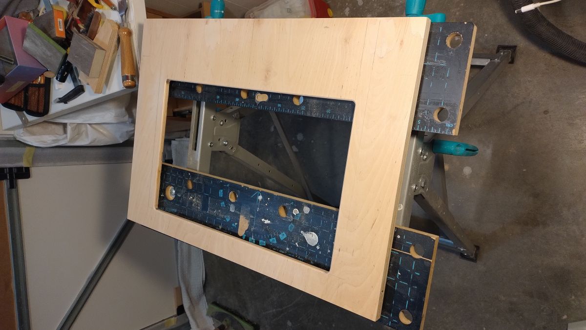

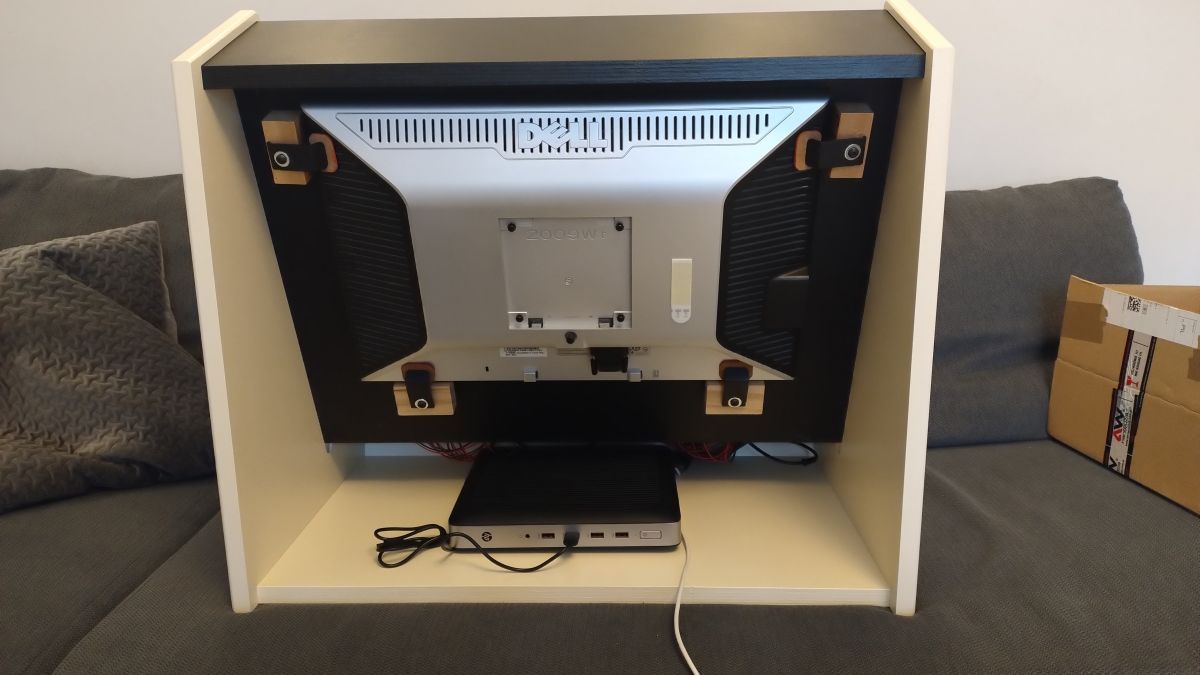

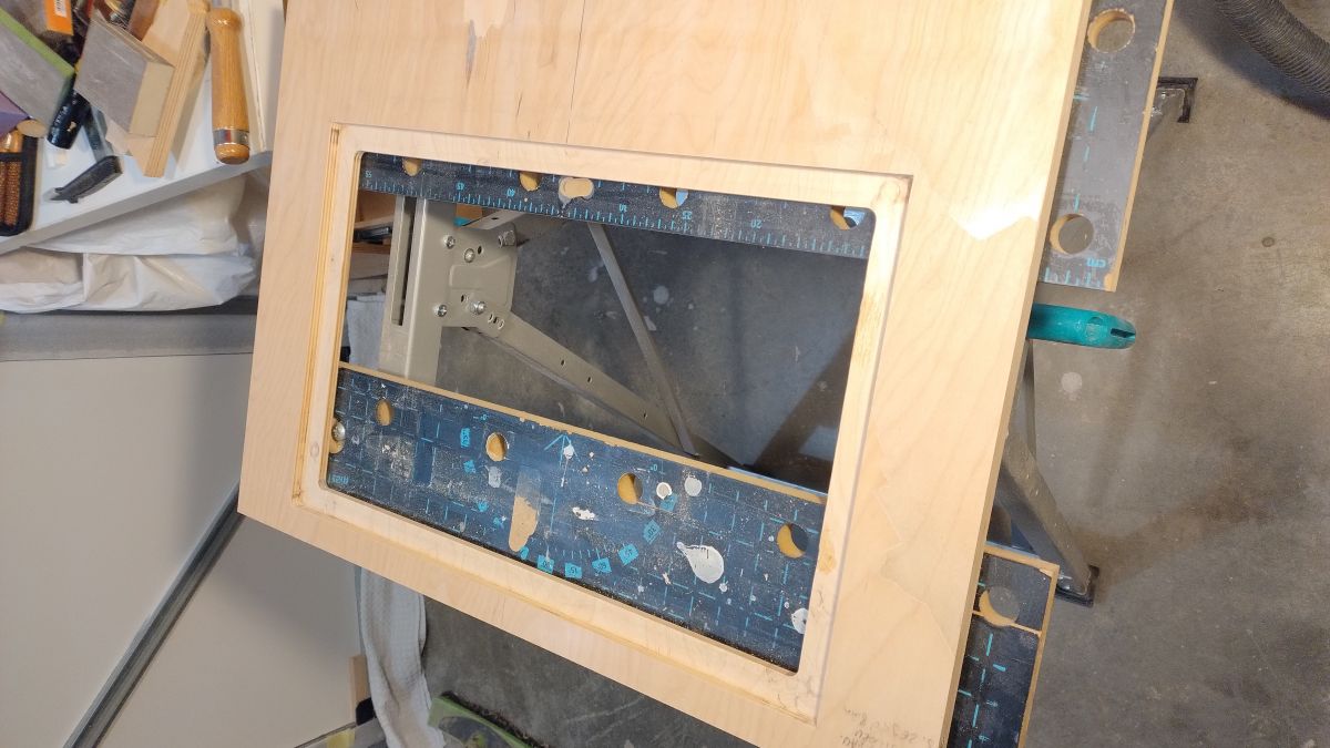

    You cut out such a fiddly format for mounting the monitor. Didn't you think about using the VESA holes?
  • #10 21431738
    siewnik
    Posts: 206
    Rate: 122
    >>21431617 Yes, I thought about it, but in the end I made a mount for the monitor bezel to avoid drilling holes in the side walls, just because I had the most work to do with them and didn't want to cripple it :-)
    Wooden frame for a monitor cover mounted on a workbench.
    Wooden frame with cut-out and mounted brackets.
    Personally, I think I had less to do with this than if I had opted for VESa

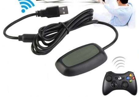

    Young people today convenient, which means instead of a coin changer you would have to think about a payment terminal ;-)
    siewnik wrote:
    skywalker2 wrote:
    I have one from Xbox 360, I just need to buy a USB receiver.
    I am still waiting for mine. I ordered on AliExpress:
    https://pl.aliexpress.com/item/10050072197798...in.11.2b2b1c24KUERh2&gatewayAdapt=glo2pol
    I was thinking more of something like the one pictured
    USB receiver with a cable for wireless connection to a game controller. .
    Although as the first owner of a C64-II and an Atari 1024STE, I understand the former charm of a cable connection.

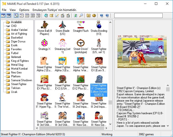

    mame pack;
    Screenshot of the MAME Plus! eXtended interface showing a list of games with Street Fighter II: Champion Edition highlighted. .

    Automatic 1st class. Superior workmanship.

    robgold
    Posts: 724
    Help: 10
    Rate: 290
    It came out very nicely. I like the neatness of the workmanship and those details - the milled indentations in the walls. Drill to mount the guide from the milling machine ... a classic no what you can have in the workshop the fastest at hand ;) Surely it will enjoy for a long time and good workmanship will pay off with many years of service. I write about this because a lot of projects are created as a concept and then, unfortunately, the execution itself is lame, where a lot of things are done by the proverbial "shortcuts". Congratulations on a great project and the quality.

  • #28 21453247
    siewnik
    Posts: 206
    Rate: 122
    robgold This milling machine is no joke. I once forgot myself and replaced the cutter with it switched off but not unplugged. I accidentally pressed the switch and almost lost a finger. In the end, nothing happened, but I learned a lesson. Now I always unplug it before doing anything to it. It's a fact that with manual work, a lot of time is spent planning how to approach something in order to achieve the desired effect. I often already plan this in my mind during the day before I actually go down to the cellar, just to save time. After the job is finished, the reflection comes that this or that could have been done differently and after each such project you gain experience and new skills which is also a lot of fun.

  • #29 21454424
    William Bonawentura
    Posts: 2419
    Help: 187
    Rate: 612
    >>21453247 .
    I attach the key to the spindle with a wire at the plug. It is impossible to lose it or "forget" to disconnect the plug.
